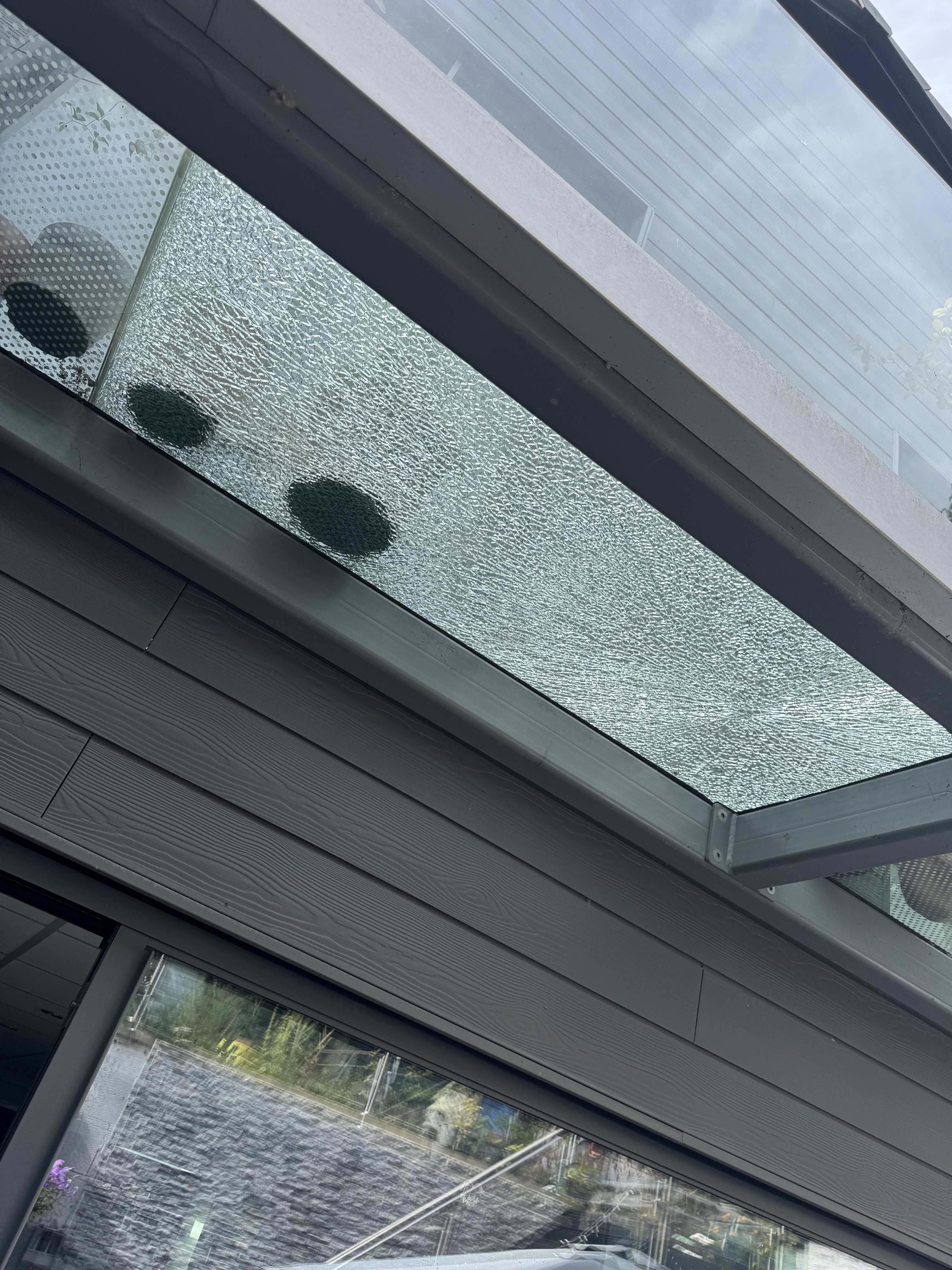

Expensive for sure …. Glass ….
Came home to this .
Really strange . You can see the impact/ fracture  mark ( top side is fine ) . Nothing obvious around like a sledge hammer ! Yet shattered ! Blame the varying heat ?
Toughened glass often has tiny impurities in it.
These set up a stress raiser.
Then they can just shatter with seemingly not reason.

Was on a job where a Norrsken slider just went pop, months after it was installed. It was either the middle or outer pane iirc, but we were all the other end of the room chatting and it decided that was the day to “leave the chat”.
Been walked on?
Nickel sulphide inclusion?

Plant pots on top of the glass right?
Women with stilettos on it.
Christ @SteamyTea , what size stiletto heels do Cornish folk wear down your way ?
Judging by the three that are visible above the glass in the photo they'd fit Shrek's missus !
