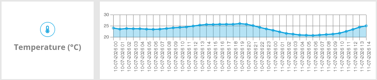

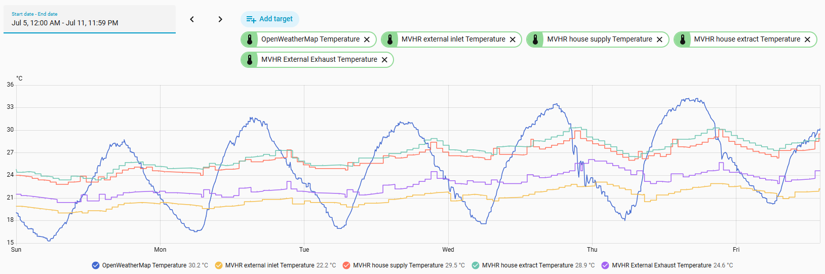

diarmidR Posted 4 hours ago Posted 4 hours ago Hi all, the summer bypass on our Sentinel kinetic appears to be giving the same inlet temperature as the normal heat-exchange operation. House at 22C, external at 14C and in-flow at vent at 21C in both modes. Has anyone else observed this lack of any temperature drop upon opening the bypass? Ta, D
