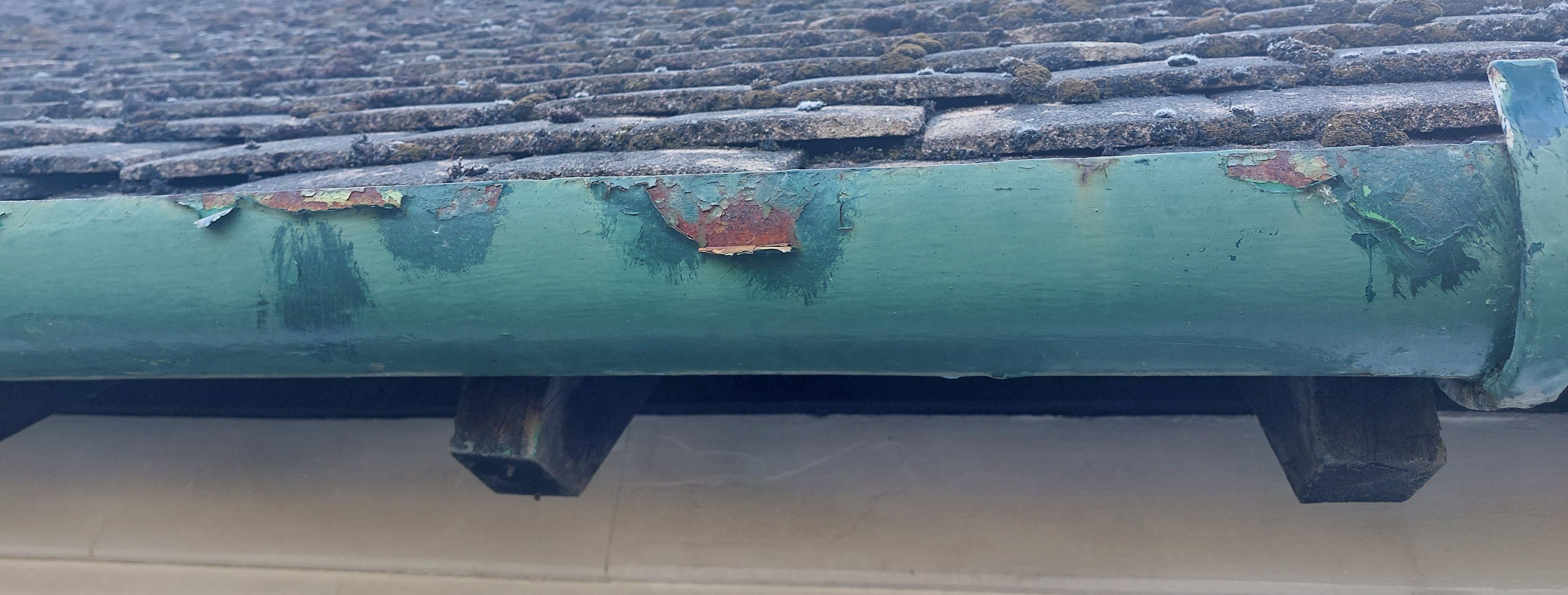

June 29Jun 29 Hoping to do as few operations to this gutter as possible. A one coat solution would be welcome. Any suggested products? I last did that about 10 years ago using something like hammerite. As you can perhaps see it was onto variously the previous finish, an undercoat, or iron. Did I do a primer where it was rusty iron? Can't remember, but certainly only if the tin said I had to. Clearly the paint didn't adhere as hoped, or fade as anticipated. So, suggestions for minimal prep, over any surface, in green. Please. 🤞
June 30Jun 30 Still trying to figure out what "cat iron" is to be honest 🙂 But, IMHO, take the guttering down, clean it all up removing loose paint and rust with a good steel brush (maybe use something in a drill?). Paint. Yes to a primer, then you top coat. If you can afford it Farrow & Ball do downpipe paint (but I guess its for the guttering as well). Other alternatives - Rustoleum, FLAG, Bedec and Centrecoat
June 30Jun 30 20 hours ago, saveasteading said: last did that about 10 years ago using something like hammerite If it lasts 10 years, why not use the same again - Hammerite? Edited June 30Jun 30 by JohnMo
June 30Jun 30 Author 7 hours ago, JohnMo said: why not use the same again - Hammerite? Because it has been blotchy for a while so not rally 10 years aesthetically. thanks for the names, Ill read up a bit incl Hammerite. Rustoleum I know the name, but the others are new. 7 hours ago, BotusBuild said: what "cat iron" is to be honest 🙂 Only one typo is good going with my fingers. I dont fancy taking it down as it is probably 70 years since it was last fitted (we are told that the roof was originally shingles but didn't last long.) and will be 25 years older than that. Just the steel brush perhaps, then whichever paint seems to be the stickiest.
July 2Jul 2 Typo edited 👍. I’d use a rotary wire brush and then a rust convertor, and then Hammerite / Similar back over the lot.
July 6Jul 6 Author The colour I need is Buckingham Green, like the lighter colour on the photo. Hammerite only make it as "garage door paint". There isn't much said about it's properties so I'm guessing the name sells it to the diy shopper and it sticks to primer or gloss. So I'll try that but with rust converter first.
July 8Jul 8 On 06/07/2026 at 18:46, saveasteading said: There isn't much said about it's properties Usually, polymer manufactures keep to what they know. The properties are probably very similar to the paints in the rest of their range. The three things most likely to change are the surface tension additive, the pigment/dye and the etching agent additive. The rest will be the same. Buy a pot and give it a go.
