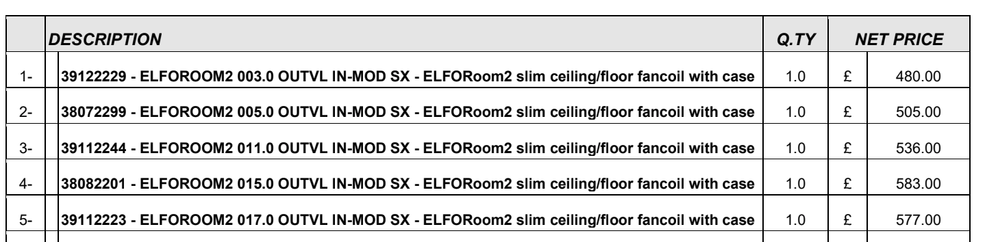

I just recalled Clivet do a unit too which can be ceiling mounted: ELFORoom2. Looks a good price based upon the below which I got December last year and completely forgot about. Prices may have changed but relates to https://www.clivet.com/en/products/home-solutions/fancoils/elforoom2 and I got that via their contact form
Well done Nick.  Will investigate.

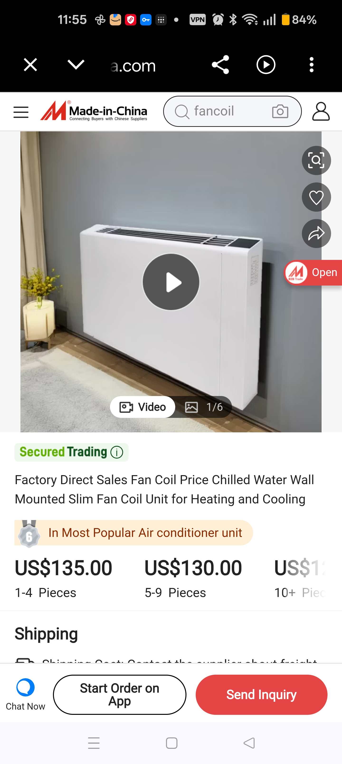

A quick image search brought up this - import duty and shipping to pay so not sure if the final price - but looks a different scale of price, many other came up also
Screenshot_2026-06-28-11-55-47-43_40deb401b9ffe8e1df2f1cc5ba480b12.thumb.jpg.cee958acab2ad9bf2a1643da3baf3b02.jpg
I’m too much of a whimp.  I looked at one from Germany and apart from the unknown of import duties (thank you so much Brexit) the possible grief of maintenance worried me off of the idea.
I would prefer to have a uk distributor who hopefully will carry spares for a good few years.  I can dream.
