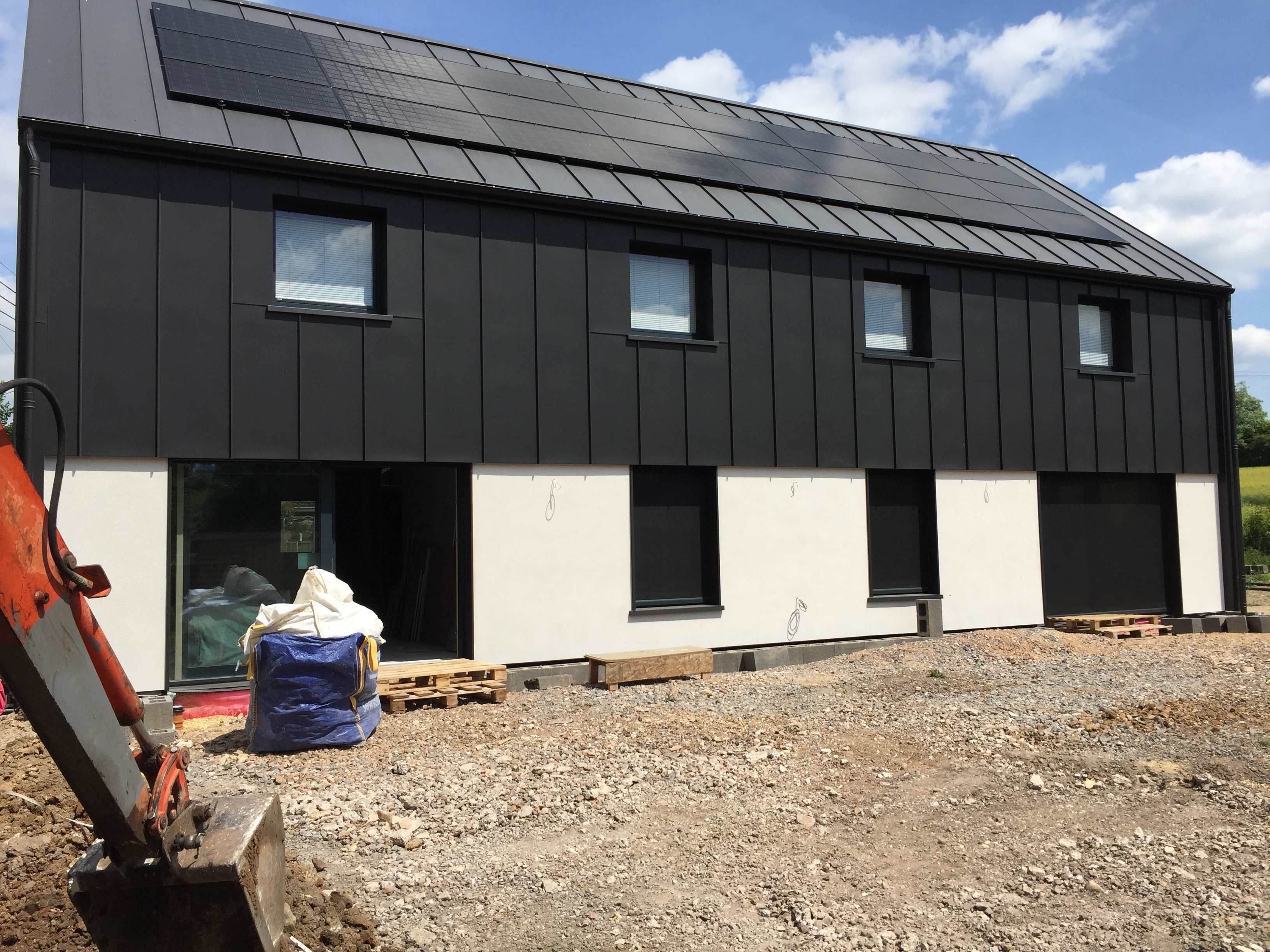

How slimline/innocuous are yours?  Do you have a photo?
Slimline, I guess so.
Innocuous, I’d say not.
ours look over the back garden and can’t really be seen easily from anywhere.
This is from a few years ago when everything was fresh, clean and unfinished.
Sadly ours will be on the front but, I have to say, your setup looks much more dicrete than many.
Have you had to take any anti-bird/nesting measures?
No, the panels pretty much sit on the standing seams using the S5 clamps that @Mr Blobby mentioned. There is no space underneath for birds.

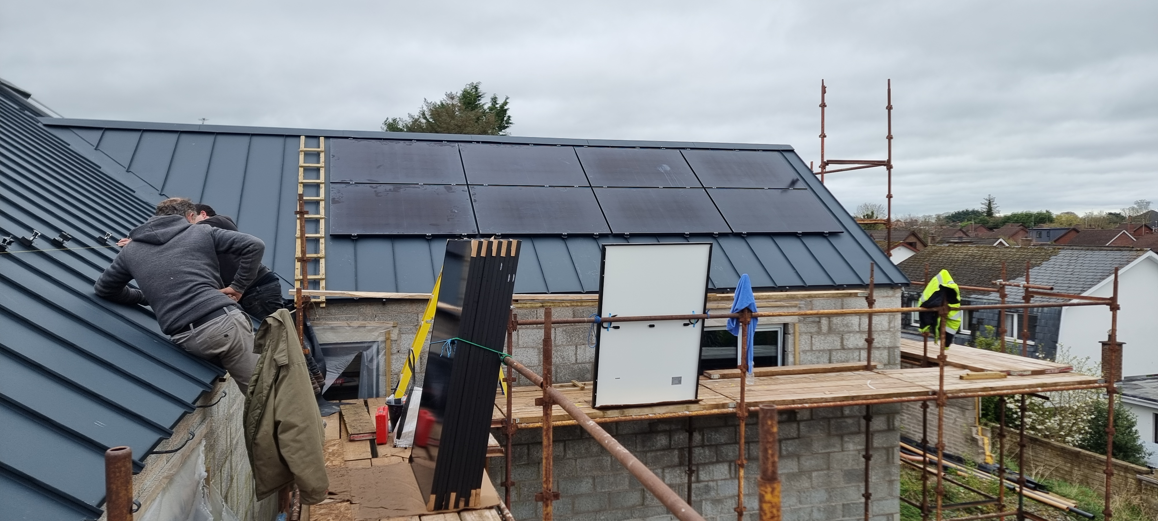

Here's ours being installed.  @Russdl's look way smarter and low profile, perhaps because of the distance from the ground.
You can see the clamps being installed, they have a disk that sits 15mm above the seam.  We've had no issue with birds trying to go underneath.
I wish I could have fitted three rows of panels on that South facing elevation 😕
I reckon it’s identical and as you say the distance from the ground that the photo is taken makes it look different. Not much though, smart set up.
I think I would have been happy to pay for additional pv to roof connectors so that there was one on each standing seam (as with @Russdl's setup).  The asymetry od skipping one seam would have my OCD twitching every time I looked at them!
