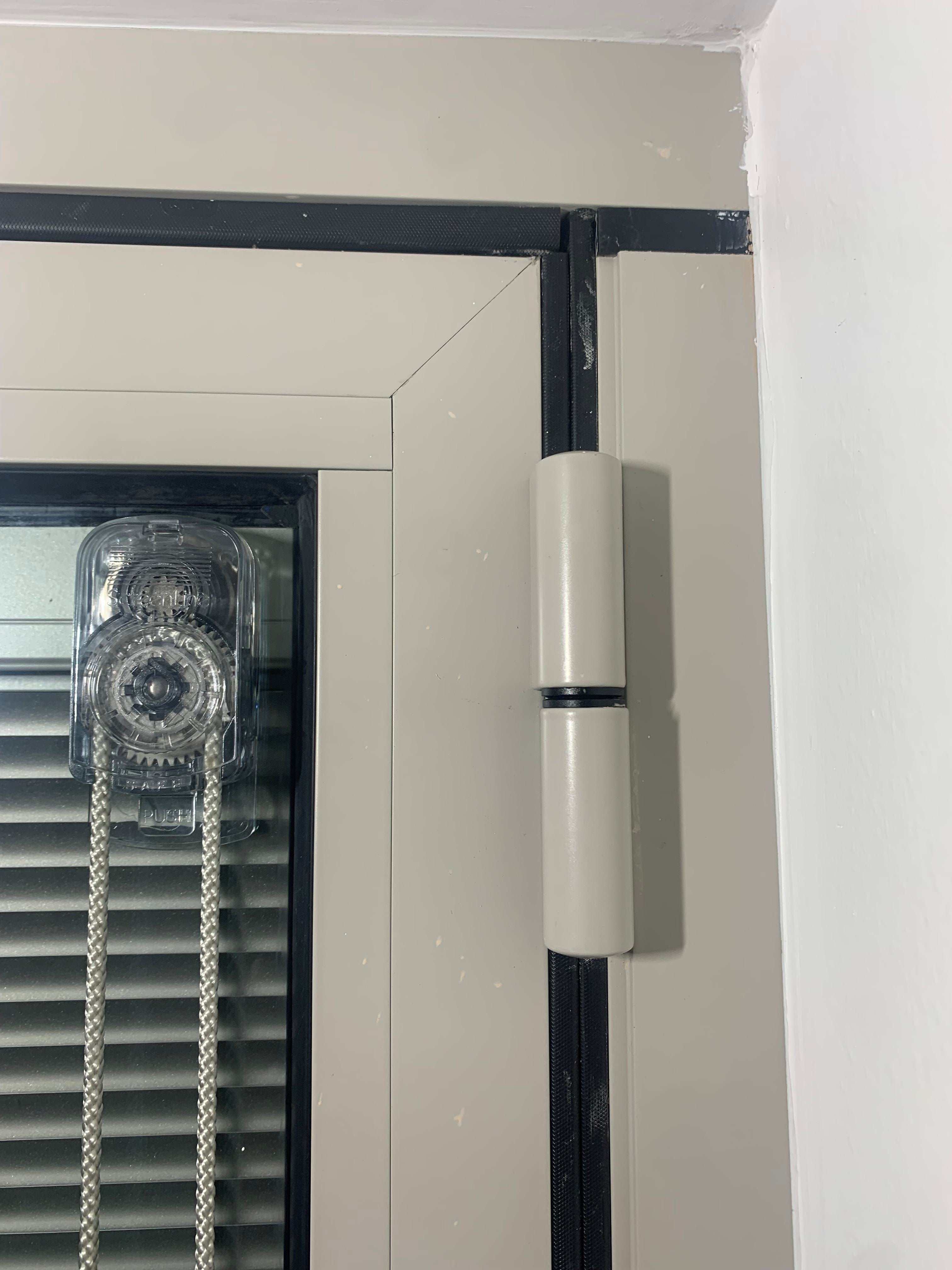

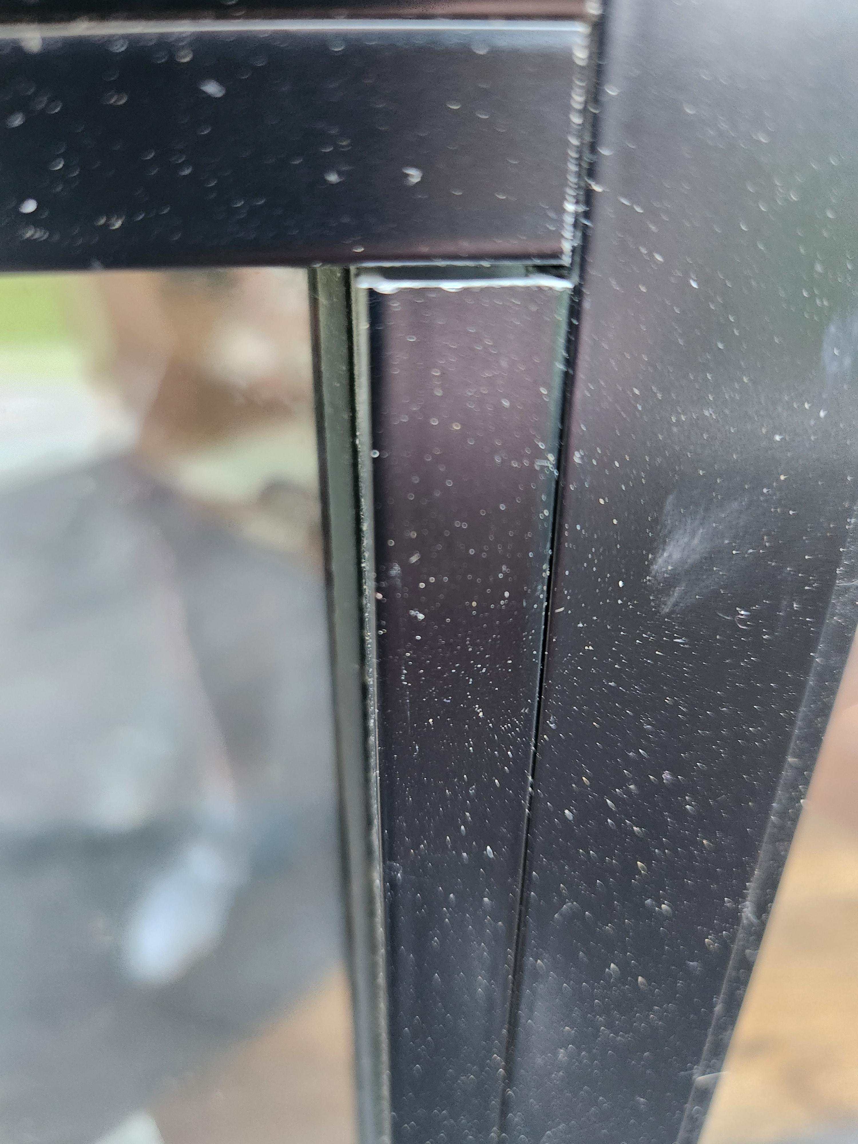

I've attached some pics below. The primary issues I have are.

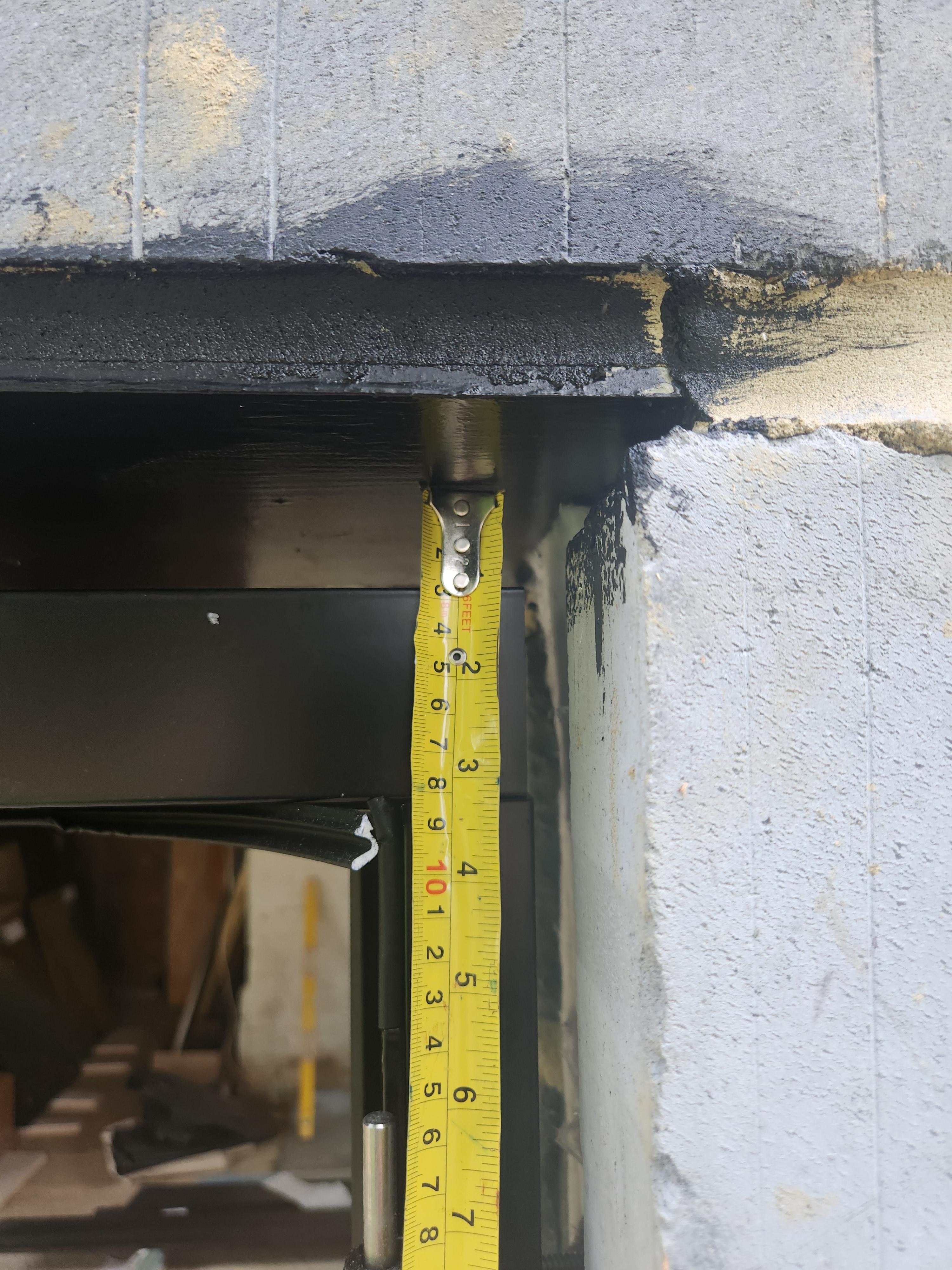

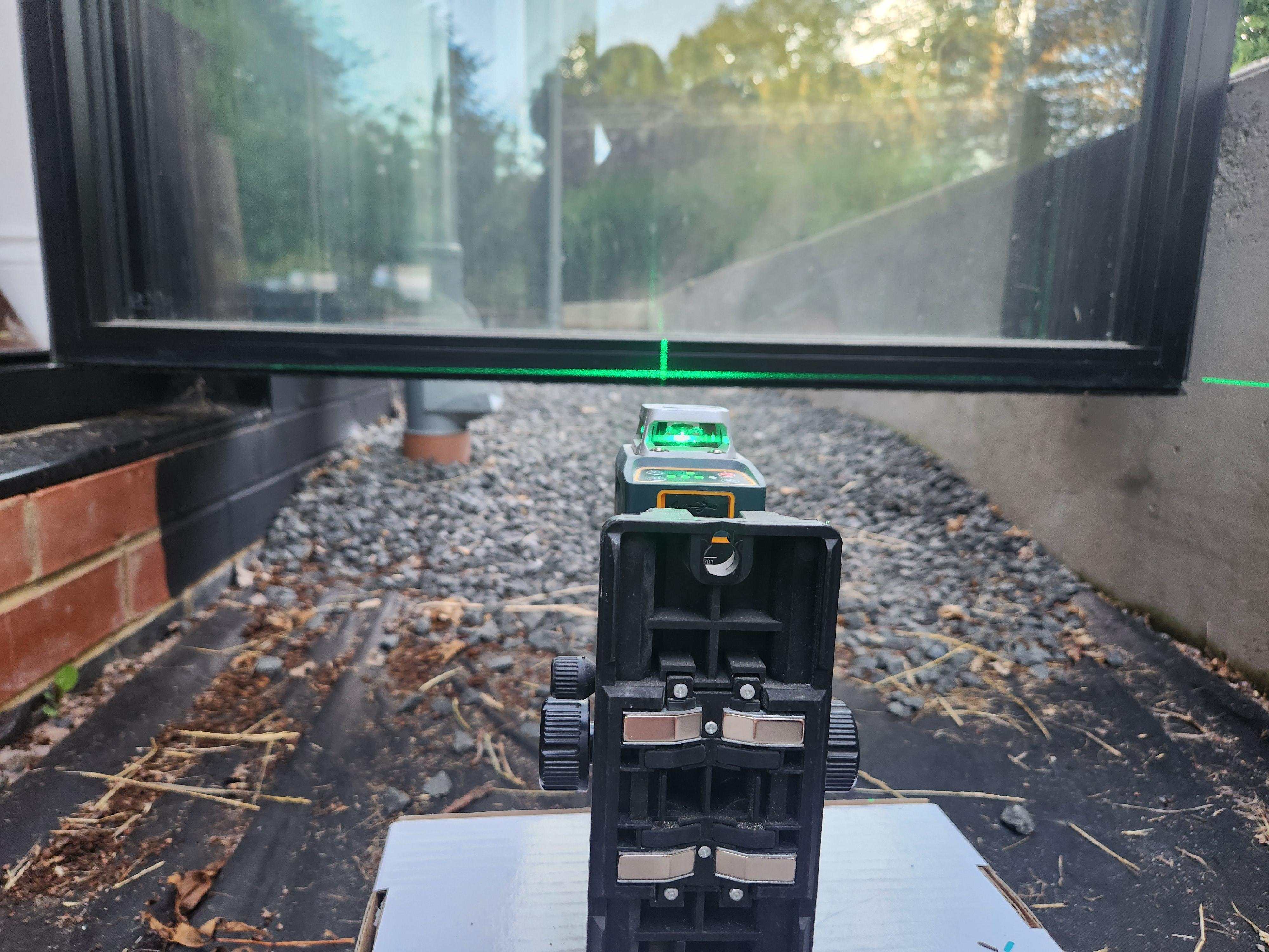

1. One of the door leans over when opened by about 10mm. This messes with my flush'ish threshold. I can work around it but the bigger concern is that the doors are so large and heavy that they are pulling on the frame. The door was not installed plumb (see pic).
2. When opening the door I was given strict rules that the door must be open and set back fully onto its magnetic catch before attempting to open the rest of the bifold. That if I didn't do this the doors WILL scrape against the bottom of the frame and could pull out altogether.

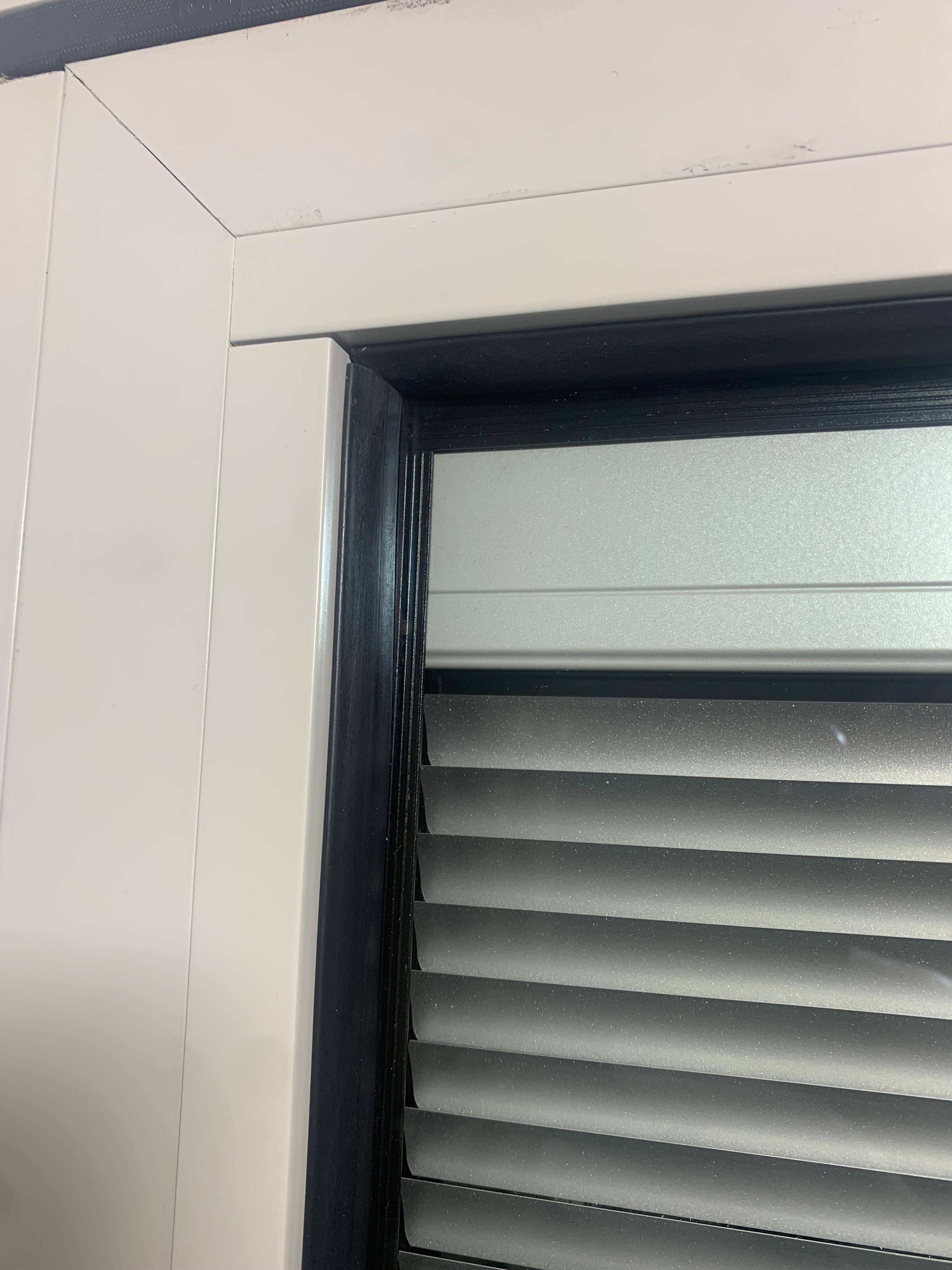

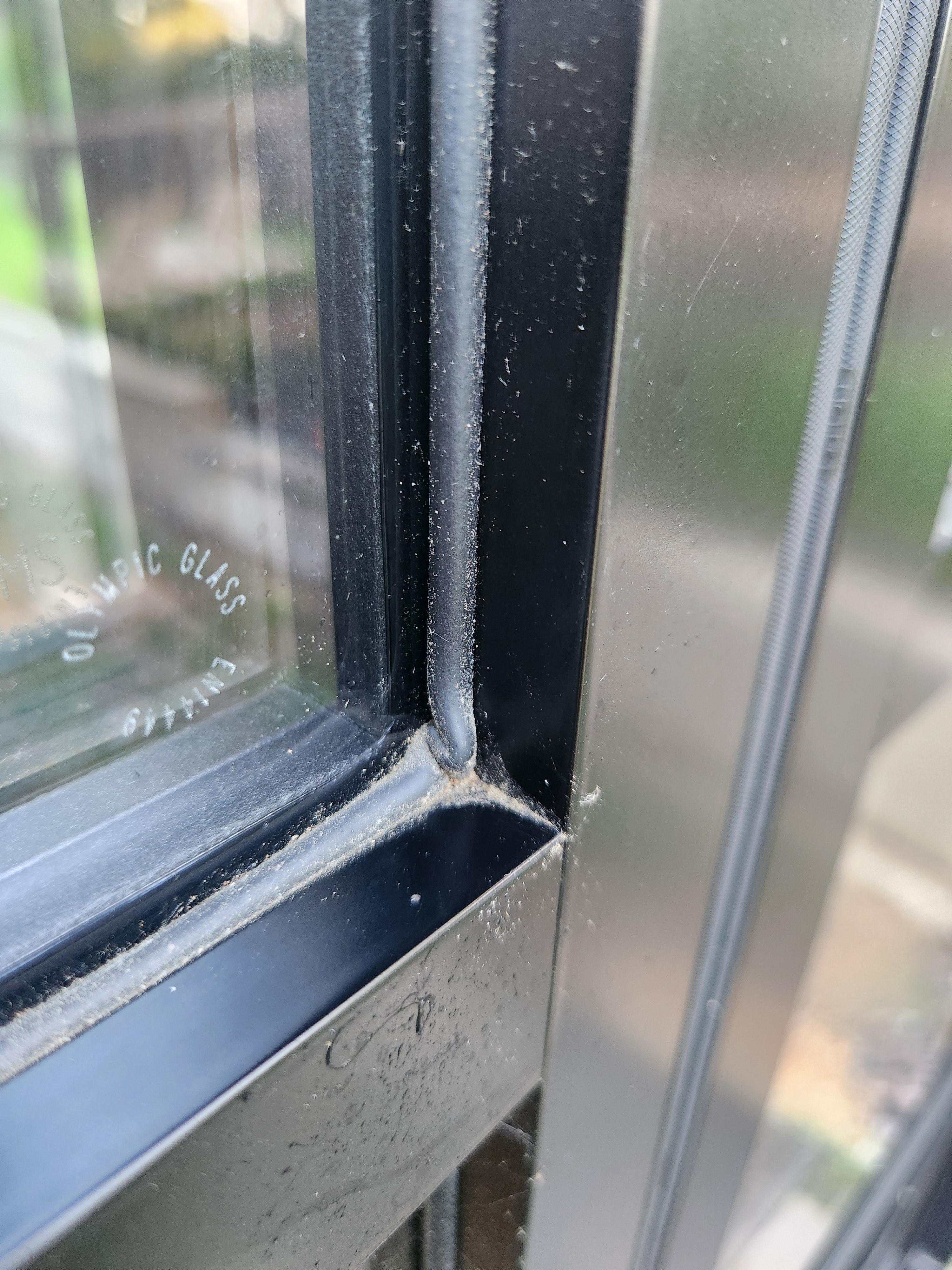

3. Exposed unpainted aluminium cuts. This problem is pretty much everywhere, every time I look at them I spot a new unfinished cut. This just feels really low quality to me. I can't understand why the cut sections couldn't have just been sprayed when they were cut.

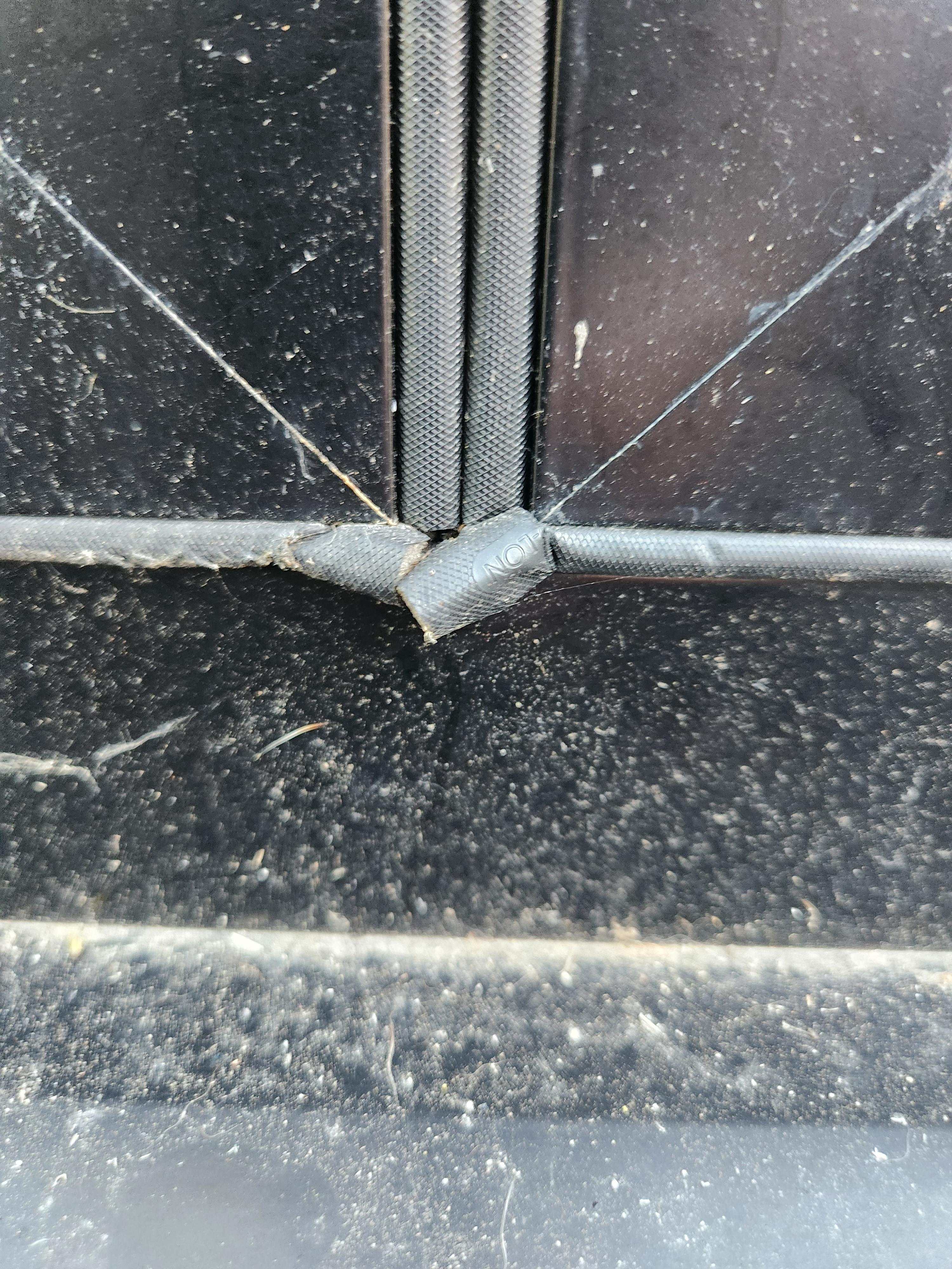

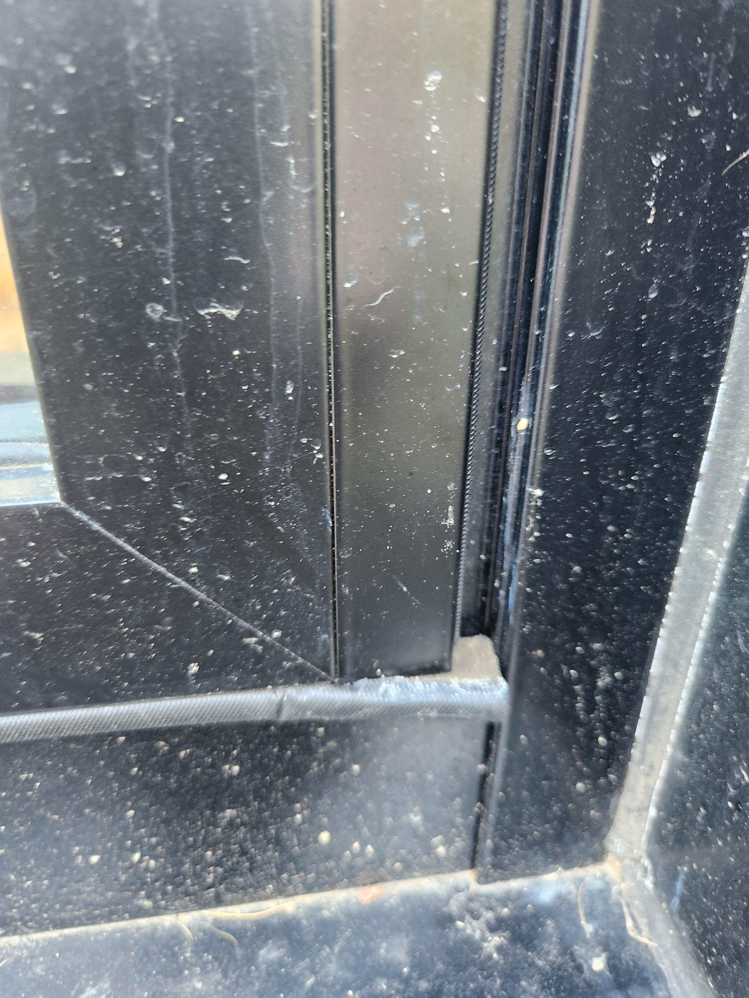

4. Gaskets and seals - I don't know all the names of the parts but essentially some of the external seals are hanging out. Again seems low quality finish that was cut after by the fitters. The gaskets that hold the glass in have issues where they appear ot be bent and don't have a clean finish. Not sure if this really makes a difference to the weather protection?
Would appreciate any views on whether I just leave it now.

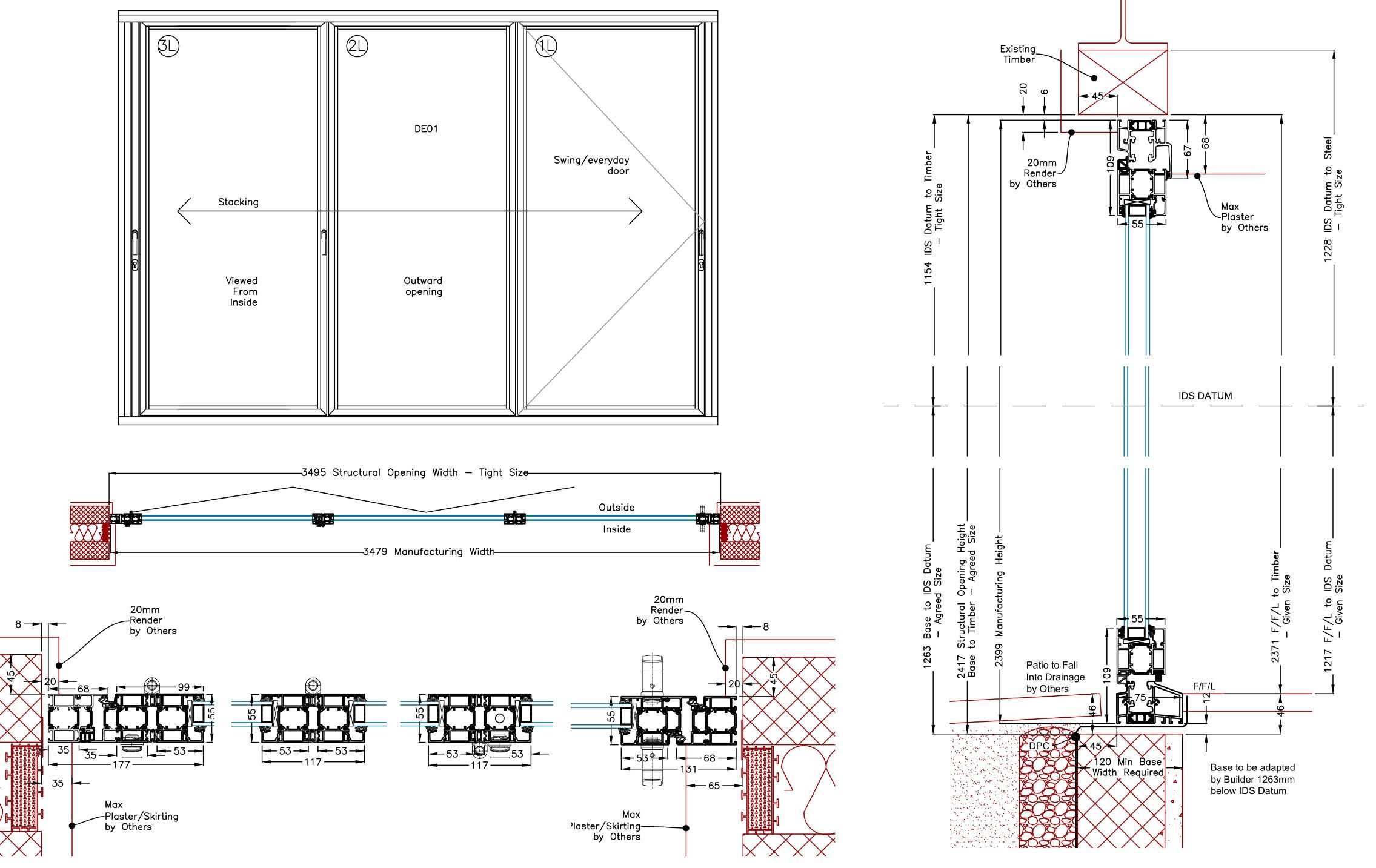

I don't have a any cut ends exposed. Opening was surveyed by the fitters and dimensioned manufacturing drawings then provided for buy off before manufacture.
Thanks Spinny. Re the seal in the pic. Would you see that as a problem?  The company that did mine came out and surveyed twice yet still managed to forget the position of the retaining wall in relation to the door opening which mean the doors ended up being set further back than intended meaning the cill didn't cover the bottom of the wall.

I wonder what exactly happened regarding your survey - did they produce dimensioned drawings afterwards and gain your explicit sign-off/approval of them prior to manufacture ? Did the drawings show or specify the distances to the wall as an explicit design constraint ? Did they change your cill design when they realised the wall mistake and adjusted the fitting ? Were you always going to have a traditional cill rather than a low profile one ?

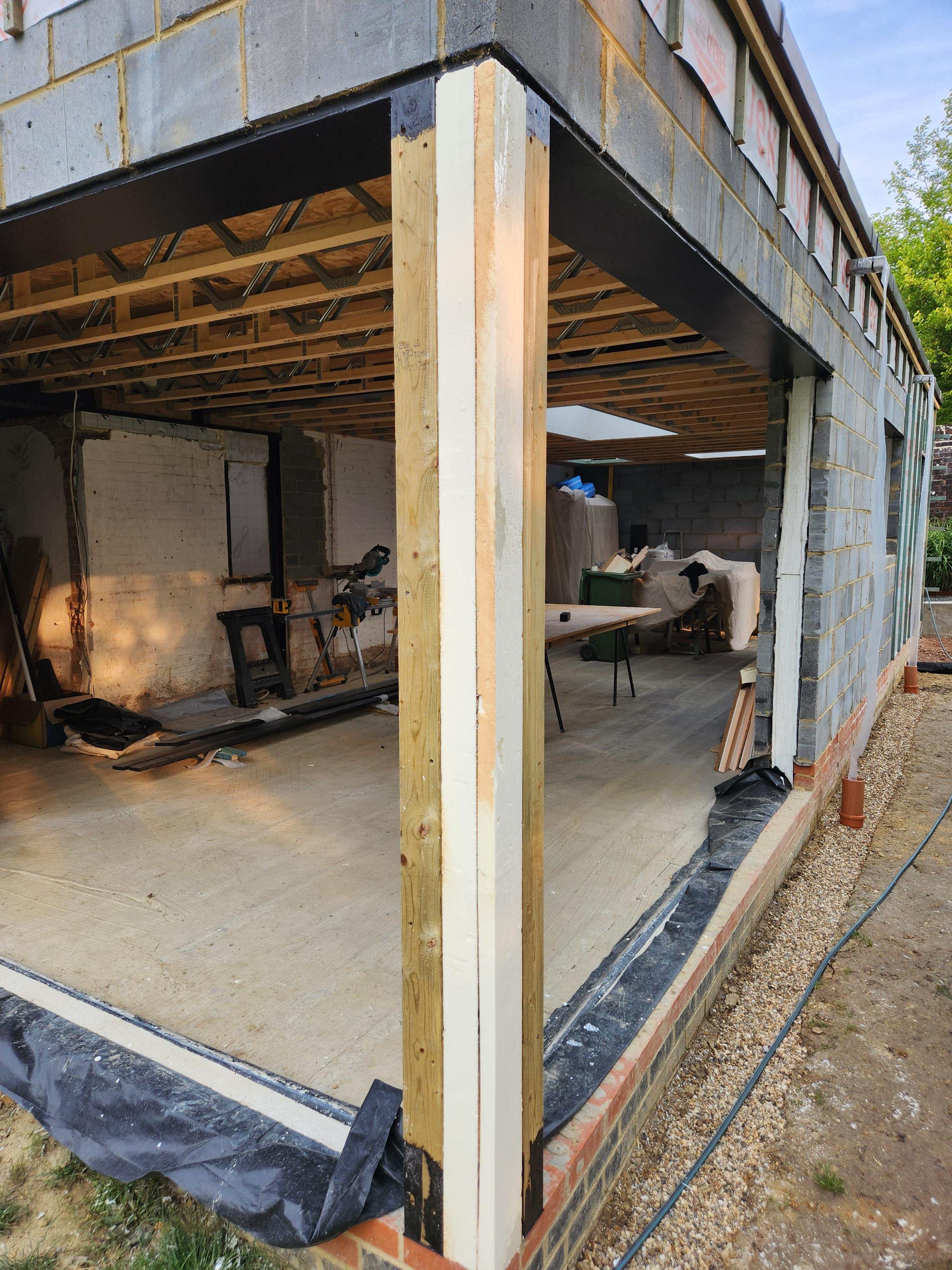

Looks like a 50mm error - did someone build the wall out of position ?
I just wonder because if there was some clear evidence that the wall issue was their reponsibility to take account of and they failed to do that then I would have thought you would have been within your rights to refuse the original fit.
I found there is actually quite a lot to think about for the sizing and positioning of doors and windows - exact FFL, handle clearances, reveal clearances, threshold fixings, lintel/steel fixings, plaster lines, render lines etc. I attach our bifold drawing to show the level of info specified. You almost need to be autistic about it all.

I would query that seal and the gasket. I think both should be fixable. When new stuff finally gets installed it is easy to be euphoric and not check it all over.
On the unfinished cut edges, you could go back to a showroom and examine the showroom origin doors - do they have the same finish - if not you could raise it.
Sorry to hear about your issues.
In terms of flexing, the door dropping common issues are:
1/ It's the glass that holds the door leaves stiff and prevents distortion, dropping. If the glass is not packed properly in the frame this will happen.
2/ The door frame is not properly secured to the surrounding structure.
3/ The hinge screws have been over driven ( the screw threads are stripped) and the hinges are moving.
4/ The structure is moving as it gets loaded sideways.
You can experiment yourself to see what is causing this. The following notation is.. A relates to item 1 and so on.
A. Is the glass packed properly? Get some 50mm masking tape. The wider the tape the better. When the day is not too hot or cold and the sun is not on the doors gently put strips of masking tape between the glass and the frame. Let it bridge over the gasket, i.e not touching the gasket.  Don't stretch the tape, let it settle but not touch the gasket. . Do this each side of the corners of the glass, in the middle vertically and mid point of the head and base of the glass. Open the door a little and see if the tape wrinkles. If it does it means the glass is moving relative to the frame.
Repeat but this time smooth the tape around the gasket so it is in contact all the way round. Carefully take a Stanley blade and cut between the glass and the gasket and the gasket and frame. The objective here is to see if the glass is moving relative to the gasket, the gasket moving relative to the frame or both. This is a bit of a moot point but later we may want to check is the correct size of gasket has been fitted. If the door is dropping by 10mm and it's a glass packing problem then you should be able to see this with the naked eye or a magnifying glass. What we are doing here is the same in principle where we may want to accurately monitor a building for settlement.
B. You can carry out a similar exercise to the above but where the frame meets the walls.
C. The hinges often have a vertical adjustment. You may have 3 or 4 hinges. If they have not been balanced (to share the vertical load) then all the vertical load and then a share of the sideways load ends up on one hinge which can over stress it. If the screws are stripped the heavily overloaded hinge may be moving. It's tempting to fiddle with these yourself.. but as soon as you do the last man on the job gets the blame.. which will be you! But have a look at them and see if they look like they are carrying equal loading. Look for unusual gaps between the shims and see where there is no gap in others comparatively.
D. You say that the door drops as soon as you open the door? The loads at this stage from the door leaf will be mainly in the plane of the wall. If the movement gets greater as you further open the door then the structure may be flexing. This is the last thing we would look at, try and rule out common issues first.

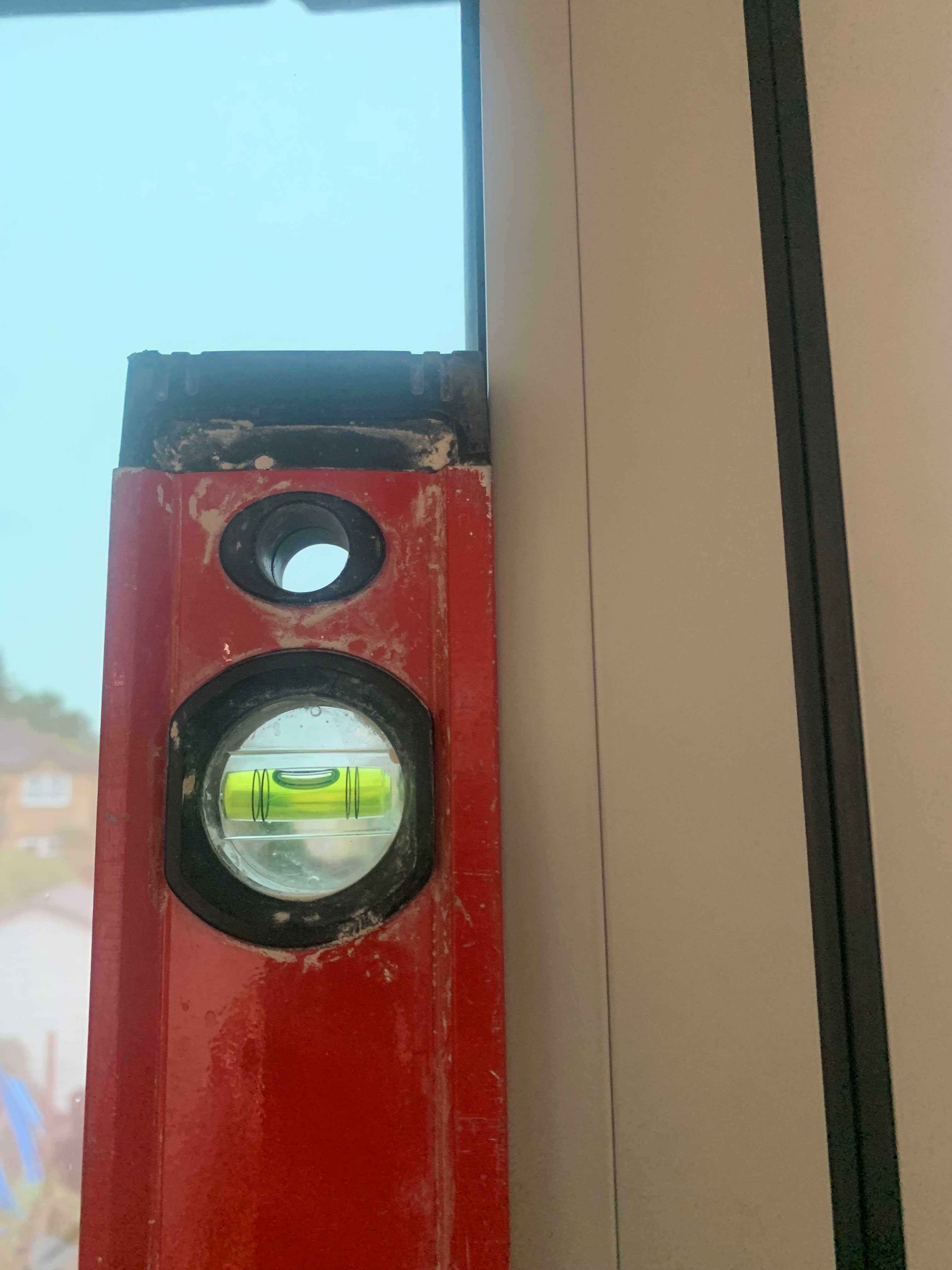

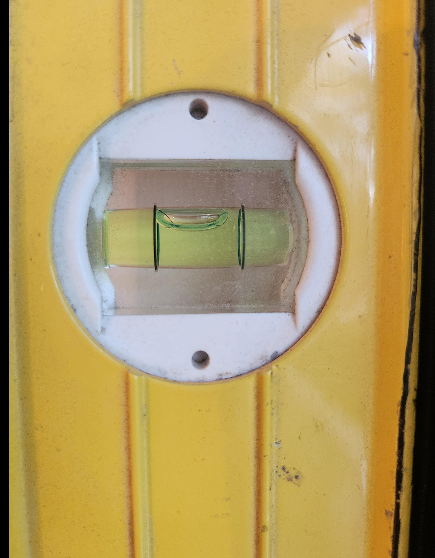

@paro I see you are using a spirit level and a laser level. Often the accuracy of these is disputed. To avoid any doubt at your end go to B & Q and get a bit of clear plastic pipe. Get some water and put a dye in it, mostly fill the tube and tape it to the door leaf at eye level when shut. Now we have a water level and the physics of this cannot be disputed.
Mark the BOTTOM of the meniscus. Open the door, remark, measure the difference. This is going to be within 1-2mm accuracy at worst.
In terms of the gasket and brush bar fits.. it does look a bit rough. Bare metal cuts are common, often these are hidden. Here we may want to get some touch up paint.
If you fancy having a go at this it should help inform you or at worse rule out what is not causing the problem.

@Spinny They did the standard Origin ones, but these were just the door sizes, no reference to the wall.  They actually came out twice to survey. There had been a long gap between when I first enquired and when I was ready to order plus there was a corner post to add detail too.
I have the doors set in the middle of the cavity (just thought this looks nicer), and had cast a concrete base for them so there was no void. The other key advantage of this was that there are steels surrounding all of the apertures for both doors so something very solid to bolt into as opposed to the thermalites which I never want to use again. I was quite disappointed to see that the doors were a good 25-35 shy in height and width when they arrived, this was then just filled with spray foam. I like the idea of maybe removing some of the thermal bridging but it seems like it would be compromising the structural integrity of the door having screws bridging wide gaps.
Originally they set the frame so that the cill sat over the brickwork but when I checked the next day they had set it back as they realised the door width was an issue. I had a whole thing with them at the time about it not being okay, they insisted it was fine and would sign it off. Spoke to BC control who's only input is 'a windows a window' and had no interest, so reluctantly accepted.

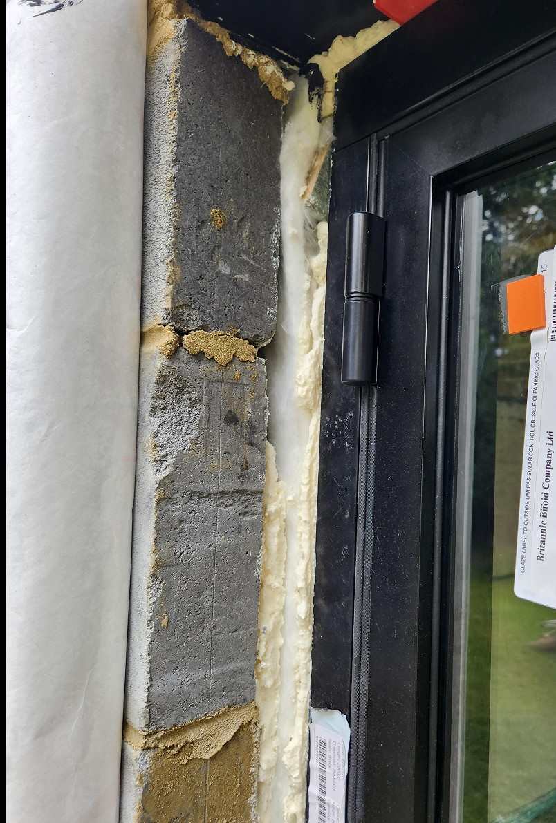

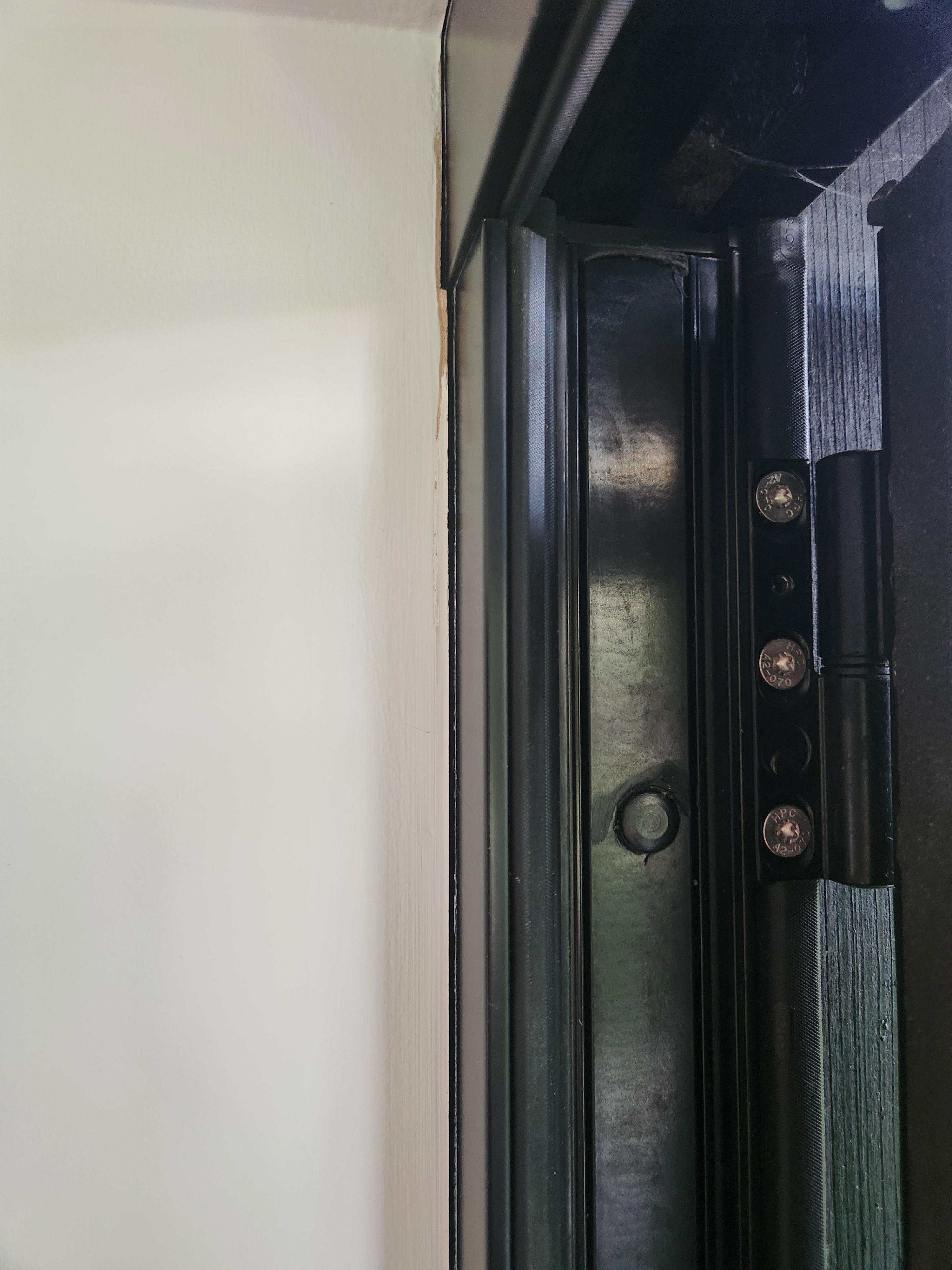

@Gus Potter I'll have a go with your suggestions on checking plumb. I can see from the fact that the door has moved away slightly from the plaster that there must be some degree of stress on the door, but not sure if this is normal or not. I can only see this on one of the doors mind. The other seems okay (the one that is plumb).

Sorry not read whole thread, but can see the steel lintel, have you plans to mitigate the cold bridge that will cause?

Your second photo shows the top hinge set high. This would encourage me to inspect to see if the vertical part of the door frame (the jamb) is twisting. I can't see how wide a cavity you have but the chances are that the vertical part of the door frame is not properly fixed to the inner leaf of the wall above the hinge.
Commonly folk think that the head of the frame stops the jambs from twisting.. the load from the hinge is eccentric to the jamb section. If you see how these are fixed together (the head to the jamb) by few screws this is not the case that the head of the frame prevents twisting via the joint. When you open the door look to see if the door jamb is twisting relative to the head. It's going to be hard to see. First thing to do is to keep the door shut. Get up on a ladder and put your finger over the joint. Get someone else to open the door and see if you can feel / see any movement in the joint between the jamb and the head.
Use the previous principle to verify what you feel as you crack open the door.
@JohnMo This was one of those things I tried to get a clear answer for from the architect, BC and the window fitters. For me I cannot see how its possible to solve that problem since the steel above goes from the outside to the inside. Per the architects drawings I wrapped the uprights in uber expensive space therm (the white in the pic) -- but honestly have no idea since it is air gapped from everything anyway so seemed complete waste of money -- I was going to put spacetherm on the top steel as well but when speaking to the fitters the doors were at least 20mm short of the top and they just filled it all with expanding foam, which I guess kind of addresses the contact between the window frames and the steel (at the expense of frame strength I would assume) but since that top steel goes all the way from inside to out I wasn't sure how to solve it. I've used 37.5mm insulated plasterboard across the top on the inside but really not if that helps of hinders.
