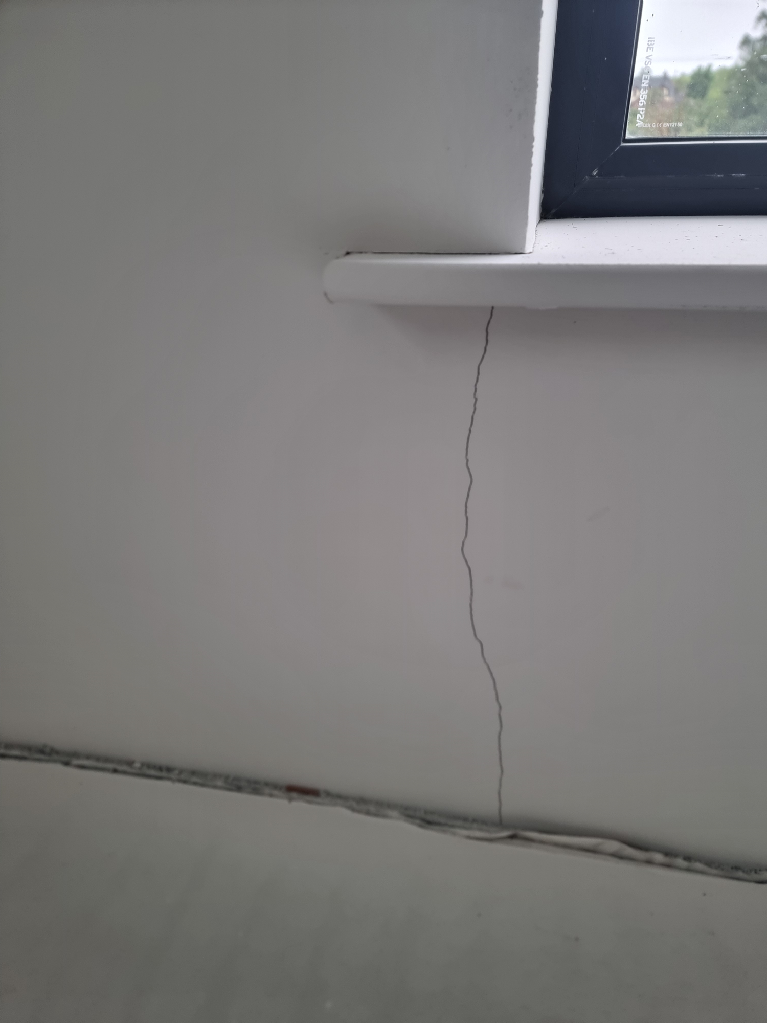

Mr Blobby Posted June 21 Posted June 21 All my window openings are like this. Would mesh have reduced the risk of this happening, or is it just inevitable?
Super_Paulie Posted June 21 Posted June 21 Definitely not normal. If it's plasterboard then the joins should be away from any edges but that's what it looks like for me. When I first plasterboarded my front room I just stopped the board at the "easiest point" and guess what, cracked at all these places a year later. Maybe that's what's happened? For what is worth, since then I've cut my boards to keep away from any edges and it's been rock solid.
Mr Punter Posted June 21 Posted June 21 No someone has messed up. Using mesh internally would be unusual.
Mr Blobby Posted June 21 Author Posted June 21 Sorry, forgot to say it's wet plaster, on mortar scratch coat. No plasterboard.
Mr Blobby Posted June 22 Author Posted June 22 3 hours ago, Russell griffiths said: Thermalite blocks by any chance ? No, dense block. Approx 10 mm mortar under the skim coat. Plastered over the winter, internal temps never went below 10 degrees. Dried out very slowly, no excess heat or dehumidifiers. Took a few months for the cracks to develop, but are not along mortar lines, and given the house is on a Kore slab on hard rock underneath then I don't think this is any subsidence issue.
Mr Punter Posted June 22 Posted June 22 So when you say all the openings are the same, do they all have a crack running down from the bottom left / right edge to the floor? Nothing at the top? Ground and first floor?
Mr Blobby Posted July 24 Author Posted July 24 On 22/06/2026 at 12:32, Mr Punter said: So when you say all the openings are the same, do they all have a crack running down from the bottom left / right edge to the floor? Nothing at the top? Ground and first floor? First floor, underneath windows at front (SW) side are the worst. Diagonally down from corners. Tops of most doors the same. Diagonally upwards.
Mr Punter Posted July 24 Posted July 24 Bed joint reinforcement (the train track stuff) above and below the openings may have helped. I have only specified it on rendered walls or brickwork feature panels like stack bond. Mesh in the render also helps. You best option now is filler.
Oz07 Posted July 24 Posted July 24 2 hours ago, Mr Punter said: Bed joint reinforcement (the train track stuff) above and below the openings may have helped. I have only specified it on rendered walls or brickwork feature panels like stack bond. Mesh in the render also helps. You best option now is filler. Do people really mesh internally? Id be interested to know if blockwork or plaster cracked. Can you hack some off below skirting line?
Mr Punter Posted July 24 Posted July 24 48 minutes ago, Oz07 said: Do people really mesh internally? Not me. I would spec it on external render though. 1
Conor Posted July 27 Posted July 27 Don't do any filling now, give it a year to let any drying/ movement/expansion/contraction finish off. And when you do, rake out any narrow cracks with edge of a paint scraper before filling.
