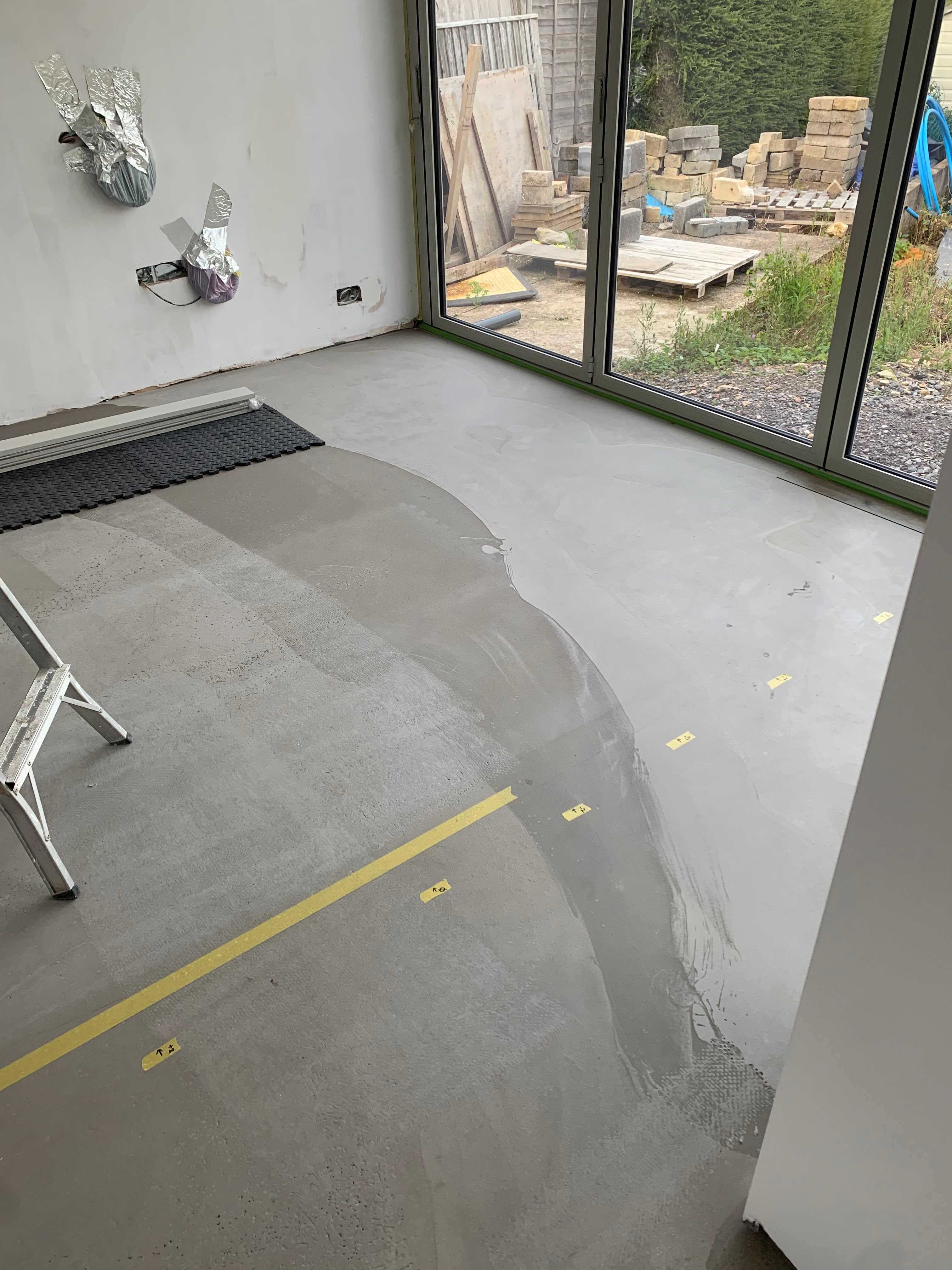

So my last lot of floor levelling compound was put down 27 days ago and has been left to go off and dry naturally in that time. All be it chunks of the floor have had floor mats and kitchen parts all over them for a couple of weeks of that. Kitchen now sitting on legs awaiting parts.
Floor makeup - 120mm concrete slab with heating pipes around midpoint, approx 25mm to 5mm of levelling compound on top in 2 coats, top coat between 15mm and 3mm.
Time to run some heat through the slab, but it is June.
Unheated the surface of the levelling compound is around 24 today anyway - using my heat gun.
(Presumably temp is lower deeper within the slab ?)
I have turned down the flow temp to Min - probably about 25C ? ? - and just turned on the underfloor heating.
Advice please on how long to run it and how to increment the water temperature over the days to come ?
(LVT to be laid in 26 days time)

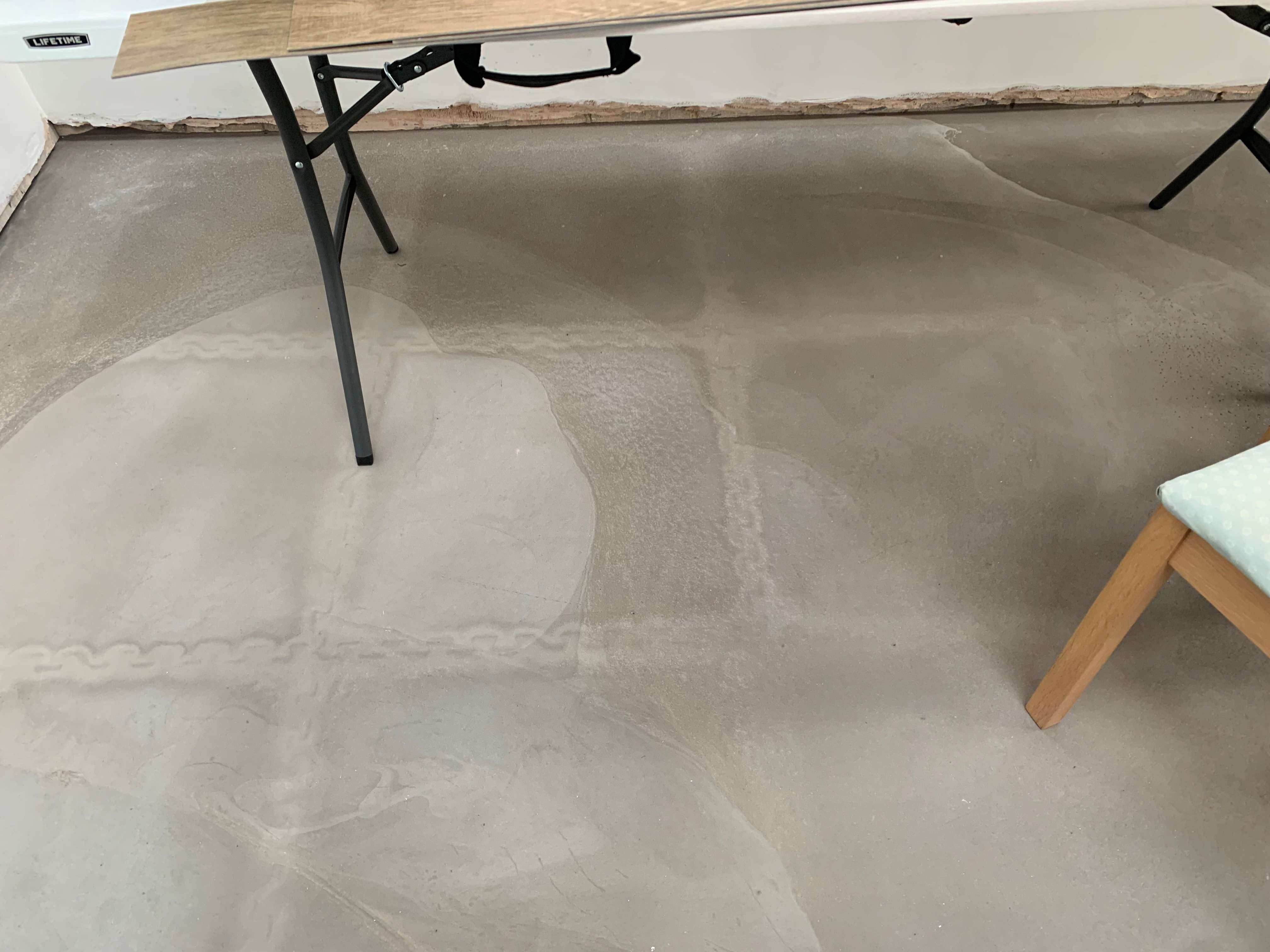

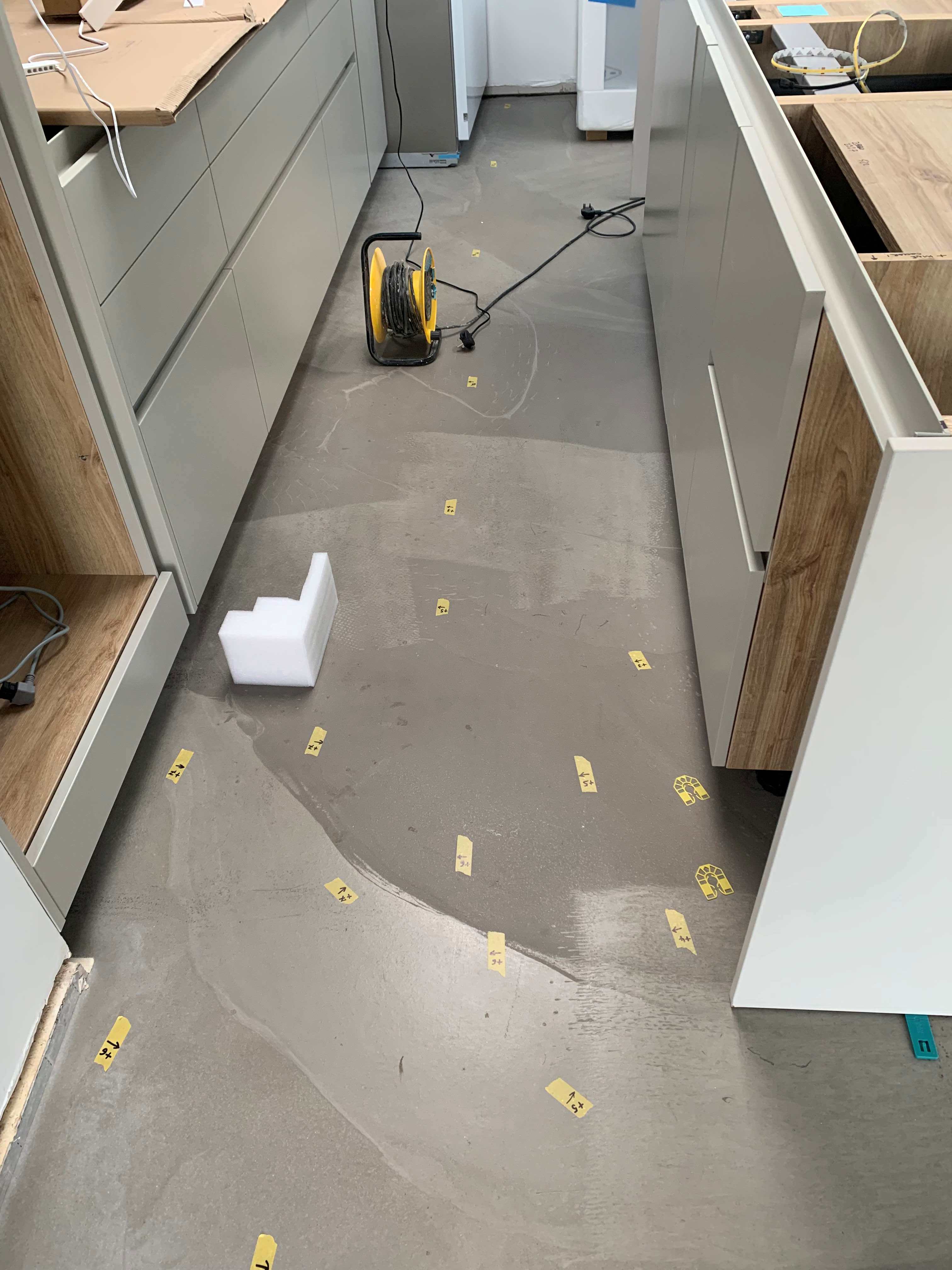

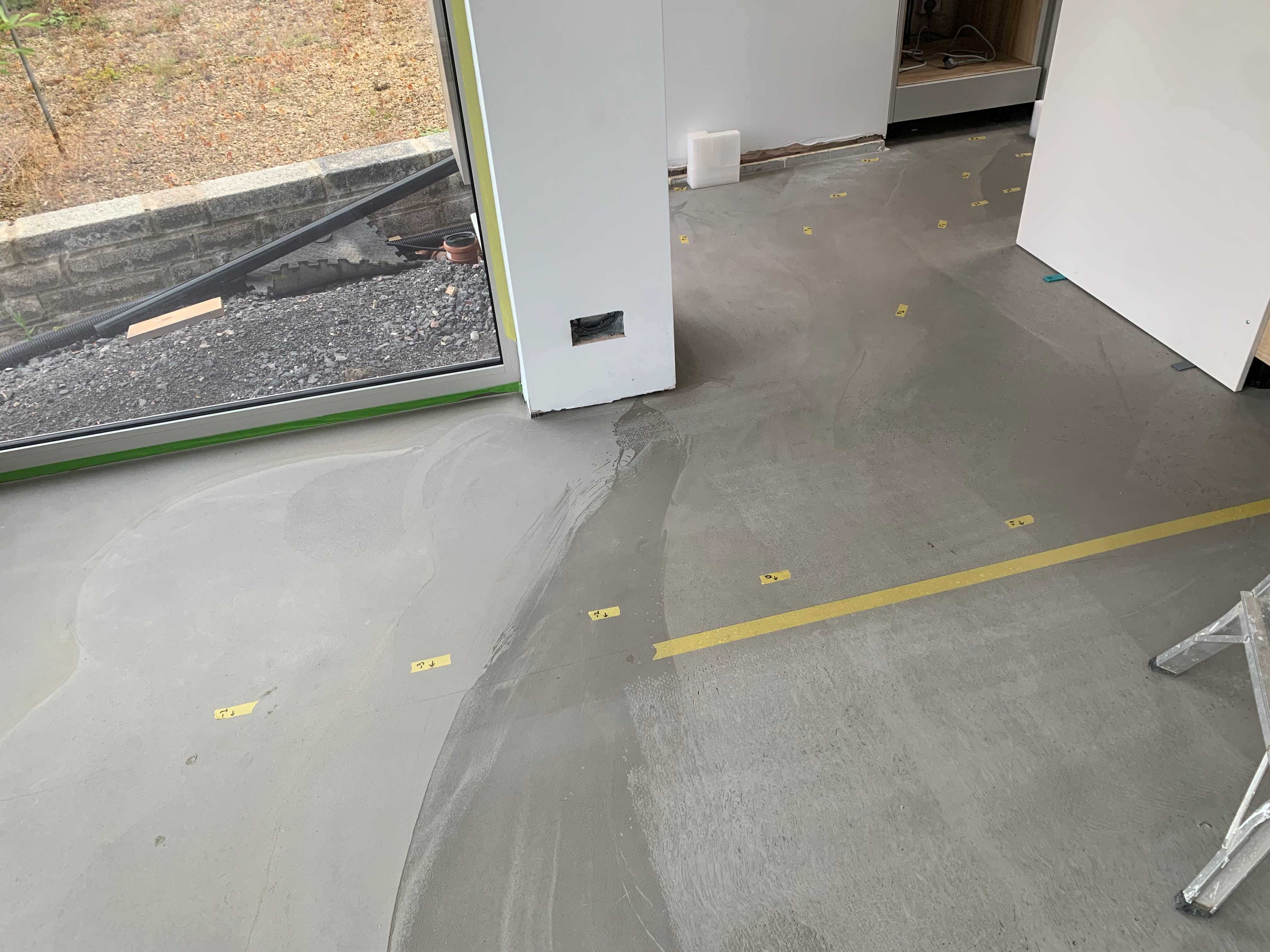

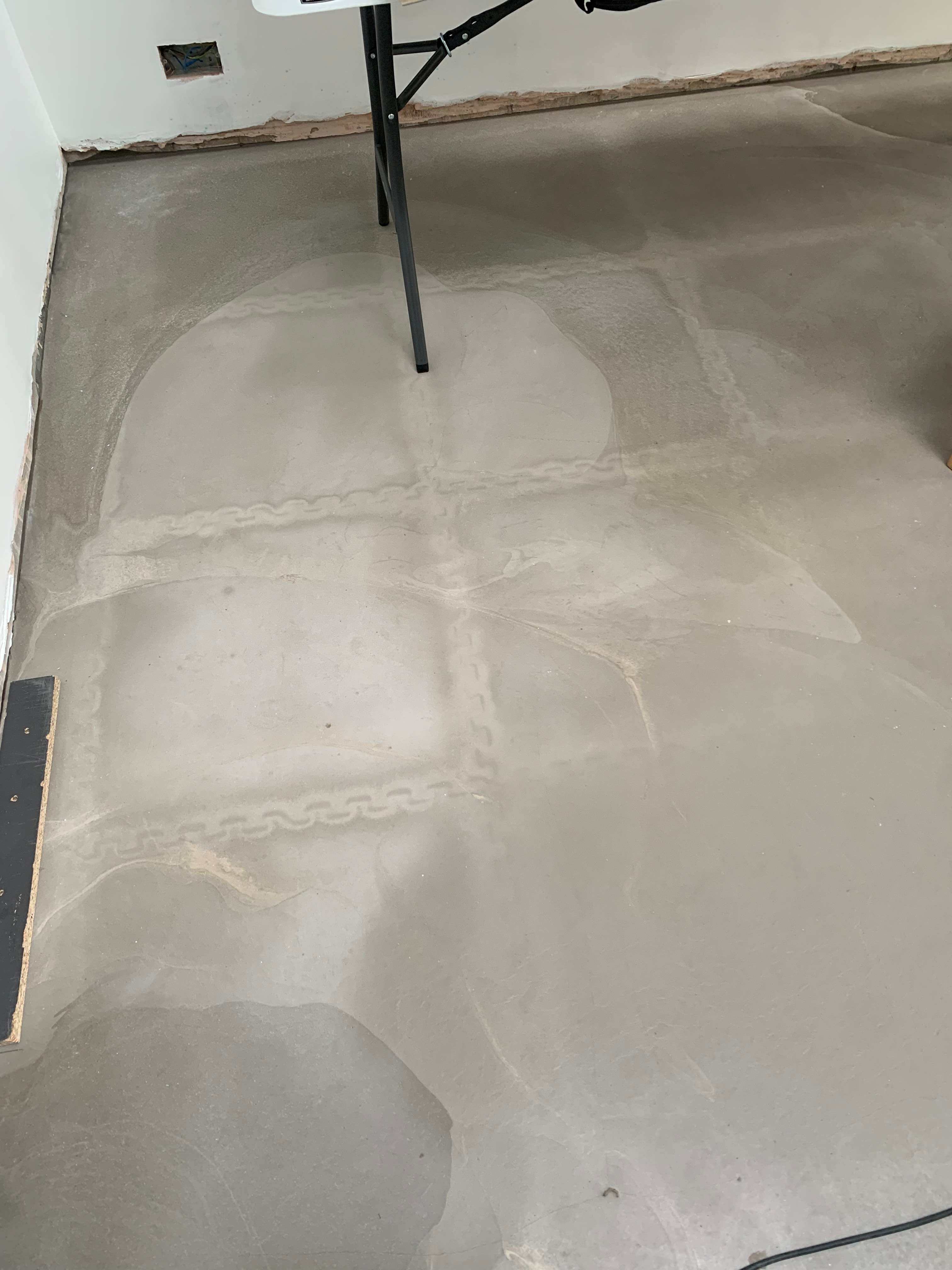

Have tweaked up the mixer a little, but if using my heat gun on the pipes at the manifold is anything to go by I seem to have an input flow at around 25C and a return flow at around 24C. The actual surface temperature of the floor is around 23C (though did open the door for a bit earlier). So I guess not much appears to be happening because that is all close to the same temperature - very gentle heating if anything at all.
Meanwhile there is no visible change at the surface. I have some marks/surface colour differences where I had mats down on top of the floor during the kitchen install. Lighter colour at the joins where presumably some moisture could escape between the mats. See photos...
Should I actually be expecting the whole floor to turn to the same colour ? It has had pronounced colour variations by pour since it was levelled.

The hardening is mostly chemistry, not drying.
Changes in colour are normal too, depending on water content, being laid straight or worked extensively, thickness, and any objects or joints below.

However what bugs me most is that you can clearly see the pattern in the surface colour in the first two photos from the floor mats and their joins. You would think this would be due to greater drying out where the mat joins were. Therefore removing the mats would see these areas gradually dry to the same colour.
The surface of the floor has been at 24-25C for periods because that has been the ambient temperature, and the doors have been opened to create air flow over the surface. In fact when sunlight somes through the rooflights or bifolds the sunlit floor surface temp gets up to 30/31C.
What the temperature is lower down in the slab I have no way of knowing.
What I don't want is to turn the u/floor heating on at 45C when winter comes, producing a floor surface temp of 26C, but driving moisture out of the floor leveller causing cracking and ruining an LVT floor. That could be £10k and more down the drain and a ruined room.

There will be hardly any free moisture in the screed unless you allow the room to be damp.
To prove this, lay polythene down and see if any moisture appears on the underside after a few hours or on a warm day.
Keep the windows and doors open during the day when it is warm and dry outside.  If you have a dehumidifier, close doors and windows and run it at night.
