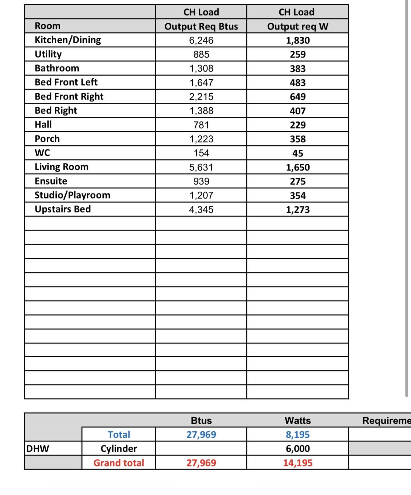

Thanks for all the help. Clearly have a lot of homework to do! I was hoping the plumbing company would help with this. Here’s the heat calcs they’ve run but I’m not sure they have factored in the efficiency of the build and other aspects such as MVHR. Im not sure where to start in terms of doing calcs myself so any help really appreciated.
ps. Location is Guernsey so no extremes in temperature.
By the looks of that, you really do need to find yourself someone else to do the work. You don't add DHW cylinder demand to a system with a heat pump as it's priority hot water - the heat pump switches from doing heating to doing hot water, so even if your house needed 8kW for heating, which I seriously doubt, this would be fine for your hot water. How big are your kitchen/dining, living & upstairs bed? They must be massive.
You can go and use my tool at https://openheatloss.com to create your own heat loss and system design. This is supported by a number of videos at https://youtube.com/@OpenHeatLoss taking you through how to use the tool and what to input - the video library is developing day-to-day
@Simon, beat me to it with the cylinder comments.
For context on heat demand, NE Scotland total are 234m², with bed and living space at 192m² @-9 3.5kW. Not Passivhaus.
So unless you are huge your heat loss calcs are way off.
