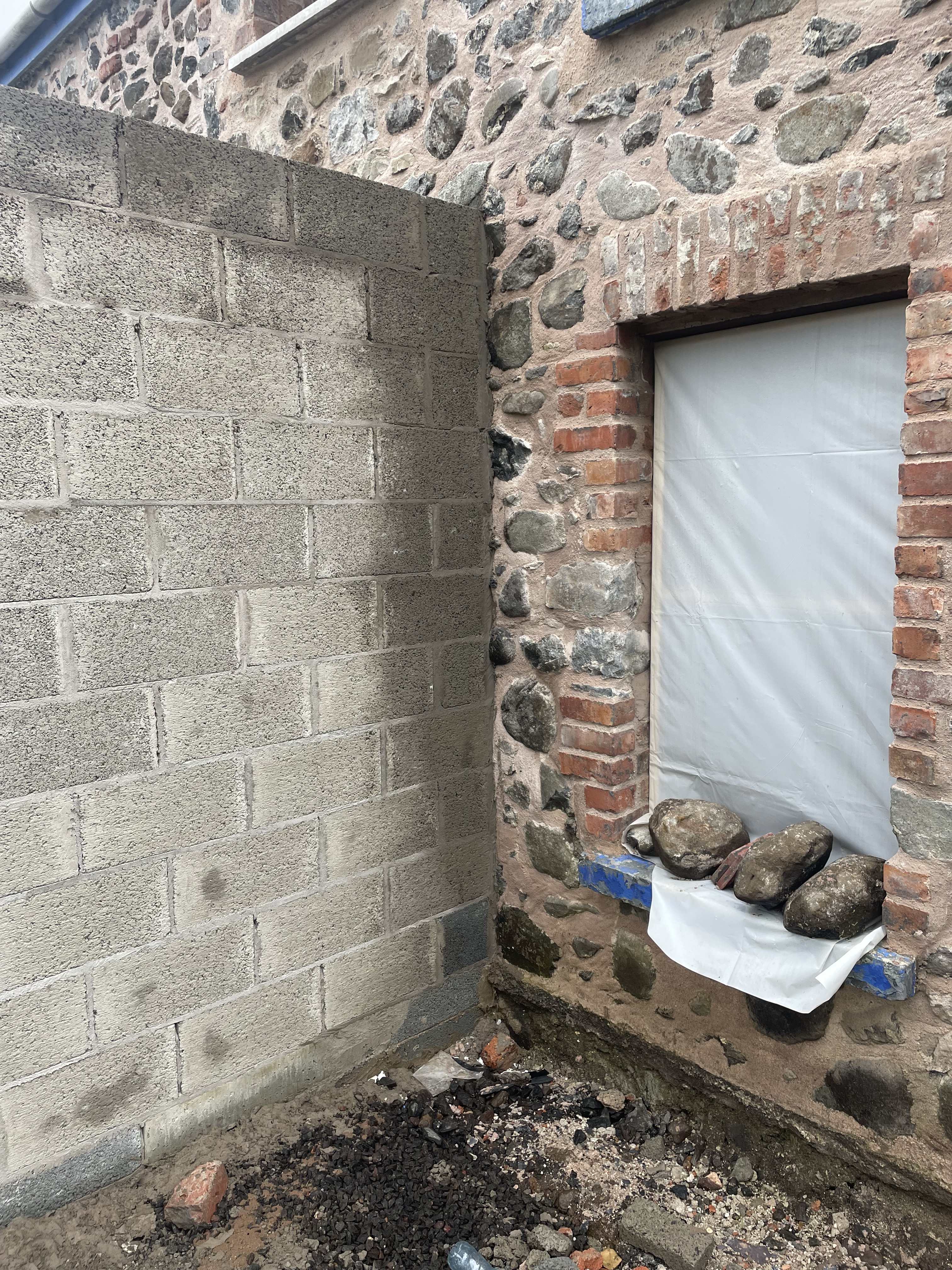

Hi,
My builder has just used cement to fill the join between the two walls. The cavity block wall and the stone, rubble and lime mortar wall. I can see the damp penetrating the blockwork but the lime mortar wall dries well as it should.
Can someone advise what I should expect for this area of the construction? I can’t see this as being acceptable. Photo provided.IMG_0520.thumb.jpeg.fcac4c3ab693eebdf26cd608816814e5.jpeg
Why is it damp?
how else is it going to be constructed? once the block wall is weathertight what is the issue?
On 25/05/2026 at 12:21, jfb said:
Why is it damp?
Hi,
I’m led to believe that a vertical DPC would normally be used between a cavity wall and the original building’s wall. I think the damp is leaching from the stone wall with lime mortar into the block wall. Ther’s not a lot of definitive information readily available.
Thanks,
Robert
On the inner leaf of the new wall - if you want something to show your builder then LABC publish renovation guidance that covers this including a diagram on page 14...
