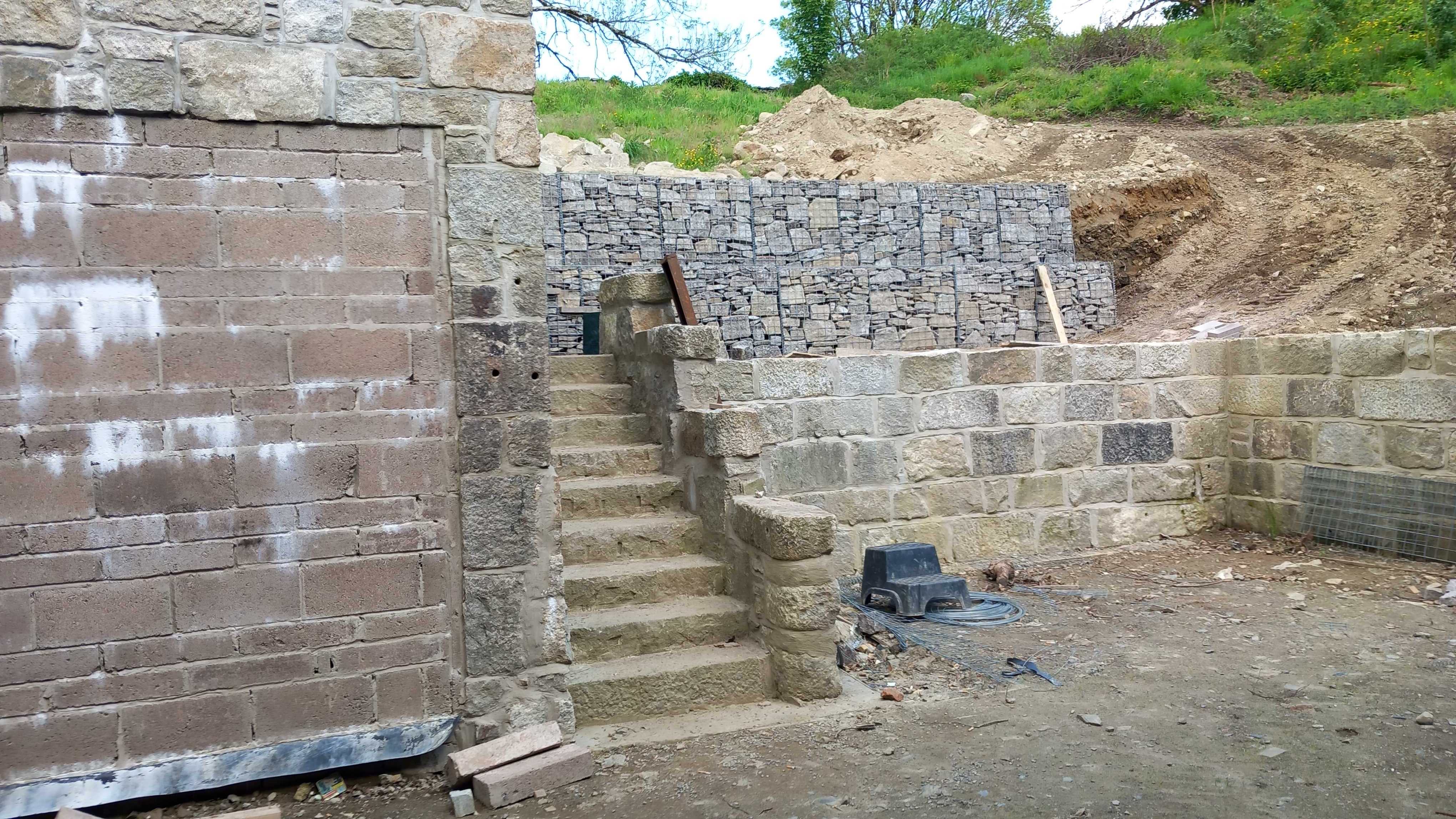

We've got a 3m high gabion wall going up behind the house. Gabion designer has specified:
"Wavin or similar perforated coil drain 100 Ø mm"
Struggling to find Wavin products anywhere (rebranded as Osma?)
Any brand recommendations from here? Unconvinced by stock at the local builders merchants. Naylor / Brett Martin have come up online... any thoughts appreciated.
Aren't gabions free draining - isn't that one the points of a gabion? I would ask your designer what the perforated pipe brings to the party?
Maybe this is to drain the water away which runs to the bottom of the gabion. Any manufacturer's perf drainage pipe will do.
that will be because over time the back of the gabion could get cloggedwith silt -so he wants a drain at bottom to carry it away
Isusepect any make of perforated land drai nwill do - make sure you surround it with pea gravel so it odes not clog
a 3m retaing wall could hold a lot of water andturn into slurry which would take your wall away --that why he wants a seperate drain to stop this happening
 could also be the type of ground you are in
do you have a concrete found for the gabion ?
when i did mine ihad about 12" of rock rubble behind the gabion for the first m from the base to stop this happening
Ialos have mine filledwith uppergabionrear.thumb.jpg.5c4d08d34dacb166f086428ad833ca8d.jpguppergabionrear.thumb.jpg.5c4d08d34dacb166f086428ad833ca8d.jpggranite wste from the quarry  -my ground is very free draining
