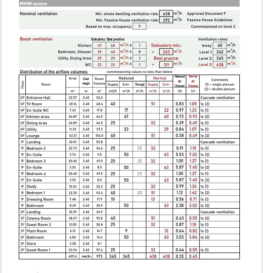

1 or 2 mvhr units?
So, PaulHeat have calculated as below, I think that means we need a unit(s) to do 438 m3/hr max.
They suggest either 2 x zehender 450 or 1 x 600 - I'm not sure why if we need 438m3/hr, we can't have 1 x 450, is it to do with the l/s do you think?
Anyway, if we need one or other of those options any opinions on 1 or 2 units? (We may go for the Ventaxia units but undecided, same Q re 1 or 2 units though)
Initially I thought is it easier to have 2 units so that we have less logistical issues ducting from 2nd floor plant room to gf (we could put the 2nd unit in the utility room on the gf) but, I'm not sure if that's reason enough to buy 2 units!
Any thoughts?

You're flow rate is determined via building regs, however you will most likely to reduce through put to meet passivhaus standards, otherwise a big house equals very low humidity levels.
1 or 2 units, I did two for ease of duct routes and reduced duct length. So location is in very different places for best routes of duct. But you have twice the maintenance bill. So a balance for you to make.
Because if you run MVHR flat out the noise can be intrusive. Ideally run it at no more than 2/3 capacity, but maximum ¾ capacity.

We were told we needed two units but I pushed back as I didn’t want to pay for two units and to pay to install two units and to maintain 2 units with filter changes etc. So the M&E company calculated that if we upped the duct size to 92mm we could use one Zehnder 600 which is what we did and I have no complaints at all.
I never fit lesser than 92mm. Always great results tbh.
The Brink 600 out-performs the Z'r and is less money ;) Just fitted one, last week, and about to fit a 2x 600 install in a weeks time.
