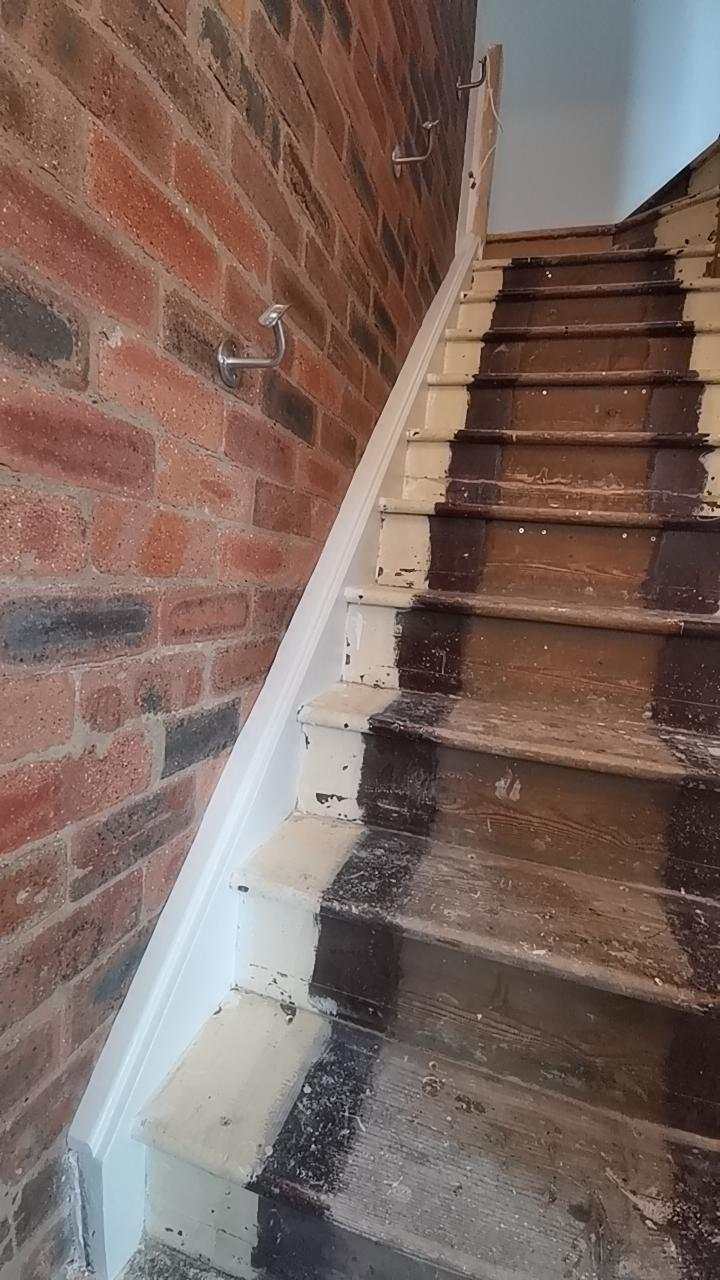

I used Leyland Eggshell on my MDF skirts downstairs, applied with a brush then a roller over the top to smooth it out, pretty good but it was 3 coats over the factory applied primer before i was happy.
However. I recently used Zinnser BIN on my stair stringers and found it great stuff, applied with a foam roller. I havent top coated yet as im still in and out doing work but quite frankly it could pass a a top coat, looks amazin. 2 coats of that and it turned my 1930s turd-brown stringers totally white. I will likely go over it with the leyland eggshell when im ready. See attached stringer and scribed cover in Zinsser BIN.
