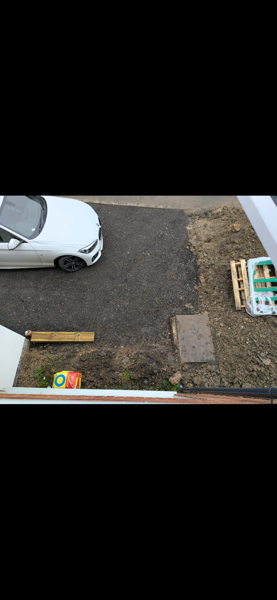

I've used recycled tarmac on my 100spm drive ready to be block paved
Hi everyone, I am now on my second set of contractors for my drive as the first ones turned out to be clueless and I wasn't happy with the time it was taking or the advice.
I'm doing 100 sqm of block paved driveway - new guys have come in done a few days setting out but are now saying they aren't happy laying on top of 150 mil recycled tarmac, this is all I could get hold of a couple months ago following how wet it had been and it was recommended so I went with it, after looking into it it doesn't seem the best sub base and I'm not sure you can use it, would I be better off getting a digger back in scraping it back and adding a 50 mil type 1 layer on top? As it stands at the minute it's 90 mil from the required level and it's been whacked, blocks are 60 mil so I guess they were going to do a sand screed of 30 mil, can anyone advise me what's best to do I don't want to spend all this money and the drive sinks in 6 months.
Listen to the advice of the new contractors as they will then be liable for longevity etc. If you ignore them then you’d be blamed for any failures.
Short cuts take 3 times longer and are always 3 times the cost. Remove the U/S sub base and get it all replaced with type 1, and install ACO drains to manage storm water.
Recycled tarmac is great as long as it is a coarse mix, and not only fine stuff from toppings and footpaths.
Many people don't realise that it is nearly all stone and sand, and the black stuff just glues it together. (5% or so if I recall)
If you ask the contractor why it is not acceptable it would be interesting to hear.
If well crushed, (not in big lumps) then well laid it can be better than type 1.
It's 150mm thick and you have presumably whacked it or rolled it. It will never get that load again.
The problem i see  is with 30mm sand.
That is very thick and will be affected by rain and weeds. Also, with block paving, you can get very local point loading. 30mm sand tends to suggest you need it to adjust to a good plane surface could you use less?
Test the surface by driving back and forward many times. Does it show any settlement?
Now jack up the car so you have half a ton on a small area. OK?
Worst case? If it ever settles locally then blocks can be reset.
I've even used it under a factory slab taking very large loads. No problem.
Do the circumstances require it to be a permeable sub-base? If so I am not sure MOT will cut the mustard (others on here know more than I).  I used between 200 and 400 c40mm crushed limestone, membrane, and finer limestone (but not sand or MOT) as a bedding layer.

They've never worked with them and were saying when they drove off it after it has been whacked it showed movement I believe.

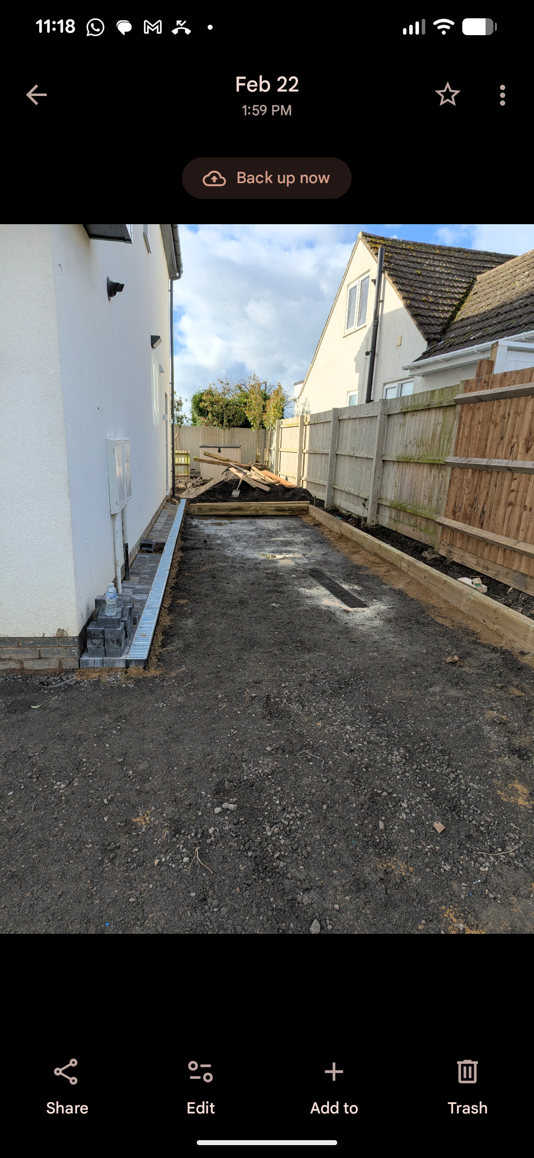

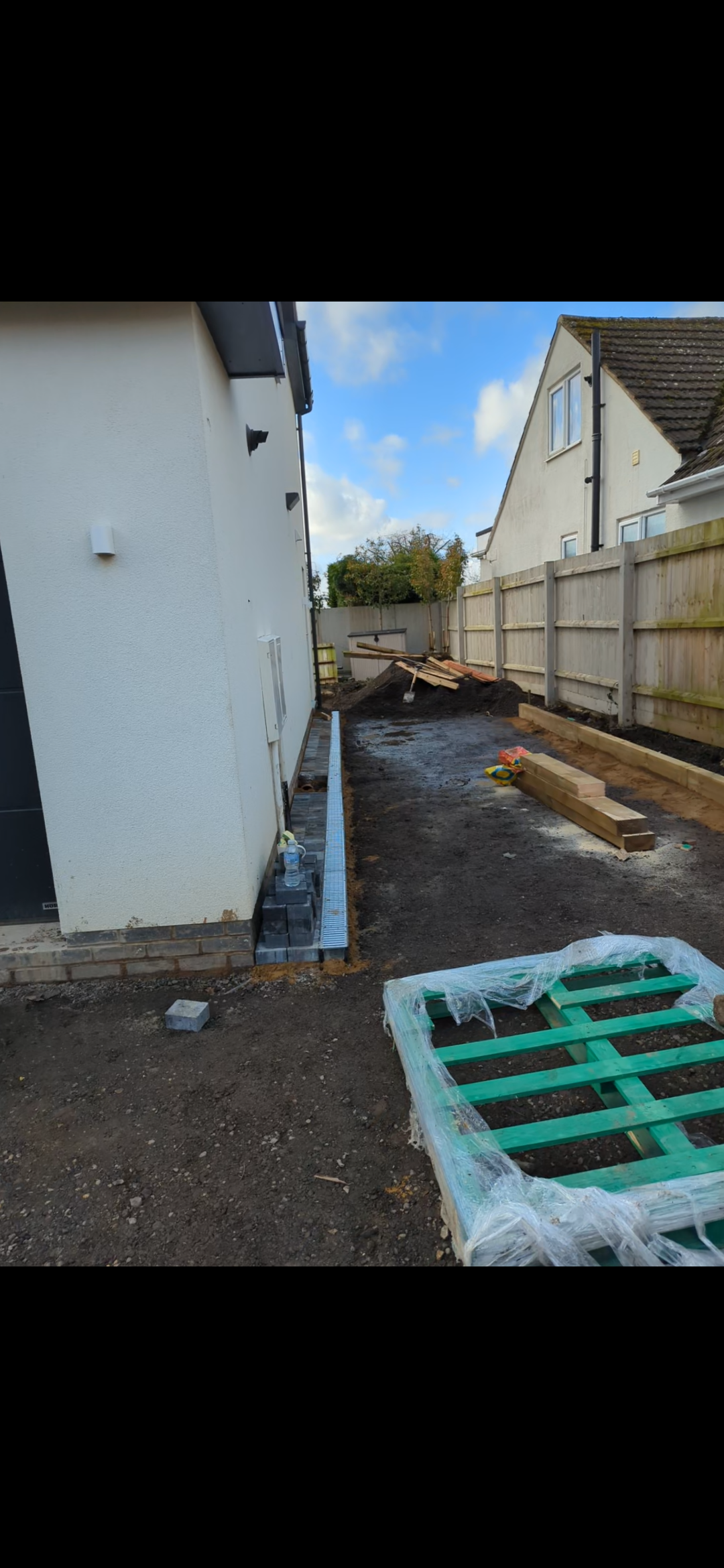

Yeah sorry the drive way on the side is relatively flat so they've put in an acco you can maybe see in the photo, on the front it all slopes into the road away from the house so no acco has been put in does this change anything?
Thanks everyone for their advice on this I'm scratching my head and pulling my hair out, to say Ive had enough would be an understatement so appreciate all the help!
Does anyone also know if you're better to roll a driveway so that it's the heaviest object that's ever going to go on there as opposed to a tiny whacker plate? Or does this not matter, Someone also recommended using a geotex membrane?

Annoyingly no idea, it just came from the grab guys taking out the earth.
It's not the M1, and will be strong enough.
Block paving is flexible so you won't get cracking even if it moves a bit over decades.
A whacker is plenty.
Do drive over it many times. If it's going to compact , then do it now and the sand will level it off.
And now stop worrying.

The timber sleepers will rot out pretty quickly.  Your tarmac looks fine.  Go over the whole lot with 3 passes with a Wacker.  Make sure the bedding layer is an even thickness.
