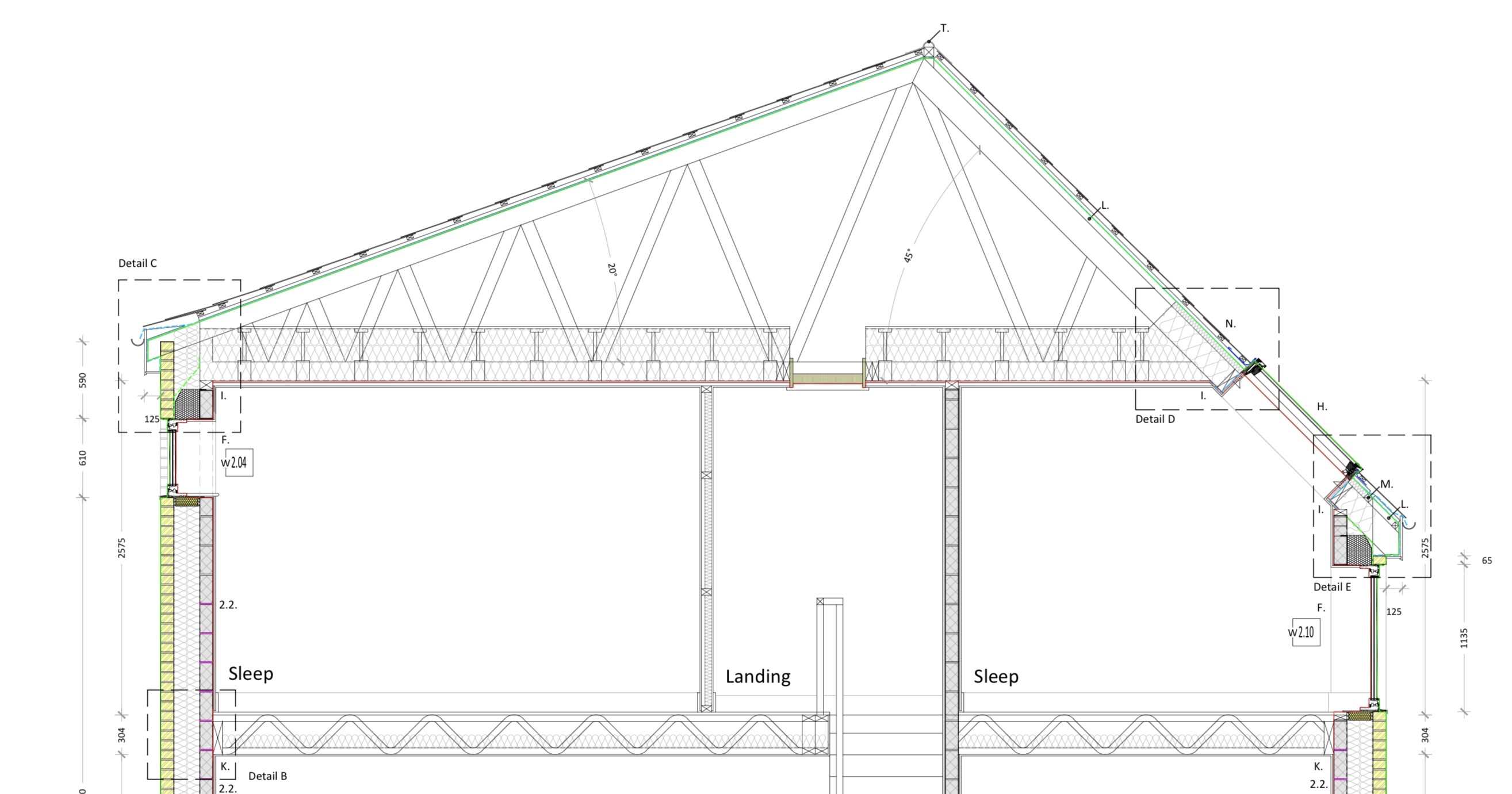

Any advice on materials for fascia’s & soffit’s?
We are trying to source good quality materials, that are fit for the task and will also have a long life.
At present we are considering 2mm aluminium fascia & soffits, fixed onto a marine ply sub-base (25mm fascia and 9mm soffit).
Builders merchants Marine ply is not always the best quality so what are the alternatives?
What about Accoya?
Is Accoya or other timber is good enough without aluminium sheet applied?
For information, planning to install Lindab Majestic (only 10 yr warranty) for the guttering & down pipes.
Many thanks.

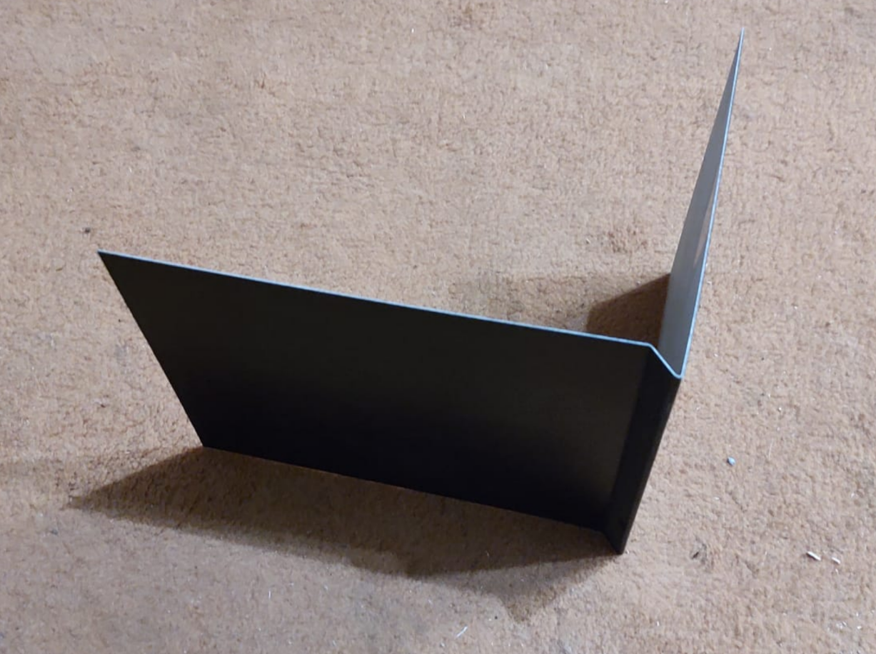

Posted
I used regular exterior ply with a custom single piece 2mm aluminium extrusion made by a local fabricator. The main reason was these should never need any maintenance in my lifetime
Regards
Tet
