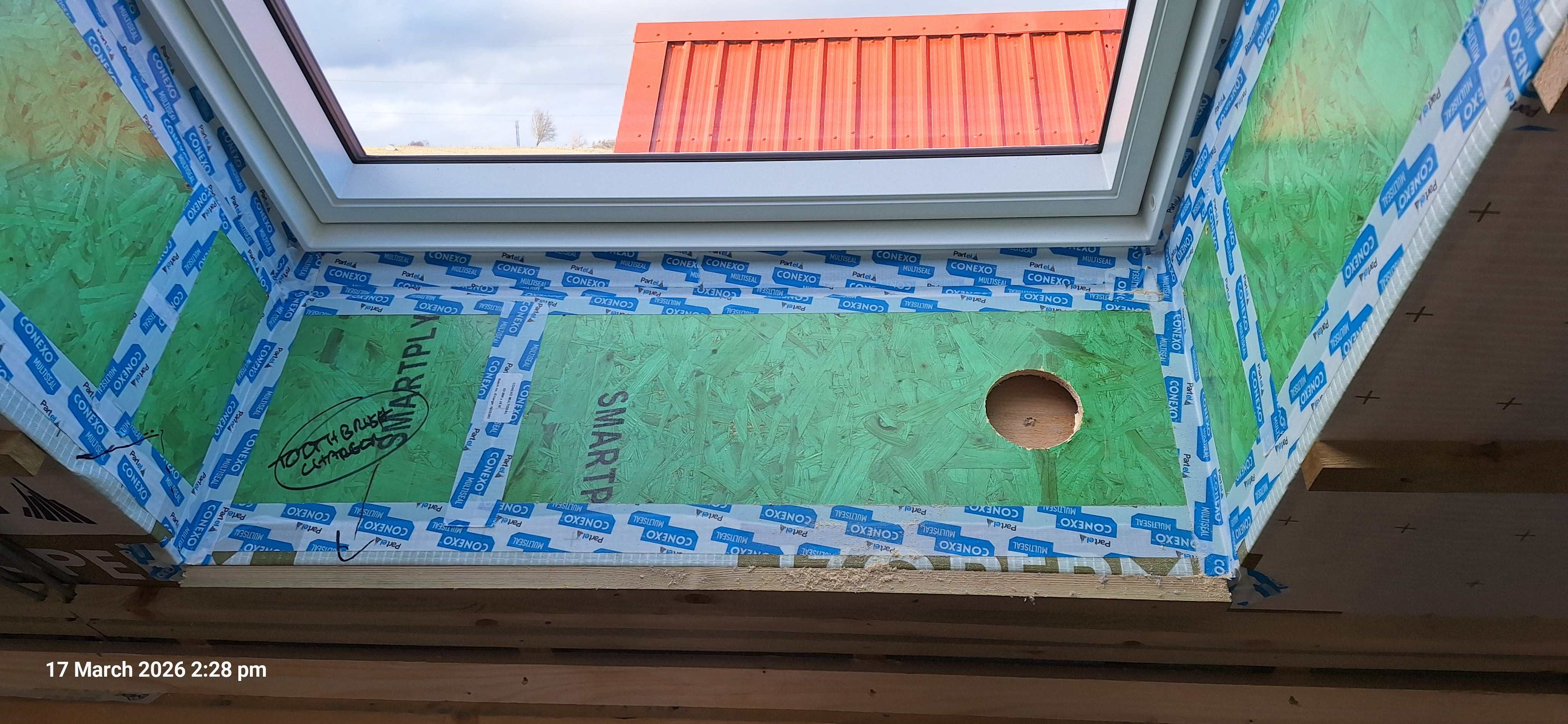

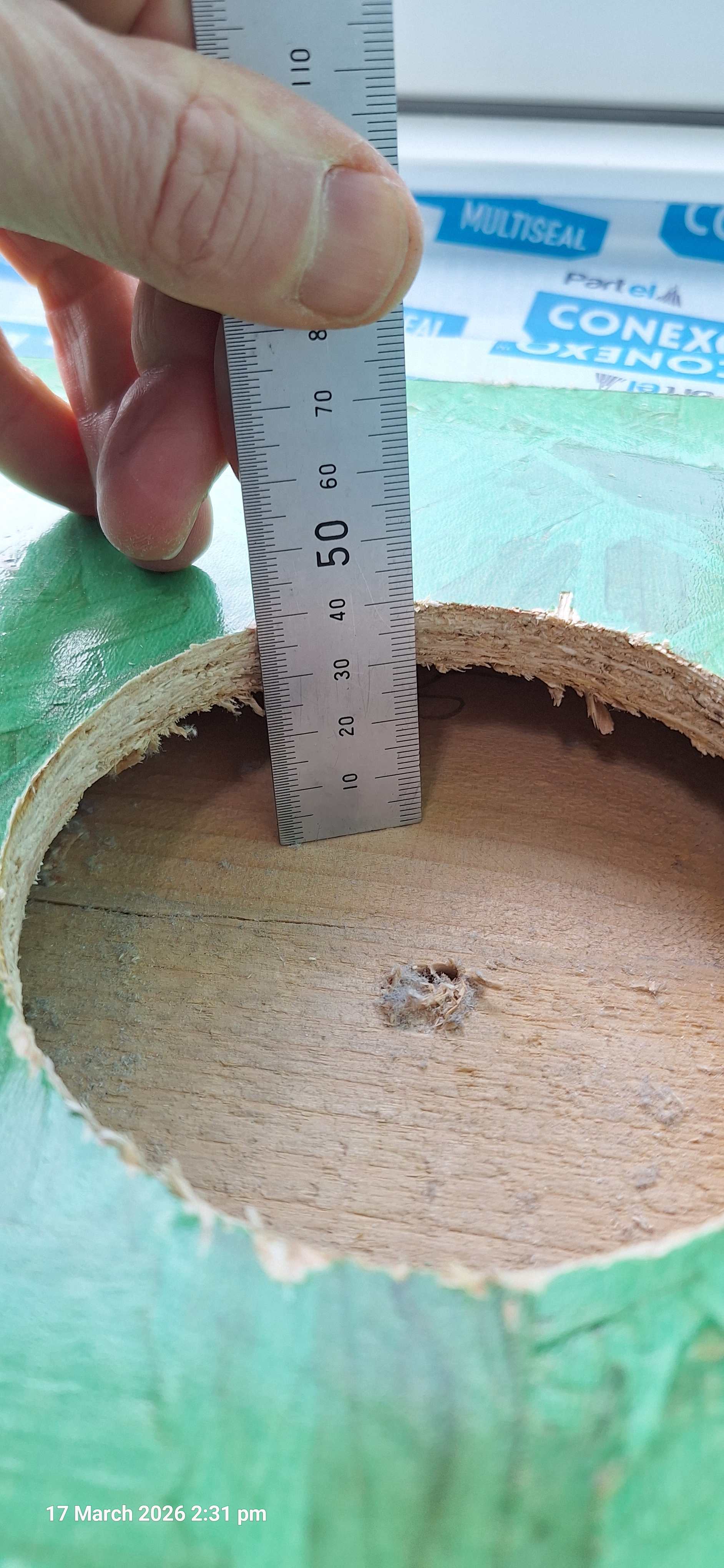

Dunc Posted 15 hours ago Posted 15 hours ago The cellulose insulation was pumped into pur larsen truss frame last week. The installer noted that at each velux window there is a small-ish gap between the head and foot trimmers and the airtightness board about 25mm. Not possible to pump cellulose into such a shallow void. There is insulation behind the trimmers, of course. The TF company have dismissed the gap as "too small to have any impact"...I'm disinclined to accept that when chasing marginal gains in Passive type builds this is a reasonable thing to ignore. Am I being unreasonable? If not, suggestions for a solution?
Eric Posted 15 hours ago Posted 15 hours ago (edited) Could you remove the airtight board and fit 25mm celotex? Roof colour looks nice 👍🏻 Edited 15 hours ago by Eric 1
Nickfromwales Posted 14 hours ago Posted 14 hours ago Drill a dozen 6mm holes and pump it full of "PIR in a can", eg Illbruck foam <20 mins per window, job done 3
Dunc Posted 12 hours ago Author Posted 12 hours ago Two good suggestions there, thank you! I take it you agree it's worth sorting, rather than ignoring. I guess the squirty foam might be easier. Getting the osb off, having already been thoroughly taped up would be difficult. The tape tends to rip the green layer off. Is all expanding foam equal? Not sure whether the expense of the illbruck airtightness foam is necessary, being on the outside of the airtight layer?
Nickfromwales Posted 11 hours ago Posted 11 hours ago 1 hour ago, Dunc said: Not sure whether the expense of the illbruck airtightness foam is necessary, being on the outside of the airtight layer? Erm....expense? A few £10's at most. It's a totally different foam, which will be void of honeycombing etc, so buy cheaper foam if you wish, but "seriously!?". 1
