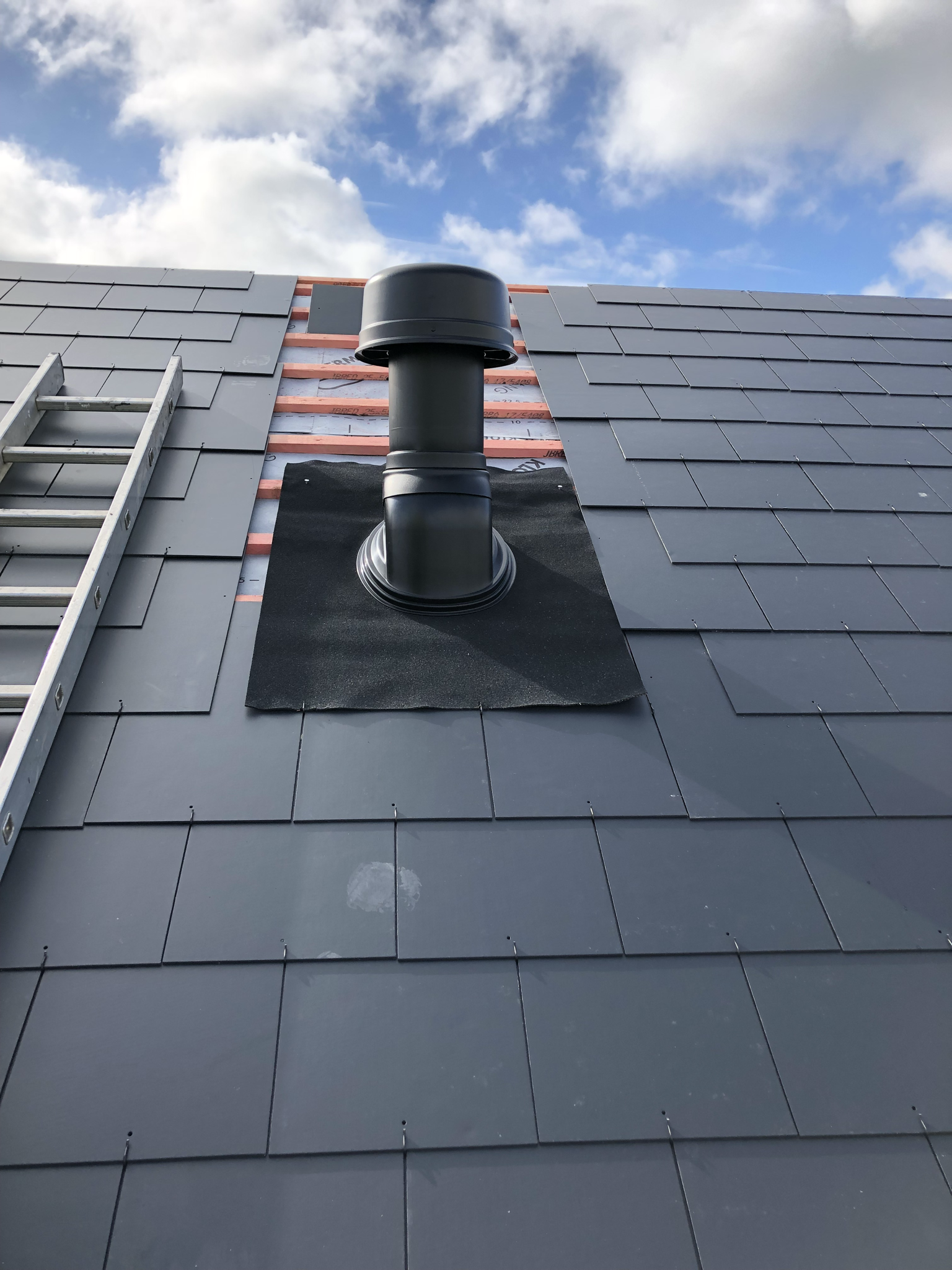

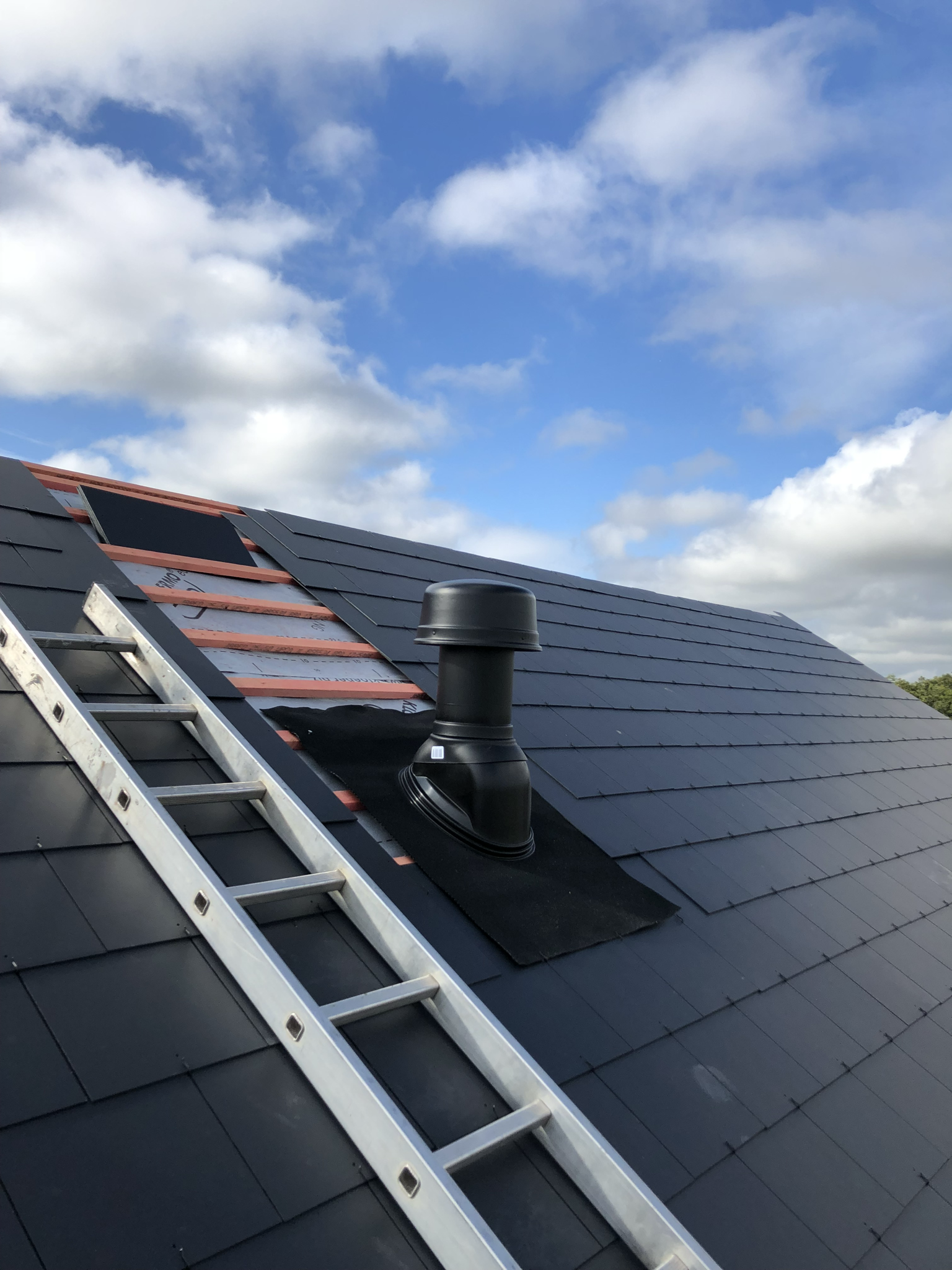

March 23Mar 23 On 21/03/2026 at 09:28, Alan Ambrose said: If the cowling could be installed last following the 2nd sleeve that would work. But that’s not how it’s designed. The sequence for installing the Ubbink ones is correct, as the rain falls down the outer edge it steps out (where the final part hits the make part of the flashing) to give a robust weathertight seal. This job is an MBC PH TF with 400mm roof void. I just extended the foam ducting before installing these, then made everything off inside the attic plant room below. Im not sure what your exact issue is, as I don’t assume you’ll need the MVHR running before your roof is finished? You just lift the terminal out of the flashing and then install it, and if you need weathertight for a few weeks or months (or years ) you just drop the terminal back in and mechanically fix it in place.

April 3Apr 3 9 hours ago, Alan Ambrose said: OK, for anyone else with the same problem, we: Post a photo of where you are are the moment.
