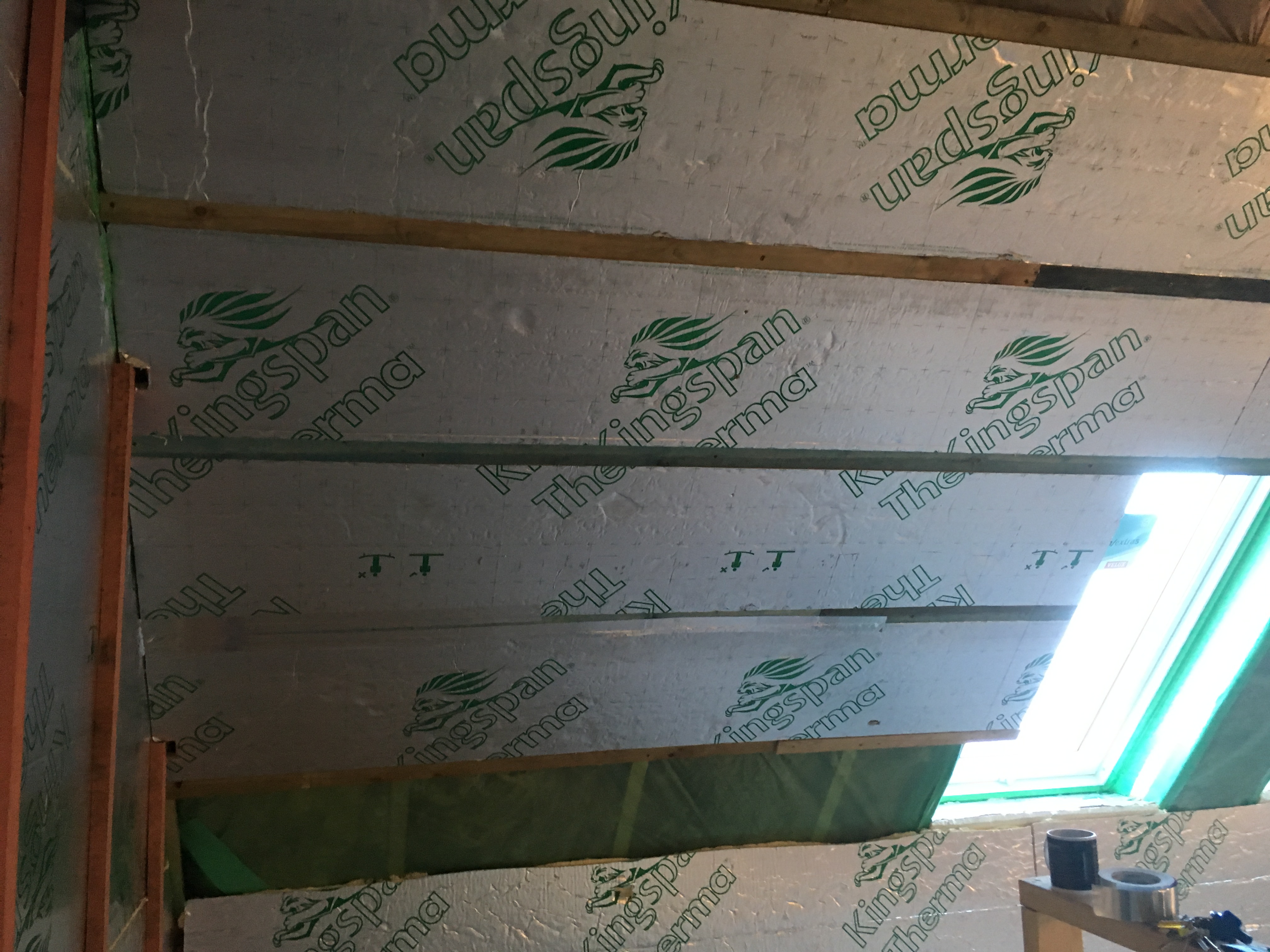

Pocster Posted January 28, 2018 Author Share Posted January 28, 2018 26 minutes ago, Ian said: @pocster Isn’t this the usual way of doing it: insulation between rafters and wall studs then continuous layer of PIR over the face then battens to create a wiring zone. So battons over the 'final' pir - plasterboard fixing to that? Link to comment Share on other sites More sharing options...
PeterW Posted January 28, 2018 Share Posted January 28, 2018 Just now, pocster said: So battons over the 'final' pir - plasterboard fixing to that? Yes unless you do what we did and go with board between the battens. You’re talking about a cold bridge 50mm square at best that is made up of 200mm of timber - it’s got about the same loss overall as one of your windows so don’t panic ..! Much easier to get a flat finish too. This then has 100mm foil tape over it to form the VCL. 2 Link to comment Share on other sites More sharing options...
