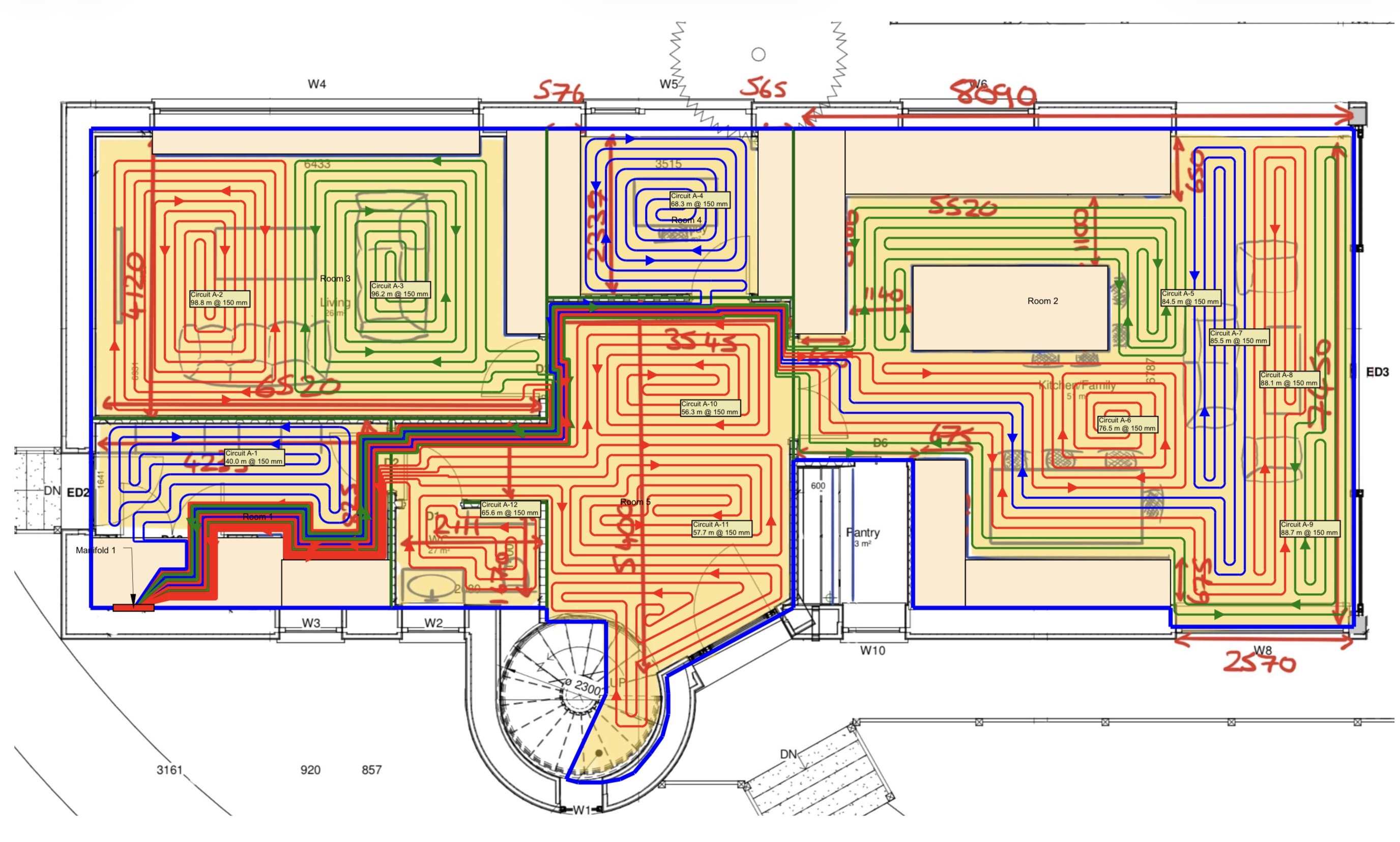

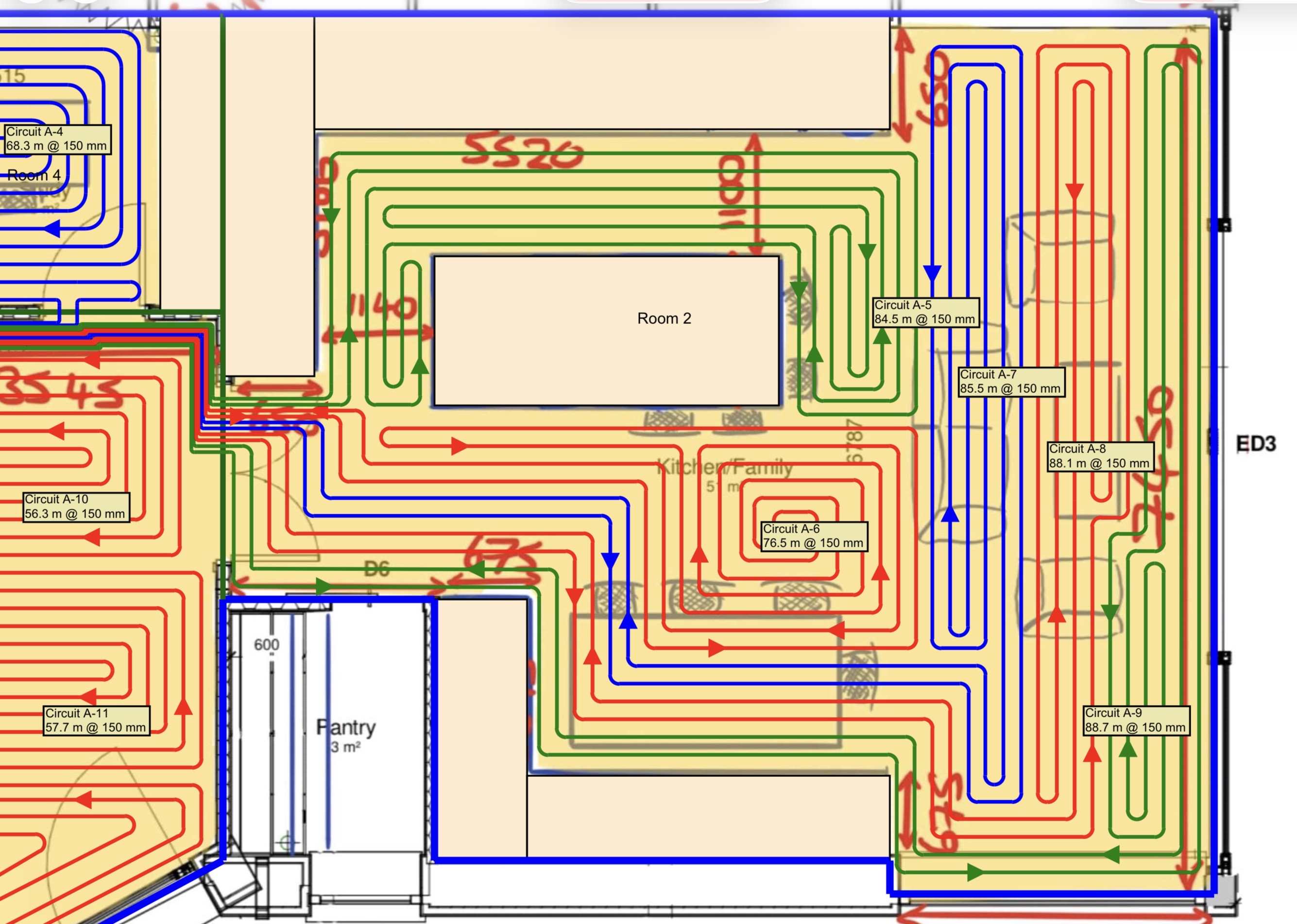

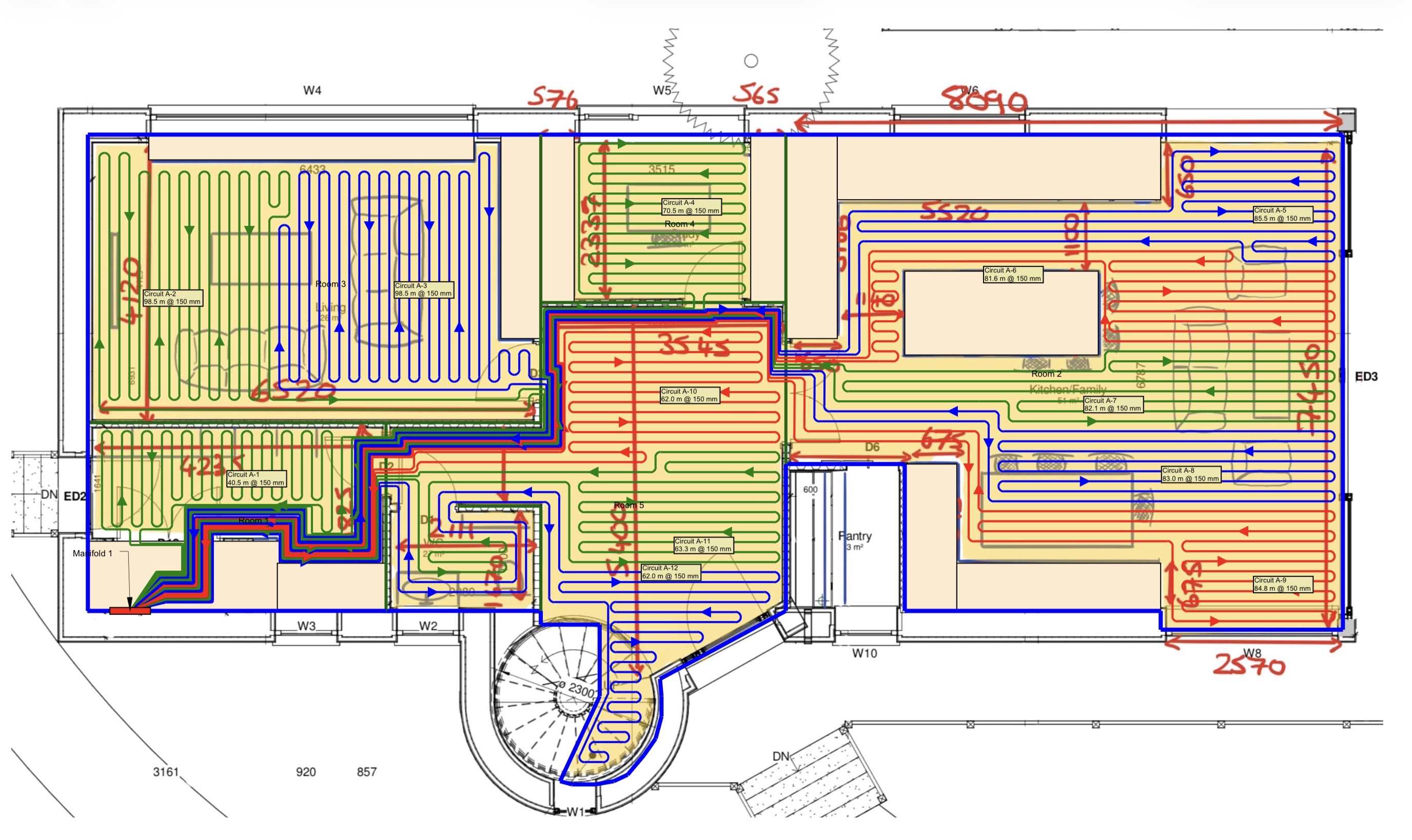

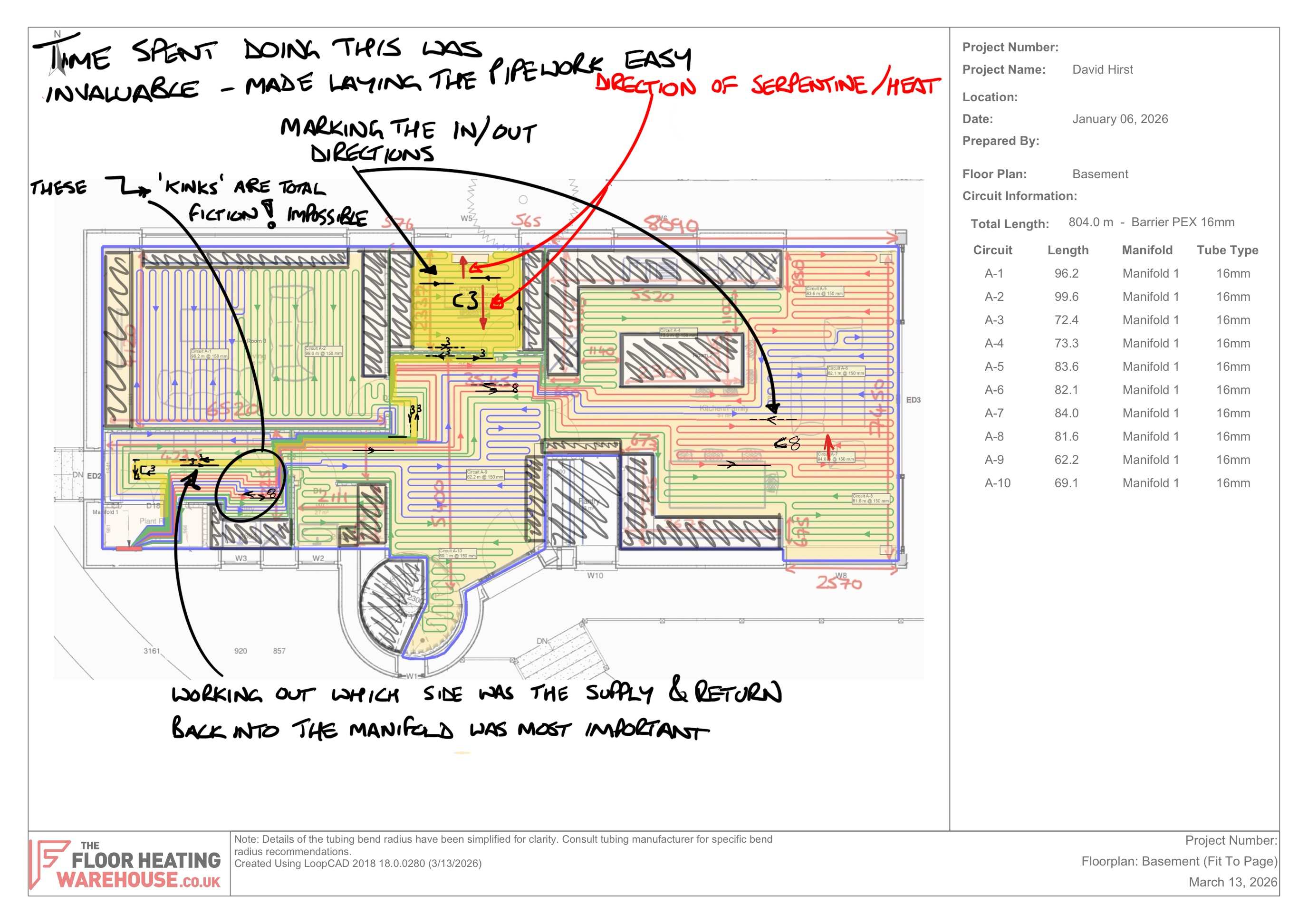

February 28Feb 28 Given the challenge of getting a UFH design done, now that we’ve (eventually) selected our UFH supplier, I thought I’d share the layout design they have provided. I had requested a spiral pattern and first time they sent over a serpentine design. I’m pleased I checked it as soon as it arrived as they they re-ran it and sent the spiral pattern, but I do like having both as a comparison. We will be installing the pipework and now that we have a design to look at I’m interested in hearing advice on how best to tackle (practically) the layout. I’m purchasing a UFH staple gun and decoiler for the pipe. I’ve got a couple of weeks before we start this. My initial thoughts are to mark out 150mm spacing across each room in both directions (partly to double-check the design), and lay the longest loops first. Spiral configuration that we’re installing: Close-up of the longest runs:

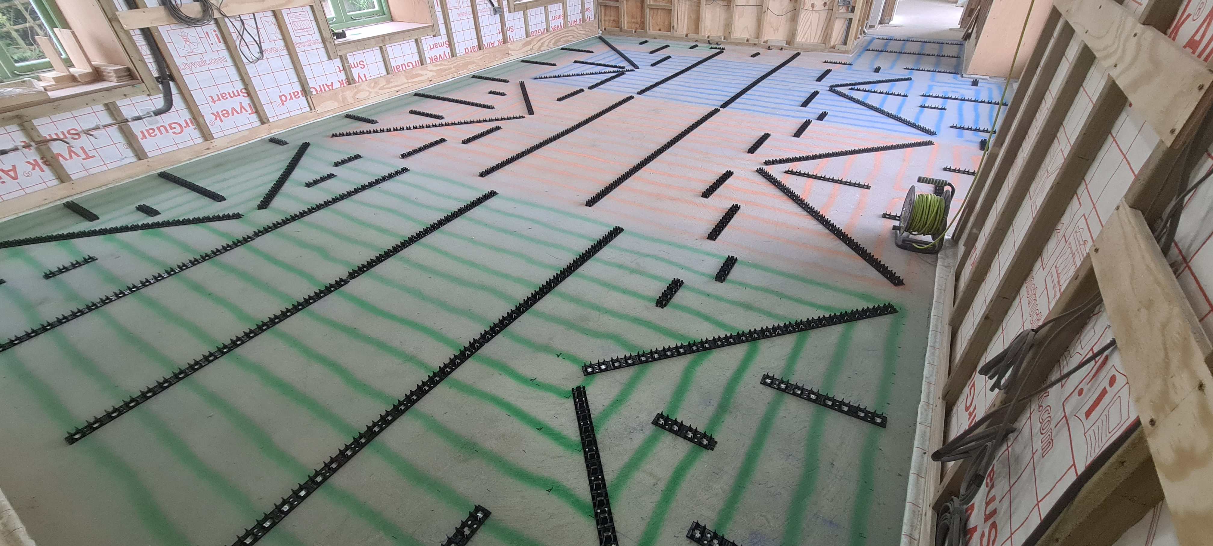

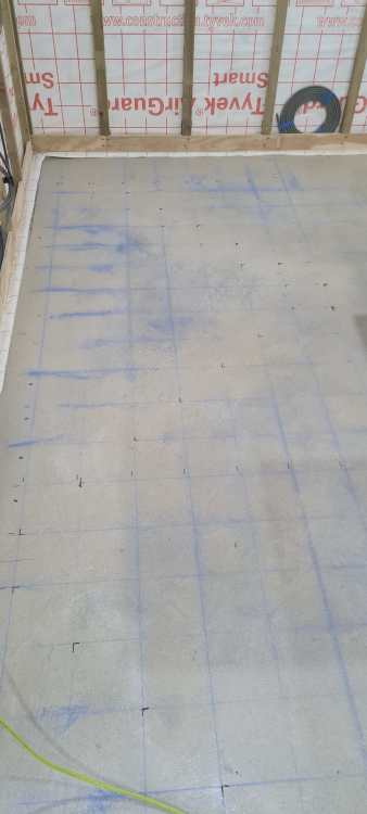

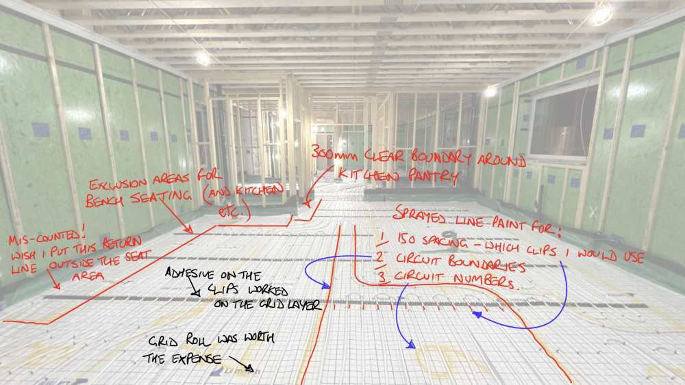

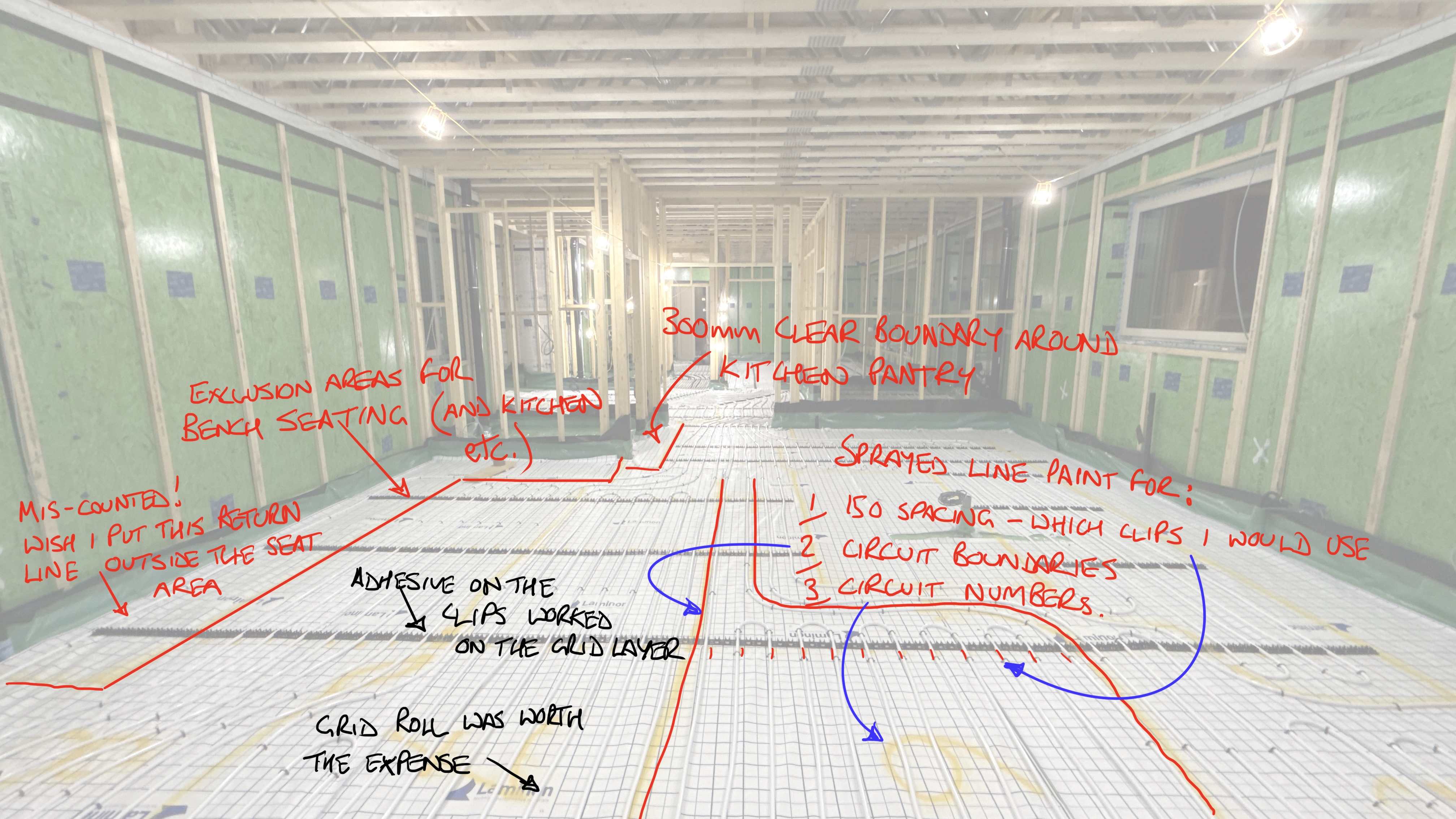

February 28Feb 28 I marked my perimeter at the required spacings, then ran a chalk line from mark to mark to create a web pattern. Next I took a permanent marker and followed the web around each room marking the turns of each loop. Once I was happy I had the correct layout according to the designs I took some line marker paint and drew each loop out over the challk line, turning ay each marker pen mark. Once everything was drawn out and I was happy, as I was fixing onto concrete I marked and fixed down the pipe clips and started laying the pipe out from the manifold starting with the furthest loop from the manifold 1st and working loop by loop back toward the manifold in each direction until all loops were fixed down.
February 28Feb 28 Author @Barnboy that is exceptionally helpful, especially with the photos added - very much appreciated. Chalk line ordered!
February 28Feb 28 Couple of comments - because I can't help myself. 1. You have all loops transiting via what I assume is a hallway, then an additional 3 loops dedicated to the hallway. Deleted the dedicated loops and spread the pipes transiting through halls to provide hall heating. 2. Low temp heating will perform just as well with either spiral or serpentine. 3. Design is done on the premise of zoned heating, using a thermostat to control each area. Bit like adding the largest radiator you can fit on a wall in each room. As it is the floor array isn't designed for room heat loss, so balancing the heating will be battle. 3. Your pantry wants to be cold, I would keep all pipes well away from there by at least 300mm. 4. Assume your manifold is in or close to the utility, with all the loops transiting through that area, it will always be hot in heating season, you do not need a dedicated loop there. You will also need to think about adding insulation to pipes to prevent overheating. So 9mm insulation for the first 2m of each loop or run in 20mm conduit to thermally disconnect from screed for the first couple of meters. 5. Drawing by something selling products, not heating design. It isn't a heating design.
February 28Feb 28 19 minutes ago, JohnMo said: It isn't a heating design. This. 1 hour ago, Great_scot_selfbuild said: My initial thoughts are to mark out 150mm There is a pattern here on buildhub that we see a constant stream of UFH systems all with 150mm space regardless of the house. So: - do you not have a heating engineer working with you to design the ufh as part of the whole heating system? - what has the supplier provided you in terms of design specification relating to floor output compared to heat load? - and have they also specified lots of room stats 1 hour ago, Great_scot_selfbuild said: Chalk line ordered! Get an inkline instead - clearer marking on all types of substrates plus you get water resistant ink too. That way you can use it to do your full markup. https://tftools.com/blogs/product-advise/inklines-versus-chalklines?_pos=2&_psq=inkli&_ss=e&_v=1.0

March 1Mar 1 8 minutes ago, Great_scot_selfbuild said: 3. Not sure I understand what you’re saying? (FYI the whole downstairs is single zone, and provides heating up through void in hallway for upstairs The person that put the UFH drawing together, has assumed you will be having a fully zoned system, so each space will have a thermostat including the hall. That is why they bunch all the pipes together when transitioning through an area. 11 minutes ago, Great_scot_selfbuild said: Manifold is in the utility, yes. This is the first I’ve had anyone mention insulating pipes, though it makes perfect sense - can you please elaborate? (Photo appreciated, to help me interpret what this looks like before screed is laid on top This where the design comes in not making pretty images. You need to understand the heat output and space heat demand. Areas like the utility can be overheated very easily with so many pipes going through area. You need the so called designer to factor this in to the design - LoopCad will do this for you automatically. LopCad is a free to download and a month or so free to use. A weekend messing with is will have a good design done.

March 1Mar 1 31 minutes ago, Great_scot_selfbuild said: Our ASHP supplier is working on the heating load requirements, and the UFH supplier providing the UFH design. I’ve asked for the additional design information beyond just the drawings, yes. Okay, from the design you posted up you have a classic situation of tail wagging the dog. The ufh you have isn't a heating design, it's a geometric exercise of fitting pipes of a certain spacing into a define space. The heat loads need to drive the design of the ufh, just like the heat loads would drive the sizing of a radiator or fan coil. Really, I would expect the ASHP supplier (should be designer and installer) to be taking the ufh off your hands and co-ordinating to make sure the ufh is suited to both the house and the ASHP.

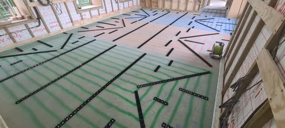

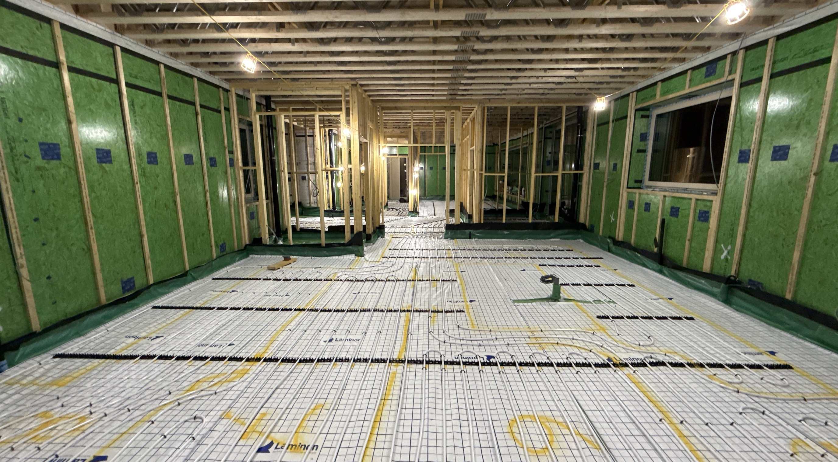

March 1Mar 1 On 28/02/2026 at 07:18, Barnboy said: I marked my perimeter at the required spacings, then ran a chalk line from mark to mark to create a web pattern. Next I took a permanent marker and followed the web around each room marking the turns of each loop. Once I was happy I had the correct layout according to the designs I took some line marker paint and drew each loop out over the challk line, turning ay each marker pen mark. Once everything was drawn out and I was happy, as I was fixing onto concrete I marked and fixed down the pipe clips and started laying the pipe out from the manifold starting with the furthest loop from the manifold 1st and working loop by loop back toward the manifold in each direction until all loops were fixed down. Great minds lol.....
March 1Mar 1 As above, the self adhesive clip rails are great. Lay them out, stick them down, then start laying your pipe, dead easy to get spacing set. You need a few staples on the bends.
March 1Mar 1 51 minutes ago, Conor said: As above, the self adhesive clip rails are great. Lay them out, stick them down, then start laying your pipe, dead easy to get spacing set. You need a few staples on the bends. I can't even imagine relying on the self adhesive to stay put during the pour. In the pic above, I gas nailed the feck out of each and every rail, and then went around with some P-clips where the pipe still refused to stay put.
March 1Mar 1 Author 10 hours ago, JohnMo said: The person that put the UFH drawing together, has assumed you will be having a fully zoned system They knew exactly what we planned to do and we gave a very clear requirement. I'm getting very used to this 'quality' of output from the suppliers / distributors etc. now though. Speaking to my builder, it's entirely 'normal' and he spends a large amount of time fixing design issues on site. 10 hours ago, JohnMo said: LopCad is a free to download and a month or so free to use Unfortunately it also only works on windows and I'm loathed to by a PC or try and set up a virtual machine on my Mac just for this; this was why I went with a supplier who would be paid to do the design (having provided them with all the necessary information). #sigh... 9 hours ago, SimonD said: Here is one that has a lot of experience and a good reputation, but I don't know their fees. Might be worth a call for @Great_scot_selfbuild: https://robberridge.co.uk/self-build.php Is this a personal recommendation of this one, or has it turned up on a search (just wanting to make sure I understand before I look around). Thanks for the nudge. 5 hours ago, Nickfromwales said: The biggest benefit of using the membrane with dry screed is to have markers to use to lay the pipe to This is a good enough reason for me I think

March 1Mar 1 4 hours ago, Great_scot_selfbuild said: Speaking to my builder, it's entirely 'normal' and he spends a large amount of time fixing design issues on site. This is what pays my bills. So few people get this properly aligned before breaking ground. 4 hours ago, Great_scot_selfbuild said: This is a good enough reason for me I think Grab this with both hands, it's just so much less stress. Watch the in's and out's, as most fill the space with pipe and forget it has to get back to the manifold somewhere.

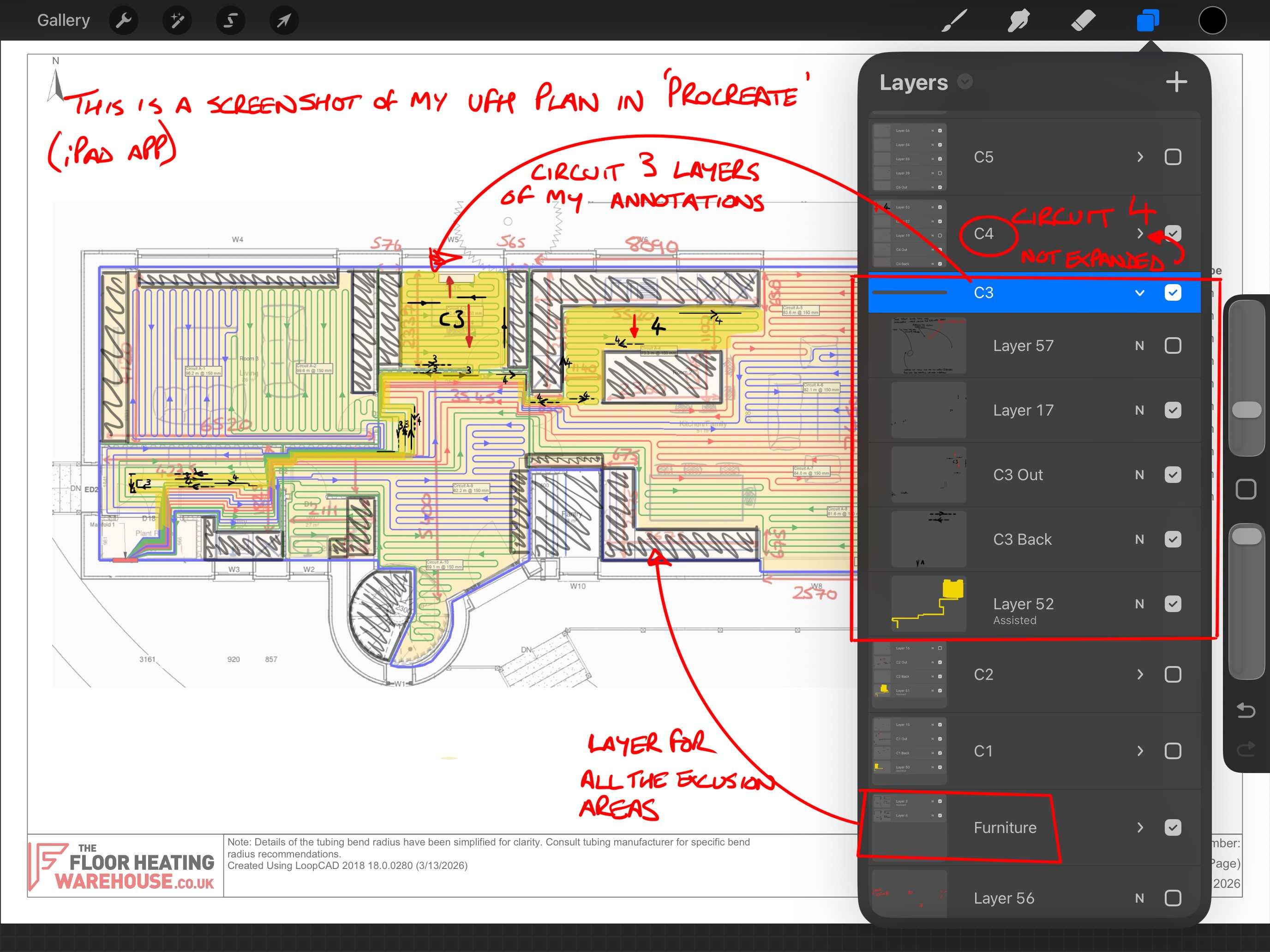

August 27Aug 27 Author Update: This was the final design layout we went for, and the installation was much better than I anticipated. Very happy with how the cable laydown went, and the BH stapler tool was excellent. I borrowed a decoiler from a friend - absolutely essential; subsequently found that this is also available as a loan tool on the hub, but I’d have happily bought one if I needed to. One useful tip was placing the decoiler as far as practical away from where I was laying the pipe - if it is too close then the pipe is less workable around the corners, it was really easy once I had a long length fed off the coil. I used Procreate to help annotate and plan out the detail circuit by circuit, as getting the plan from the UFH supplier is all very well, but you then need to count the individual lines and work out which clips you’re actually going to use. I’ve scribbled some notes on the following photos. The time spent marking up drawings and then spraying the grid and which clips we would use was well worth it, because once the pipework starts being uncoiled there can be a lot of distractions. A clearer image of the pipework What the app looks like with the layers panel open
