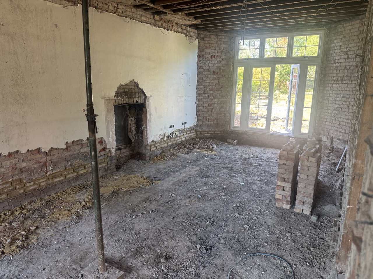

I'm refurbishing the floors on my Edwardian house. I've removed the old timber suspended floor and looking to put in an insulated floor with UFH. I have about a 350mm-400mm void and ideally don't want to dig to far below this. The original slate DPC is about 150mm below floor level.
I have two options and wanted to validate what works:
Option 1: Foam glass aggregate (bottom up):
250mm Foam Glass aggregate compacted
75mm Sand Cement Screed (with UFH)
Total build up 325mm
I'm considering option 1 because of the level of the DPC being below floor level and bridging it with any other options - but maybe i'm overthinking it?
Option 2:
100mm Compacted Hardcore
DPM lapped to wall and above screed
200mm EPS
Total build up 375mm
Option 2 does it work without a concrete layer and is the hardcore enough? There are some posts on here that suggest concrete isn't required and the hardcore might be enough? Also what about the fact that the DPC might be bridged in this setup?
Any advice and thoughts on these options will be appreciated!

Option 1 may need a DPM.  You normally put a thin sand layer over hardcore to cover the sharp bits before you lay the DPM.  Is foam glass expensive?

I would want a concrete slab of some sort I think. Ground moves and stones will follow it.
50 to 100 stone base with 10 to 25mm sand blinding  ( the lesser  if you can get the stone really flat and smooth)
polythene
100mm concrete, maybe with steel mesh.
150mm PIR insulation with polythene over and pipes fixed to the surface
50mm screed
PIR is a lot better U value I think.
Due to diminishing returns, using foamglass instead of stone under the concrete is excessive.
That's  360 to 425 but I'd want to know more.
Maybe you can increase the insulation.
You can likely dig some more ground out but that's a different question.

Option 1 is the way to go for old building with solid walls. RFG acts as a capillary break and also acts as hardcore and yes will need to be compacted.
You have to wrap the RFG in a geotextile membrane.
Have a look at Mike Wye and Unity Lime for drawings and detail.
Out of interest you have mentioned 250mm RFG depth- is this to achieve a certain U-Value or something else.
Of quoted figures for RGP depth is about 175-200mm.
The depth of 250mm is because i have to make up around 325mm-350mm ground to get to sub floor level. Using 250mm seems like a good way to this and bump up the ground insulation. I think we're now pretty set on going the foam glass route because it also seems simpler build wise.

Option 2 will work, just add a sharp sand blinding layer over the compacted hardcore and use that to level the ground, plus also protect the DPM.
8 hours ago, amin said:
@Night Owl I've seen some documentation where they suggest that 75mm is fine see https://mikewye.co.uk/wp-content/uploads/2014/09/GEOCELL-Brochure-UK-Sep-16.pdf
@Nickfromwales Does option 2 work without a concrete layer? I'm trying to optimise buildup as much as possible so that I don't have to dig whilst also putting in materials that don't wick moisture up.
You will be putting the DPM in underneath the insulation, so anything above that won’t be in direct contact with damp / moist ground, so just go with 200mm insulation.
You should be using PIR vs EPS at <250mm btw, as EPS is a poorer performing product. You’d be fine with 50mm EPS at the bottom and 150mm PIR, if on a shoestring.
