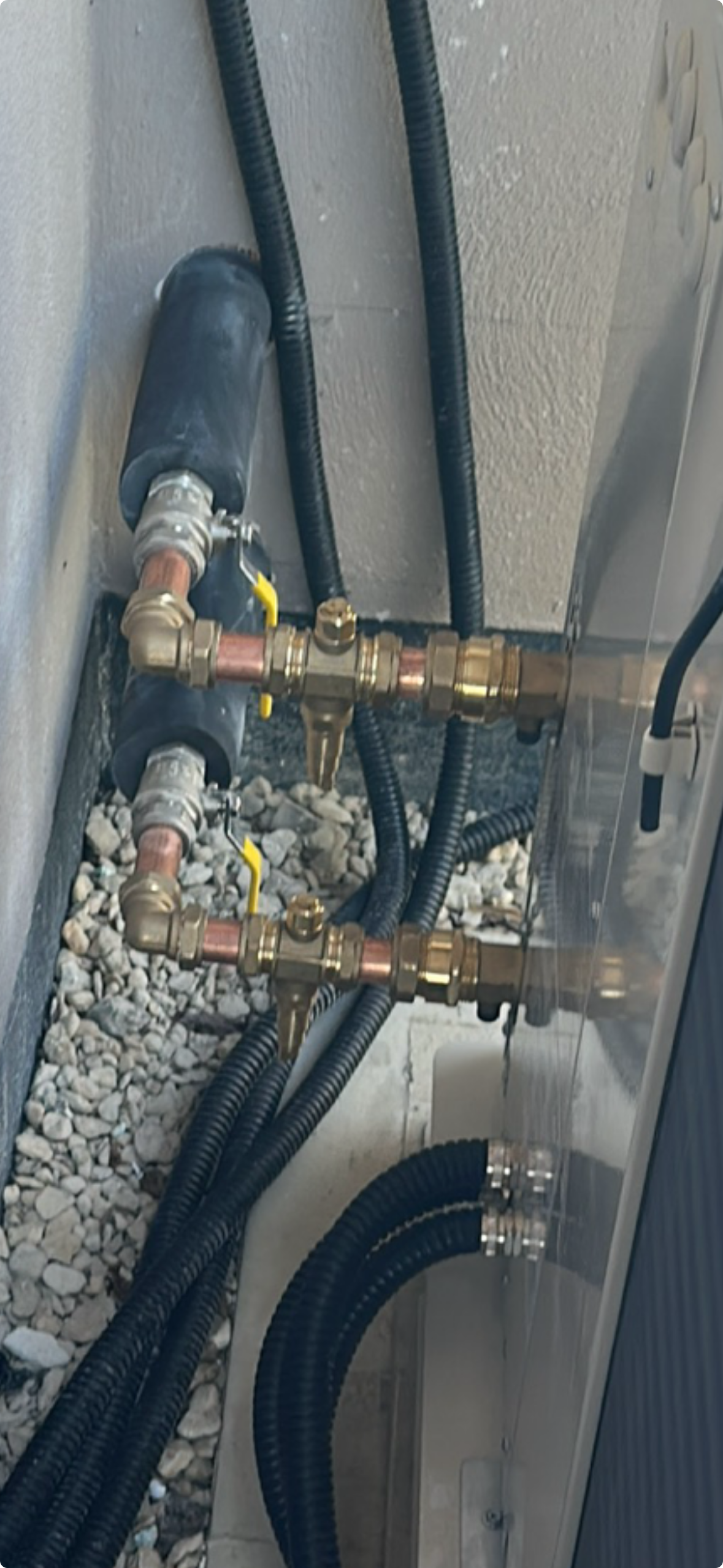

February 12Feb 12 6 minutes ago, Duncan62 said: Thinking about it, should the Freezer valves be sited at the lowest point before the heat pump, or will anywhere outside do it? Low points - outside, if that at the heat pump, that's where they go.
February 12Feb 12 5 hours ago, Duncan62 said: Thinking about it, should the Freezer valves be sited at the lowest point before the heat pump, or will anywhere outside do it? Here’s the last one I installed. Lagging was finished after leak testing.

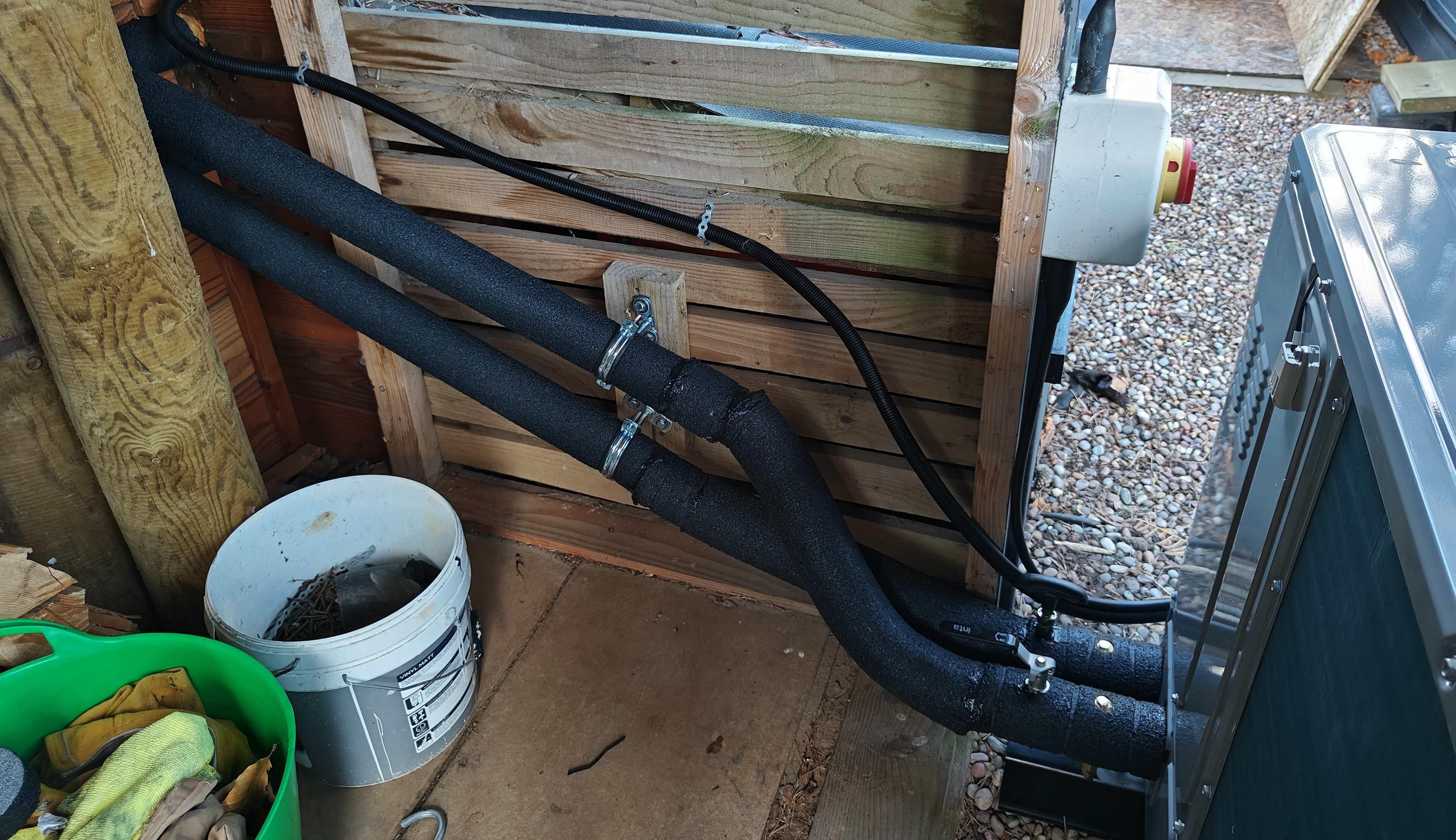

February 26Feb 26 Author Thank you all, uninsulated until I get it up and running in case of any leaks, but system installed and closed loop. Next challenge is flushing the UFH loops (only 3x100m) and filling the system from the now connected fill hose under the expansion vessel. Also need to add the biocide and anti-corrosion. Wish me luck.

March 15Mar 15 Author So, filled with water. Lots of leaks.... Which was unexpected. Going round tightening everything again.
March 15Mar 15 2 minutes ago, Duncan62 said: So, filled with water. Lots of leaks.... Which was unexpected. Going round tightening everything again. Don't overtighten fitting with olives.
March 15Mar 15 Author 31 minutes ago, JohnMo said: Don't overtighten fitting with olives. I think this may be my issue, I knew not to offer tighten, so maybe didn't do it enough. I only have normal spanners so don't think I could have overtightened as wasn't forcing anything... I'll open one up and look at the pipe, hopefully it doesn't look like a fat finger on a ring! Been advised to add some paste to the olives before tightening to help with the leaks.

March 15Mar 15 6 hours ago, Duncan62 said: Been advised to add some paste to the olives before tightening to help with the leaks. Yes, absolutely. It doesn't just help with leaks, it helps lubricate the olive and nut so it's much easier to tighten it up without horrible squeeks and judder. On larger diameter compressions, you can use a bit of the paste on the thread which helps a lot too. The other thing you're going to be swearing about is the use of primary pro insulation. God awful stuff and the sealant is a messy nightmare - you also have to mend the outer protective layer on regular occasion. I only use Armaflex or Kaiflex with the adhesive and tape. TBH I now use trunking wherever possible now. Also, your anti-freeze valves shouldn't be installed on top of each other, but about 150mm apart. But what you can do with your situation is get the half bend covers like these: https://www.bes.co.uk/inta-zeroguard-anti-freeze-valve-protector-26812/ so if the top valve dumps its contents, it doesn't pour it all over the one below. An alternative in some instances is to have 1 anti-freeze valve at the lowest point of the pipework. And lastly, to be picky, you've got a lot of weight hanging of the connectors on the heat pump, no pipe clips until the pipe goes through the wall and this is what's holding the weight of the pipes. Personally, I would have run the flexis straight from the heatpump and then have the isolation valves on hard pipe properly clipped to the wall for support.
