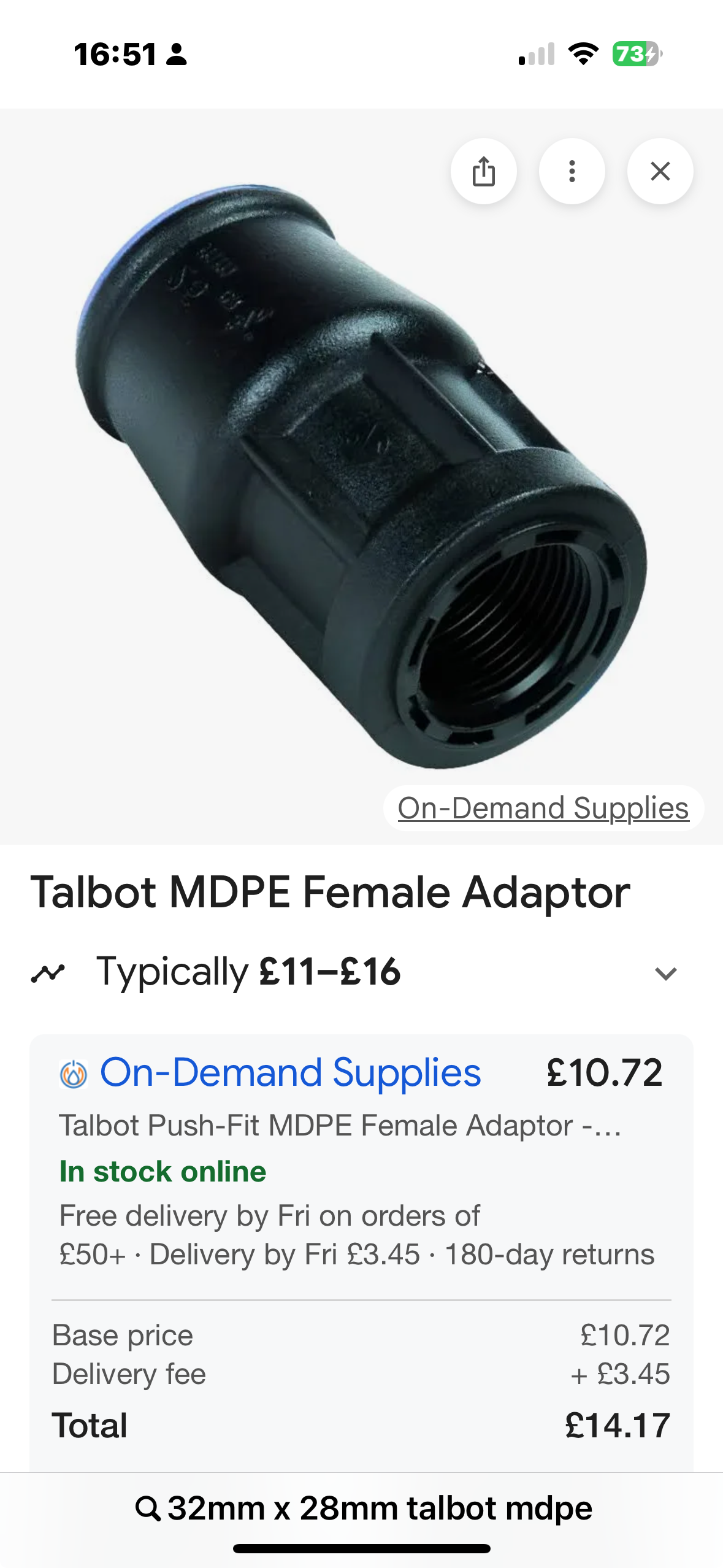

February 4Feb 4 Author Looks like the existing are Talbot: https://www.plumbingforless.co.uk/plumbing/atplas-talbot-mdpe-fittings/talbot-elbows/talbot-pushfit-90-degree-elbow-32mm-e2784
February 4Feb 4 Author FWIW these fittings are approx 20 years old. Google suggests a known failure of them is o-rings failing due to age (15-20 years).
February 4Feb 4 5 minutes ago, -rick- said: Certainly once the pressure was off and I felt the pipe it was possible to push the fittings on by another inch with zero resistance. Pipe was completely free to move. When the pressure was turned back it pushed the fitting back out with some force as I was trying to hold it tight. Shouldn't the joint seem stiff/tight even with no pressure? Just had a look on the Plasson site, nothing that matches these fittings on there (at first glance). I meant compression MDPE like this, in case that wasn't clear: https://www.pipestock.com/mdpe/mdpe-pipe-fittings/mdpe-elbow-90 Ah! Gotcha. Yes, that type of fitting is also robust. Being able to push the pipe an inch means it wasn’t past the o ring, so you were living on luck there!! yup. Just found the bugger lol.
