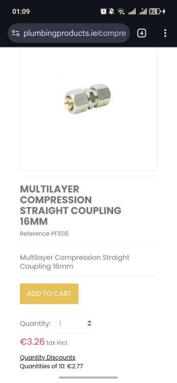

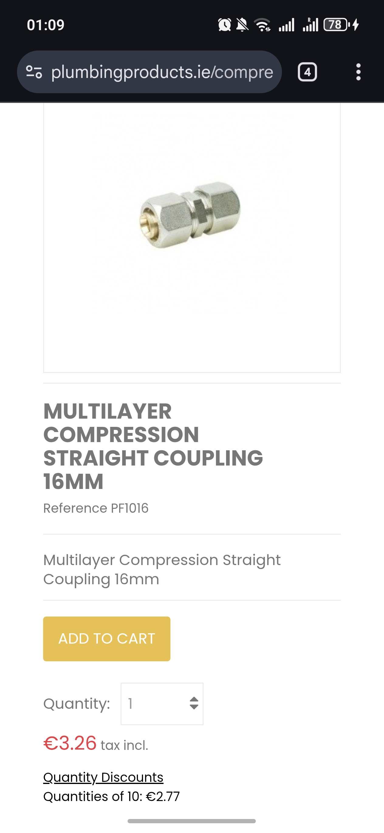

February 5Feb 5 It's been the standard go-to in Ireland with a while for new builds I've seen. You can buy screw fittings if you don't have the compression tool. It's a very robust system. HEP2O is an easier system to install in my experience and has less restrictive fittings for flow and plenty good enough for houses. I would be happy with a multilayer system if done well though. Much more so than copper or cheaper push fit. Edited February 5Feb 5 by Iceverge
