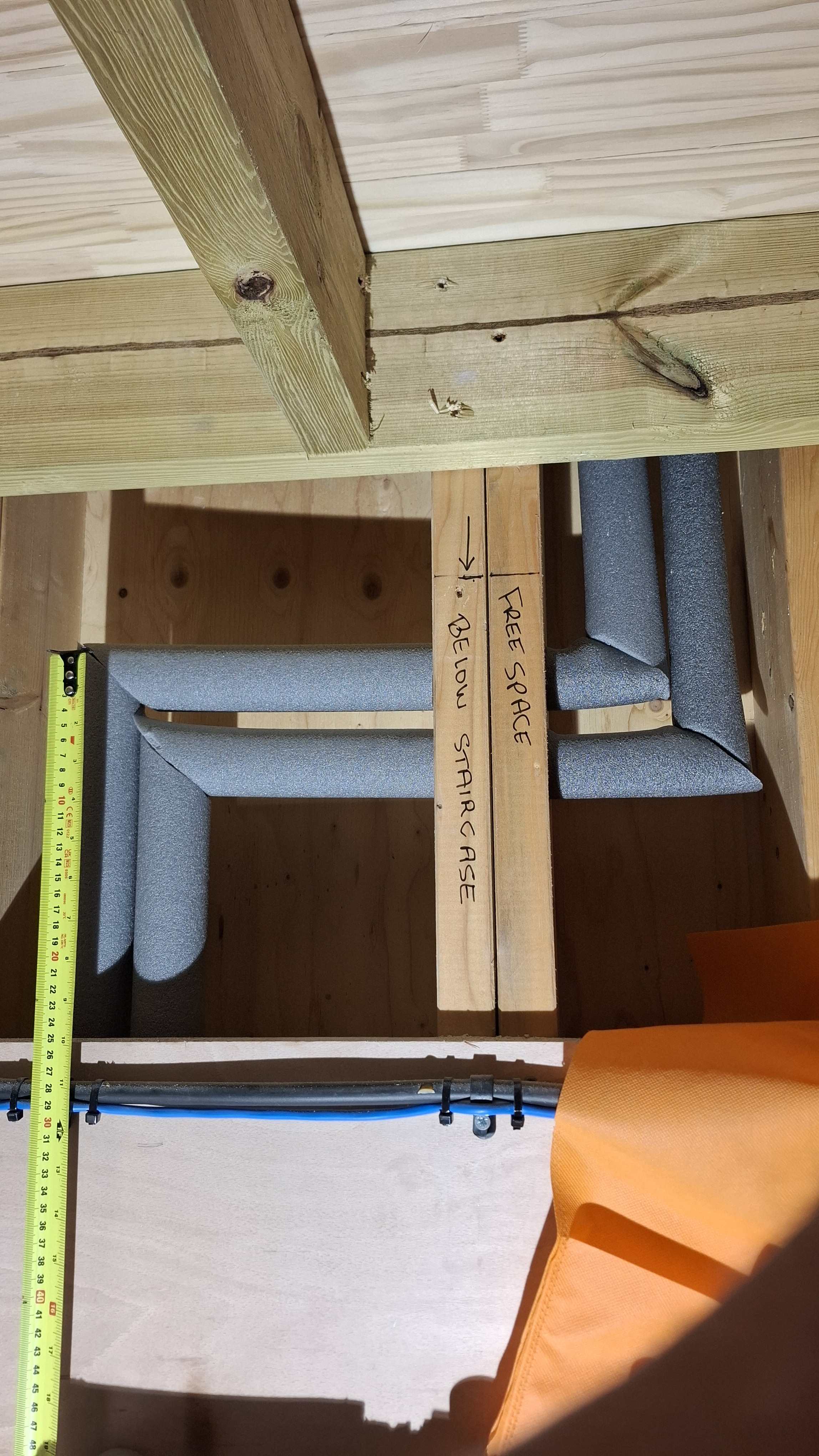

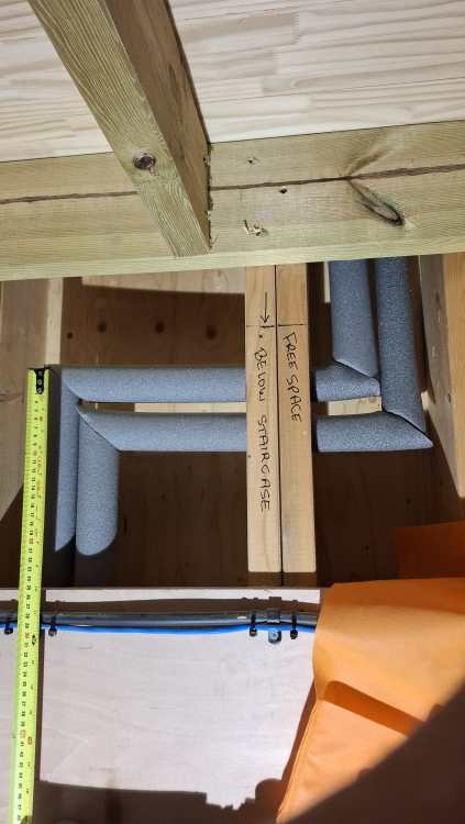

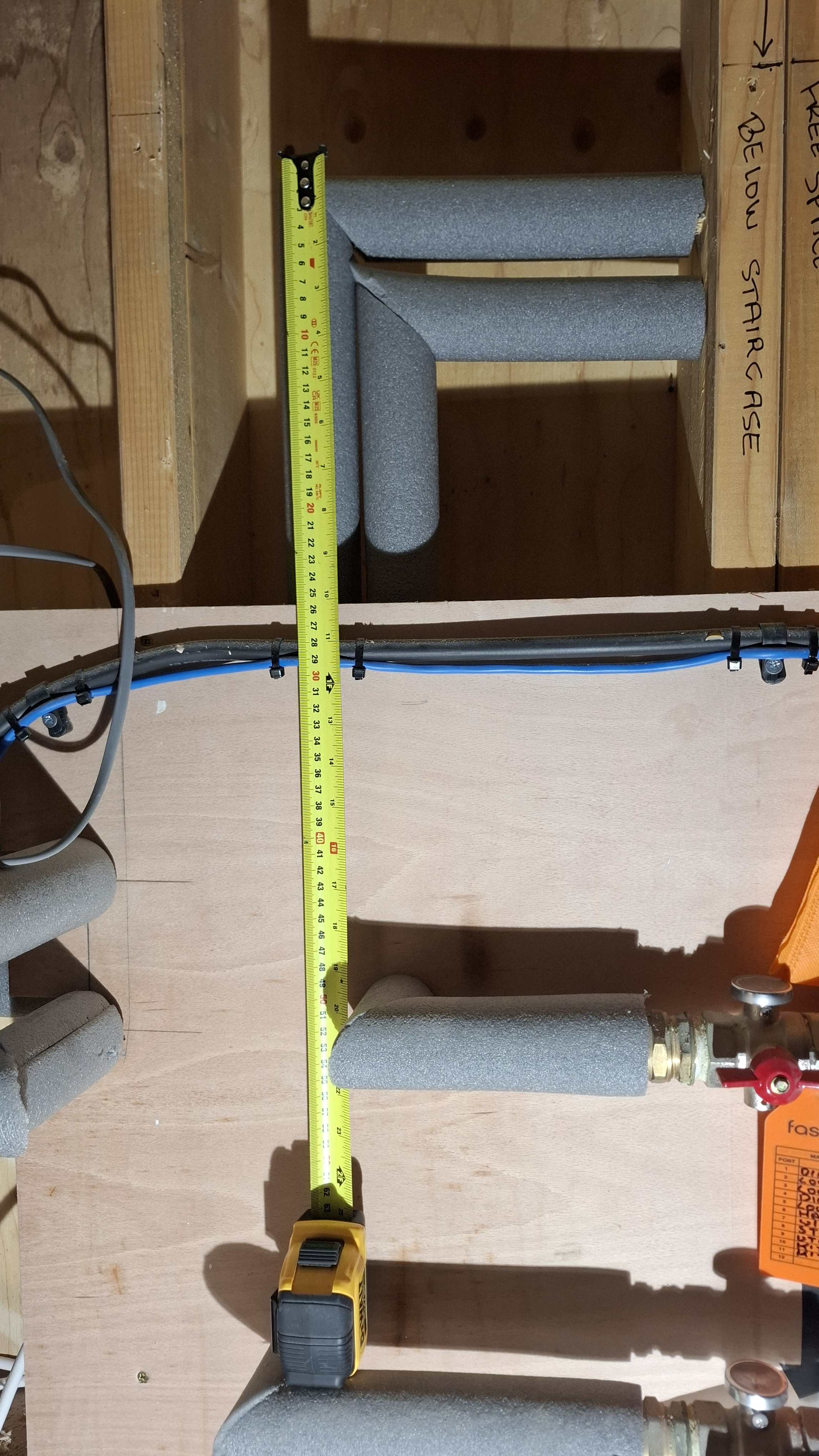

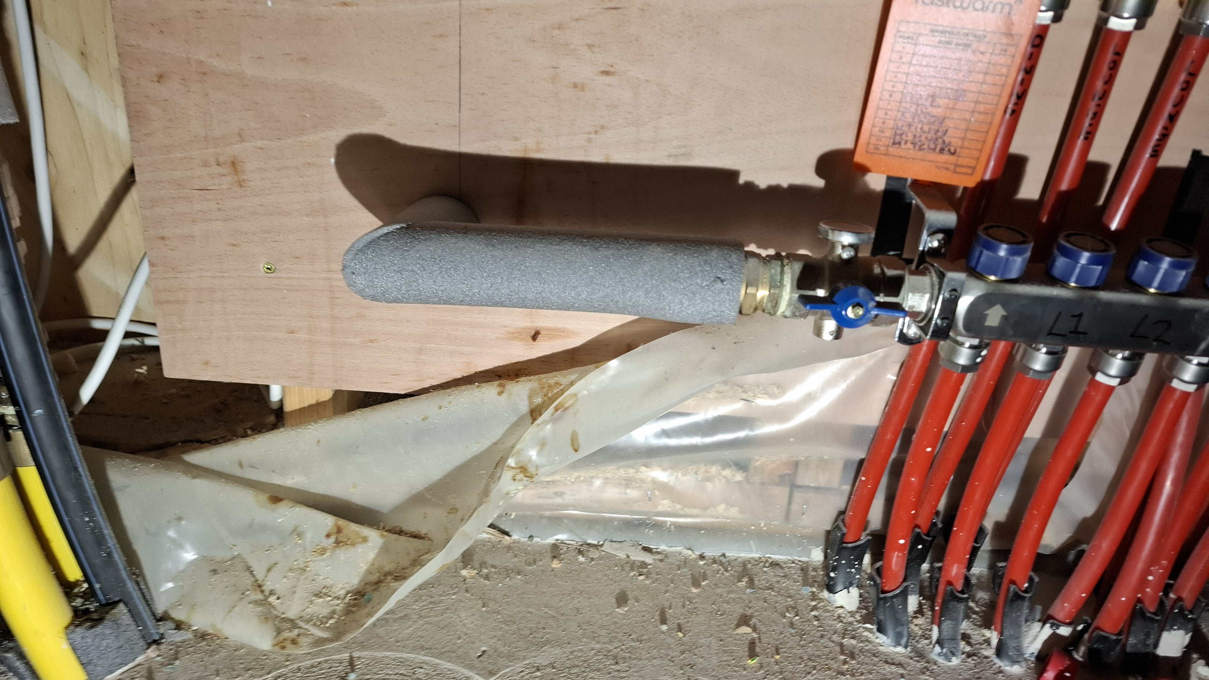

Nickfromwales Posted 8 hours ago Posted 8 hours ago 8 minutes ago, Post and beam said: Thanks dude, that was the motivation. Regarding the Ivar mixing valve option. I am not sure i have the space to install one as it happens. Therefore a review of my radiators to move them around and fit a couple of larger ones might be the thing to do. K3 instead of K2 perhaps. Post a pic of the manifold, showing above / below / immediately surrounding space. Doesn’t have to be directly connected, but needs to be close ish.

Post and beam Posted 8 hours ago Author Posted 8 hours ago 21 minutes ago, Nickfromwales said: Post a pic of the manifold Will do when i get home later. 1

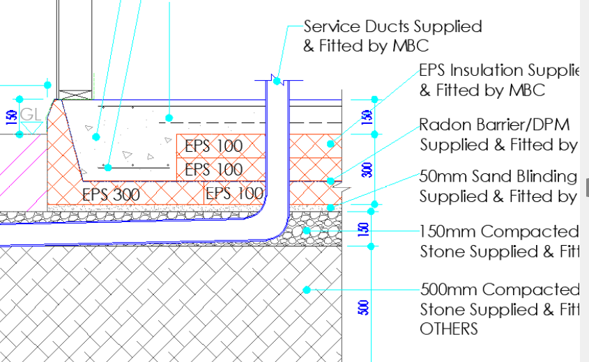

Bramco Posted 8 hours ago Posted 8 hours ago 4 minutes ago, Post and beam said: Yes it is. 75mm, why? Just wondered if being in a screed meant the floor didn't retain the heat you put into it as well as a passiv slab should (and in our case seems to do). The MBC slabs are 150mm over 300mm EPS

Nickfromwales Posted 8 hours ago Posted 8 hours ago 5 minutes ago, Bramco said: Just wondered if being in a screed meant the floor didn't retain the heat you put into it as well as a passiv slab should (and in our case seems to do). The MBC slabs are 150mm over 300mm EPS 100mm? Thickening over ring and intermediate beams.
Bramco Posted 8 hours ago Posted 8 hours ago From the contract, so unless they shortchanged us..... And the ring/intermediate beams should be 350. Also noted that our vaulted ceilings are 0.1, not what I said earlier.

Post and beam Posted 2 hours ago Author Posted 2 hours ago 6 hours ago, Nickfromwales said: Post a pic of the manifold, showing above / below / immediately surrounding space. Doesn’t have to be directly connected, but needs to be close ish. Here are pictures of the manifold.
