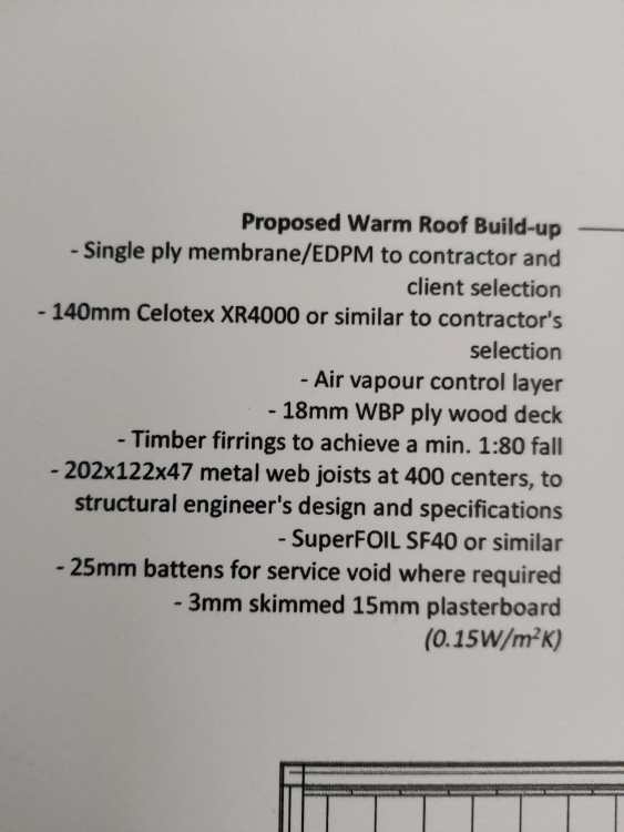

I'd would prefer nothing there than that layer of poly.
It will be far too resistant to vapour to allow any drying back into the room and your roof rafters will get damp.
Intello or some other low sd or variable sd membrane or nothing
What's being constructed is a recipe for rotting your timbers.

@andeebee, do you have a pic of the architects section for this roof build up?
We have removed the superfoil element. It was added as an additional U value factor. I opted to increase the thickness of the PIR on top to 150mm.
I guess had the superfoil remained it would have provided the same impermeable layer that the poly is now providing...
