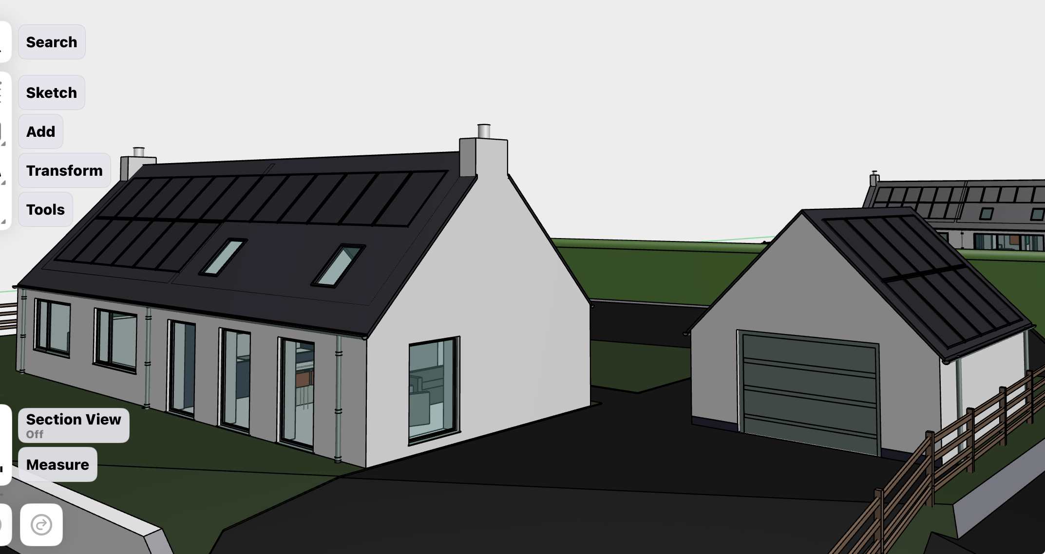

Sarking boards on roof with built in solar trays
The house is currently going through planning for changes from the original design. In the meantime I’m trying to get my head around the Scottish way of doing a few things.

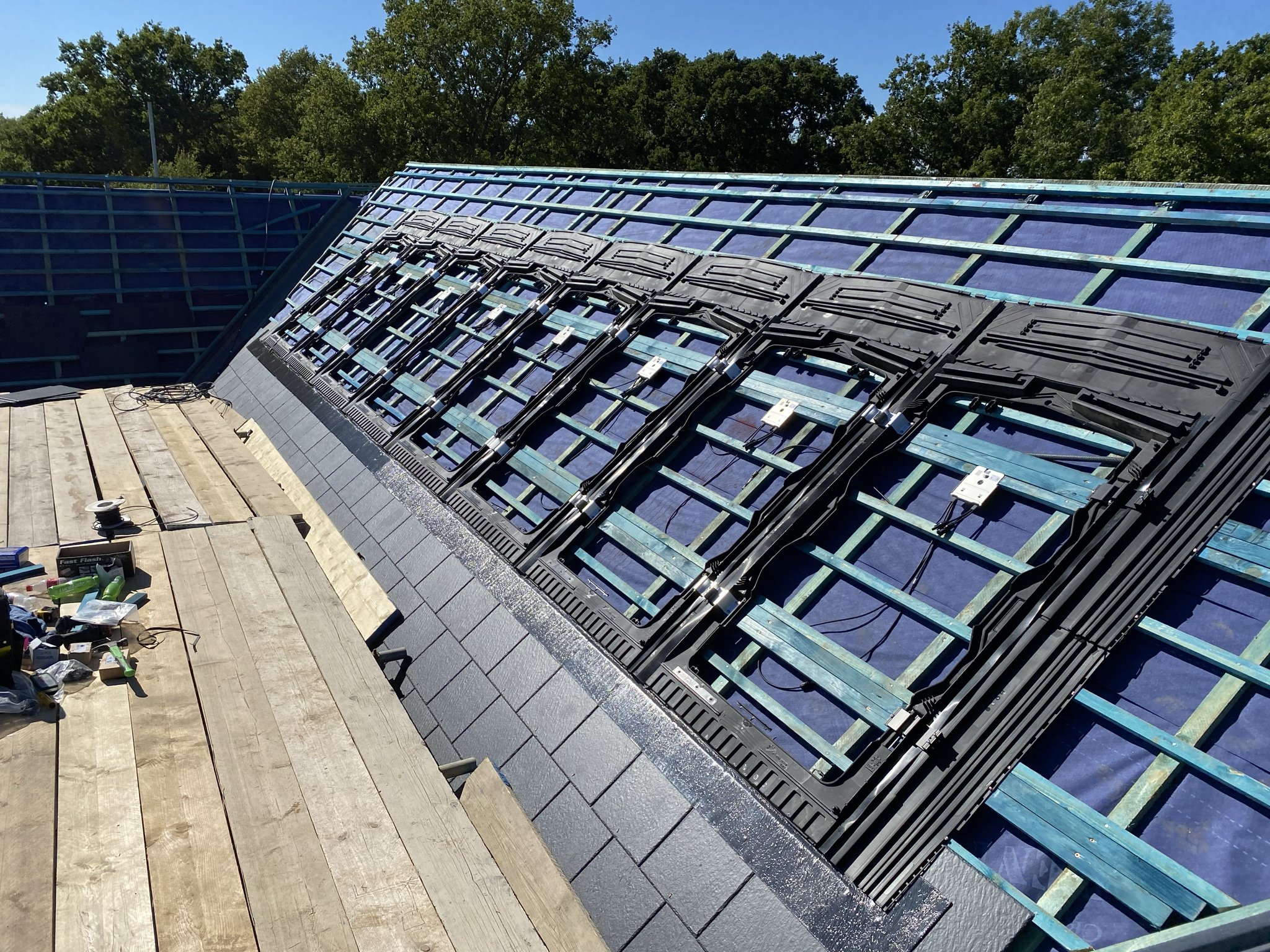

Now if I’m having built in GSE solar trays, my understanding is we will have to do following,
Truss
Sarking boards
Breathable membrane
Counter batten
Tile batten
Slate
Is this correct? It’s okay to have the membrane flat with no slack or would membrane go on top of counter batten and be droopy?

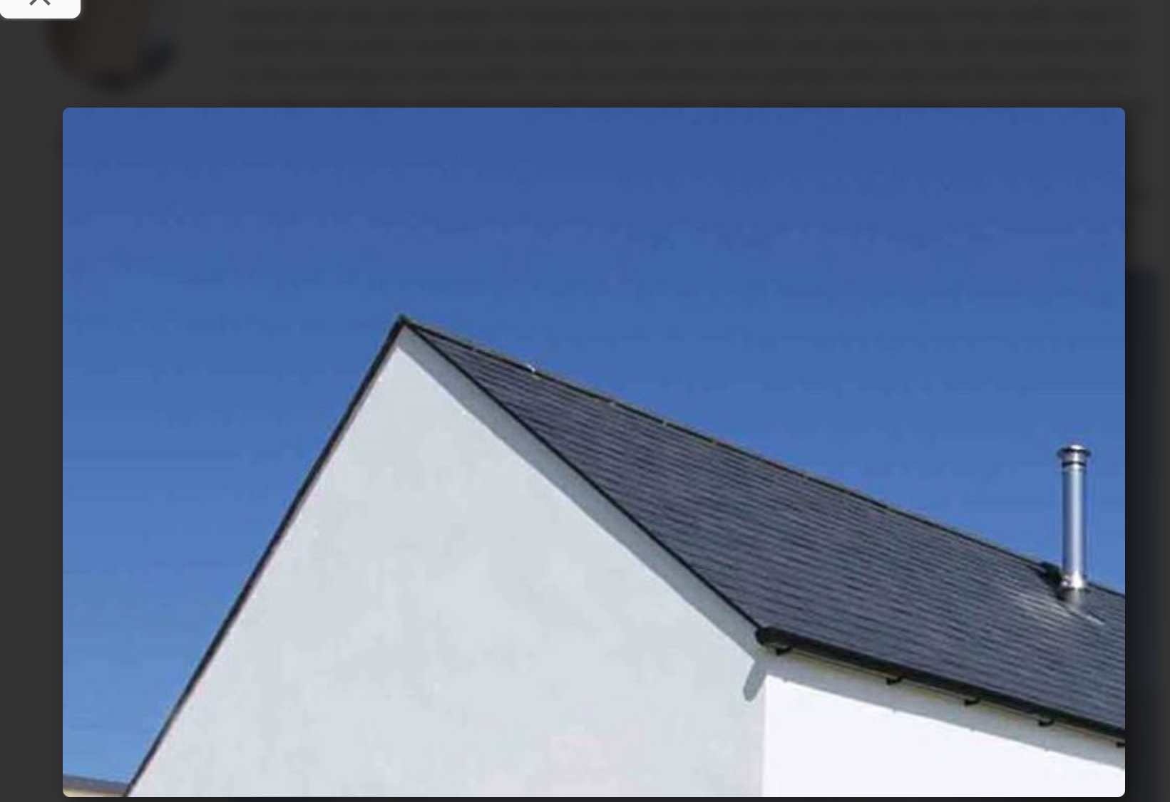

Trying to create a thin verge without any facia so looking how to achieve this on the gable ends.
cheers

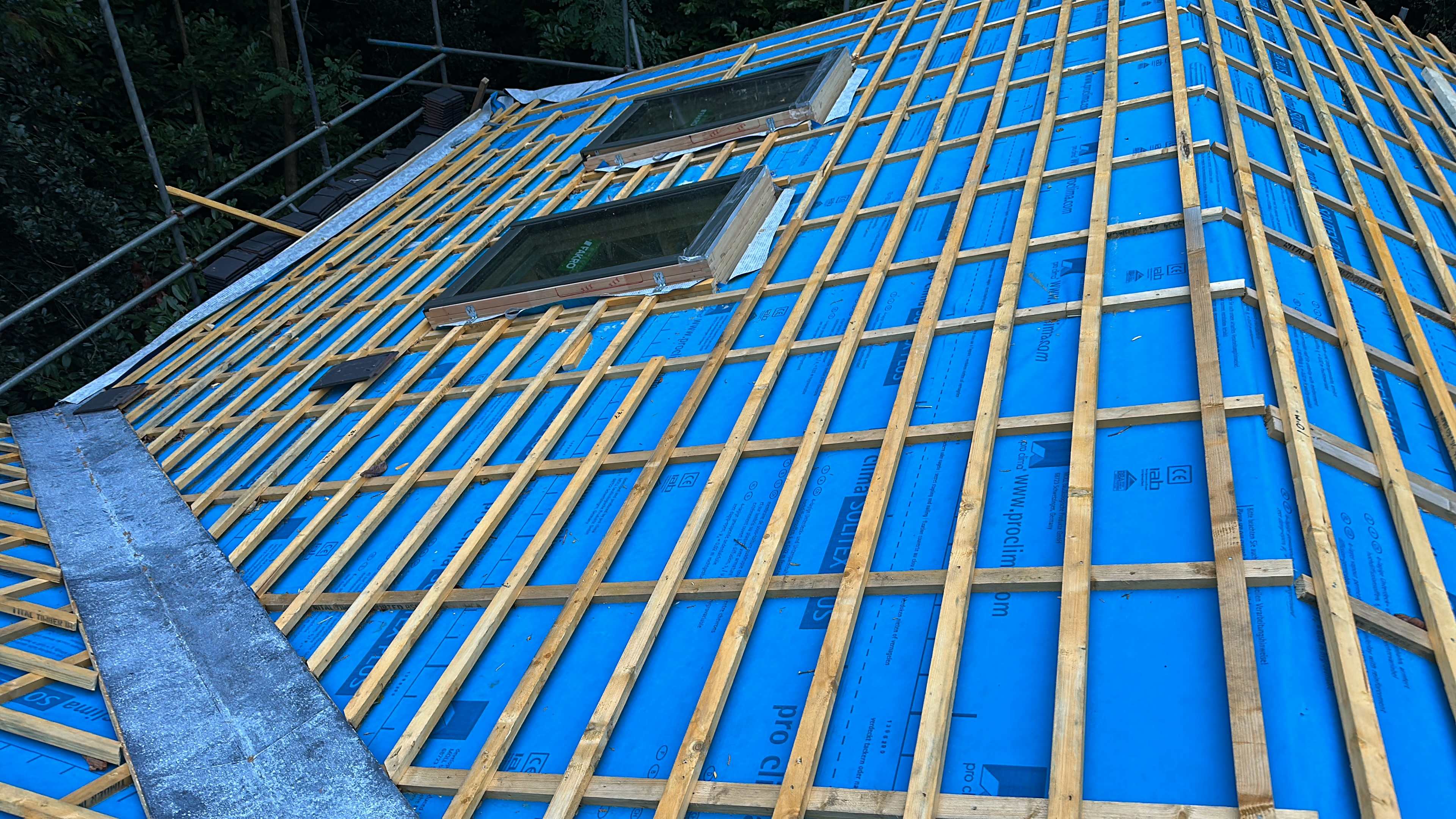

Effectively completely ignore the GSE instructions, they are not applicable to a sarking board roof.
Attach the trays direct to the sarking, through the membrane
IMG_20220114_085531.thumb.jpg.7e1b446d6a4307513c76627675f7162d.jpgIMG_20210303_155056.thumb.jpg.4af748d377a98e113317b49e13cd1283.jpg
@JohnMo
Thankyou. It’s so hard to find pictures of an install onto sarking and you have provided. Much appreciated👍
That looks very tidy indeed.

  • 4 weeks later...
Just jumping on this as in the exact same scenario. My assumption was I would need to battern on top of the sarking vertically and the counter batten horizontally on that to enable water run off down the membrane that sits on top of the sarking board. Then trays and slates would be fixed to that horizontal batten.
Are you saying you are not counter battening and if so, is that not an issue for water run off as it would get stuck and pool?
maybe I’ve missed the point

Just done one project where it’s was sarking > membrane > counter batten > roofing batten. That is the way, and the light. ;)
If fitting in roof, remember to have additional battens ready on site for the PV installers to utilise.
They need to be stacked where the fixings on the trays are. See this for an example of a job we did, so you know what is needed :)
Then slate.   With solar pv in roof.
That’s what we’ve done.
Things to note:
Ventilated ridge and airflow at the bottom of the slates help the membrane shift water vapour and hopefully cool the panels too.
Most roofers round here will counterbatten but then run the felt directly under the bottom tile, stifling all airflow.  Not good. Close supervision was needed in our case and we had a brilliant and well respected roofer.
Not all membranes are spec’d for this configuration.  Make sure you’ve got one that is.
