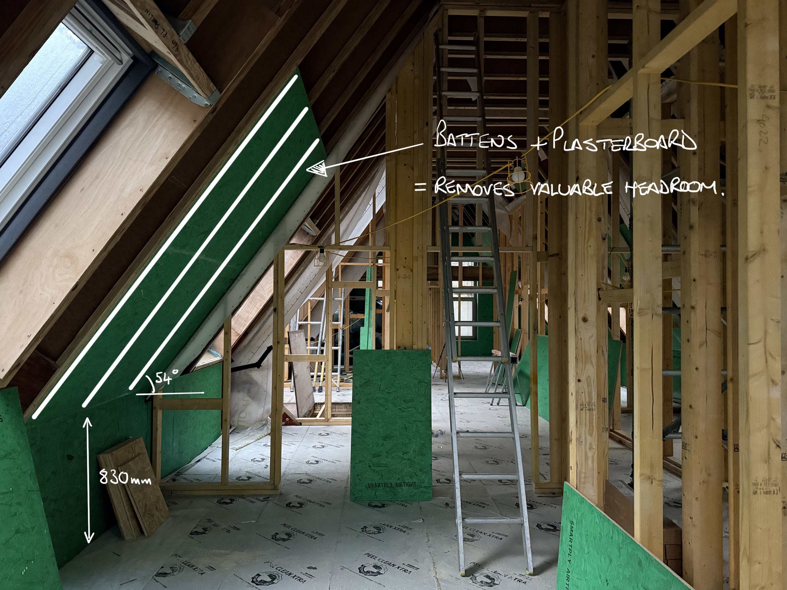

January 12Jan 12 The entire upstairs is within the roof void. We have a steep pitch and a short wall height before the steep pitch starts. Having reviewed our lighting and power plans, we have no need for a service void on the sloped ceiling, and losing 37.5mm for the sake of it would be noticeable to the headroom and useable space in the room. I’m wanting a sanity check - is there anything I’m missing? The sloped roof will be all boarded with airtight pro passive board, and I would assume we would screw the plasterboard to it as ‘normal’ (should we be aware of / consider any other way?) Thanks
January 12Jan 12 Yep, if no services, put the PB straight onto the PP board without a gap. Gives you a little more heardoom.

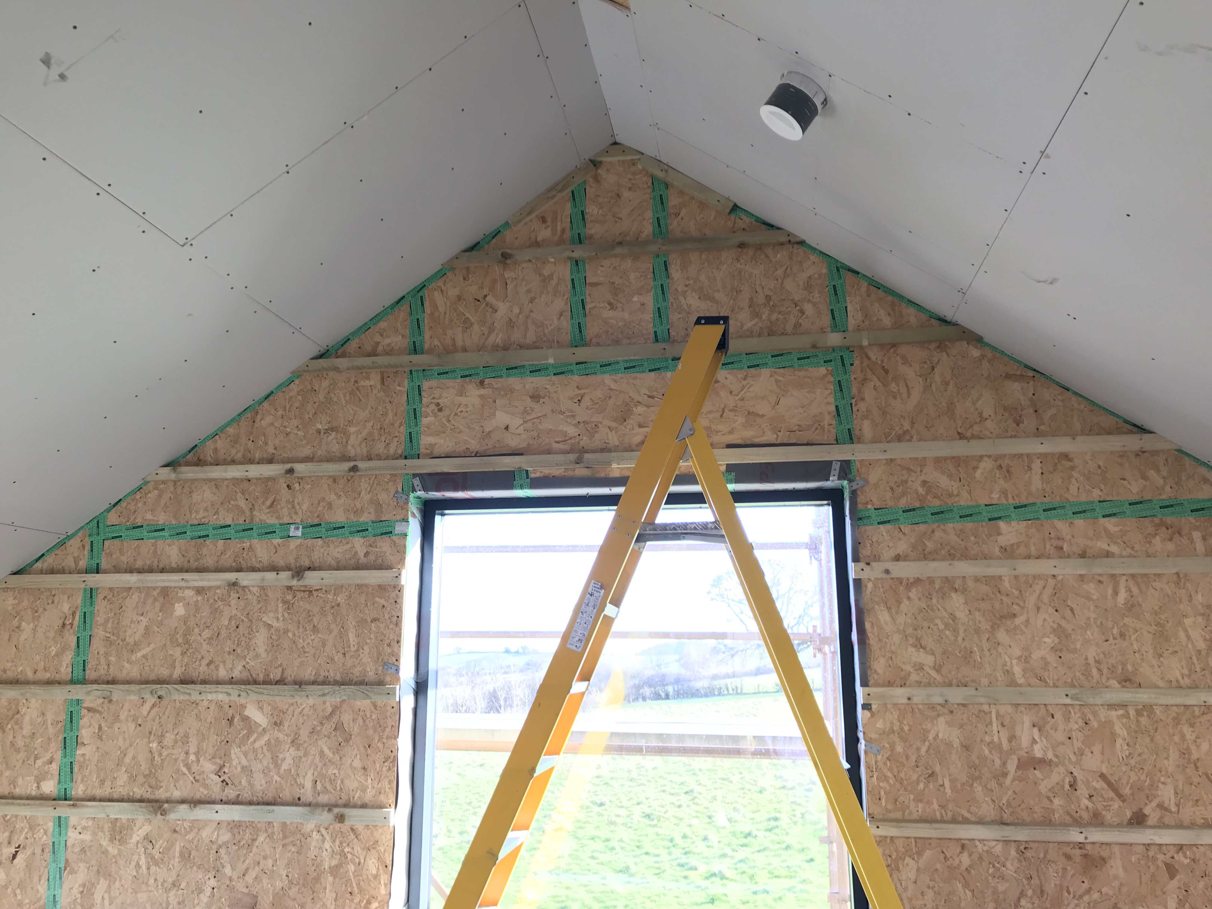

January 12Jan 12 Yes, I fixed PB next to OSB on the sloped ceilings. Service batten only fixed to walls.
January 12Jan 12 a service void is nice to have but I'd prioritise the headroom. Anyway, that 830mm vertical bit could be widened to be a SV without affecting headroom.
January 13Jan 13 Remember your smoke alarms, you would need power to them and inter linked to the other alarms, add in a conduit to pull the cables through somehow.
January 13Jan 13 Author 14 minutes ago, Russell griffiths said: Remember your smoke alarms, you would need power to them and inter linked to the other alarms, add in a conduit to pull the cables through somehow. Yes - planning to do this with the internal walls and. There will be a void in the ceiling (small flat section at top). All these comments are very useful reminders - I’ve thought about many/most of them, and am creating a checklist but I’m looking at one aspect there’s a risk of forgetting another!
