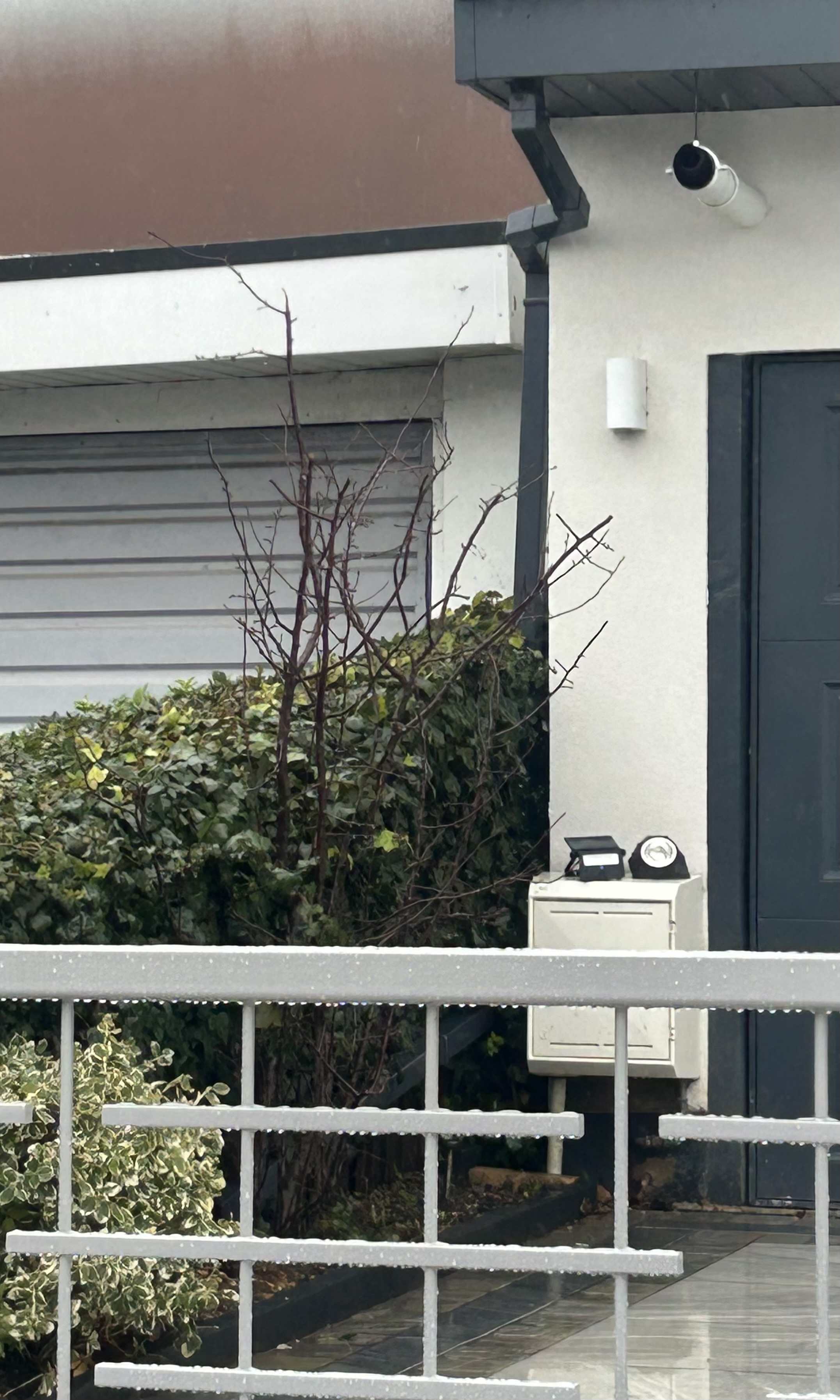

January 7Jan 7 Hi, looking for some input here please. What would be the best solution to have a rainwater outfall without digging up a driveway? We recently had an extension done and this is the last one prior to completion. The current downpipe runs to the flower bed and the BCO made a comment about it. I will also get back in contact with the architect to ask for solutions. I just need to know the options are as I’m stressing about it. Thank you.
January 9Jan 9 A gulley drain, aco, leading into a drain outlet? You might even be able to do a french drain in the flowerbed or something, if you can’t move the soakaway to the lawn. It’s hard to know without the plan and the planning implications. I wouldn’t stress about it, it’s not a major issue and it’s rarely even checked from what I can tell.

January 9Jan 9 Going back to the OP's question. Can you clarify, when referring to a downpipe going to a flower bed - is that an existing one or the one off the new extension? Not sure why you would need to dig up a driveway if there is access to a soft area such as a flowerbed.
January 9Jan 9 Author No, it’s not an existing one. There is an existing one on the side to catch the water from the side of the side and this pipe is for the bit of flat roof from the front. We extended the pipe to the middle of the flower bed so the water won’t end up next to the garage. The BCO wants a solution for it as it must have a rainfall outlet. Customer doesn’t want to dig up the newly installed driveway.
January 10Jan 10 17 hours ago, Oceanjules said: We extended the pipe to the middle of the flower bed so the water won’t end up next to the garage. The BCO wants a solution for it as it must have a rainfall outlet. Customer doesn’t want to dig up the newly installed driveway. Why not dig up the flower bed, install a proper soakaway under the flower bed then put the soil and plants back?

January 12Jan 12 Front downpipes tend to be a pain as often there's insufficient depth of garden to get a soakaway far enough from the building. I am anti putting any more rainwater through an existing combined sewer but sometimes there simply isn't another solution. However, before that, as mentioned above can't you utilise the soft dig through the flower bed to a traditional soakaway or agree a filtration solution using perforated pipe within that bed if the area of roof isn't too big?
January 13Jan 13 Author The architect got back to me and suggested a rainwater harvesting solution and below is what the BCO had said back. “Any type of rainwater butt would still require a suitable overflow to a soakaway system or surface water drain. It is not permissible to run rainwater onto a flower bed.” I asked her what system she would recommend but she wasn’t straight forward. Will putting a French drain onto flower bed be classed as running the rainwater onto it? thanks
January 14Jan 14 So how far can you get away from the house to start with if the underground pipe went through the flower bed? That will determine if a soakaway is even practicable. Then how large is the roof area that the downpipe drains. Arguably that ought to be the additional area as you are not meant to make an existing non-compliant situation any worse than it is. Presumably the original pipe didn't run to a soakaway so the extension is what is causing the problem.
