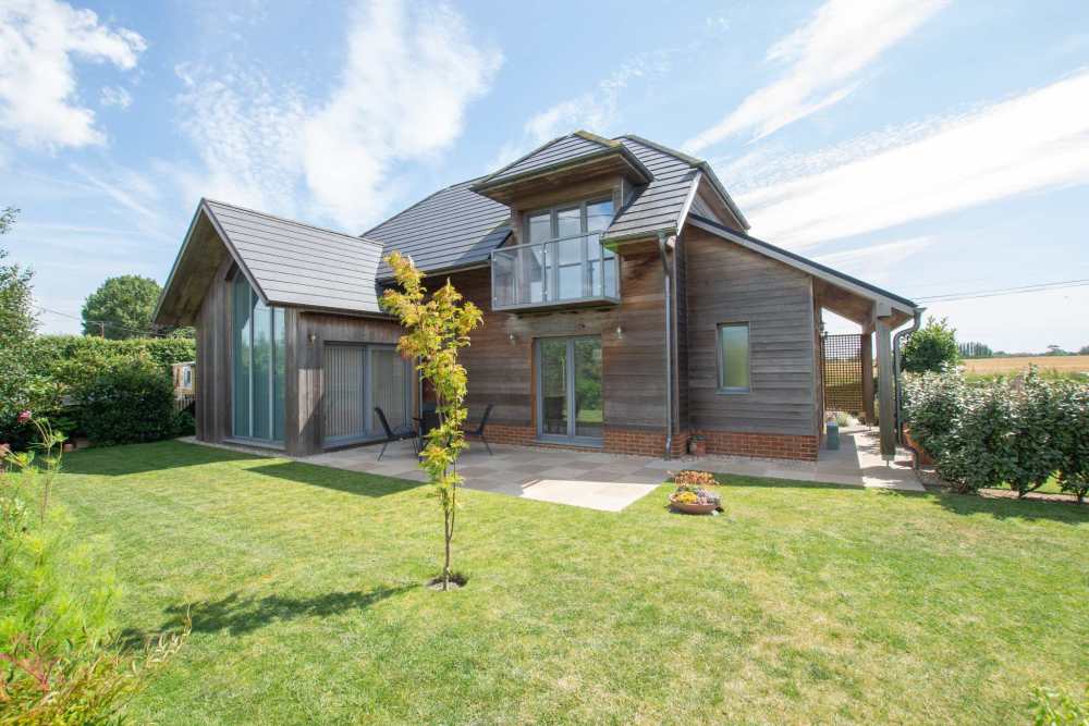

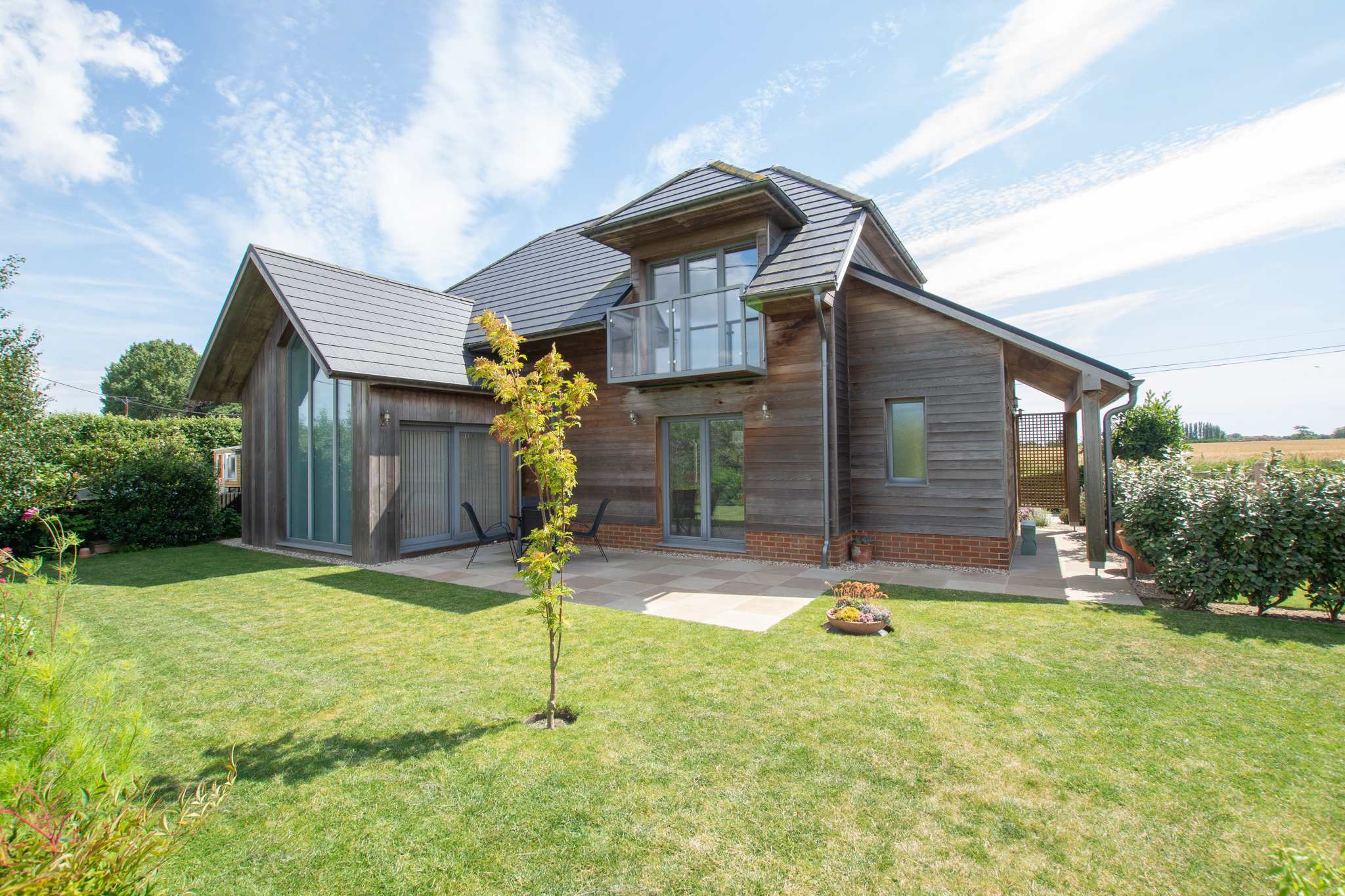

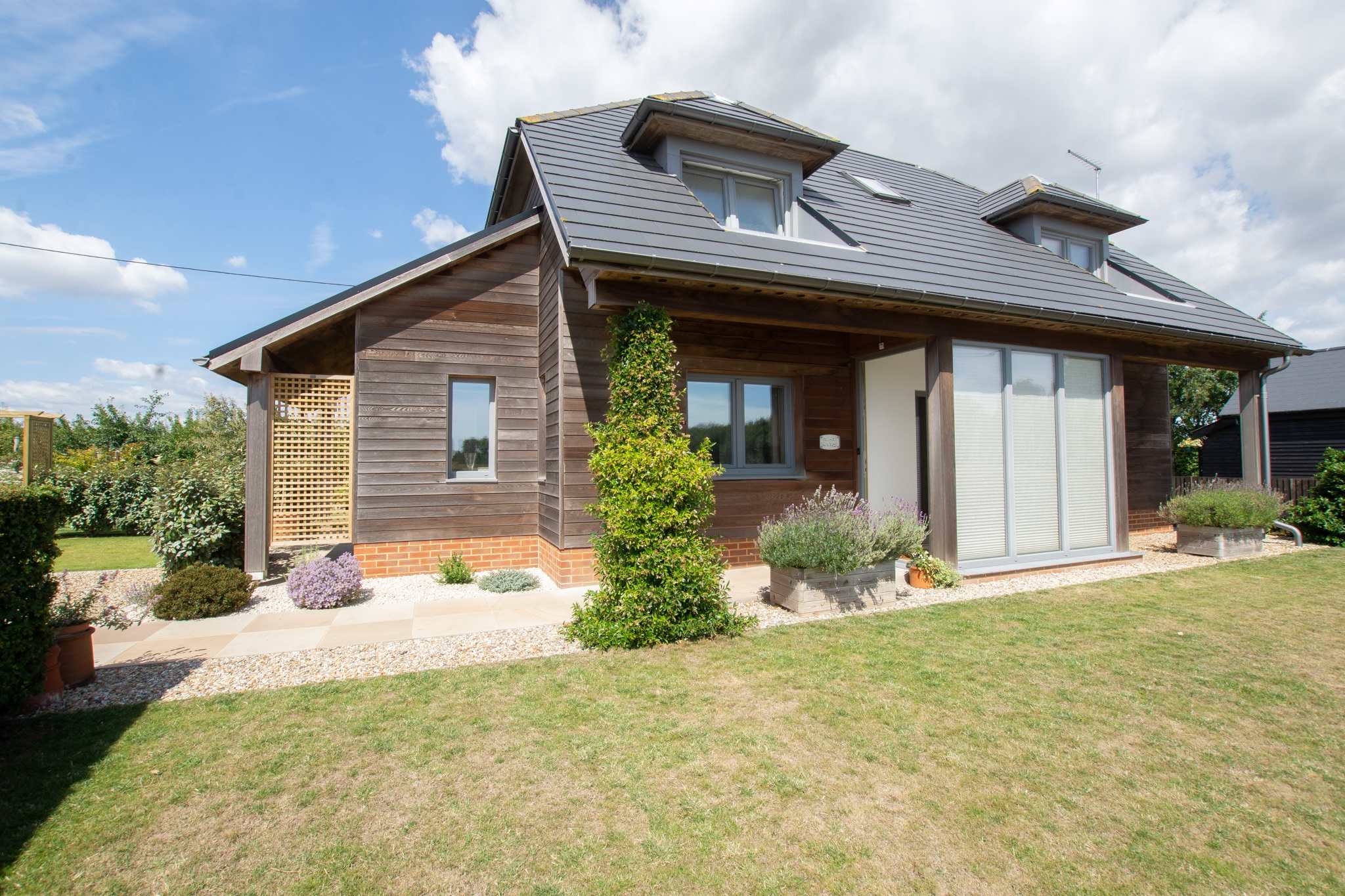

Gone West Posted Sunday at 13:00 Posted Sunday at 13:00 (edited) 1 hour ago, fatgus said: built a 100% wood clad timber frame house We moved into our new timber frame, timber clad, self build in 2018. We had no problems insuring it, neither did the new owners in 2021 have any problems obtaining a mortgage or insurance when we sold it. Regulations may have changed in the meantime though. Edited Sunday at 13:02 by Gone West Update

G and J Posted Sunday at 21:51 Posted Sunday at 21:51 We are building timber frame and had planned a render on board and circa 70% larch cladding. Because of the type of people we are, and you never know, we did some research to ensure the result was mortgageable, by either as as a equity release in years to come or by others should we decide to sell. We found several instances in mainstream lenders of more than 50% cladding being a no go, and other requiring more than 50% block. In the end we have a block skin to the ground floor and less than 50% wood cladding backed by cement board on our boundaries. 1
