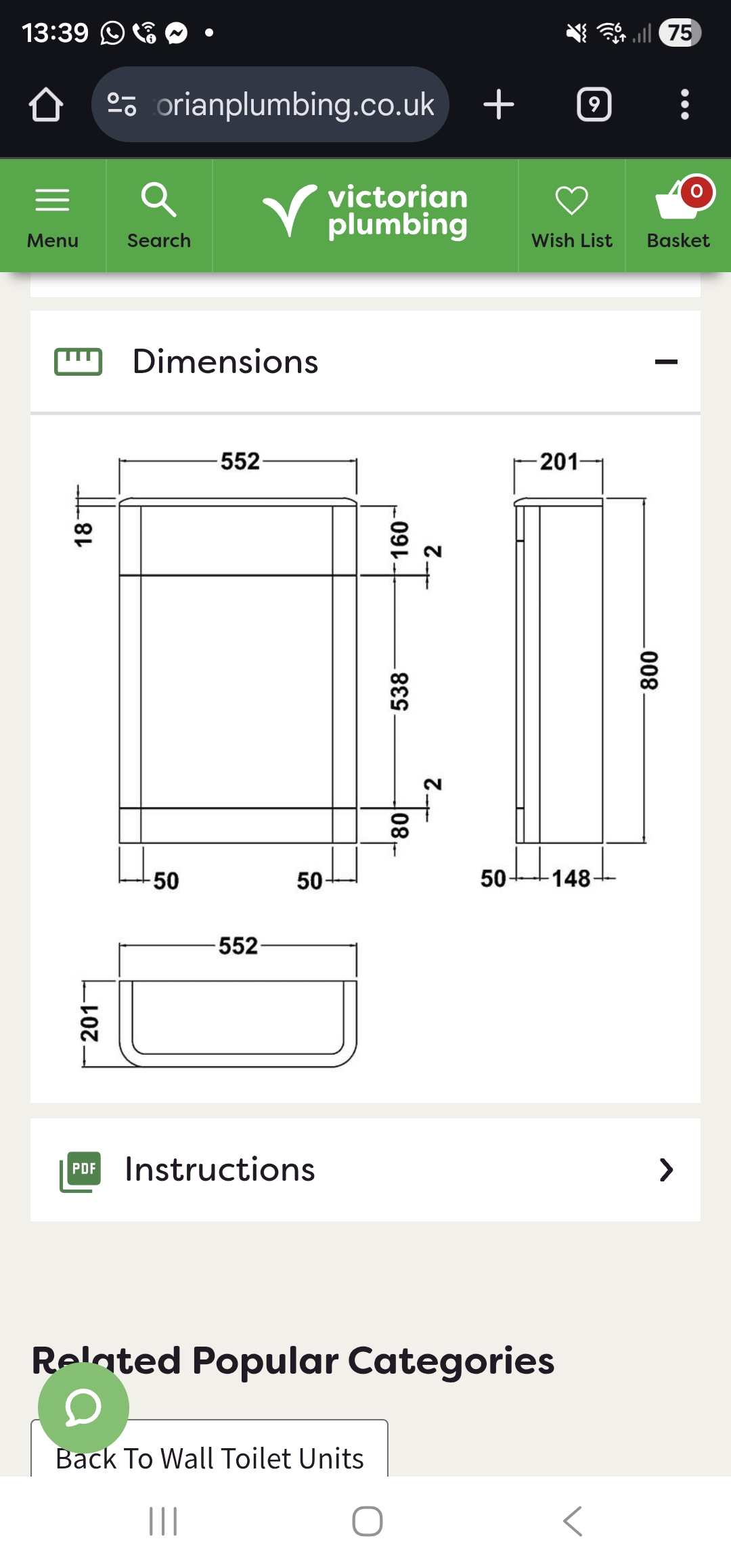

Victorian Plumbing have said it is this one but ideally I need to get it today or tomorrow from Screwfix or Toolstation.
https://www.victorianplumbing.co.uk/venice-concealed-wc-cistern-with-wras-sensor-flush

This one looks like it will fit, but check carefully that the dimensions are no larger than the actual one you have before buying one.

EDIT  it is more important to measure the unit it has to go in. there are others on SF that are wider than the one you have, but that does not necessarily mean they won't fit.

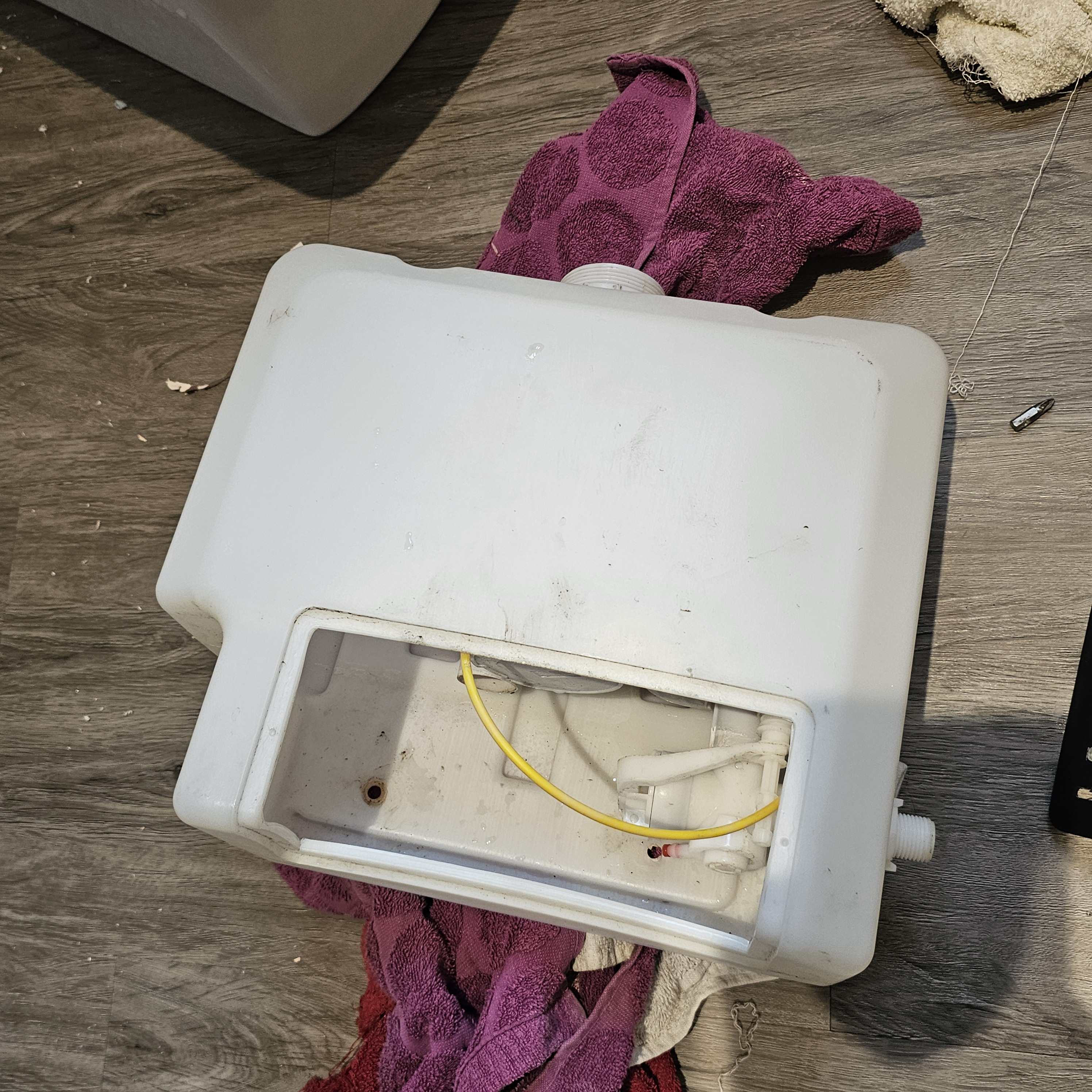

Post a picture of the empty unit and measurements please.

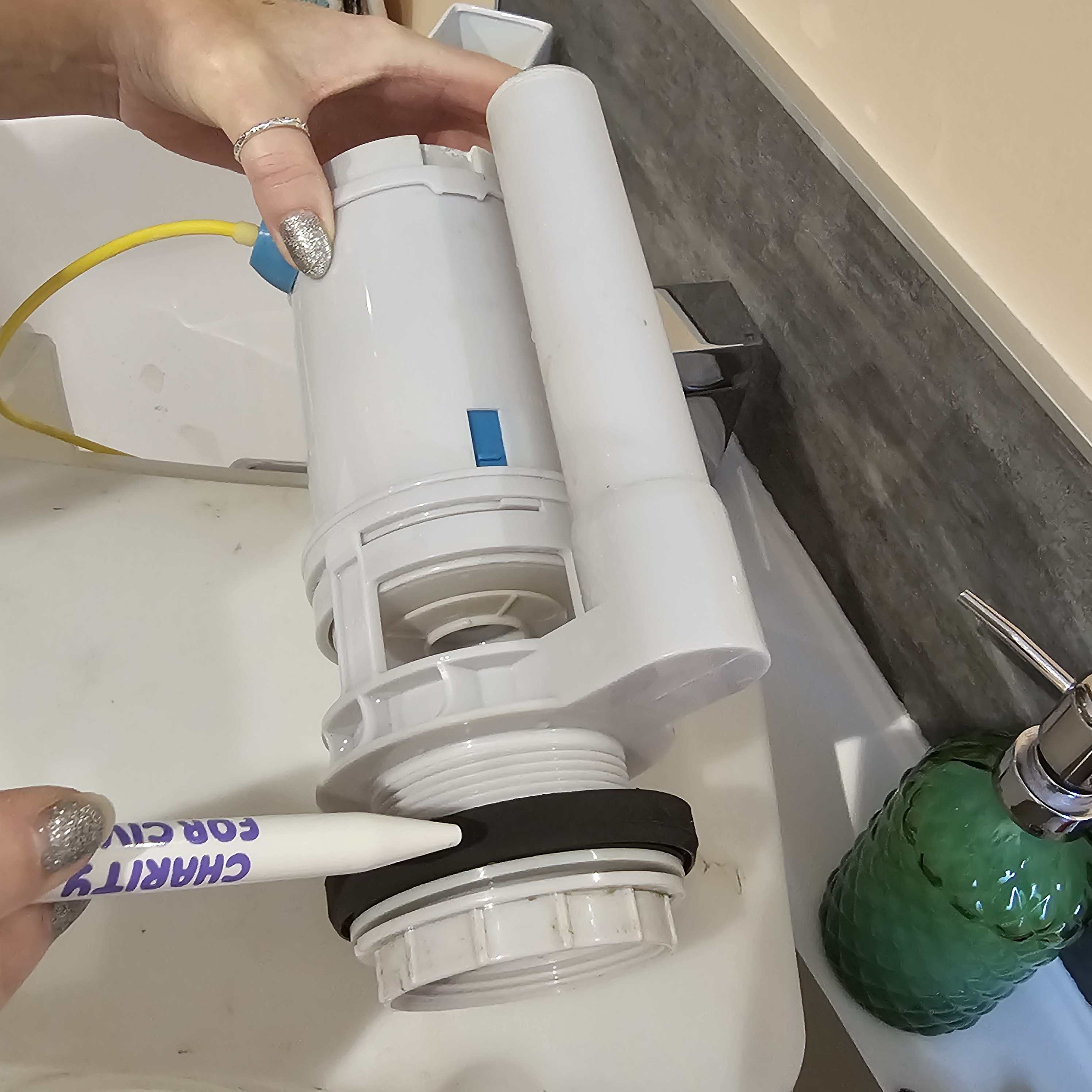

Its this bit black rubber..
And that kit from Screwfix looks like it will fit and has the otherseal but we will double check the measurements...

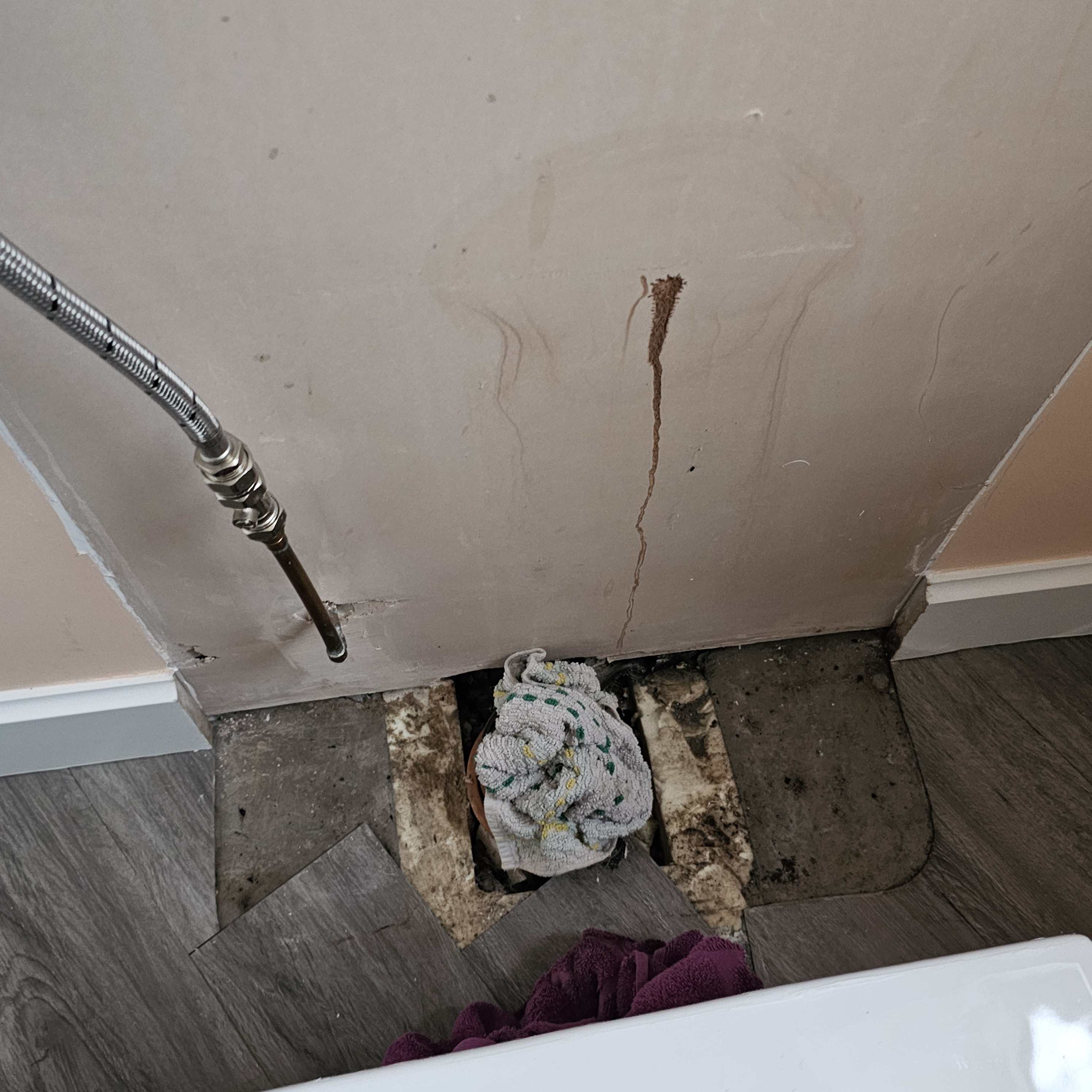

Measurements of unit
Check your cold feed pipe location.  Most concealed cisterns have bottom entry but looking again at your picture yours appears to be side entry.

Those big rubber washers get put in dry by most, and go the distance, but if they’re not put in right first time obvs they leak.
Clean all components and dry everything off. Then rebuild with CT1 as the saviour, either side of that washer, on all joining faces, and do not over tighten it when reassembling.

That is what they look like. But I think it should be on the outside of the tightened screw for full contact with the pan.

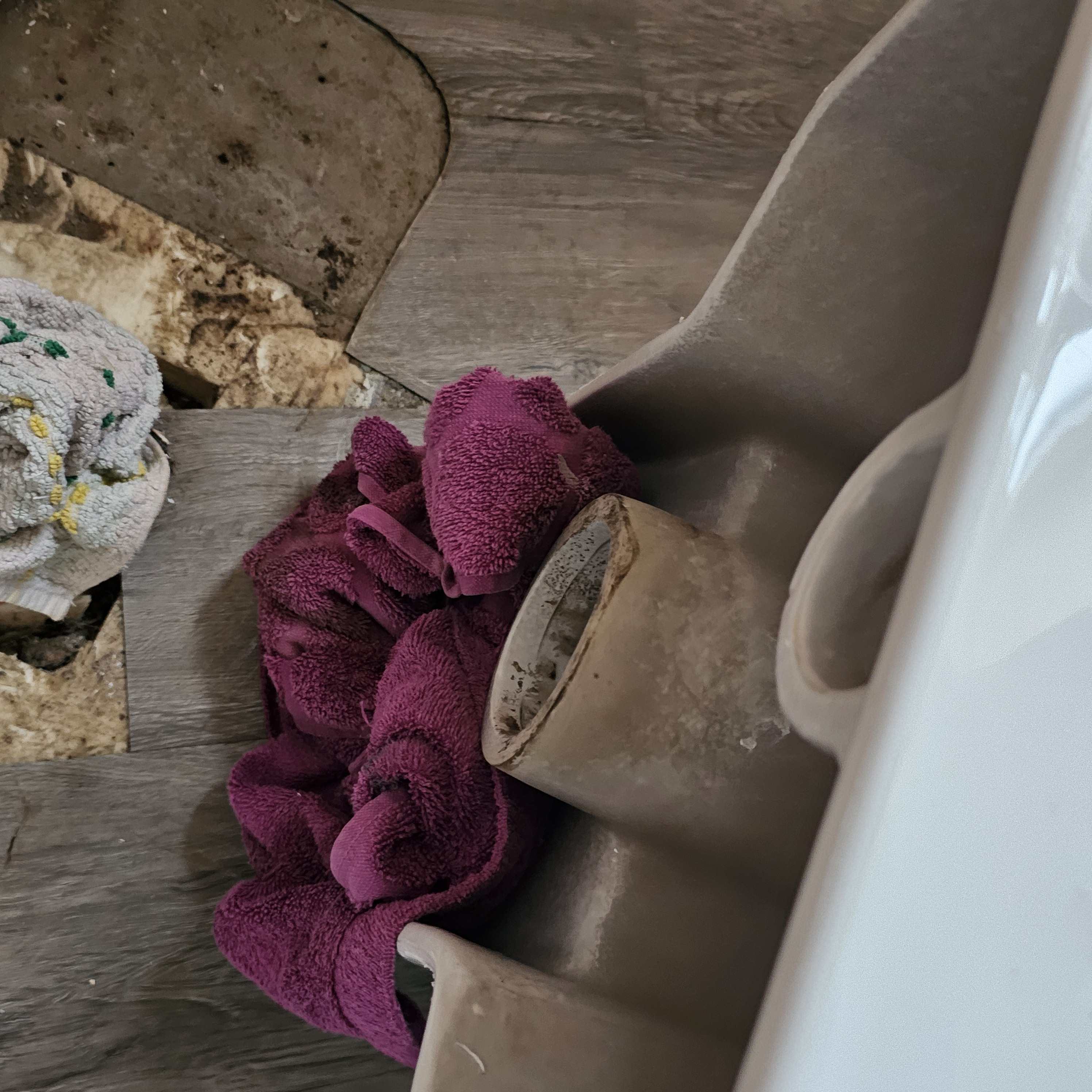

Let's see the pan and thr fixings that came off, for certainty.
Btw I'm only expert in this through getting this wrong, then right... if any proper plumbers want to correct me that's fine.

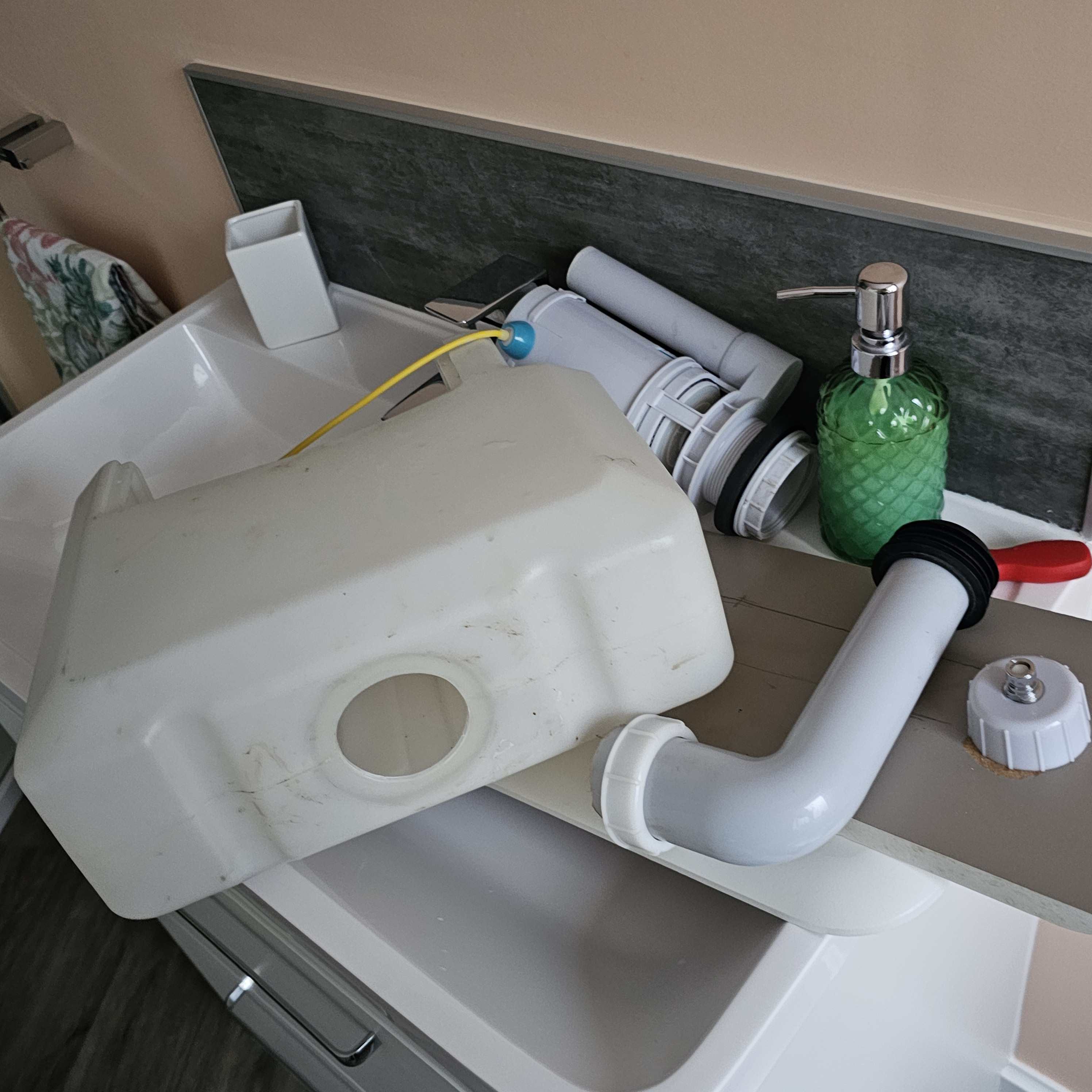

Here are some photos.
Dad doesn't think the waste or toilet was fitted on properly either but it in fairness it is in the Airbnb and had not been used really til June this year so obviously been leaking since then.
Water to toilet is now off so for now panic over and dad is going to sort after xmas once we have sorted stuff.

Yep that's a back to wall pan with a flush pipe.  NOT a close coupled pan with a donut and a clamp to pull the cistern down onto the pan.
If you choose to change the cistern, probably best to use the existing flush pipe that is already cut to length.
You assemble the fill valve and flush valve into the cistern and fill the cistern with water before you fit it, so you can leave it a while and check it is not leaking from either the fill or flush valve,  if all is well empty it and continue fitting.
If it then leaks it must either be from the flush pipe at either end, OR the waste pipe coming out of the pan if the pan connector is leaking.

If it leaks whilst flushing it’s either from the connection under the cistern, or at the conical washer that pushes into the small hole in the pan.
