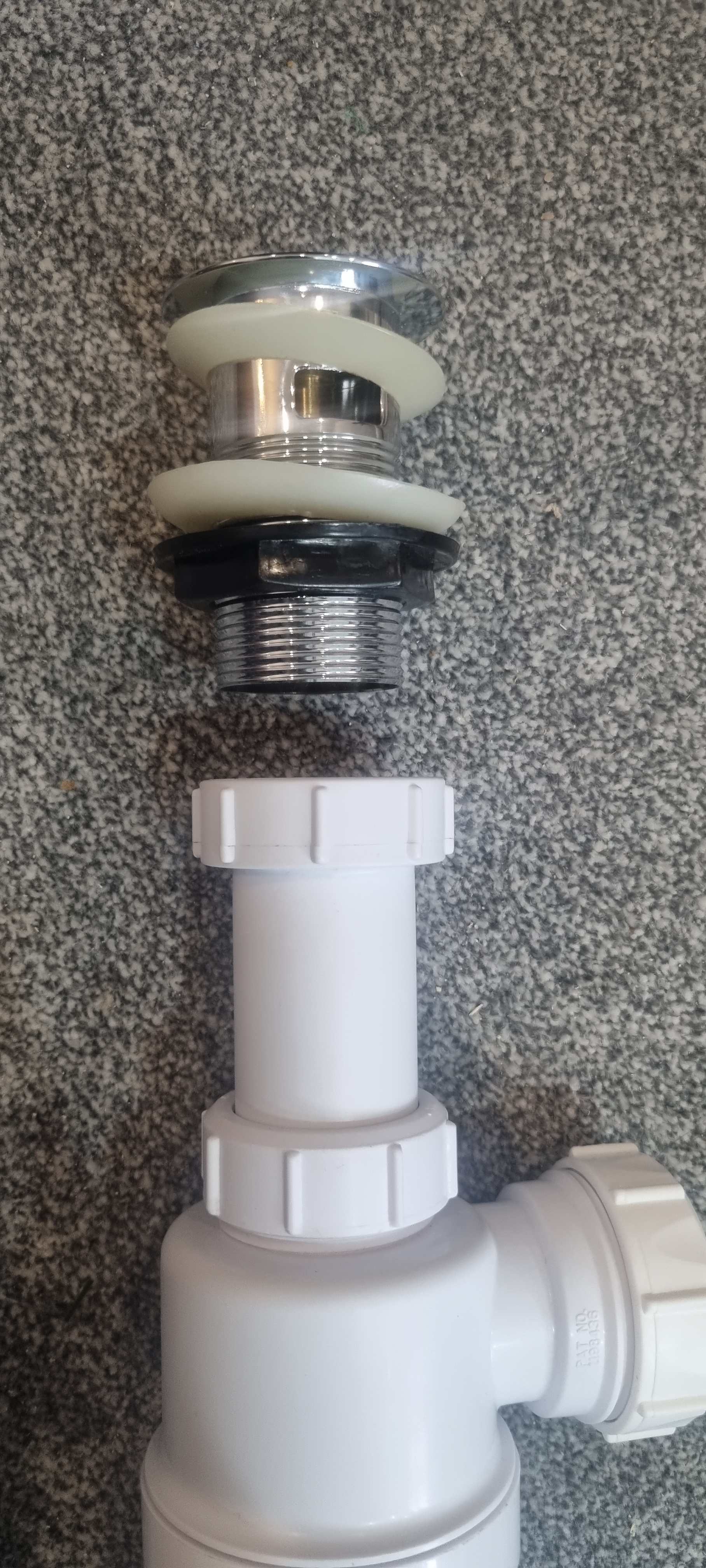

FuerteStu Posted December 27, 2025 Posted December 27, 2025 Got an 1.5" basin sink waste into 1.75" trap. Was thinking such a simple adapter would be easy to find, but alas I'm only finding the wrong sizes, or reverse threads (female to male instead of male to female etc) I've already got 1.75"pipe and AAV coming up under the sink.. Would it just be better to get another trap and reduce it there? Or can anyone find something like the macalpine T16 that's actually the right size?

FuerteStu Posted December 27, 2025 Author Posted December 27, 2025 Very possible! Just concerned about the amount of thread on the 1.75" side..
Marvin Posted December 27, 2025 Posted December 27, 2025 7 minutes ago, FuerteStu said: Very possible! Just concerned about the amount of thread on the 1.75" side.. Silicone it in using Dow 785 white - (allow 24 hours to dry whilst not fitted to sink and in the dry and warm) 1

Nickfromwales Posted January 17 Posted January 17 Just reduce 40>32mm at the point these two meet, and fit a smaller trap? That’s what I do, as I never run long lengths of 32mm pipe for basins any more, always 40mm and then reduce at the bend where it turns from vertical to horizontal. I use a 40mm 90° bend with a 40>32mm reducer glued into the bend, and then a short piece of 32mm to an 1.5” trap. Simples. You can even just buy an anti-siphon 1.5” trap. 2

Nickfromwales Posted January 18 Posted January 18 Scrap the bigger trap, move to a P or bottle trap, enjoy life with a job well done. Traps are easy to ‘self clean’, so it’s no biggy.
Marvin Posted January 18 Posted January 18 On 17/01/2026 at 19:19, Nickfromwales said: That’s what I do, as I never run long lengths of 32mm pipe for basins any more Almost ditto. I run 32mm down first vertical into a 32 to 40 collar and 40mm swept bend and pipe from there on. Also, always use swept bends the whole way. 1
