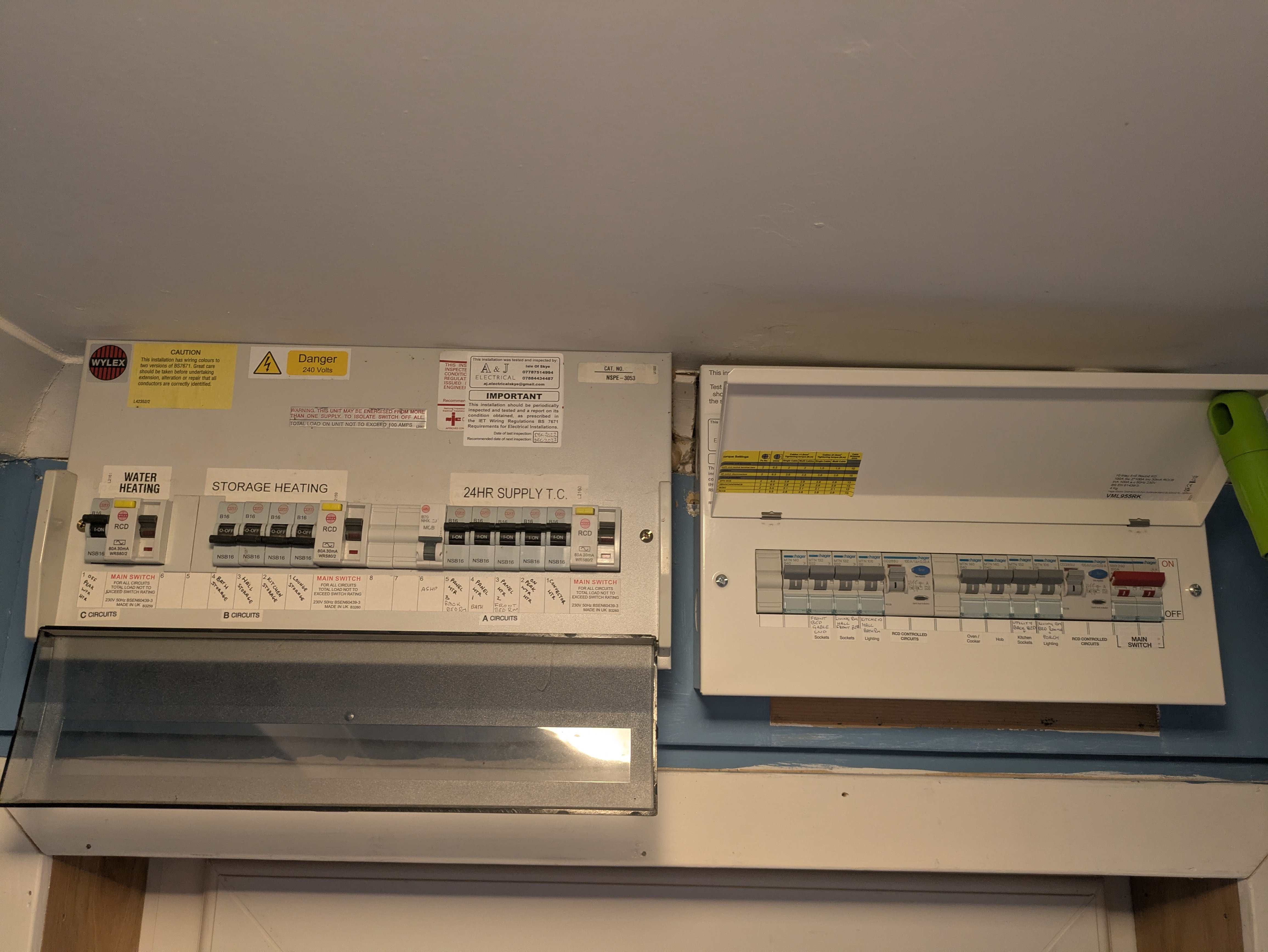

ProDave Posted December 18, 2025 Posted December 18, 2025 Usually when swapping off the THCT system to "normal" E7 the total control CU gets left disconnected, so only the normal house circuits and off peak circuits work. This is because there are only 2 metered outputs on E7 and they have 3 connections, and the meter monkeys won't join 2 together, that is a job for an electrician. How to sort that out depends a lot on what consumer units you have. It was common at the time to use a custom Wylex fuse box split into 3 internally with 3 separate main switches for the 3 different systems. So solutions range from re configuring that back to a 2 system box, or just joining 2 of the feeds together outside the CU with a Henley block. Post a picture of your consumer unit(s) and we can advise. Off peak does not make the sense it used to, the rates on offer just don't seem to make it attractive.
Crofter Posted December 18, 2025 Author Posted December 18, 2025 We have two CUs, the one on the left is the THTC one which is split in to two. I've just had it confirmed by OVO that we will get a single smart meter to replace the dual meters we currently have. I'd have thought that, to change to a single rate tariff, all they have to do is bill me at the same rate for everything. No re-wiring required. And just to complicate things, I want to add a diverter in to all of this. Hmmm.
ProDave Posted December 18, 2025 Posted December 18, 2025 What will most likely happen is the "24 hour supply TC" section will not get connected at the smart meter swap, so that section, your panel heaters and ASHP will not work. Simple to correct. Your meters are separate, outside in a meter box I presume, can we have a picture of that.
