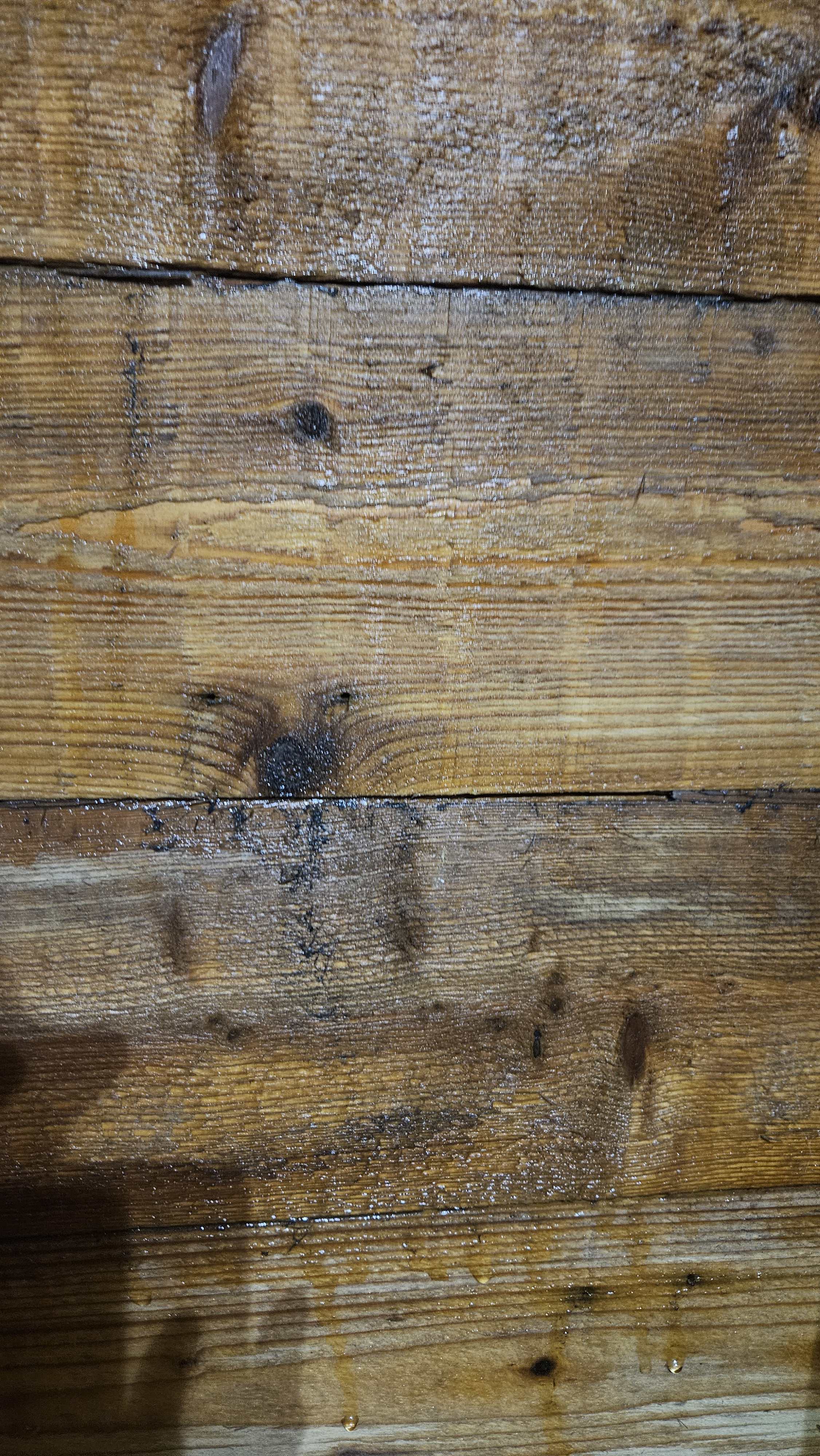

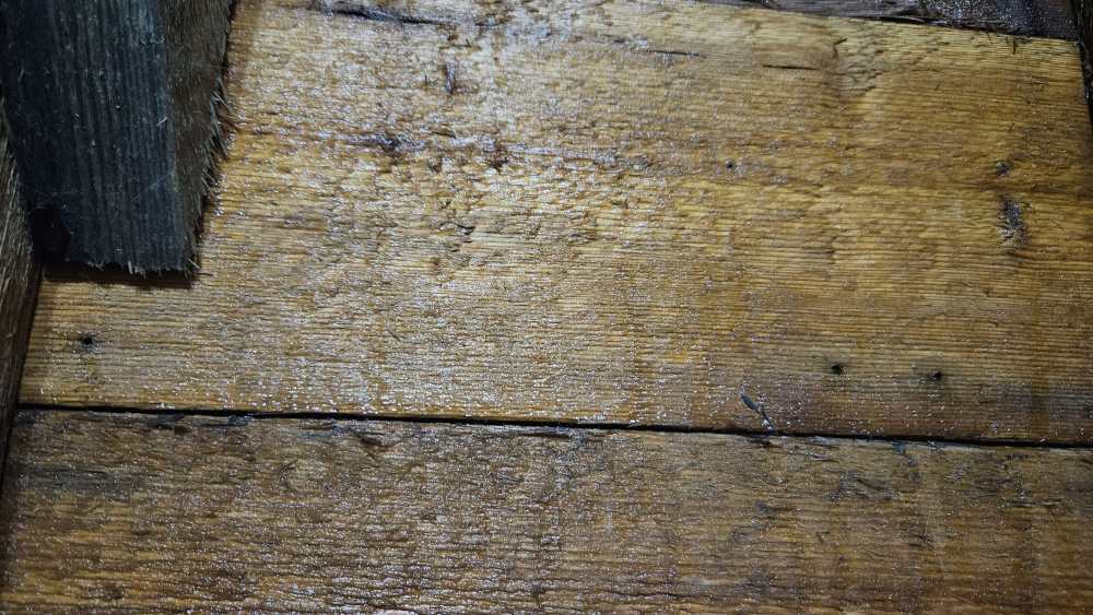

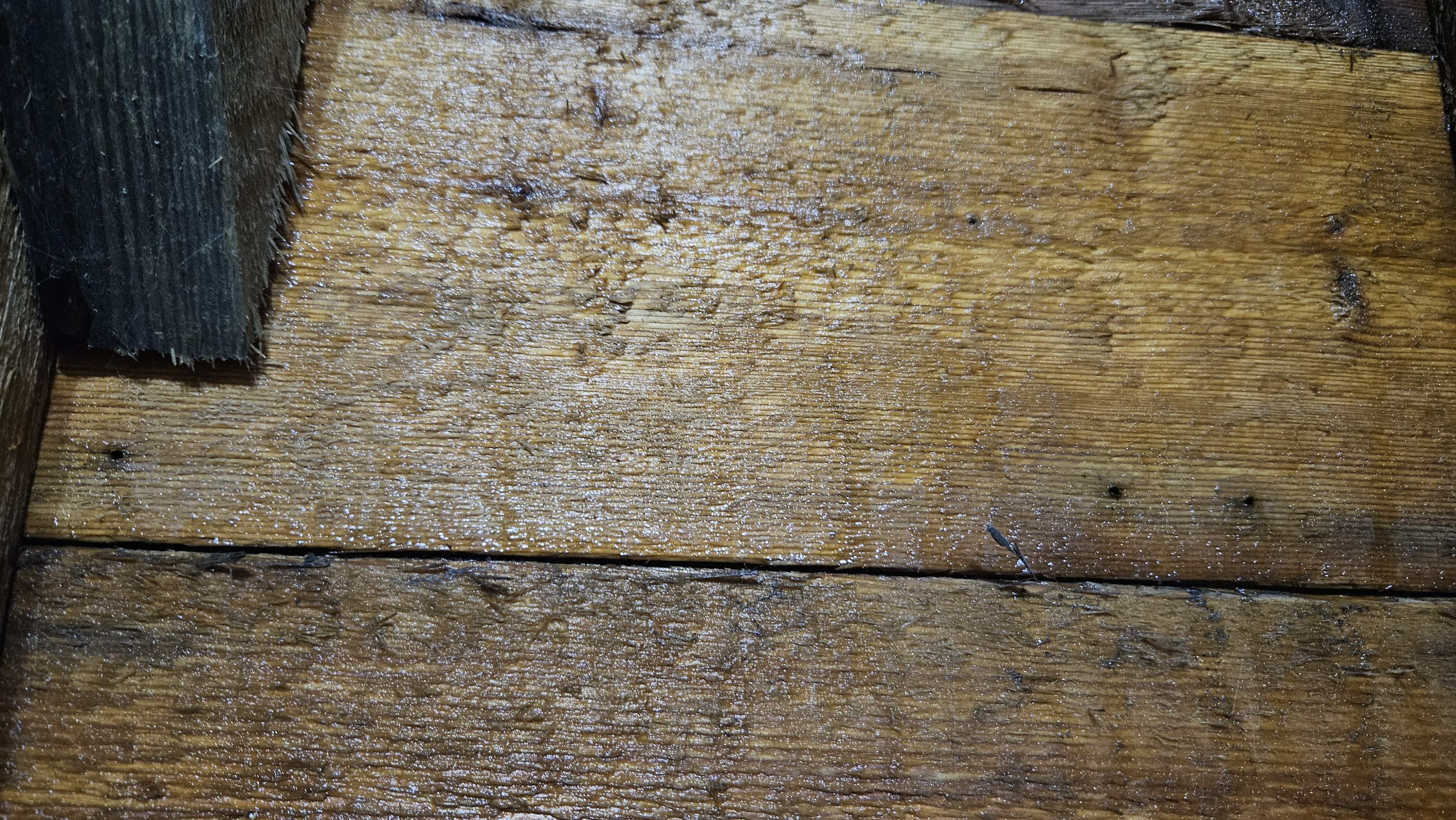

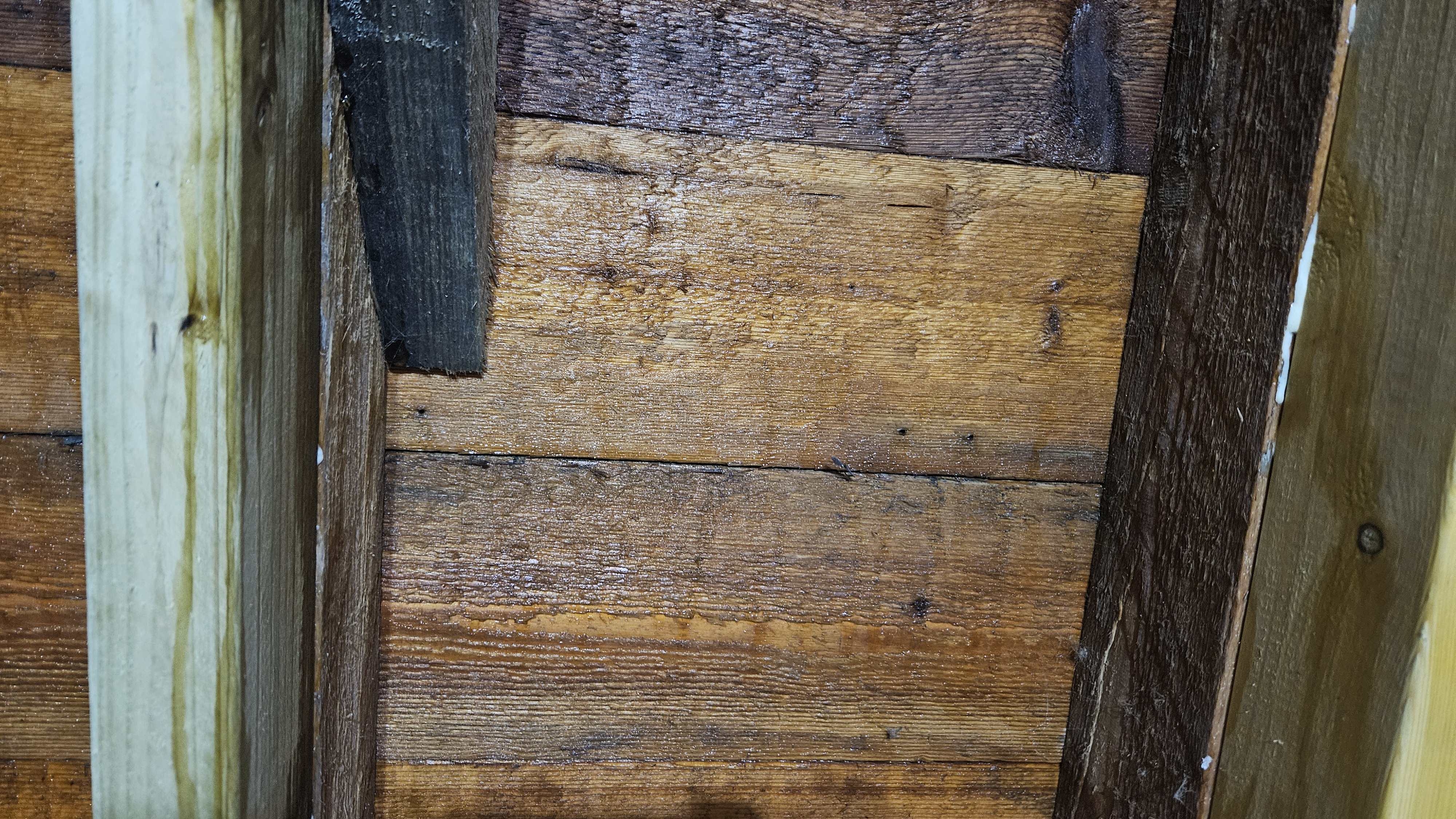

frslam Posted December 17, 2025 Posted December 17, 2025 Hi all, Season's Greetings and all that! Where do I start? I'm refurbishing my old family home. I employed a roofing contractor and he agreed to purchase the materials on my behalf for which I provided all the correct order codes. The roof is approximately 140m2, job entails stripping lightweight concrete slates, fitting new membrane, fascia's, 5 x VELUX windows and re-slating. The price for all of this (not including scaffolding) was approximately £30k. The job was supposed to start mid to late October, allowing the roofing contractor to safely strip the roof before my new windows (£15.5k) were going to be installed. My new windows were installed on the due date of 10th November but the roofing contractor spent the previous couple of weeks giving me excuse after excuse why he hadn't started yet. When he did get around to starting, I provided him with as many sheets of OSB as needed in order to protect the new windows before I headed off for a meeting. On my return, the roofer told me he had damaged a window (the biggest window in the house). I inspected the other 2 windows on that elevation and discovered that he had damaged all 3 windows, at a cost of over £1,700.00. At first he said he would pay for the damaged windows (which I naturally, secretly recorded him saying). I received the quote for the repair and relayed this to the contractor, he said "it is what it is..." before again confirming that he would be paying for the damage. He drove away from the site and after a few minutes he phoned me. He said "just calling to let you know that I won't be paying for the repair of your windows because your scaffolding is not 'up to spec' to protect the windows below it. All I could say in reply was, scaffolding's job is for access and safe working at height environment, not to protect windows. I also asked him why he never used a debris chute to safely discard old slates from the roof. Hi response was "well, where's your skip". (I didn't have one, it wouldn't fit and couldn't be positioned on site because of low overhead electric wires), but the tele-handler on site was used with a big bucket to load the old slates into anyway. The Roofing Contractor starts fitting VELUX windows into framing that had been previously carried out. All he had to do was drop them in and fix them to timber. Then the breathable membrane was installed and finally the slating started (no grading of slates was carried out). I inspected the roof while he wasn't onsite (which was most of the time), and the day before he was due to come back to site I sent him an image on an instant message platform. I needed to inspect the work carried out up until then because we had a storm hit us between the time he left the site and the time he was due to return. This was on a Sunday but we agreed that he'd work Sundays in order to get the job done before the worst of the weather hits us. He didn't actually show up on Sundays, or most other days either. I told him I was unhappy with the membrane fitment, not 'lapping' into the (Scot) Dry Verge channel like it's supposed to, in fact, sarking boards are visible between the membrane and the Dry Verge. His response was to tell me that he couldn't work for me anymore, that he would be in the following day to collect his things. Then came the threats of Court action from him. All I paid him up until this point was approximately £16k for materials and a joiner to work alongside myself. I have to cover myself so went up to inspect his work. The 'cheap' membrane he used on the roof had completely failed or was poorly installed, allowing the rain to soak right through the sarking boards, the water was beading on the inside of untreated timber sarking. The sarking boards aren't a major issue being relatively cheap and easy to replace, what was very concerning was the sheer amount of water coming in, soaking the sarking and all that water starting to soak into all of the rafters. The house had been constructed in the early 1970's and I'd be lucky if the roof timbers were treated at all (against water ingress damage). As it turns out, the contractor ordered the incorrect flashings for the VELUX windows, destroyed the cartons they came in before realising they were the wrong items, then telling me that they couldn't be returned now because the boxes they were in were damaged and not re-usable. I then have to spend another £1k buying the correct flashings ( I had already paid for all materials when they were ordered from JEWSONS). On discovering the wrong items were delivered, the Contractor telephoned the local JEWSONS to report it. They told him, which I heard as I was standing right beside him, that I had gone in to the local JEWSON Depot and changed the order. I did go in to the Depot but when I asked the staff about the order, they told me they couldn't discuss it with me because it was someone else's (the Roofing Contractor's) order. So I get the blame which should be impossible, going by their own policies, and the roofer destroys the cartons containing the materials, meaning they cannot now be returned. I have plenty photographic evidence of all this. I also taken images from the slating side. There are images of the sarking and rafters taken 9 days after the roof membrane was installed, images of the membrane to Dry Verge fitment and images of the slate installation (which I think isn't great, but am I being too fussy? The difference in position (course height) of the slate upper left of the image with the slate to the right of it is approximately 8-9mm followed by another 5-6mm height difference again to the next slate)

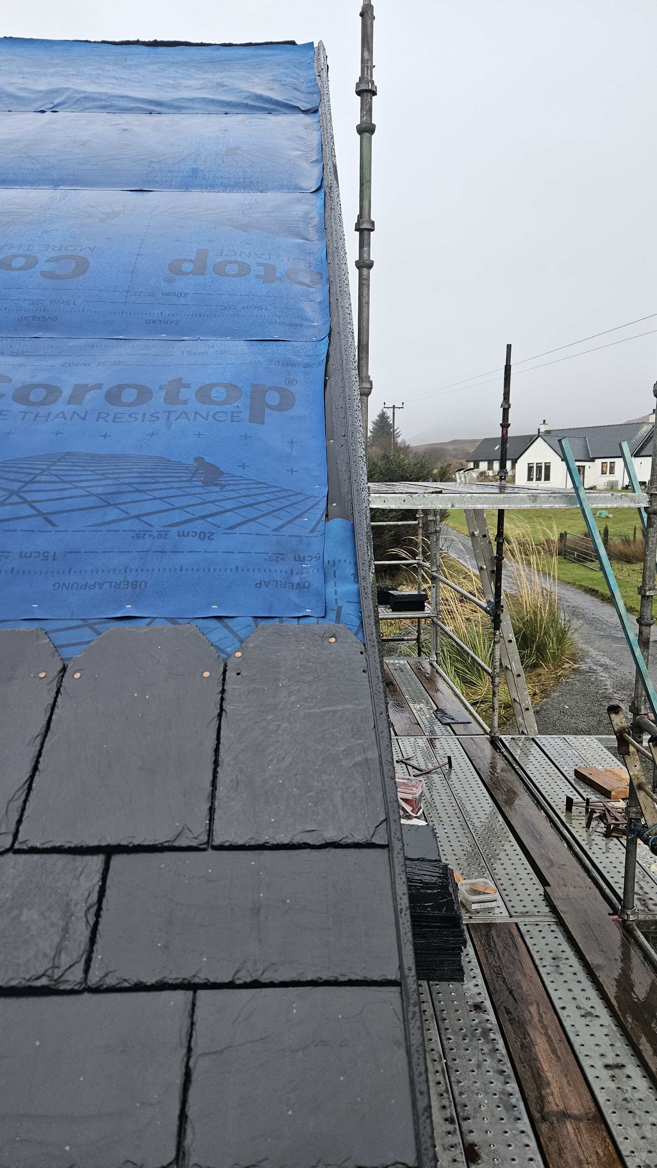

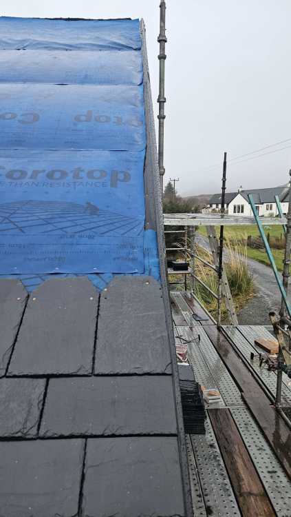

frslam Posted December 19, 2025 Author Posted December 19, 2025 4 minutes ago, Mr Punter said: Is it now the case that the roof is correctly membraned by others, Velux properly fitted and you are waiting on the Velux flashings to complete the roof? Yes. The contract for the roof stipulated Roof Shield. He installed Corotop which is about half the price of Roof Shield (IMHO there's a reason why there's such a price difference) but he was charging me the price of Roof Shield. So I had to remove over 400 slates to re felt the roof, then it was re-covered in what was supposed to be used.

frslam Posted December 19, 2025 Author Posted December 19, 2025 1 hour ago, Mr Punter said: So have you just parted ways, calling it quits, or is one of you wanting some money from the other? He wants money for work carried out to date, around 5 grand but I class his work as totally substandard including wrong membrane and incorrect fitment, poorly fitted slates etc. He caused over £1,700 worth of damage to windows and blamed me for not using scaffolding to protect them, cost me £1,000 to de slate what he'd done and re felt with the correct membrane (we had agreed roof shield - in writing, he fitted corotop), he cost me £1,000 when he destroyed the boxes containing velux flashings for 6 windows (doubles and singles) meaning they could not be returned. He missed out under eaves slate, laid some poor slate because he never graded them at all
Nickfromwales Posted December 19, 2025 Posted December 19, 2025 3 hours ago, frslam said: He wants money for work carried out to date, around 5 grand but I class his work as totally substandard including wrong membrane and incorrect fitment, poorly fitted slates etc. He caused over £1,700 worth of damage to windows and blamed me for not using scaffolding to protect them, cost me £1,000 to de slate what he'd done and re felt with the correct membrane (we had agreed roof shield - in writing, he fitted corotop), he cost me £1,000 when he destroyed the boxes containing velux flashings for 6 windows (doubles and singles) meaning they could not be returned. He missed out under eaves slate, laid some poor slate because he never graded them at all Tell him to get (expletive deleted)ed. 1

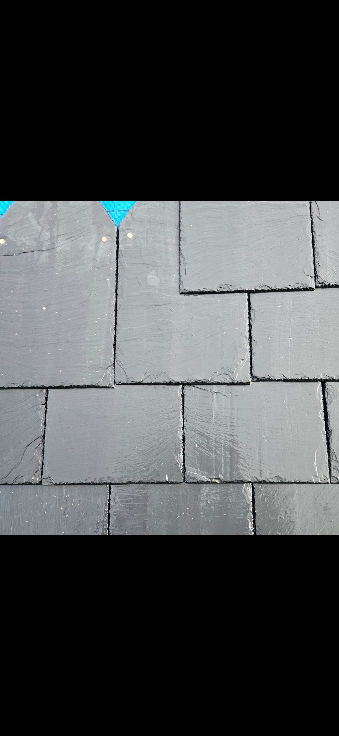

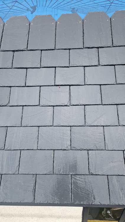

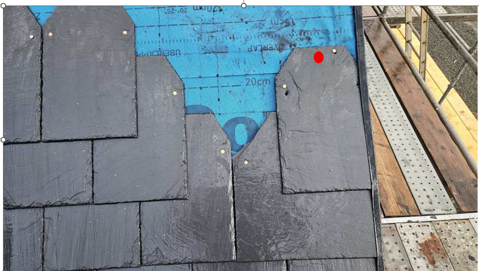

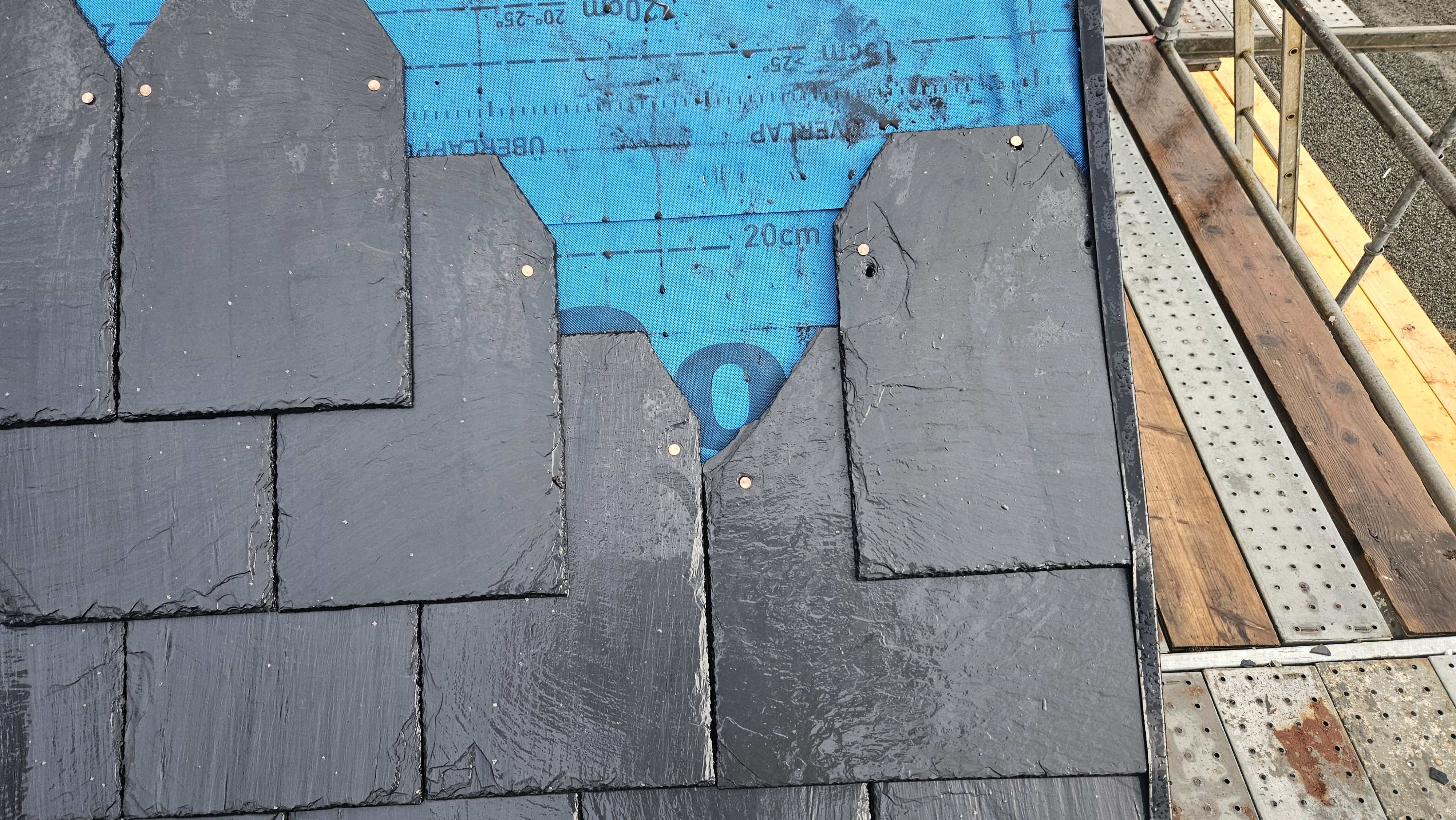

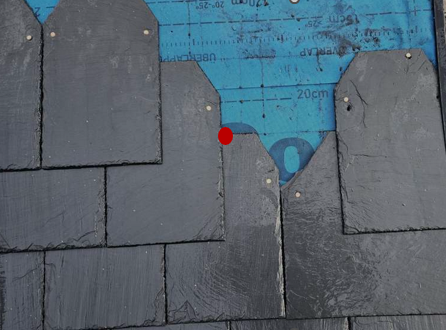

Andeh Posted December 21, 2025 Posted December 21, 2025 Just as a care point, from a total layepersons point of view those slates look neat, lined up and normal. You'd need to explain and evidence what's wrong with them.

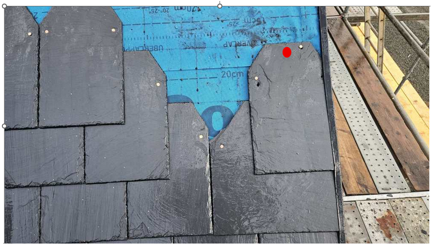

frslam Posted December 21, 2025 Author Posted December 21, 2025 9 hours ago, Andehh said: Just as a care point, from a total layepersons point of view those slates look neat, lined up and normal. You'd need to explain and evidence what's wrong with them. is that the image taken from the verge? If you look at the broken slate and half, the second course of slates above that should give the slate and half a double cover but the broken top left corner goes down so far that it wouldn't be that way, just take a line across from the highest slates. I might be being picky but it's my £30k that's re-roofing the house, I feel that I'm paying premium prices but not getting the product to match. On the image above, where you can see the eaves course, a slate (or half slate) is missing altogether where there was no nail puncture in the membrane or on the eaves felt, so it was never installed. Ironically that corner of the house is looking at the South Westerly direction and gets the prevailing wind. Further, this is CUPA Heavy 3's being installed, all the eaves slates were installed with 1 nail per slate, according to CUPA, 2 nail fixings per slate should be used. Even if they didn't recommend that, I live in the North West Highlands, it's strongly advisable to double nail all slate courses including eaves courses
frslam Posted December 21, 2025 Author Posted December 21, 2025 9 hours ago, Andehh said: Just as a care point, from a total layepersons point of view those slates look neat, lined up and normal. You'd need to explain and evidence what's wrong with them. I stripped the 400 odd slates off that the slater had installed because I was unhappy with the membrane and to be honest with you, with the slating in general. He said that he wasn't going to grade the slates, that they were good enough. I disagreed. While stripping the slates, I found some slates on the higher courses were way more than the 20% tolerance thicker than slates fitted below them. I know it's tricky getting to show this in a photo because the higher the slates are, the more of the riven edge you see, so it's hard to tell on this image but I just didn't like it. I said in a previous message that I expected the quality for £30k, forgot to mention, that figure doesn't include the several £thousand's for the scaffolding

Gus Potter Posted December 21, 2025 Posted December 21, 2025 4 hours ago, frslam said: I live in the North West Highlands, it's strongly advisable to double nail all slate courses including eaves courses Hope this helps to give you a bit of an insight, feel free to discuss. Your Highland location is relative as its very windy often and coupled with heavy rain. But to start from not where you are! In the central belt and in the Scottish borders the general rule is if you were using Welsh, or Norwegian slate (these are a lovely green / blueish slate and very hard wearing, used in Edinburgh on high end houses) say was to single nail every slate but cheek nail every third course. A cheek nail would go where the red dot is below. The head of the slate is kept square. The nail head is big enough to lock onto the side of the slate. All these slates are realitvely thin. A hard Welsh slate can be very durable but workable, the beds split easily in the quarry. You would have a nail in the head of the slate. One inch down as below: Now the beauty of this is that it make the roof easy to maintain. If you get a broken slate then you can turn the slates easily to fix the broken ones. Traditionally folk would get the Slater in every so often to check the roof and maintain, clear the valleys and check any drip type flashingsl for holes, often at low cost. Now along came say the warranty providers. They are looking for say 10 years warranty. Now the cynical might say. See if we double nail every slate as above then the chances of a split slate falling out are slim as it very hard to spot a split slate from the ground. Scotch slates are a different animal. They tend to vary in thickness a lot and are smaller. Because they are thick they are heavier so tend to lift less, parly due to their own self weight and the smaller size increases the density of the nailing. The nails are still one inch from the head so the bending force in the slate is less and this stops the slate from breaking at the nail point. Where this happens is down to the skill and knowledge passed down from traditionally father to son / apprentice. A skilled person will know that eaves, verges are vulnerable, but also around chimneys and the like. The wind in the highlands can be ferocious! 4 hours ago, frslam said: He said that he wasn't going to grade the slates He should have graded them. Cupa's at the very least in my view should be graded into two piles. Thick ones at the bottom, thin at the top. Usually I would grade into three piles. 4 hours ago, frslam said: I was unhappy with the membrane and to be honest with you It's important to understand what the membrane is supposed to do. Traditionally there was no roof felt or membrane. There are many roofs in Scotland that just have slates on timber sarking. This worked traditionally as there was no insulation in the loft and any water that got in quicky dried out. I sometimes get asked this question and am acutely aware that if I'm insulating this kind of roof I need be very careful, call it conservation design. In the (I think) 1930's they developed bituminous roofing felts, often called a type 1F today. These were water and pretty much vapour proof. So to make that work they introduced eaves and ridge ventilation. For all on BH.. Heads up! there was an invention of felt called ASTOS. Folk realised that you could use bitiminous felts for flat roofs but they burnt well. So they included asbestos. The clue is in the name. Your membrane is NOT intended to stop water ingress it's mainly there to stop wind driven snow, odd water mist and to let the roof breath. It's not like 1F felt and never has been intended to do so. 1 hour ago, frslam said: looks like I'll have to take legal action Your starting point is to really understand the mechanics behind this, how your roof was supposed to work and then why it's not. Legal action is the last resort. But before you even go there you need to check that the roofer has some assets you can go after. With a fair wind if he is not limited and has other assets, other than a marital home. Seek legal advice pronto before going down this route.. to freeze assets say , that is not free and if you do it maliciously then the builder will come after you! Don't discount this. I had a Client that got trading standards involved in a case where the builder had been fradulent. If your roofer has stated that he has supplied, installed materials and billed you for it and it turns out that he never actually supplied the materials then that is fraud. Trading standards were supportive (the builder was already known to them as a chancer) so it might be worth calling them up to test the water. In summary though, you need to work out and check all your flashing and slate details and work out why the roof is failing in the geographic location, yes I know it's not finished. 2
Gus Potter Posted December 21, 2025 Posted December 21, 2025 (edited) To add an unfortunate bit. Your verge closure seem incorrect. The vapour membrane should be under these. Traditionally these slates should be undertailed. Rather than write at length about this I've used AI and checked that what is says, I agree with. Copied below. I am of the view and have always done so when slating roofs in my last life as a builder that the verge slates should be tailed as well. In your Hhighland location we need to make use of every trick and technique. I wonder if your roofer can even beging to address some of the issues? AI output: The traditional method for "tailing" slates in a valley refers to a specific cutting and laying technique where the bottom edge, or tail, of the cut slate is inverted to direct rainwater away from the vulnerable valley lining and back onto the main roof surface. This is a traditional craft skill that employs the principles of capillary action and surface tension to manage water flow effectively. The Mechanics and Importance of Traditional "Tailing" Understanding how this intricate system works provides insight into the mastery of traditional slating. It's a method born out of necessity, predating the common availability and reliance on extensive lead flashing, and it continues to be valued in historic building conservation. Capillary Action and Surface Tension: The technique relies on the natural properties of water. When a slate is cut, it exposes a sharp edge. Normally, water might cling to this edge or be drawn underneath the slate due to capillary action, potentially dripping onto the underlying valley lining (often lead) or the roof structure below. The Inverted Cut (Tailing): To counteract this, the slater takes the slate that is to be laid on the rake (the diagonal line of the valley) and essentially cuts its bottom edge as if it were the top edge (head) of a slate, or by flipping the slate upside down to make the cut. This results in the exposed, raw edge facing downwards, towards the eave, while the smoother, "dressed" (original) edge or a specifically angled cut faces up and into the valley. Water Shedding: This subtle inversion of the tail ensures that water running down the face of the slate forms a meniscus and trickles along the surface, shedding water back onto the top of the adjacent, lower slates and ultimately into the main flow channel of the valley, rather than dripping inward or compromising the integrity of the lead lining. Why This Technique is Crucial The 'tailing' technique is not just about aesthetics; it has substantial structural and protective benefits: Protection of the Valley Lining: By actively shedding water away, it reduces the amount of direct impact and continuous moisture on the lead or metal valley gutter, which helps to extend the lifespan of the metal and prevents premature wear, corrosion, or pinholing. Frost Protection: A sharp, exposed edge of slate is more susceptible to frost damage and general maintenance-related damage. The 'tailing' method protects this vulnerable edge by tucking it or angling it in a less exposed manner. Preventing Infiltration: The primary goal is enhanced weather resistance. Traditional slate roofs are "water-shedding" systems, relying on gravity and precise overlapping rather than being a fully watertight membrane like some modern low-slope roofs. This meticulous detailing at the vulnerable valley intersection is essential for preventing water ingress into the building structure below. Traditional Valley Construction Traditionally, valleys were formed using skill and ingenuity before the widespread availability of modern materials. The slates in the valley would typically be laid over a robust wooden valley board, which was installed flush with the rafters. A metal lining, usually lead, was placed over the board. The slates from each intersecting roof slope are then cut and "tailed" to meet the valley line, creating a clean, weatherproof junction. Common traditional valley types also included: Double-cut valleys: Slates on both sides were cut to overlap a narrow strip of slates laid up the centre of the valley. Single-cut or half-swept valleys: Where one side (often the steeper pitch) was cut, and the other side's slates were swept across the intersection. The 'tailing' technique is a testament to the high level of skill involved in historical slating, showcasing how traditional builders achieved durable, long-lasting results through an intimate understanding of materials and physics. In summary, 'tailing' in traditional slate valley construction is a superb example of how traditional crafts incorporate subtle yet vital techniques to manage water flow, protect materials, and ensure the overall longevity and weather-tightness of a heritage roof. Edited December 21, 2025 by Gus Potter 1
frslam Posted December 21, 2025 Author Posted December 21, 2025 24 minutes ago, Gus Potter said: He should have graded them. Cupa's at the very least in my view should be graded into two piles. Thick ones at the bottom, thin at the top. Usually I would grade into three piles. It's important to understand what the membrane is supposed to do. Traditionally there was no roof felt or membrane. There are many roofs in Scotland that just have slates on timber sarking. This worked traditionally as there was no insulation in the loft and any water that got in quicky dried out. I sometimes get asked this question and am acutely aware that if I'm insulating this kind of roof I need be very careful, call it conservation design. Had the roofer come to work and done the roof when he agreed to, there would likely not have been a problem. On good days when you could get a lot done, I understood from others that the roofer may have been enjoying his favourite sporting pursuits. The membrane issue ended up being a bigger issue than it should have been. The roof was letting in far too much water even 9 days after it was installed. The 9th day was the 14th December. Turns out the VELUX flashings aren't available until the middle of January 2026 so that's a long time to have the roof in that condition, there are 4 tall VELUX windows on the front elevation so it would have been limited as to how much slating could have been done before the flashings arrived. The ungraded CUPA H3's were a problem. I own another house opposite the renovation which was slated in 2010 by a craftsman, when it was built. Pizzaro Paramo's (please excuse spelling) were used on that job and the difference between using ungraded and graded slates is quite stark.
