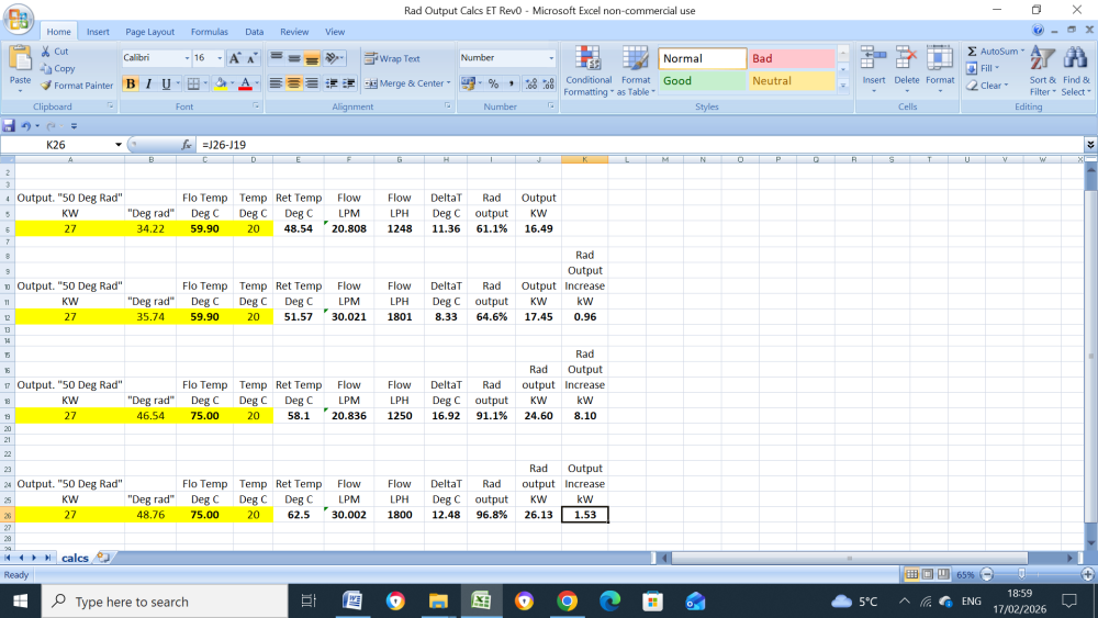

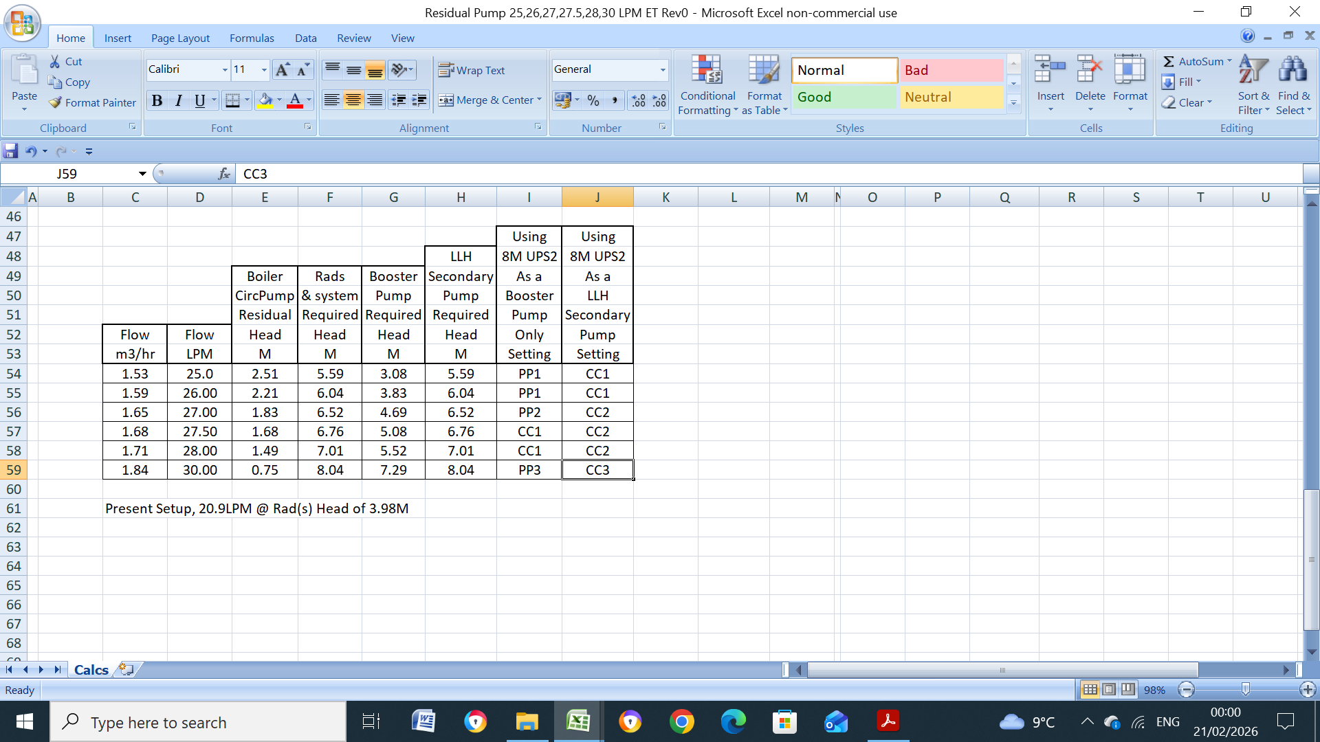

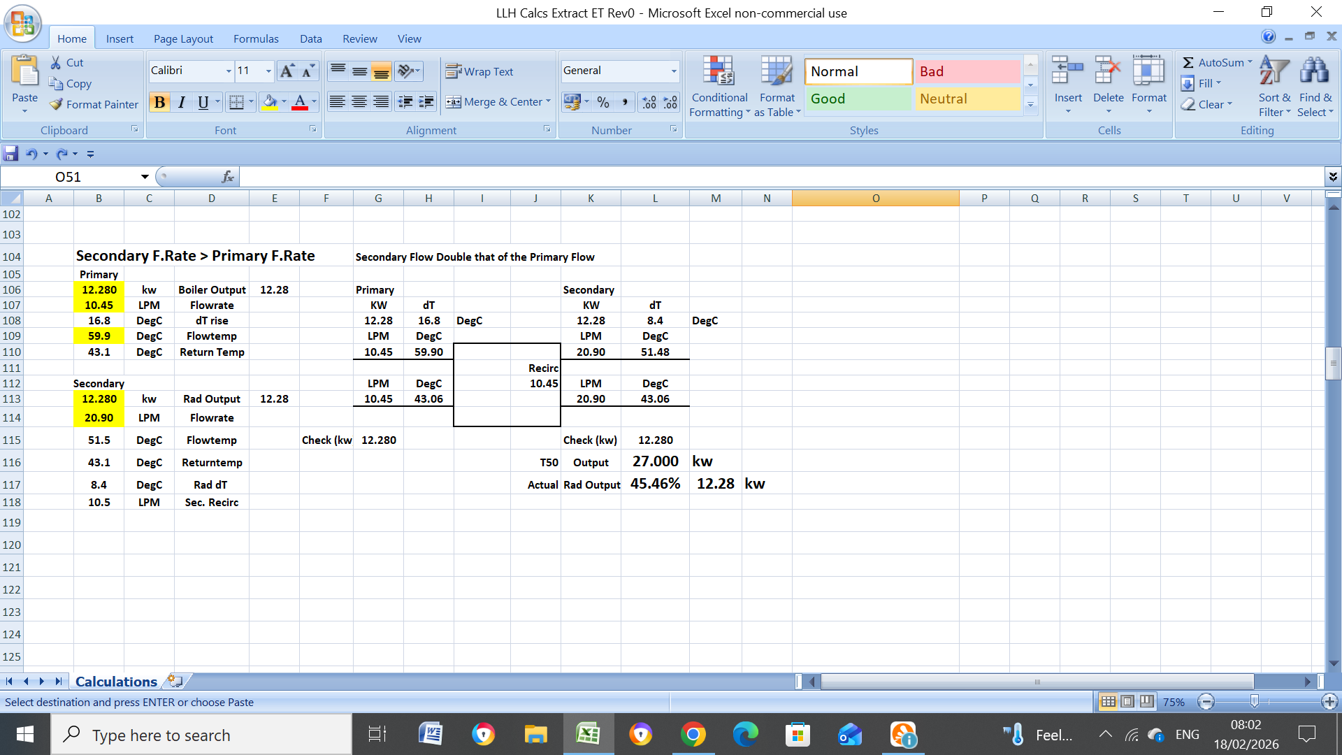

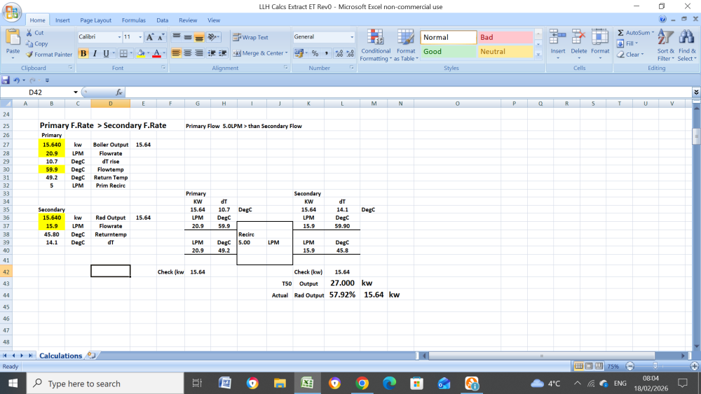

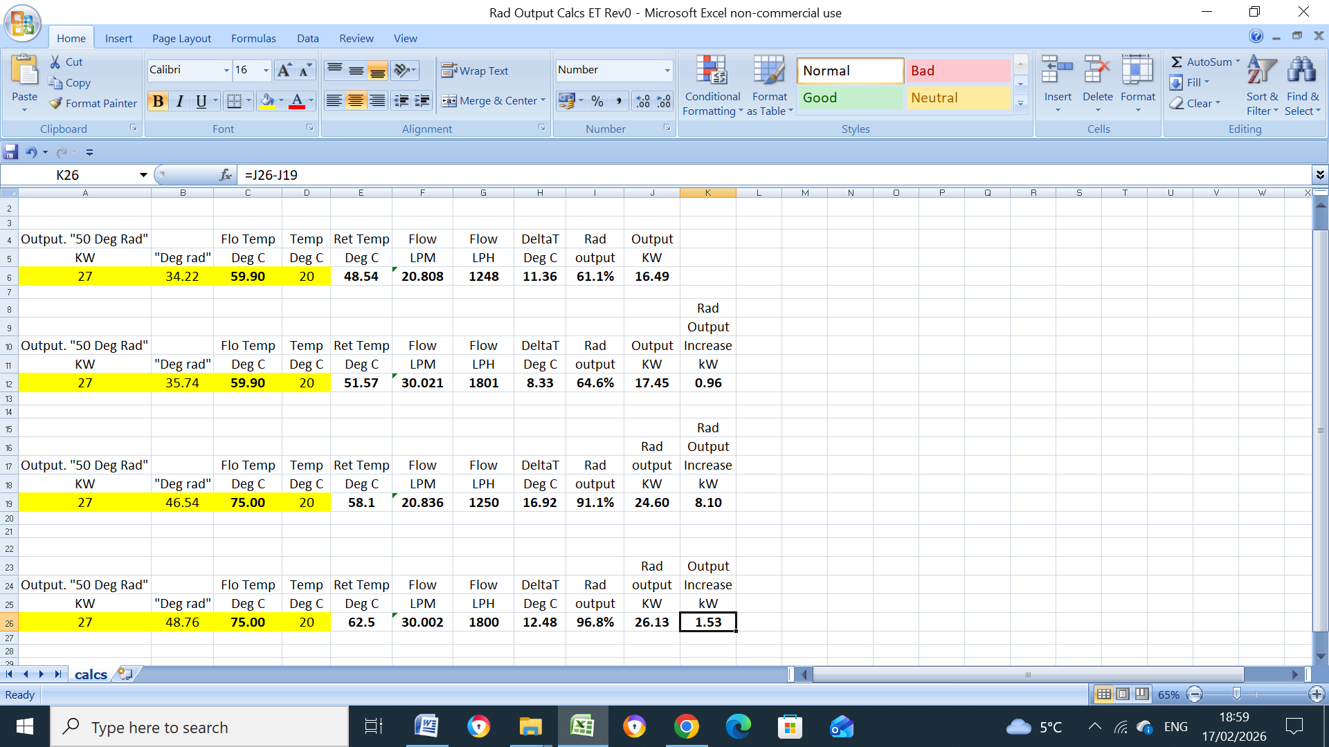

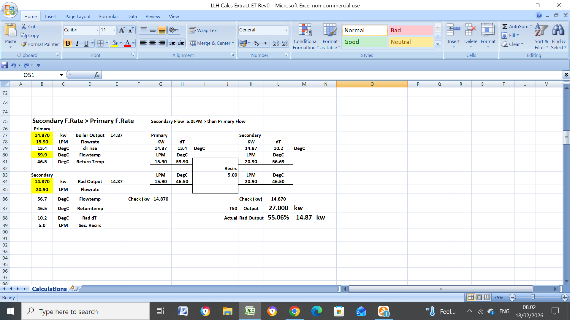

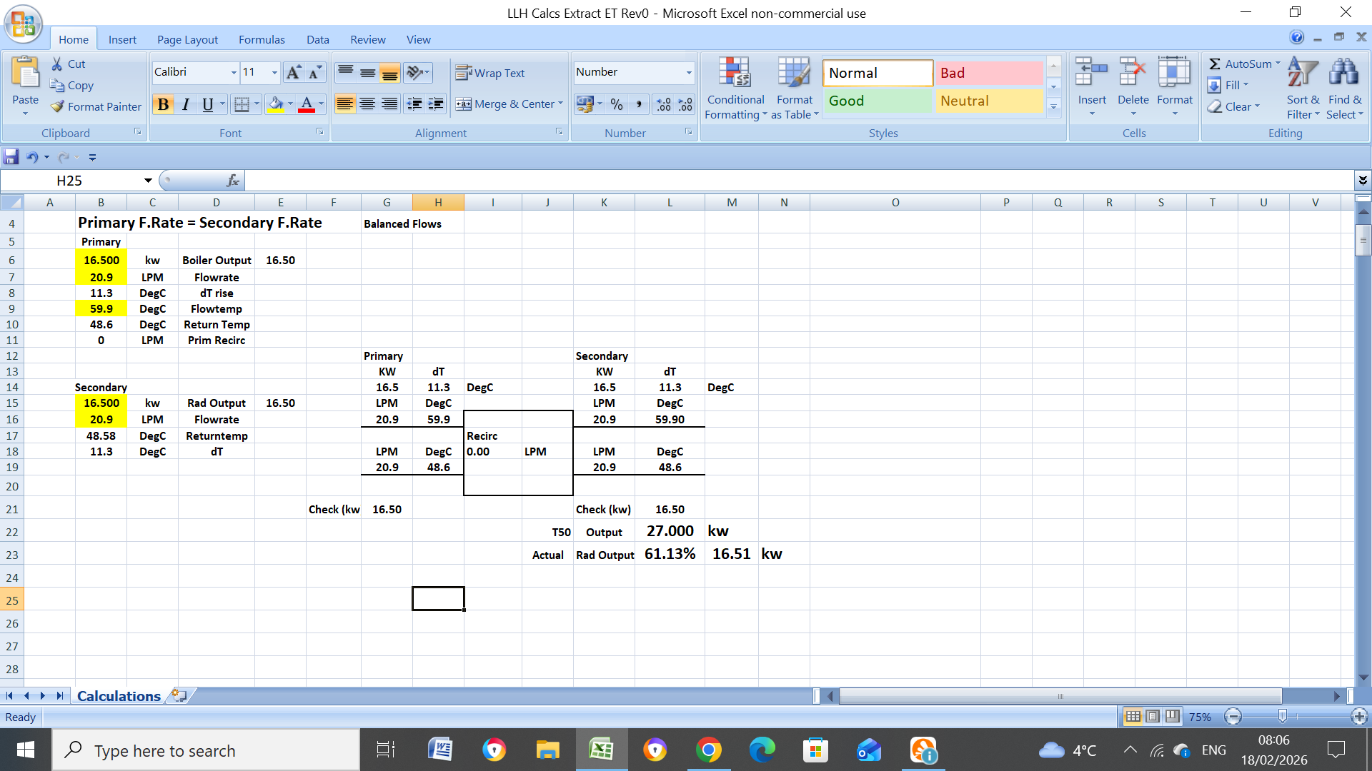

Had a look at installing a 6M Wilo Yonos Pico as a booster pump. It should, IMO, provide a modest boost in flow from 20.9LPM to 25LPM or slightly higher, might not seem a lot. but if your problem is getting a higher flow to a few cooler rads then it may be beneficial because the residual pump head now available to the rads should rise from 3.98M (398mb) to 5.7M (570mb), a 1.72M (43%) increase.
