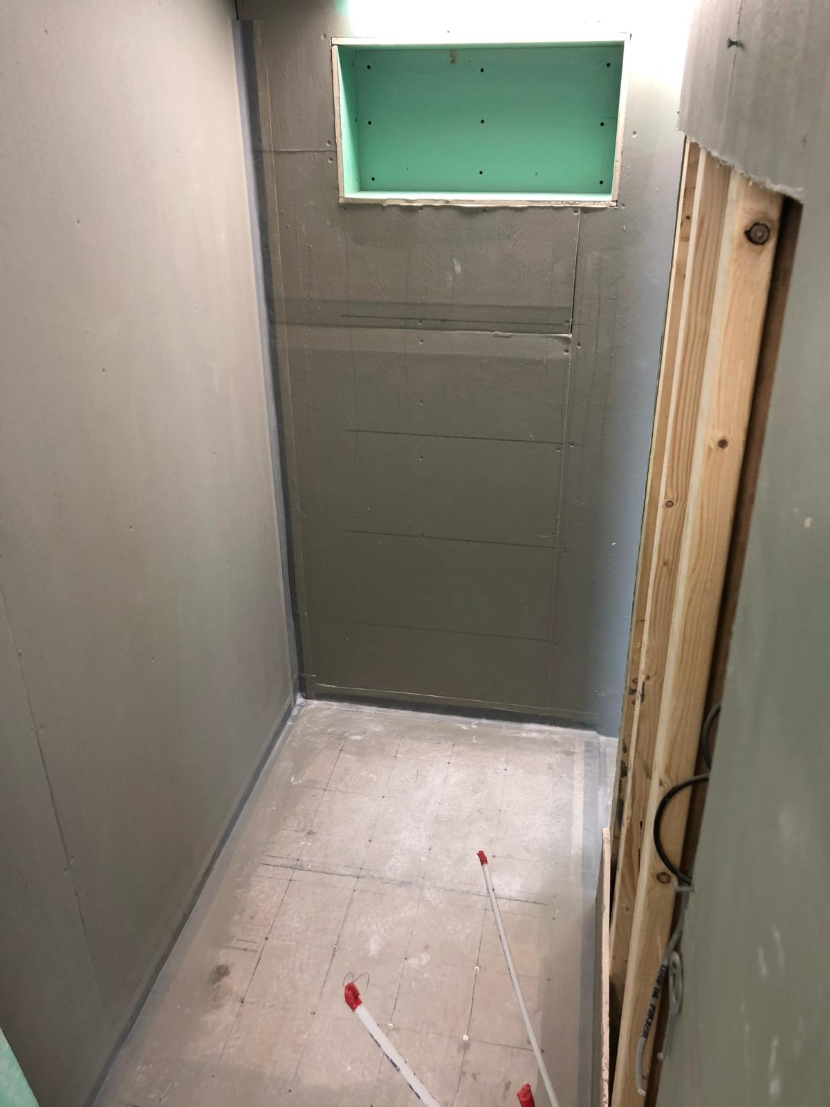

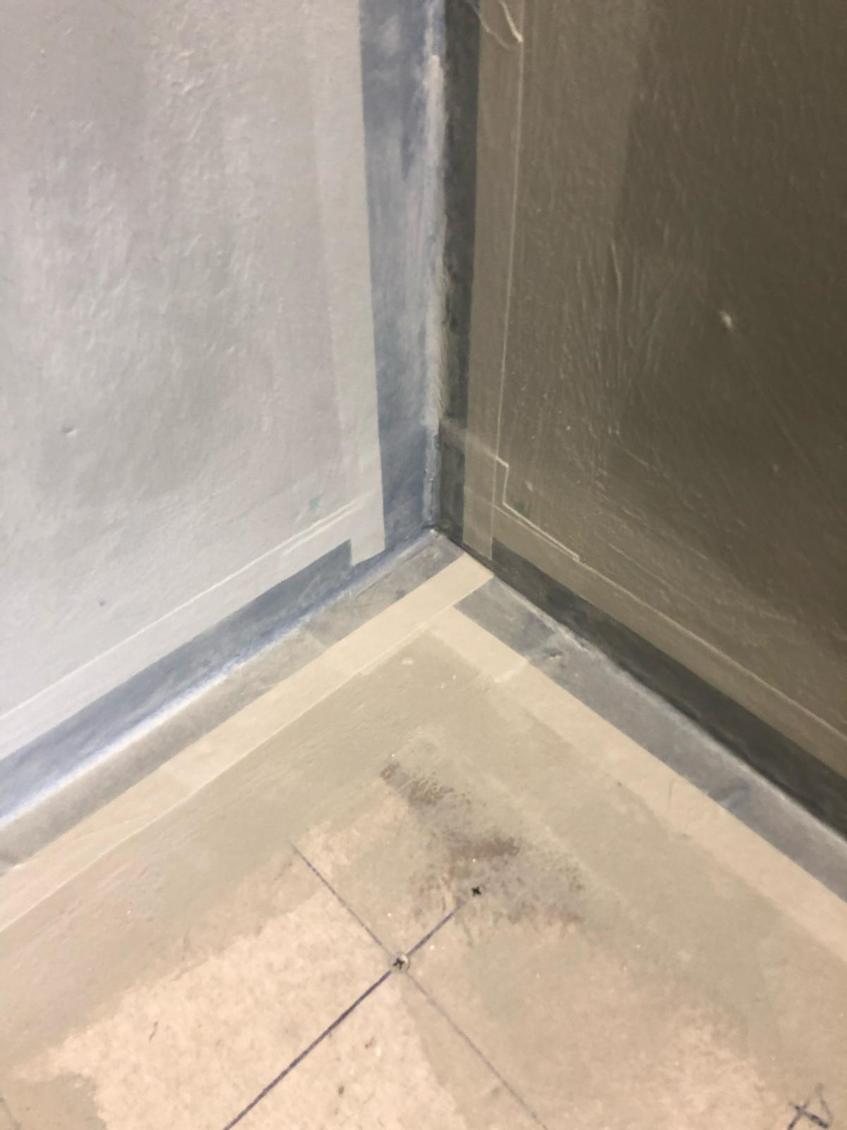

? You mean a tanking membrane? Why bother, and just buy liquid tanking kit(s) and keep brushing it on in opposite directions until you are happy. Bombproof, and the joints get done with the strips or a roll that come with the kits:
LINK
And tile straight over the tanked plasterboards.
I’ve never used anything other than plasterboard. When lathered over with tanking, you can keep Koi in there.

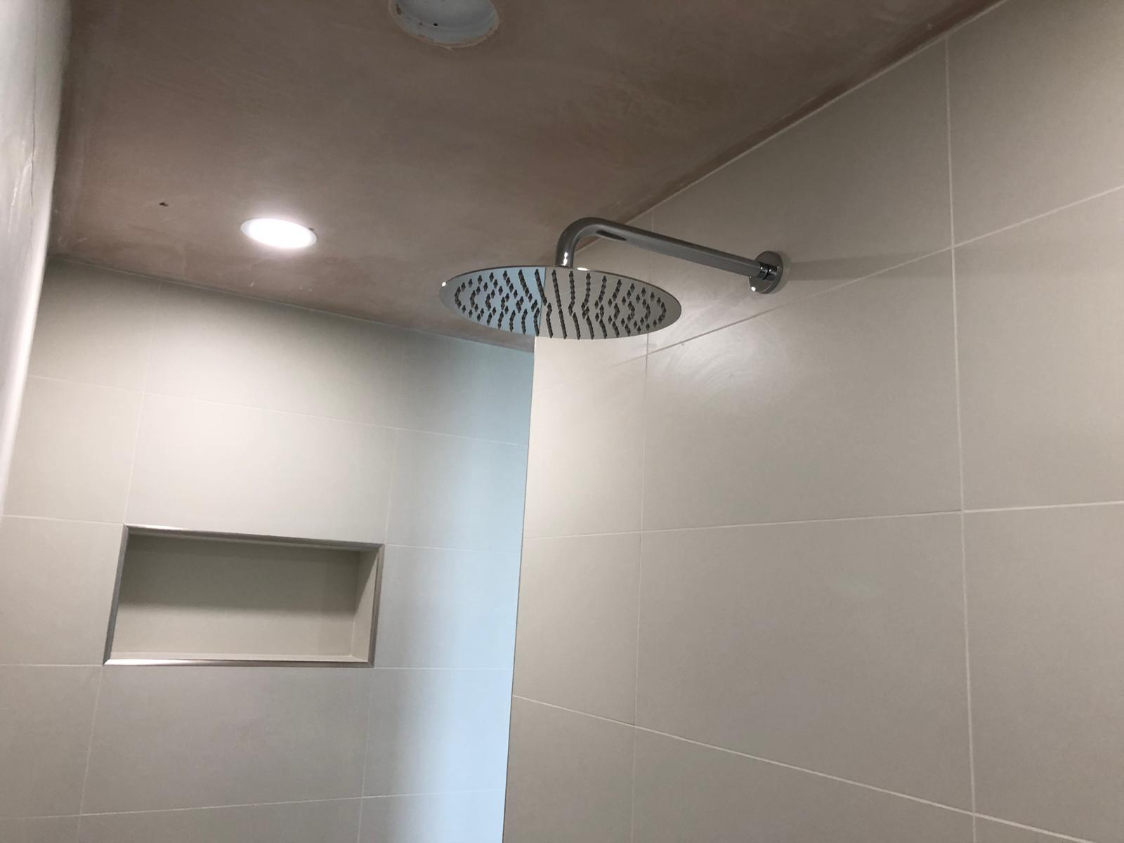

I don’t plaster where I’m going to be tiling, ever. Waste of money afaic, and tanking loves to stick to plasterboard, and so does tile adhesive.
Thanks @Nickfromwales - those pictures look great. It's my first wetroom installation and I'm nervous of making mistakes, so I might be a bit belt and braces (and holding the waistband with both hands) with it.
