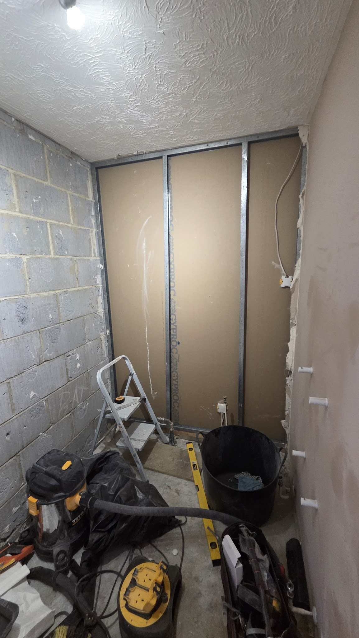

In my bathroom I'm replacing I have got a stud wall I will be housing a shower, basin and most like porcelain lumps of tile!
Advice I need if anyone can help is;

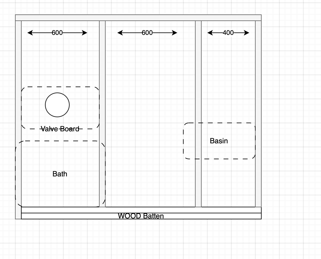

-I need to put on a shower board as I would like to be going concealed
-Will adding in C Stud be needed here to be safer than sorry?
-If I do add stud the wall adjacent is already there and screwed in with 12mm PB. How do you deal with this? Screw from the inside of the Stud with small screws towards this wall so it just goes in the PB?
For wall I'm thinking I will either be using Tile board or some Hardie that's tanked.

Why do you think it needs reinforcement
the weight of the tiles is determined by what base board you fix too, not the stud strength, do you have a picture of it.
unless it’s been butchered before it’s probably strong enough.
you could add extra noggins into areas that will have fixings, or you could sheet it with plywood before you board it.

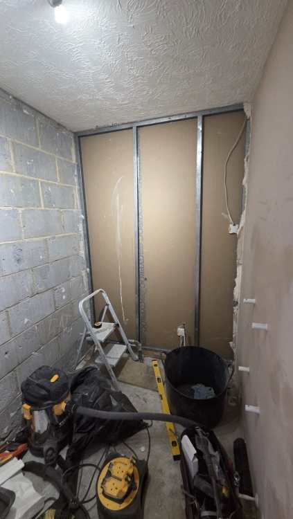

Thanks. Picture attached.
I will be doing nogs to support the fixings yes, builders on original build used leftover floorboard lol
It's a DIY project and the first hence the caution!
