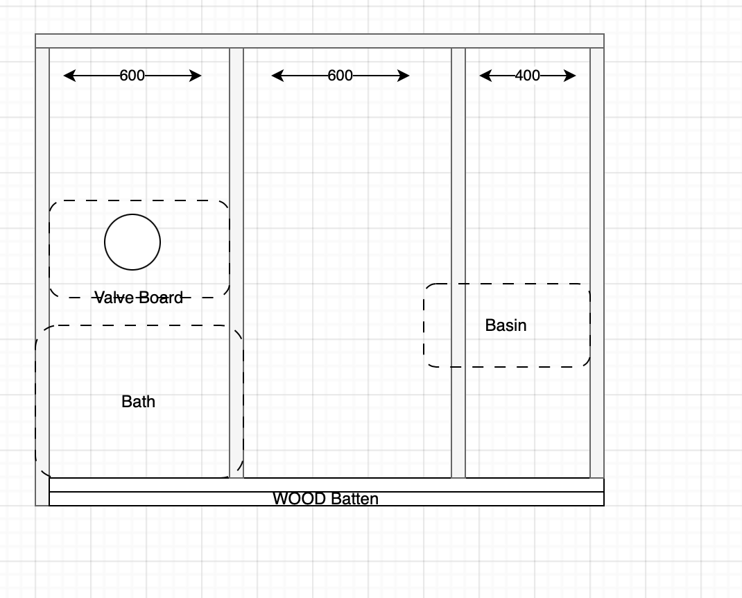

Nick when can you start on my job as I'll probably be finished by June at this rate lol. I see what you mean about piping, I'll be overlapping the pipe run and im going to be using Pushfit so throws thickness of ply out. Looking this morning I'm just about to buy this plate https://www.plumbarena.co.uk/product/abacus-easi-plan-universal-shower-valve-fitting-plate-epfp-05-3005/?gad_source=1&gad_campaignid=21120514031&gbraid=0AAAAADtJBDoeHhMCLjeUK4FC2lrF_Qksj&gclid=Cj0KCQiA6Y7KBhCkARIsAOxhqtP1ohFy0mOf-5zB5qx8SJeuu7FTAlUho74Upi9bA6eaf1QVWLH5lnMaAjeREALw_wcB That means I won't be on Plyboard for the Pattress but im assuming very thin frame here. I can't find any dimensions on depth of this thing. Maybe better as an option ?
Hi, I was posting in the thread about extending stud. Maybe more appropriate in this section is whether the options are actually suitable! Does this work for concealed valve to a minimum line fitting?

Hi, I have taken down Plasterboard to prepare for a concealed shower. I have metal stud that is 50MM The current wall is PB on the adjacent room already screwed into the Metal stud. My depth is 50MM, a concealed valve will need about 75MM to comfortably have a patress/batten to put the valve on and room to pipe in. The other issue is I need 1700mm for the eventual bath. Being a DIY idiot I'm not sure what is going to be the most viable. I do have other options to conceal the shower which involves channelling breeze, this is preferred but never done this before, and also if it (Ever) went wrong on the stud wall I can get access from behind. I wish I had a bigger bathroom lol

In my bathroom I'm replacing I have got a stud wall I will be housing a shower, basin and most like porcelain lumps of tile! Advice I need if anyone can help is; -I need to put on a shower board as I would like to be going concealed -Will adding in C Stud be needed here to be safer than sorry? -If I do add stud the wall adjacent is already there and screwed in with 12mm PB. How do you deal with this? Screw from the inside of the Stud with small screws towards this wall so it just goes in the PB? For wall I'm thinking I will either be using Tile board or some Hardie that's tanked.
