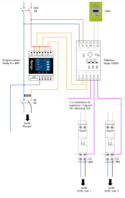

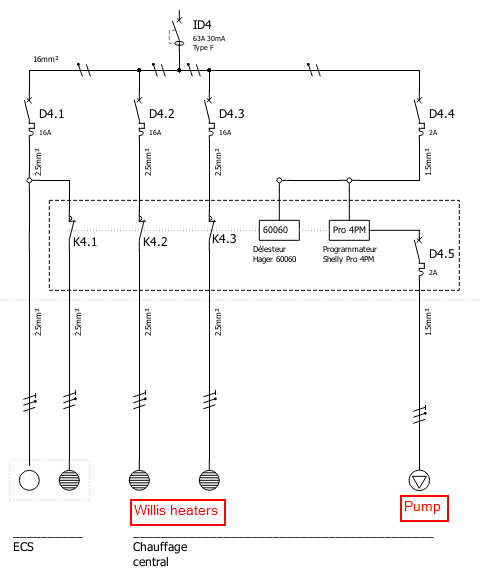

For the second winter in a row, my Wilis UFCH is operating manually, but by next winter it will be more sophisticated.
A Shelly Pro 4PM will be capable of scheduling the days and times to switch on and off & providing remote control. Upstream of the Shelly there will eventually be a Raspberry Pi which will calculate the heat required, monitor temperatures and command the Shelly (which will become a fall-back in case the Pi is out of action). Either way, the Shelly will send control signals to a pair of 25A contactors (one for each* Willis heater) and will directly control the pump (since that draws little current).
A Hager 60060 load-shedder will temporarily cut the contactor control signals if the mains supply is under heavy load, but in your case, @Antonb182, that would be the place to put a thermostat. However, note that with UFCH isn't as reactive as radiators - there's a significant time lag between heating the floor and the air reaching the set temperature that you'd need to take into account to avoid overheating.
Schema + sketch below. All the this (excluding the Pi) will take up one row of my consumer unit. D4.4 & D4.5 in the schema = D21 & S1 in the sketch; not got round to updating that...
Schema1.png.0af2b8263fe65843c2c08465e0a63dcd.png                                  Schema2.png.ab22b2525fd4620d7dedca8e7a972472.png
*Although I could heat my place with 1 Willis heater, I've chosen to install 2. That's partly to have the option to use both to load the floor with heat during off-peak hours, but mainly so that I can switch to the second if the first should fail.

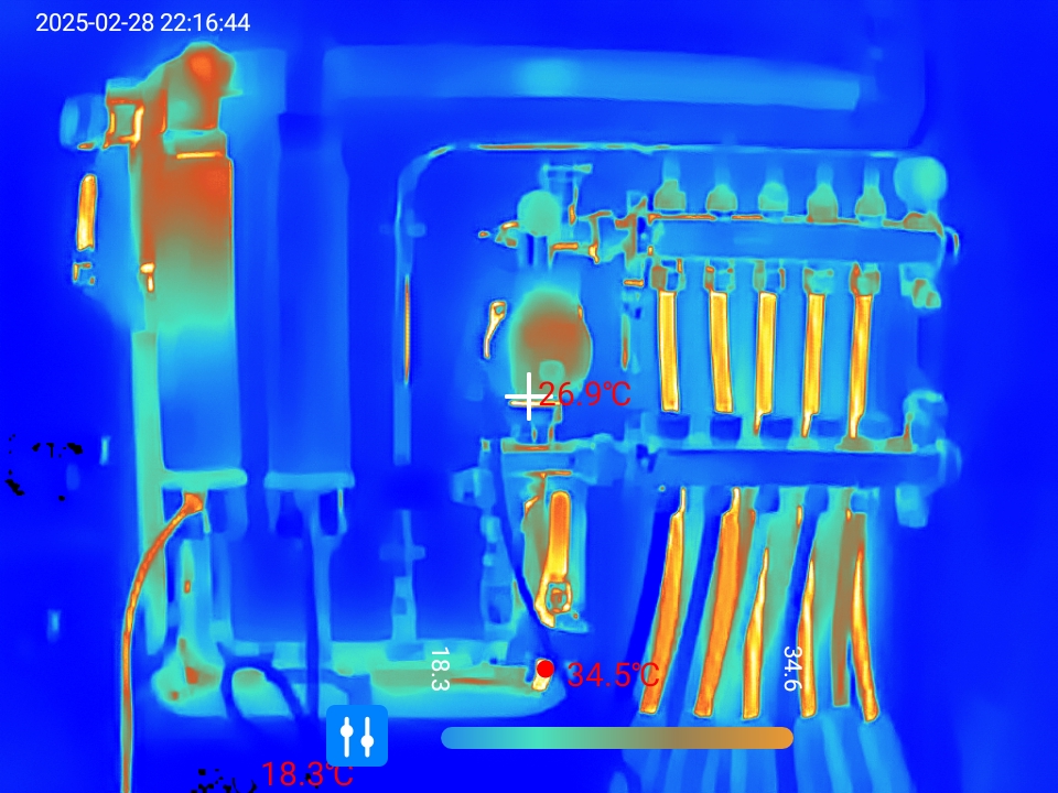

I have a mixing valve too, but only to prevent high temperature water entering the underfloor pipes in case someone mistakenly sets the Willis thermostat too high. It's therefore set to 50°C, not the target flow temperature. But it will still mix the water temperature down a few °C as mentioned by @JohnMo.
IR image below. With the Willis thermostat set to about 30°C the water coming out of the Willis at 45°C-ish and entering the floor is about 35°C. Other temperatures are misleading as some of the pipes are insulated.
The stats probably read at the lower cooler section of the heater, so you’re correct in that you see the output temp being much higher than the displayed set temp.
What you need to do is dial these back in live play, to get the output temp that you require, using the stat as a ‘volume control’ vs using the markings denoted on it.
