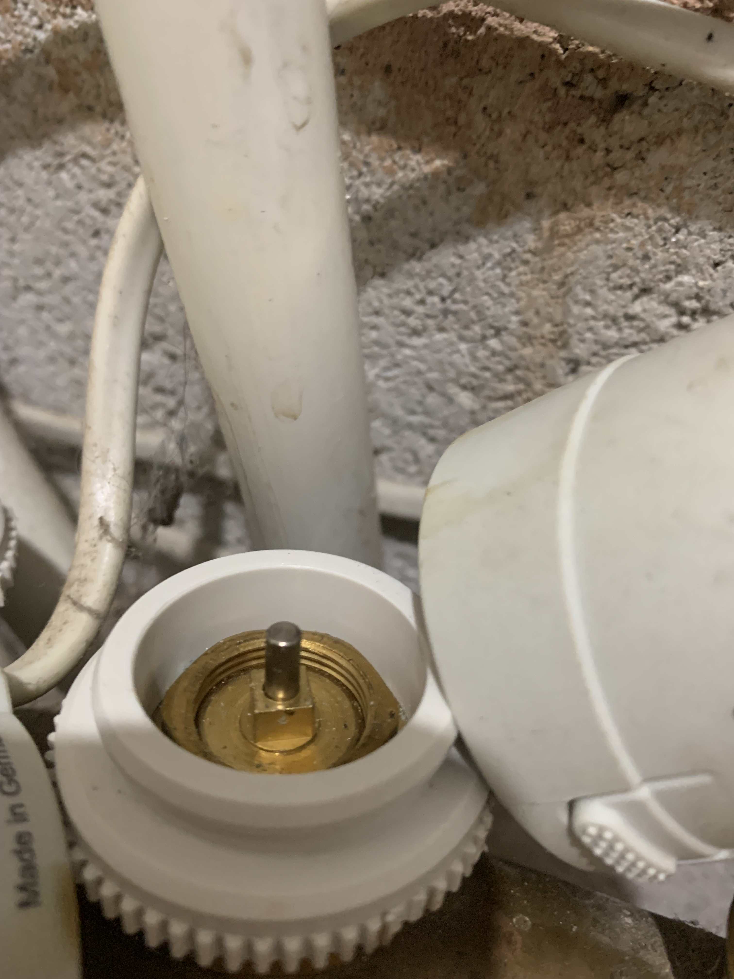

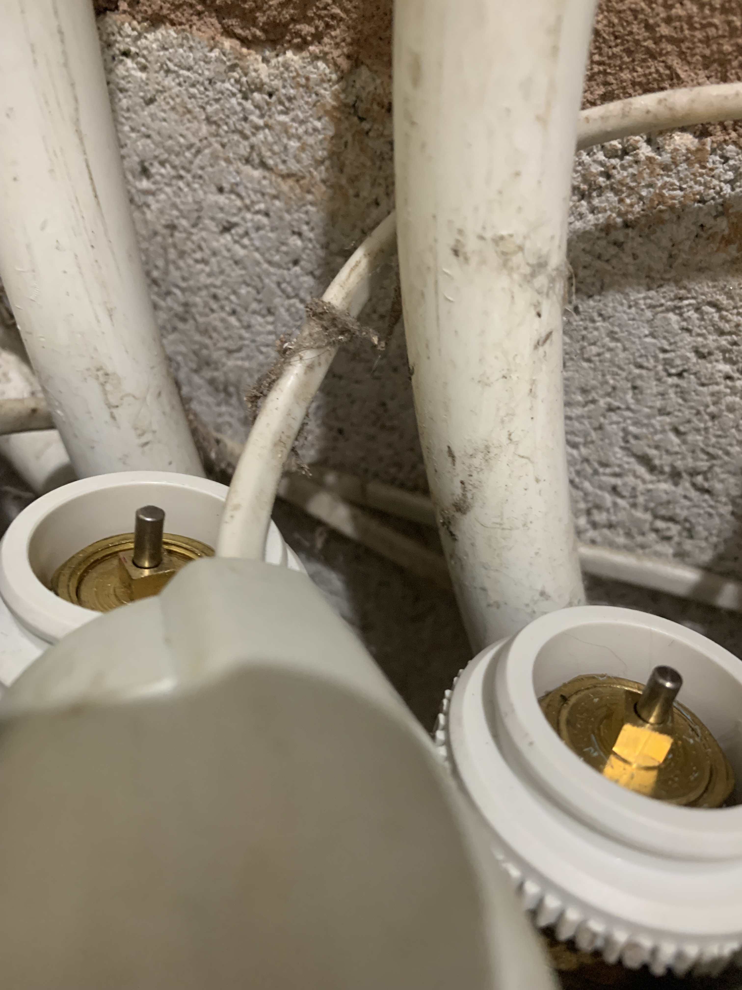

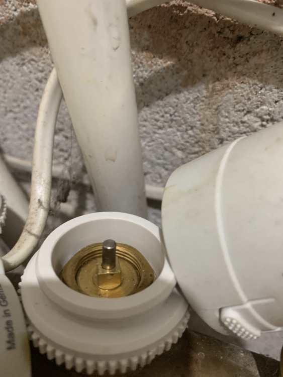

December 3, 2025Dec 3 Author Hi, thanks for the replies. Really appreciated. Sorry for the late response, my daughter isn't well so I've been preocupied. JohnMo, I've taken off the actuators and the red markers don't move. Should they start moving soon after removing, or should I leave them for a few hours to be sure? One thing I have noticed is that, although the pins move, the part that surrounds them (sorry I don't know what that's called) is much lower down than the working ones. Photos attached. Gus, I'm trying to find a manual on the system but finding that difficult. I haven't had to purge the sytem before so not sure what I'm doing. The plumber that fixed the system is no longer available unfortunately. Trying to save myself a little money and fix myself if it's straight forward enough. Watching videos online it seems pretty easy other than re-pressurising. Thanks again. Edited December 3, 2025Dec 3 by JDAB

December 3, 2025Dec 3 38 minutes ago, JDAB said: JohnMo, I've taken off the actuators and the red markers don't move. Should they start moving soon after removing, or should I leave them for a few hours to be sure? The red marker move down to. indicating flow had started. They move in response to water flow. The brass thread section with the pin at the centre sets your flow rate. Would assume screwing upwards increases flow. So it may be worth screwing outward (take note of how far you move in number of turns) watch the red marker if that starts to move that may be your issue. If the red marker hasn't moved after a few of turns that isn't the issue. You are most likely looking at air in the loops. To get things moving. Go round each room and turn off the thermostats (or set to lowest setting), once all are off the pump will stop. Now go to one problem room and set the thermostat on. Pump should start. Open bleed on manifold top rail (white radiator bleed thing - top left). It may spray water so slowly open have a towel handy. You may have to open and close a few times. Once the loop starts running, leave for 5 mins. Close the demand at thermostat. Repeat for each problem loop. Report back.

December 3, 2025Dec 3 35 minutes ago, JDAB said: Will report back. Just to quickly add. The pins that were moving (i'm sure of it) are now solid. I noticed because I was finding it very difficult to put the actuators back on. I would unscrew the brass bit and see if that frees things up the brass bit may be so far down they have fully closed off flow and pin has nowhere to go?
December 4, 2025Dec 4 Author You were correct about the pin. After I raised the height, the pin moves freely. I set it back to how it was calibrated. The red flow marker didn’t move though. On 03/12/2025 at 14:46, JohnMo said: The red marker move down to. indicating flow had started. They move in response to water flow. The brass thread section with the pin at the centre sets your flow rate. Would assume screwing upwards increases flow. So it may be worth screwing outward (take note of how far you move in number of turns) watch the red marker if that starts to move that may be your issue. If the red marker hasn't moved after a few of turns that isn't the issue. You are most likely looking at air in the loops. To get things moving. Go round each room and turn off the thermostats (or set to lowest setting), once all are off the pump will stop. Now go to one problem room and set the thermostat on. Pump should start. Open bleed on manifold top rail (white radiator bleed thing - top left). It may spray water so slowly open have a towel handy. You may have to open and close a few times. Once the loop starts running, leave for 5 mins. Close the demand at thermostat. Repeat for each problem loop. Report back. I’m going to try this next. Couple of questions (sure they’ll sound daft): You say I may have to open and close the bleed a few times. Will it be obvious when to stop? Guessing it’s when the water stops? Regarding the loop starting running. How will I know? Because the actuator is already warm & lifted. Am I looking to the flow marker? Also, I’ve attached a top down photo of the bleed. I've turned the plastic white part left & right 360 degrees but nothing happened, so I assume I need to turn the brass part shown instead? Edited December 4, 2025Dec 4 by JDAB

December 6, 2025Dec 6 These are the ‘stems’ around the pins, and the square head of the stem allows you to rotate the body of the valve; further down = less flow > no flow if fully seated. How old is this setup?

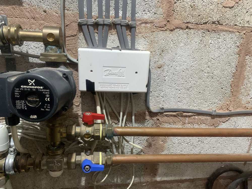

December 15, 2025Dec 15 Author Still looking into this and having done a little more research, to try and understand how everything works, i'm wondering if the Automatic Bypass valve is causing the problem? The new Boiler is an, Ideal Logic+ Combi C30. The old one was Worcester CDi. The new boiler has a built in ABV, where as (if i'm right) the old one didn't, so needed the external one. That is currently set to 0.5. Could the ABV be robbing the ufh of the heat it needs to warm large/multiple rooms? It will comfortably warm my 3m x 3m bathroom but if I add another room the manifold & pump cool down. Edited December 15, 2025Dec 15 by JDAB

December 15, 2025Dec 15 Author That does indeed look very handy. Wonder if I can hire one. Although, right now, mine would all look very blue. Bathroom aside! As few rooms are getting the heat they should. I've been using this, Bosch infrared thermometer, to monitor tempertature changes on the manifold, pump, flooring etc.
