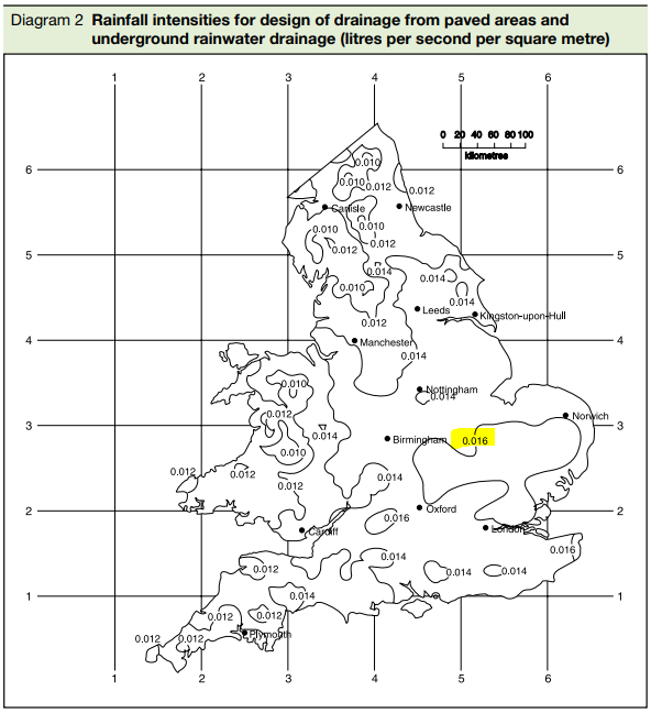

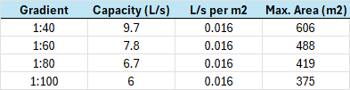

MortarThePoint Posted November 30, 2025 Posted November 30, 2025 Due to a lack of solids, rainwater gradient is less critical than for foul drainage. The minimum gradient is 1:100. The lower the gradient the harder it is to control in the laying process, so I think my ideal would be 1:80. That said, I need to connect to a pipe that is 425mm below surface with a branch of pipework with a length of about 32m, so that's likely to need the 1:100 fall to be possible, since even that will leave the top of a 110mm pipe at the surface. I may have to rethink the far end of that branch since the other points are at a maximum distance of 20m so a 1:80 gradient leaves the top of a 110mm pipe at a depth of 425 - (20,000/80) - 110 = 65mm which may just work and a gradient of 1:100 would make it 115mm which would be fine. Based on Diagram 3 on page 45 and Diagram 2 on page 43 of Part H, the following gradients of 100mm pipe can cater for up to the following areas of roof and/or paving: Even 375m2 is a large area and way beyond my needs. You need to divide by 1.5 if it's roof area, so that become 250m2 which is still lots of area. NB: Peak rainfall rate of 0.016 L/s on 1m is equivalent to 1mm or rain fall depth per minute (60mm per hour) Pipe run distances to gully/hopper entry point to 110mm underground rainwater drainage pipework:

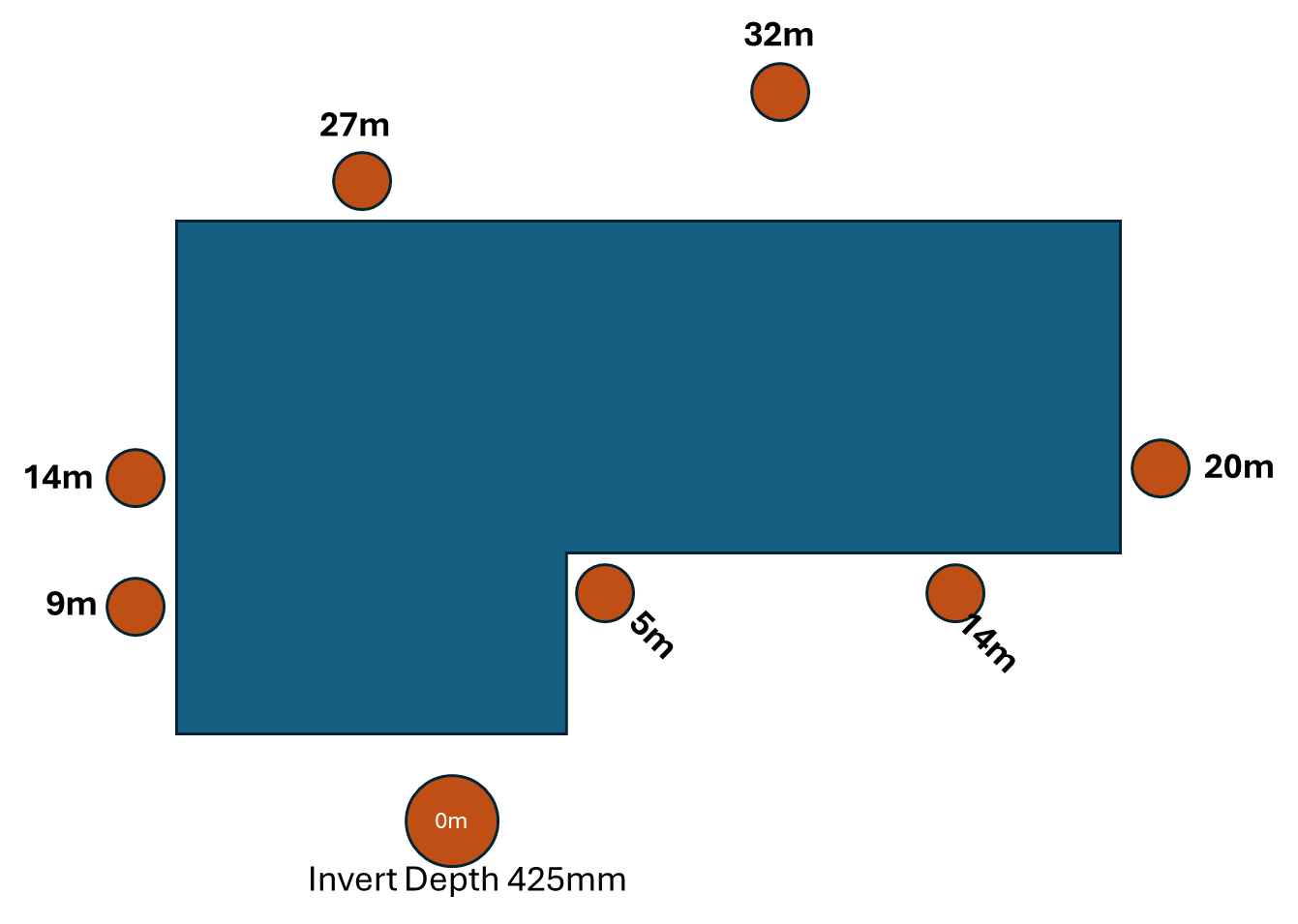

MortarThePoint Posted November 30, 2025 Author Posted November 30, 2025 The downpipe at 27m is servicing 50m2 of roof whilst the one at 32m is servicing 26m2 which hasn't been constructed yet. I'm wondering about combining that second roof area with the one serviced by the furthest right downpipe which is only handling 12m2 of roof area. The one at 27m can't be scrapped though so that's the main challenge. 27m @ 1:100 leaves a depth of 425 - (27,000/100) - 110 = 45mm which could just about work as it's a patio there.
Nickfromwales Posted November 30, 2025 Posted November 30, 2025 Just use trapped gulleys on the furthest one, to manage leaf litter / other debris? 1 1
MortarThePoint Posted November 30, 2025 Author Posted November 30, 2025 4 minutes ago, Nickfromwales said: Just use trapped gulleys on the furthest one, to manage leaf litter / other debris? Yes, that's a good though as that sort of gully would have its output near the surface. I'll have to work carefully to hold the 1:100 gradient though.

saveasteading Posted November 30, 2025 Posted November 30, 2025 A general point re rainwater capacity. The rainfall diagram above is becoming out of date, as some areas of the country are getting exceptional downpours. The annual rainfall is irrelevant, but what happens over 15 minutes can cause problems to your system, or over days to the whole area of infrastructure and waterways. So it is best to future-proof by overdesigning OR having somewhere else for the water to go. So what if: What if a downpipe is blocked? does it escape safely over the gutter or go backwards and cause issues? Using 2 x dp set well apart or having a weir overflow prevents this. What if your drain doesn't quite cope with the flow, or another drain downline is over capacity? An open gully as above allows the water to run onto the ground, but make sure that can run away from the building. 1
MPx Posted November 30, 2025 Posted November 30, 2025 All good points above. We had our last set of soakaways sized "for the 100 year storm". Which happened at least 5 or 6 times over the next decade. In fact I did put in (more than) enough capacity - but still got caught out by the failures. I had 8 downpipes on the house, 2 on the barn and 5 Acos across the drive. My early warning was the one on the front of the barn which would always block first (leaves, helicopter seeds, muck). That was the signal to check the Acos - cos if they blocked, a flash flood was a serious possibillity. Clearing the downpipe head baskets was on my monthly jobs list - and in max drop season could be needed weekly. 1

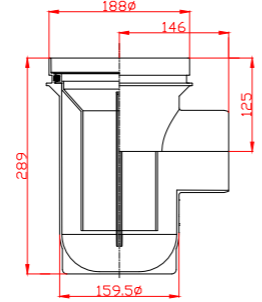

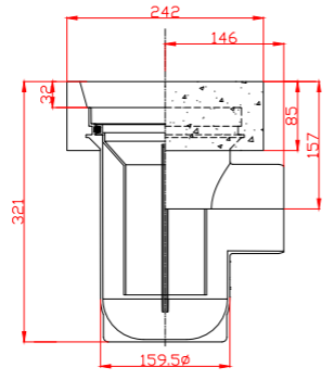

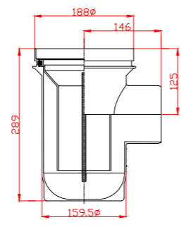

MortarThePoint Posted December 1, 2025 Author Posted December 1, 2025 Bottle Gullies have an output reasonably near the surface, though a P-trap is probably the best for that. Of the bottle gullies, UG425 from polypipe has the shortest distance between top of grate and output invert at 175mm (Osma 4D900 207mm, Floplast D515 262mm). The spigot output of Polypipe UG425 looks to be at least 60mm long which is greater then the insertion depth of most ring seal couplers 175mm + (27000/100) = 445mm so should be workable with 1:100 over 27m and an end invert of 425mm (would stick up 20mm).

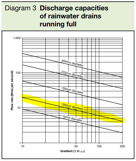

MortarThePoint Posted December 1, 2025 Author Posted December 1, 2025 If I needed to, I suppose I could use a section of 82mm (OD) drainage pipe where the invert is really shallow, but I'd rather not. 75mm (ID) pipe at 1:100 has a capacity of about 2.7L/s which would be enough for one downpipe (standard 63mm ID / 68mm OD downpipe has a capacity of 1.11 L/s according to Part H Table 2 page 40). It would buy me an extra 28mm of headroom, so shallowest top of pipe would 78mm rather than the 50mm with 110mm pipe. I guess it depends a bit on the make up of the patio whether that additional depth is needed. If it is, replacing the first 3m would be enough since it would drop 30mm (@ 1:100) in that distance.

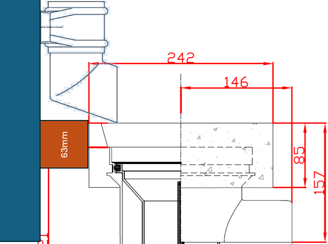

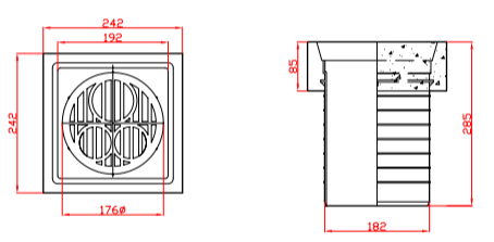

MortarThePoint Posted December 1, 2025 Author Posted December 1, 2025 Looking to use the Polypipe bottle gully with concrete antisplash surround (UG425AST). It's not cheap (~£50) but finishes things quite neatly. I had intended to use the concrete hopper (UG414AST) which has a square grate, but that has a 110mm vertical outlet that I would have sent into a rest bend but for levels. I just need to decide how far to position it from the wall. Pulled away from the wall slightly would make access easier but leave a gap between the wall which would need dressing. If water blasted out of the downpipe it could in theory overshoot the concrete surround if it is too far back, but that feels pretty unlikely. Positioned with concrete surround touching the wall, shoe dipping below the top of the concrete: Positioned with concrete surround 25mm from the wall, bottom of shoe level with top of concrete: Positioned with concrete surround 63mm from the wall so that shoe is just over the grate, bottom of shoe level with top of concrete:
MortarThePoint Posted December 1, 2025 Author Posted December 1, 2025 (edited) Polypile UG425AST has an invert at 85 - 157 - 50 = -122mm relative to the bottom of the concrete surround, but the outlet can't rotate relative to the concrete. An alternative is to use UG425 in conjunction with UG427RAST which is an extension with concrete surround. That combination has a minimum invert at 32 - 157 - 50 = -175mm relative to the bottom of the concrete surround. Note that is the same as without using the concrete surround addition since in its lowest position it would sit on the rim of the bottle gully (UG425). The maximum invert would be about -(285-85) - (125 - 20) - 50 = -355mm. When used on a patio, UG425AST would likely need to have its concrete surround's bottom level with or lower than the underside of the patio paving to allow enough clearance between paving and outlet pipe (157 - (132/2) - 85 = 6mm to the OD of a ring seal and 157 - (110/2) - 85 = 17mm to the OD of a 110mm OD pipe). Interestingly, the combination of UG425 + UG427RAST is cheaper than UG425AST and certainly cheaper than that with a subsequent bend to get the correct outlet angle (though that bend could save a coupler). UG425.pdf UG425AST.pdf UG427RAST.pdf Edited December 1, 2025 by MortarThePoint

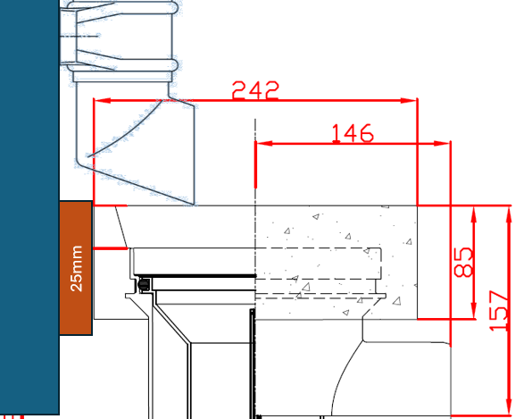

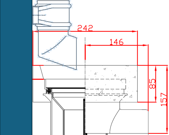

MortarThePoint Posted December 2, 2025 Author Posted December 2, 2025 (edited) 16 hours ago, MortarThePoint said: Positioned with concrete surround 63mm from the wall so that shoe is just over the grate, bottom of shoe level with top of concrete: This is probably the only configuration that might allow the trap insert to be removed without having to remove the downpipe shoe and likely the lowest downpipe section too. That should be an uncommon event, but worth bearing in mind. That said, the trap insert locates in a pair of guide slots so I think it would have to travel directly upwards so would probably still clash with the shoe. 11 hours ago, MortarThePoint said: An alternative is to use UG425 in conjunction with UG427RAST which is an extension with concrete surround. I checked and the trap insert can be removed through the UG427RAST extension piece. Edited December 2, 2025 by MortarThePoint
MortarThePoint Posted December 2, 2025 Author Posted December 2, 2025 Polypipe UG425 has an output invert level 289 - 125 - ((110/2) - 3.2) = 112.2mm above its base. [3.2 based on OSMA pipe wall thickness] That's 176.8mm below its top rim.

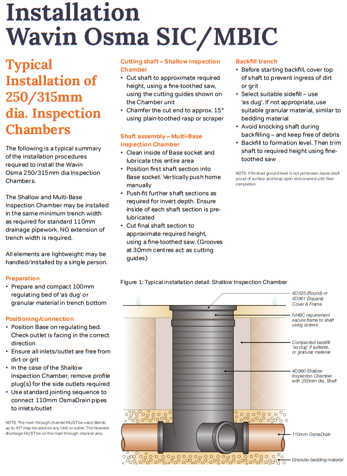

MortarThePoint Posted December 2, 2025 Author Posted December 2, 2025 (edited) Osma 4D960 250mm inspection chamber has its inverts about 6mm above the main body bottom and about 13mm / 0.5" above the outer surface of the ring seal's plastic outer. Edited December 2, 2025 by MortarThePoint
MortarThePoint Posted December 2, 2025 Author Posted December 2, 2025 placing bottle gullies onto a paving slab is a good idea and then haunching with concrete to help keep it in place. 4D960 250mm chambers can be placed bedded in gravel, but I may use slabs to help achieve the levels needed (though could use a non-sharp brick instead as long as granular will is all around.

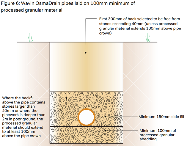

MortarThePoint Posted December 2, 2025 Author Posted December 2, 2025 (edited) @Nickfromwales I've got a bit carried away digging the trenches on my own and didn't notice that at the far end of one branch the starting ground level hasn't yet been brought up to final ground level. It was also soft soil here so easy digging. The upshot is that for the first section I have dug the trench about 200mm deeper than needed (so 300mm below bottom of pipe). I have loads of 10mm gravel as I had a tipper load rather than grab bags. What should I do: Mistake is no issue, just fill trench with 10mm gravel all the way up to underside of pipe, lay pipe as normal Fill trench to the depth I should have dug to (100mm below pipe) with 10mm gravel in 100mm layers, tamp between fills. Then lay pipe a normal Fill trench to the depth I should have dug to (100mm below pipe) with as dug soil in 100mm layers, tamp between fills. Then lay pipe a normal Fill trench to the depth I should have dug to (100mm below pipe) with MOT rich soil in 100mm layers, tamp between fills. Then lay pipe a normal Thankfully this is for the shorter branch that is going to be 1:80 fall. There is a 250mm inspection chamber in this section though. Edited December 2, 2025 by MortarThePoint
saveasteading Posted December 2, 2025 Posted December 2, 2025 Rounded gravel does not compact, and that is the point of it... it settles and is stable. so not option 2. You can just fill with the earth or as 3 or 4 but must compact it. If it is clay then this will be difficult to do well. 1. will be the quickest but cost you a bag of gravel. 3 the cheapest. You can buy a tamp for £15. 4. Does that mean it was soil but now has stone mixed in it? same as 3. 1
