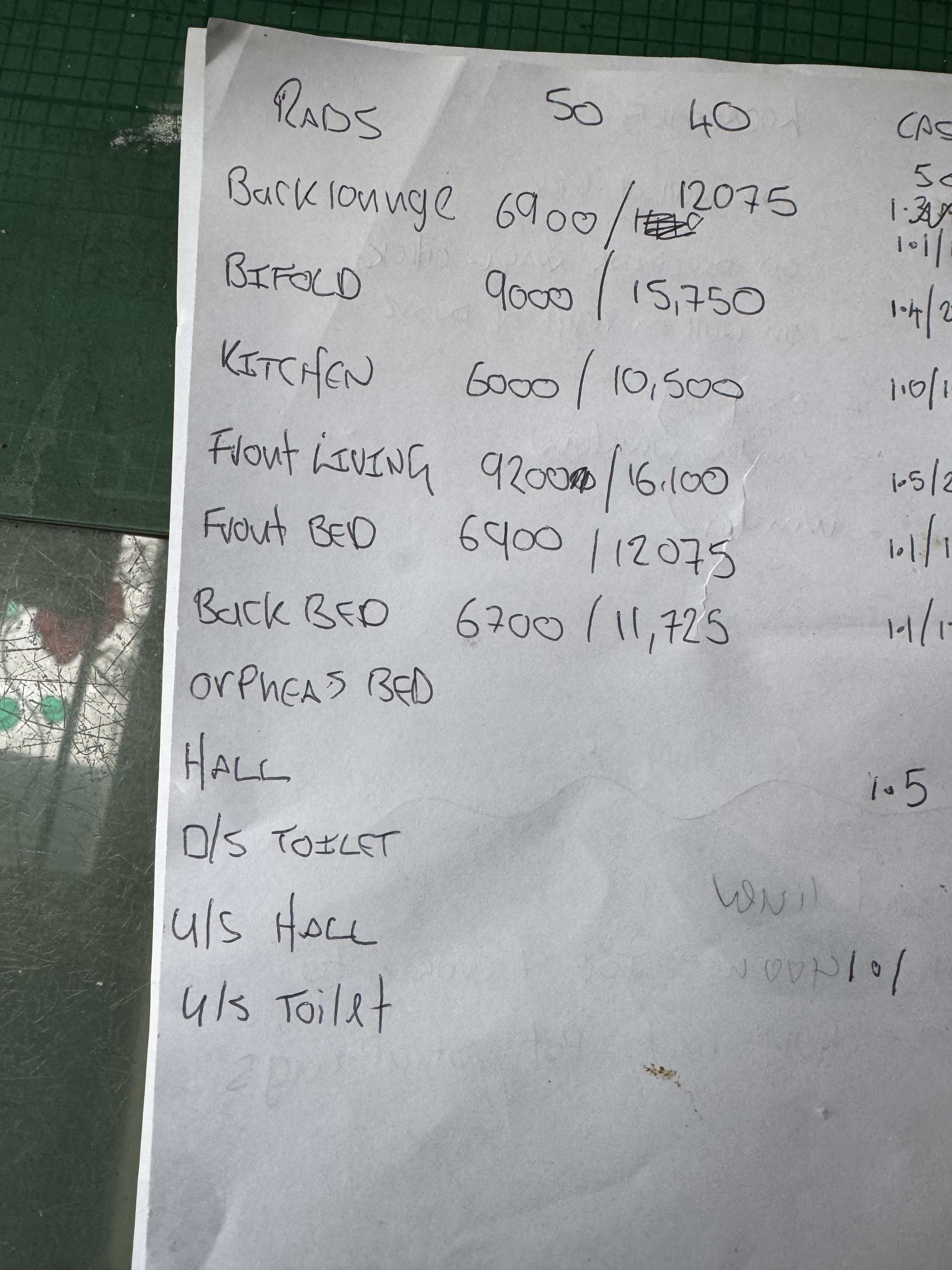

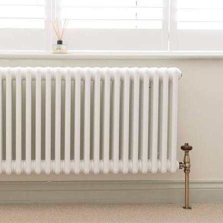

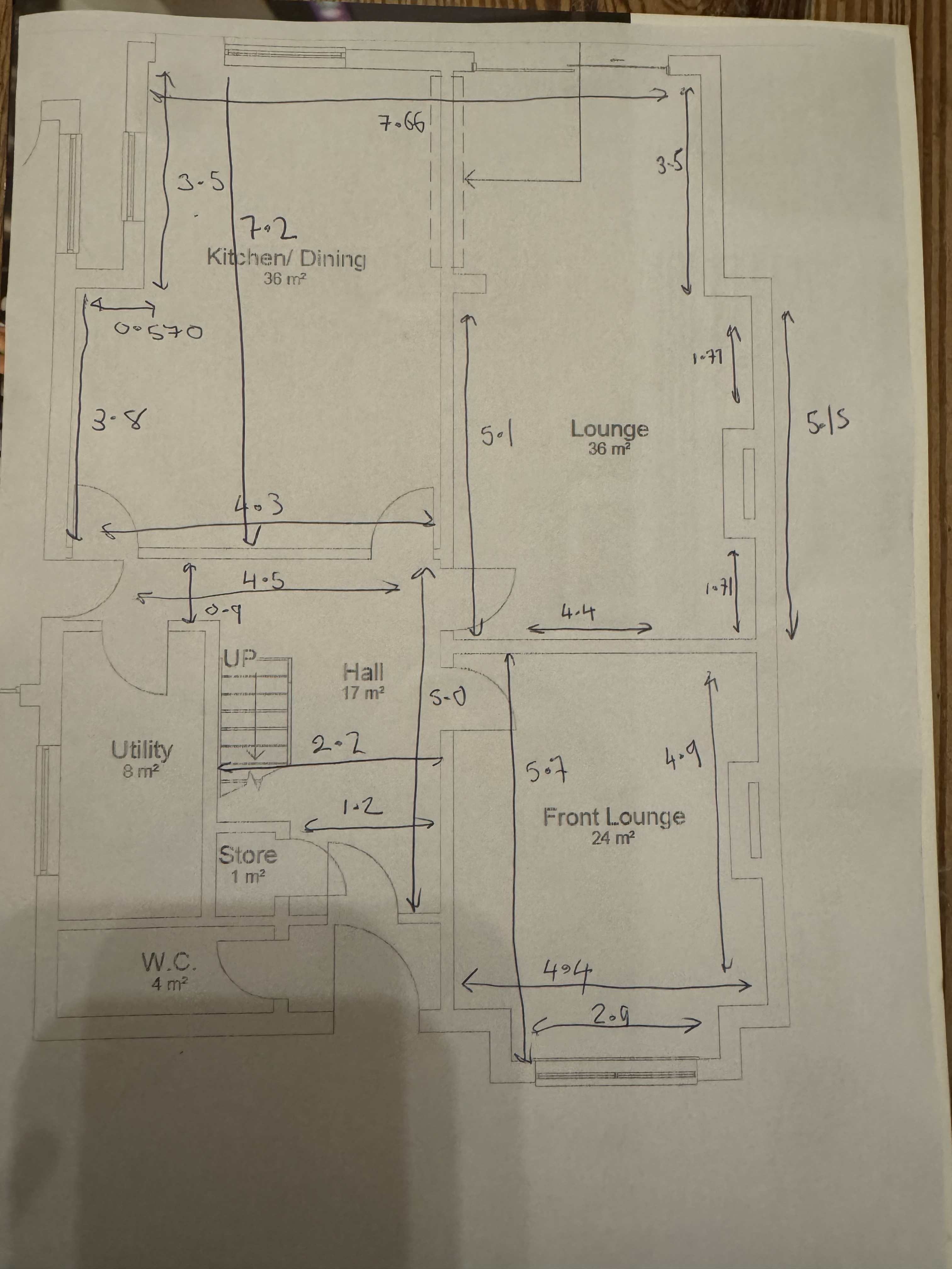

Rocket Ron Posted 3 hours ago Posted 3 hours ago Hello everyone We are in the process of sympathetically renovating a large Edwardian three story semidetached house and we are considering underfloor heating for the ground floor. The property benefits from double glazing and an open plan area of approximately 70 m² consisting of a lounge area plan extension with bifold windows and an kitchen separated by a single wall. The property has a traditional suspended wooden floor and we are considering an overlay system such as those supplied by Wunda. The materials quotation has come back as favourable however I see complications running the 35 kW valent boiler with Custom iron radiators in the upper floor and underfloor heating on the ground floor. The idea for this is to reduce energy costs as well as comfort. The alternative is to run cast iron radiators downstairs and upstairs at Delta 40. I need some help with the best solution for our house as I have no experience within the floor heating let alone running a radiator system upstairs and an underfloor heating system downstairs. Any help and advice would be gratefully received? Is it going to be worth the cost and installation of underfloor heating over and above that of cast iron radiators. Will I be able to effectively run radiators and on the floor heating off the same boiler? It’s decision time now so any help gratefully appreciated. just to add that the rear of the property where the bifold windows are and the extension is has all been insulated in accordance with current building regulations the front half of the property and upstairs is traditionally built
