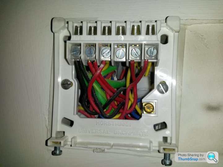

marshian Posted November 25, 2025 Posted November 25, 2025 On 22/11/2025 at 17:45, gaz_moose said: I bought the drayton wiser one as suggested. The magic pixies might be responsible for installing it as its illegal for a non gas safe engineer to remove the cover or something like that. Is your old controller base unit mounted on a universal backplate - sometimes called industry std backplate? If it is a wiser hub should be easy to install no "gas safe" engineer required I replaced my original controller below (library image as the original item got trashed by a toaster - don't ask some people are just stupid) With a Danfoss 24/7 digital programmer that had a universal back plate - so I had the headache of working out what the wires did what on the original. No smoke escaped from the wires so once done further swaps of the controller have been isolate power - remove old - replace with new and power up.

-rick- Posted November 25, 2025 Posted November 25, 2025 10 minutes ago, marshian said: Is your old controller base unit mounted on a universal backplate - sometimes called industry std backplate? No opentherm connections there. A system boiler may also not be wired for separate CH and DHW signals which limits you to a single water temperature or in the case of the 1st gen wiser and similar prevents Opentherm use if you also want hot water. A competent installer can solve those problems.
MrPotts Posted November 25, 2025 Posted November 25, 2025 The “industry standard” backplate will only fit the gen1 Wiser hubr, the gen2 hubr uses a slightly different backplate.
marshian Posted November 25, 2025 Posted November 25, 2025 Just now, -rick- said: No opentherm connections there. A system boiler may also not be wired for separate CH and DHW signals which limits you to a single water temperature or in the case of the 1st gen wiser and similar prevents Opentherm use if you also want hot water. A competent installer can solve those problems. Sorry I was directing the question to @gaz_moose My wiser unit isn't connected to the boiler at all - I'm heating 24/7 😉 Boiler is set up with DHWP and WC already Wiser schedule for HW switches the boiler to recharge the cyl via a HW Demand box so there is actually no need to connect Wiser to the boiler. I will eventually connect it again just to use the away function but right now I just use the Viessmann app to do that...
