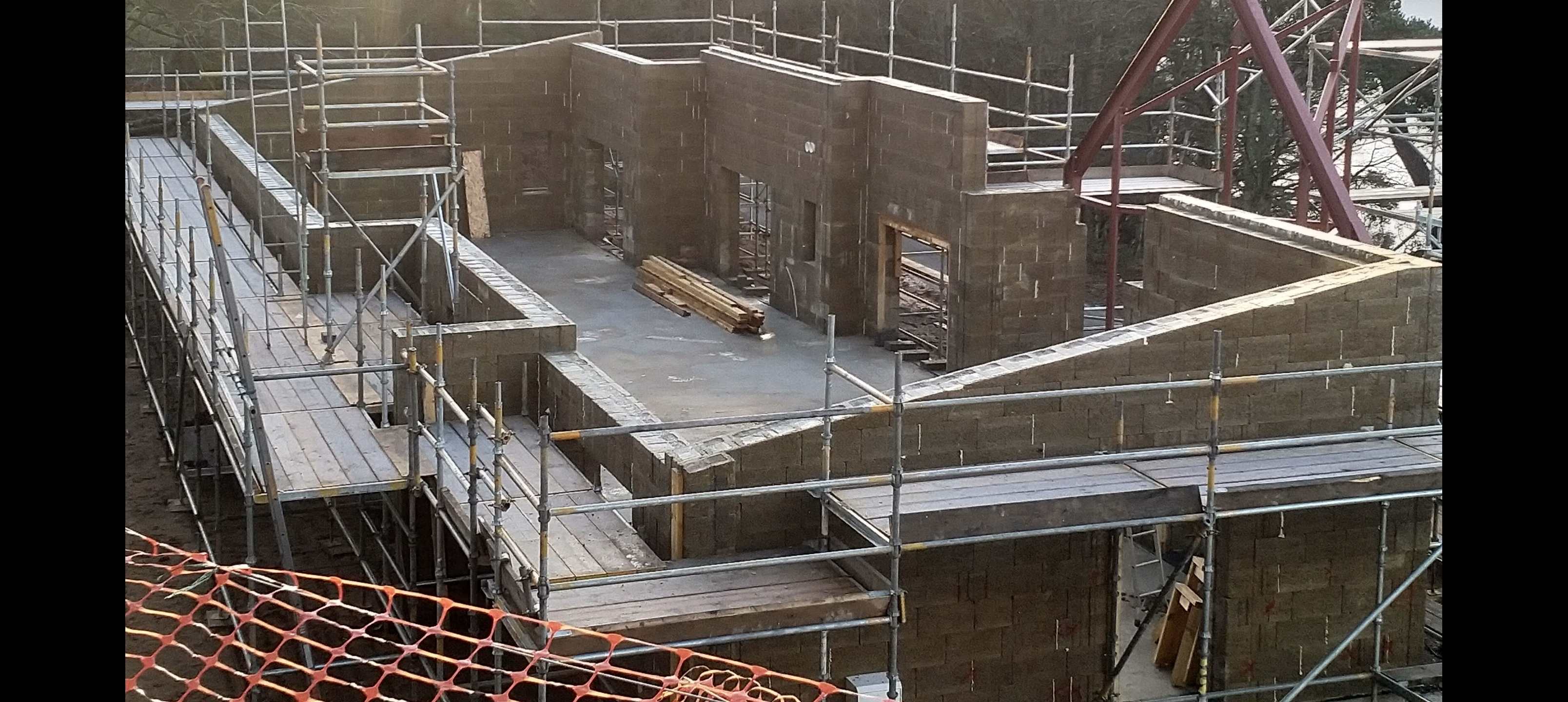

Posted
This took 4 weeks, two of us never done it before (working 8 hrs days in Dec in NE Scotland), 70m perimeter, up to 3.5m high at front.
Screenshot_2025-11-20-18-40-04-82_965bbf4d18d205f782c6b8409c5773a4.thumb.jpg.e9e115e9d87b45979745532973a138a9.jpg
Then there was a break over Christmas and new year and roof materials arrived 12th Jan
First week of Feb roof on. If you exclude the Christmas break, 9 weeks, not sure where the savings of 3 months come from.
  • Like 2

ICF can be quick. Our Thermohouse crew of three guys assembled the ground floor walls in 4 days, then spent 4 days bracing and erecting the scaffold platform, then poured the walls on the Friday of the second week.
So 10 working days from blank foundation to poured concrete ground floor walls.
