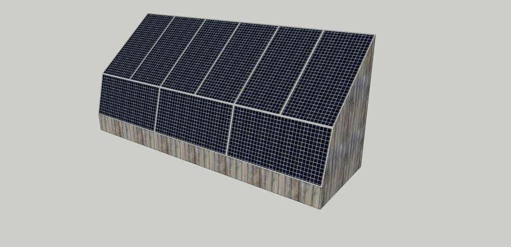

-rick- Posted November 18, 2025 Posted November 18, 2025 A single inverter with two MPPTs will handle two strings with different condition (and importantly different voltages/number of panels). 1
Dillsue Posted November 19, 2025 Posted November 19, 2025 9 hours ago, Crofter said: I thought I'd need a second inverter because the extra three panels will see quite different conditions. Maybe I'm overthinking it. Tbh they don't add a huge amount, it would be easier just to stick to the main array of six. If you have 5.68kw of POTENTIAL export then you'll need DNO permission. As rik says a single 3.68kw inverter with dual mppts is the way to go. Each mppt operates independently of the other so will manage the differing output profile from the 2 sets of panels 1

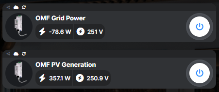

TedM Posted November 20, 2025 Posted November 20, 2025 (edited) I'm doing something very similar with my [electrically heated] holiday place in Wales that is occupied 90% of the time during May to Mid September. We have a south facing 3kWp array on the roof and a 210L Megaflo tank with hot water usage basically being showers - no baths. I've set up an [old] Immersun diverter to heat the tank and when that is satisfied any spare generation going into a single electric wall heater in the hall which is only connected to one of the Immersuns' outputs - it's an upside down house so it heats open-plan upstairs as well as the hall. I like using the Immersun because, not only does it have two outputs, it can also be remotely boosted by applying any voltage to a specific connection. Quote So I'm looking to design a system that can deliver close to 8kwh/day over that period. Unfortunately there will be periods, even in the summer' when that's not going to happen. I also run a Pi that monitors various house temperatures including the hot water. This checks the water temperature very early in the morning (say 5am) and, if it's below a threshold that I've set, it switches on a wireless plug that sends power to the Immersuns' remote boost port so there's enough hot water ready for morning showers. This is pretty important at a holiday let where guests expect hot water all the time! You don't have to use a Pi to achieve this - I'm moving quite a lot of stuff over to Shelly relays which are simple to set up. Our array and this setup supplies all our heating needs for 6 months of the year. The one change I do want to make is to add a further 4 ground mounted panels that face west which would give us some very handy generation past 4pm during the summer. I'll be adding another inverter to handle this power as the original array is on a very attractive FIT so I'm not going to mess with it! Edited November 20, 2025 by TedM 1
Crofter Posted November 20, 2025 Author Posted November 20, 2025 49 minutes ago, TedM said: I'm doing something very similar with my [electrically heated] holiday place in Wales that is occupied 90% of the time during May to Mid September. We have a south facing 3kWp array on the roof and a 210L Megaflo tank with hot water usage basically being showers - no baths. I've set up an [old] Immersun diverter to heat the tank and when that is satisfied any spare generation going into a single electric wall heater in the hall which is only connected to one of the Immersuns' outputs - it's an upside down house so it heats open-plan upstairs as well as the hall. I like using the Immersun because, not only does it have two outputs, it can also be remotely boosted by applying any voltage to a specific connection. Unfortunately there will be periods, even in the summer' when that's not going to happen. I also run a Pi that monitors various house temperatures including the hot water. This checks the water temperature very early in the morning (say 5am) and, if it's below a threshold that I've set, it switches on a wireless plug that sends power to the Immersuns' remote boost port so there's enough hot water ready for morning showers. This is pretty important at a holiday let where guests expect hot water all the time! You don't have to use a Pi to achieve this - I'm moving quite a lot of stuff over to Shelly relays which are simple to set up. Our array and this setup supplies all our heating needs for 6 months of the year. The one change I do want to make is to add a further 4 ground mounted panels that face west which would give us some very handy generation past 4pm during the summer. I'll be adding another inverter to handle this power as the original array is on a very attractive FIT so I'm not going to mess with it! That's a very similar application to mine, great to hear that it's working out so well for you. Using a panel heater as a dump load is an excellent idea- and I presume that its own thermostat is enough to prevent overheating the property? My understanding (and I could be wrong) is that a grid tied inverter feeds in a higher voltage than the grid, so that the house draws preferentially from it- and any surplus just gets exported, whether you are getting paid for that or not. So e.g. I could leave a panel heater switched on and it would take from either the grid or the panels depending on how sunny it is. Obviously not a very clever way to do things, but I'm just trying to understand how the system will work.
JohnMo Posted November 20, 2025 Posted November 20, 2025 1 hour ago, Crofter said: and any surplus just gets exported, whether you are getting paid for that or not Only up to either a CT clamp on export says no or the inverters limits (e.g. G98) say no 1 hour ago, Crofter said: So e.g. I could leave a panel heater switched on and it would take from either the grid or the panels depending on how sunny it is. Not sure that would work, as the heater would be hot all the time, so hot 24/7 - is that want you want? You have a heat pump, assume that is set up to do the heating/DHW. I would heat DHW to the highest setting the heat pump allows at lunch time each day and also boost central heating around the DHW heating to coincide with peak generation - around 11am to 2pm for both jobs each day. Anything else dump to immersion. Don't get carried away with array size, otherwise you just have a job managing it and it will be wasted. Look at it as a back filler for your normal loads only. Anything above G98 limits can be full time job in summer.

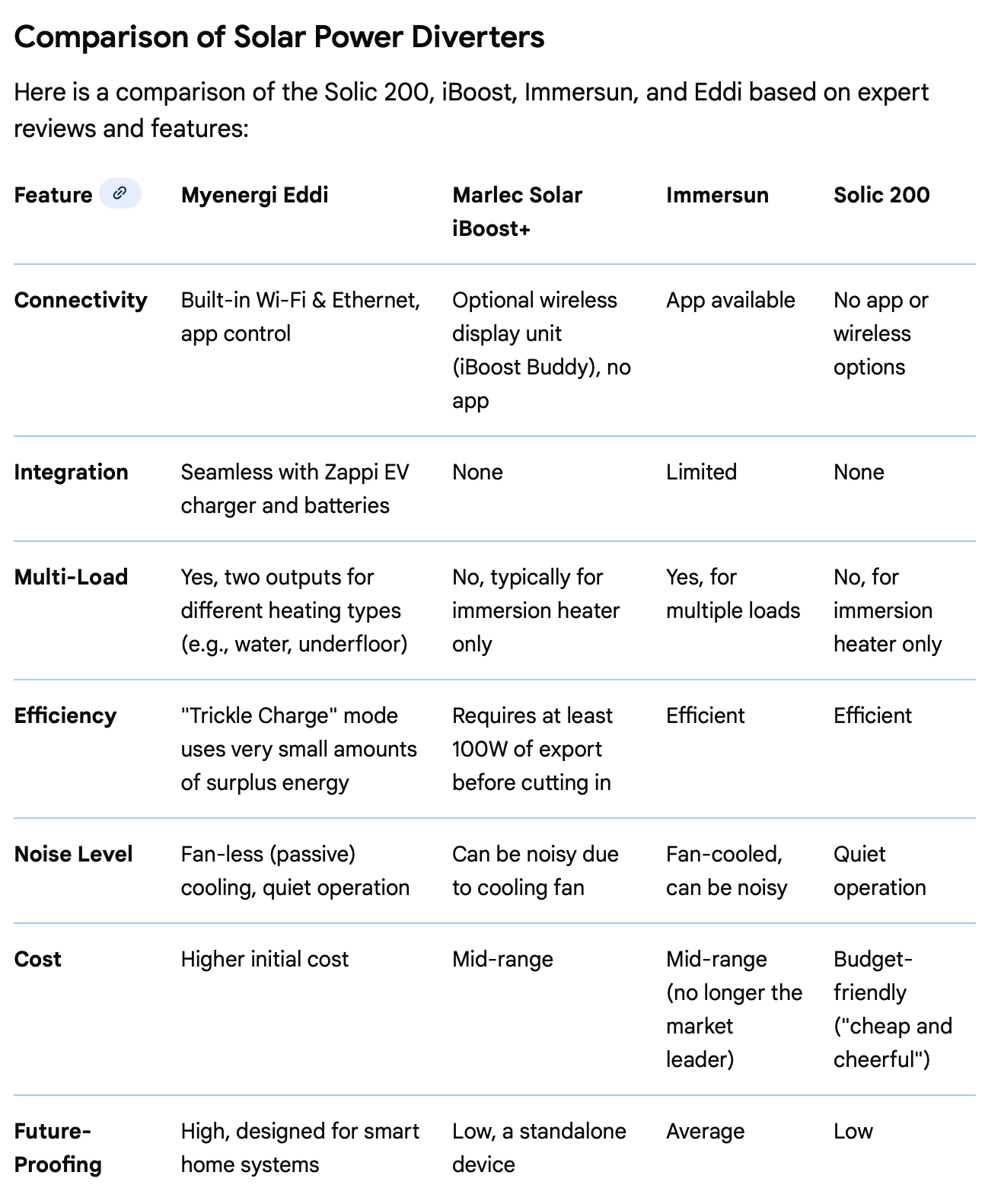

Crofter Posted November 20, 2025 Author Posted November 20, 2025 I looked up the Eddi and the ability to power two different devices sequentially looks absolutely perfect. Is this a common thing on diverters? What should I be considering when choosing the heater? As it happens I never removed the old storage heaters when I put in my A2A, so it would be tempting just to wire up the one that's in the hallway, which would add a nice bit of background warmth to the whole house. But I don't know what wattage is appropriate for this, e.g. should it be sized to take account of the array output?
JohnMo Posted November 20, 2025 Posted November 20, 2025 32 minutes ago, Crofter said: Eddi and the ability to power two different devices sequentially This does as well https://coolenergyshop.com/products/cool-energy-solar-power-diverter?srsltid=AfmBOoqhPEOh5honAnsCyw0EYcVA8sIS74Zkpt_ENnLL5pn1vo1dzyRM Most don't do two outputs Spending big on diverters is a waste of money, so buy carefully. Pay back can be huge, especially if spending £400 on an Eddi. If you are thinking about a battery, a diverter make no sense and can it other ways more efficiently.
Crofter Posted November 20, 2025 Author Posted November 20, 2025 41 minutes ago, JohnMo said: This does as well https://coolenergyshop.com/products/cool-energy-solar-power-diverter?srsltid=AfmBOoqhPEOh5honAnsCyw0EYcVA8sIS74Zkpt_ENnLL5pn1vo1dzyRM Most don't do two outputs Spending big on diverters is a waste of money, so buy carefully. Pay back can be huge, especially if spending £400 on an Eddi. If you are thinking about a battery, a diverter make no sense and can it other ways more efficiently. I know diverters aren't the right answer for everybody. My interest in this was actually sparked by seeing a cheap used diverter for sale locally. The unusual thing about my use case is that, being a holiday house, I'm not in a position to load shift. Guests are going to use electricity when they want to, not when the sun is shining.

TedM Posted November 20, 2025 Posted November 20, 2025 Quote I looked up the Eddi and the ability to power two different devices sequentially looks absolutely perfect. Is this a common thing on diverters? I don't think so - and the external boost [by applying any voltage to a special 'port') is a game changer and, I think, limited to Immersun and the Eddi. (Immersun came out quite a long time ago but went out of business but you can still find the units for sale on eBay. Myenergi bought Immersun and based the eddi on it - it's extremely similar but has a couple more bells and whistles) Quote What should I be considering when choosing the heater? Literally any cheapo electric convector heater (without a fan) will do. Quote But I don't know what wattage is appropriate for this, e.g. should it be sized to take account of the array output? The Immersun and Eddi can output a maximum of 16A (you can actually throttle the eddi back if you wanted) so pretty much any heater will do.
TedM Posted November 20, 2025 Posted November 20, 2025 (edited) 1 hour ago, JohnMo said: Pay back can be huge, especially if spending £400 on an Eddi. Yep, I've never paid more than £100 on any of mine - all bought on eBay. (although if you have an EV then the eddi works in conjunction with the zappi charger to utilise your PV generation even better - I think this adds value to the eddi) Edited November 20, 2025 by TedM

Crofter Posted December 3, 2025 Author Posted December 3, 2025 So, it looks like the going rate for a secondhand diverter is around £100, sometimes a little less. I'm getting the impression that the Eddi is maybe the best of the bunch? And the Immersun also good; both can do two sequential loads, yes? The Solic 200 seems to go for a bit less money, but it seems that it's not straightforward to have it share a load with another power source (e.g. an off peak timer) Any others to recommend or avoid? The inverters are a bit more easy to find secondhand, and generally a bit cheaper. Other than making sure it's around 3.6kw, and compliant with current G98 standards, anything to look for? Any brands to avoid like the plague?

Crofter Posted December 3, 2025 Author Posted December 3, 2025 Does this AI-generated summary of different inverters sound about right? Makes the Eddi look the best by far. Especially considering in the future, when the house is no longer rented out, I am hoping to get an EV and charger.
