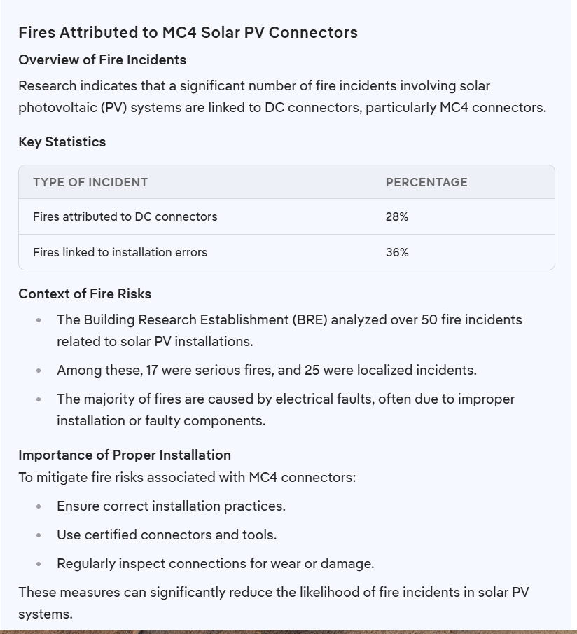

Saw an eFixx thing on this recently. The person they were talking to was talking about how important it is to match the connector manufacturer and crimp tool as while it should be a standard there are tolerance errors that have caused fires. I don't know how much to trust this as eFixx can be a bit of a sales thing for manufacturers pushing their product but definitely worth paying close attention to. MC4 connectors are a common cause of issues.

Is that the connectors or the way they've been installed? In my very limited experience of site crimped MC4s out of the couple of dozen I've handled, 1 has had the cable pull out and on removing the pin it was obvious that whoever had crimped it had used a pair of pliers rather than the correct crimp tool.

I wonder how many fires there have been?  And how were they attributed to the connectors and who checked that if the fires were caused by the connectors, which brand of crimp tool was used.  Or could they have been caused by not clicking the crimped part into the housing properly?

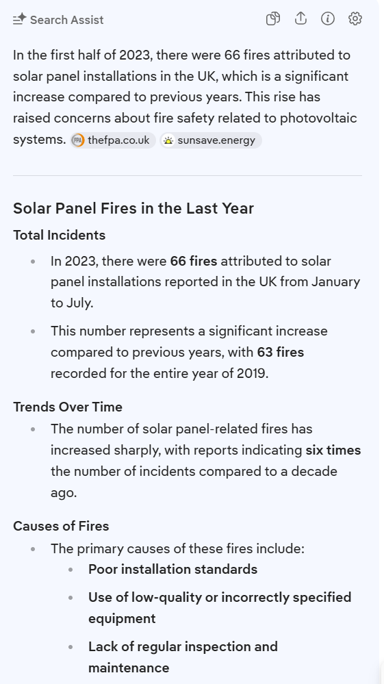

Majority of fires ...  often due to improper installation or faulty components.  What they haven't analyzed is what the cause of the fires were that were attributed to faulty connectors.
So, as with anything - make sure you do things properly and double check that the connections are good.

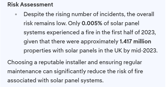

I think the 0.005% of systems that experience a fire is the statistic to be mindful of.
