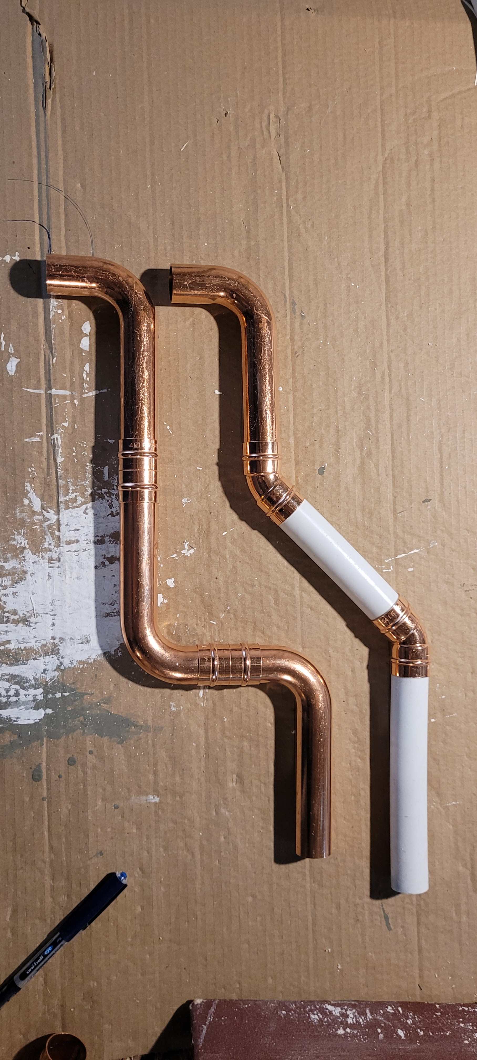

MikeSharp01 Posted November 16, 2025 Posted November 16, 2025 Just plumbing in the heat pump and am trying to keep all pressure drops to a minimum. Here are two possible configurations of one part, assume the plastic segment will be copper, which of them is going to have the lowest pressure drop I wonder and how would I work it out? It is all 28mm pipe.
JohnMo Posted November 16, 2025 Posted November 16, 2025 You have a dinky heat pump, you could easily pipe in 22mm, so if using 28mm don't loose sleep. The difference in pressure drop is very small.

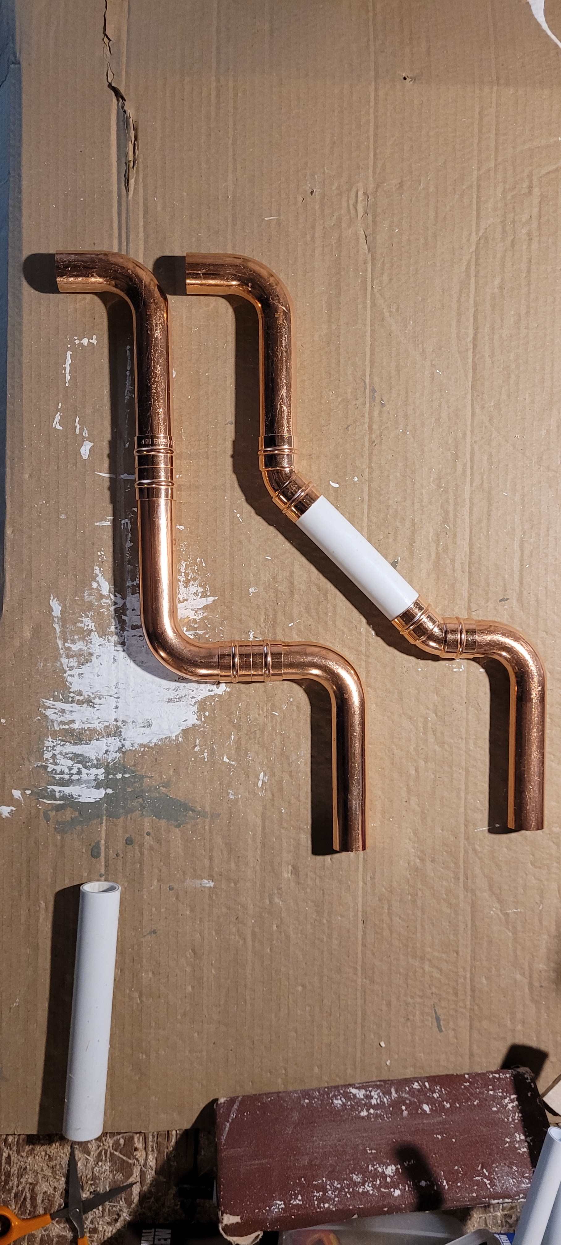

MikeSharp01 Posted November 16, 2025 Author Posted November 16, 2025 Yes John and I realise I could simplify further as this image:
ProDave Posted November 16, 2025 Posted November 16, 2025 With a pipe bender I could do both 45 degrees as two bends in one length of pipe. No joints.
JohnMo Posted November 16, 2025 Posted November 16, 2025 Or just do Hep2O and don't bother tube bending anything.
MikeSharp01 Posted November 16, 2025 Author Posted November 16, 2025 45 minutes ago, ProDave said: With a pipe bender I could do both 45 degrees as two bends in one length of pipe. No joints. Bending 28mm pipe sounds like a challenge, I got the swept bends in the images to avoid bending myself. I do have a conduit bending machine but I am not sure I can get a 28mm former for it - I will have a look.
ProDave Posted November 16, 2025 Posted November 16, 2025 I have 28mm formers for my Hilmor bender. It was originally my dad's. I also have the imperial sized formers for it. I don't have the electrical conduit formers though it is the same bender as electricians use so they are available.
