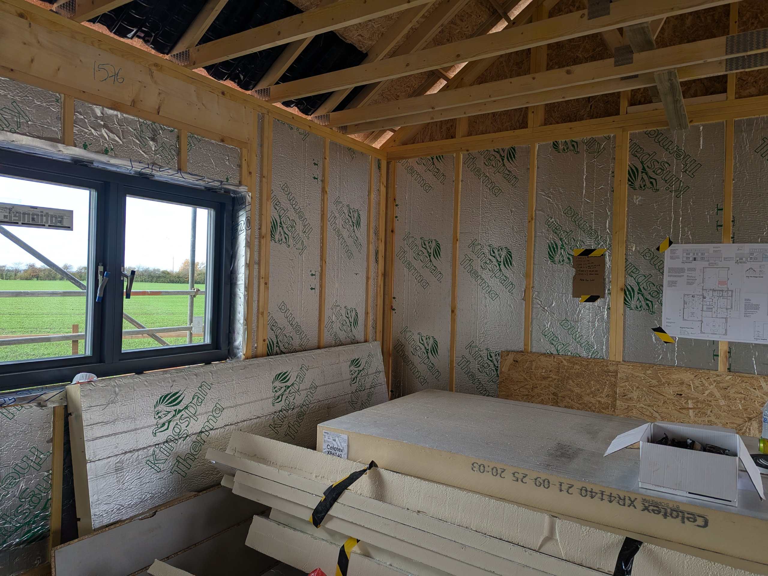

Lincolnshire Ian Posted 18 hours ago Posted 18 hours ago We need to finish our timber-framed, attached to the house, garage. The walls are 140mm studs with 120mm insulation which was fitted by mistake in the TF factory. We have considered plasterboard, plastering and paint, but this is quite an expensive way to finish the garage. Then we have OSB board, cheap to buy and easy to install, but with a utilitarian appearance. Are there any other options we should consider - we want it to look nice for the least possible money (who doesn't). Here is a picture of the wall. Thanks
crispy_wafer Posted 18 hours ago Posted 18 hours ago OSB + PB, or just Fermcell, skim it and swallow the cost. Make it a nice space to use and work in, and give the walls the ability to hold tools/bike racks/ladder hangers.
Nick Laslett Posted 15 hours ago Posted 15 hours ago (edited) I’m sure you are already on top of this, but my understanding is there are specific fire regs that dictate how you finish an attached garage. But I could be mistaken. So PB with 30 min fire rating is possibly required. Edited 15 hours ago by Nick Laslett

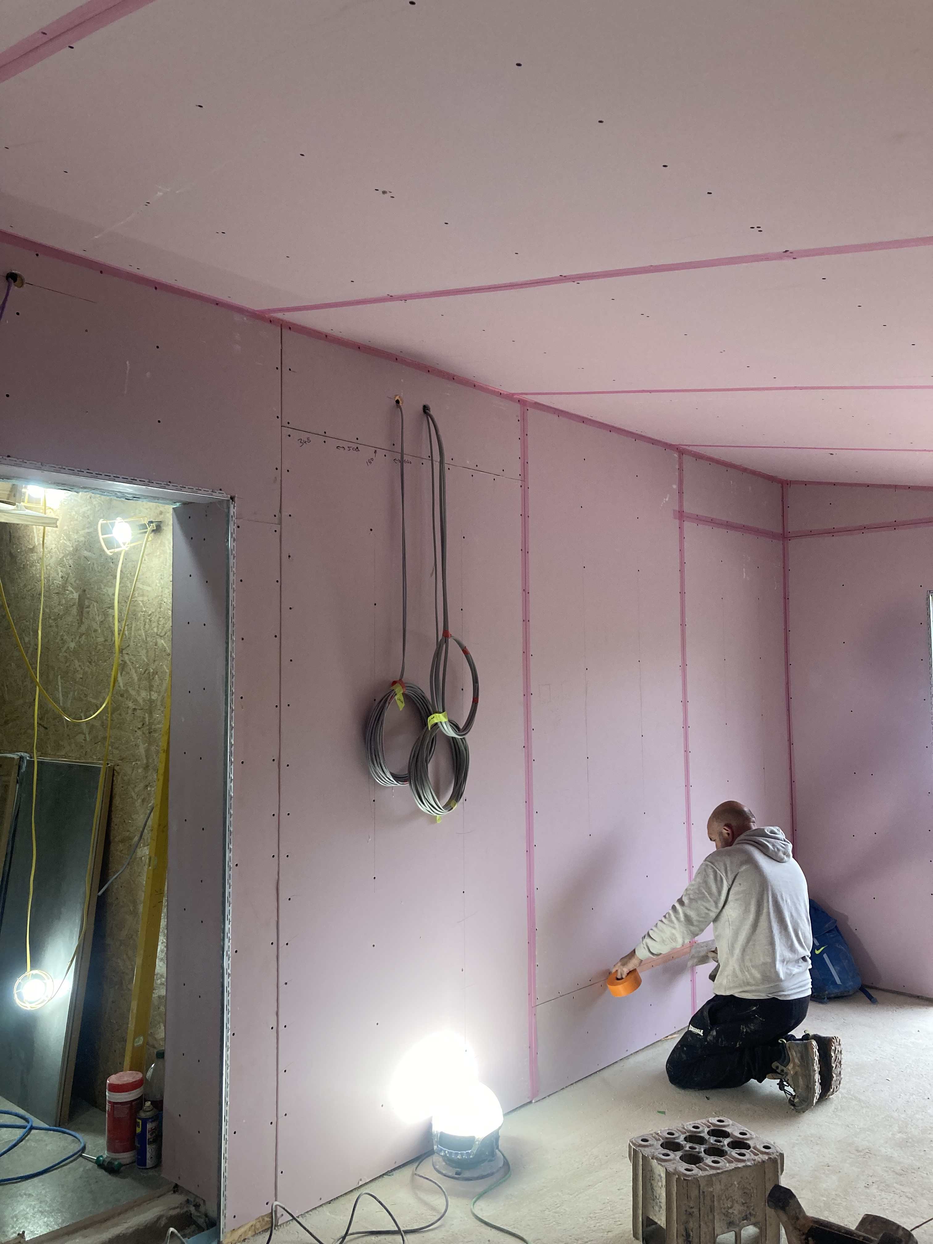

Russell griffiths Posted 10 hours ago Posted 10 hours ago Our attached garage is lined with 18mm osb, then pink fire board and skimmed. pits made a lovely room and I’m happy it’s sort of safe.
Eric Posted 7 hours ago Posted 7 hours ago Your approved drawings will state what is required for fire regs, for other walls as above just plasterboard or osb/ply then plasterboard means there is always material behind the plasterboard for fixing items in the future.
