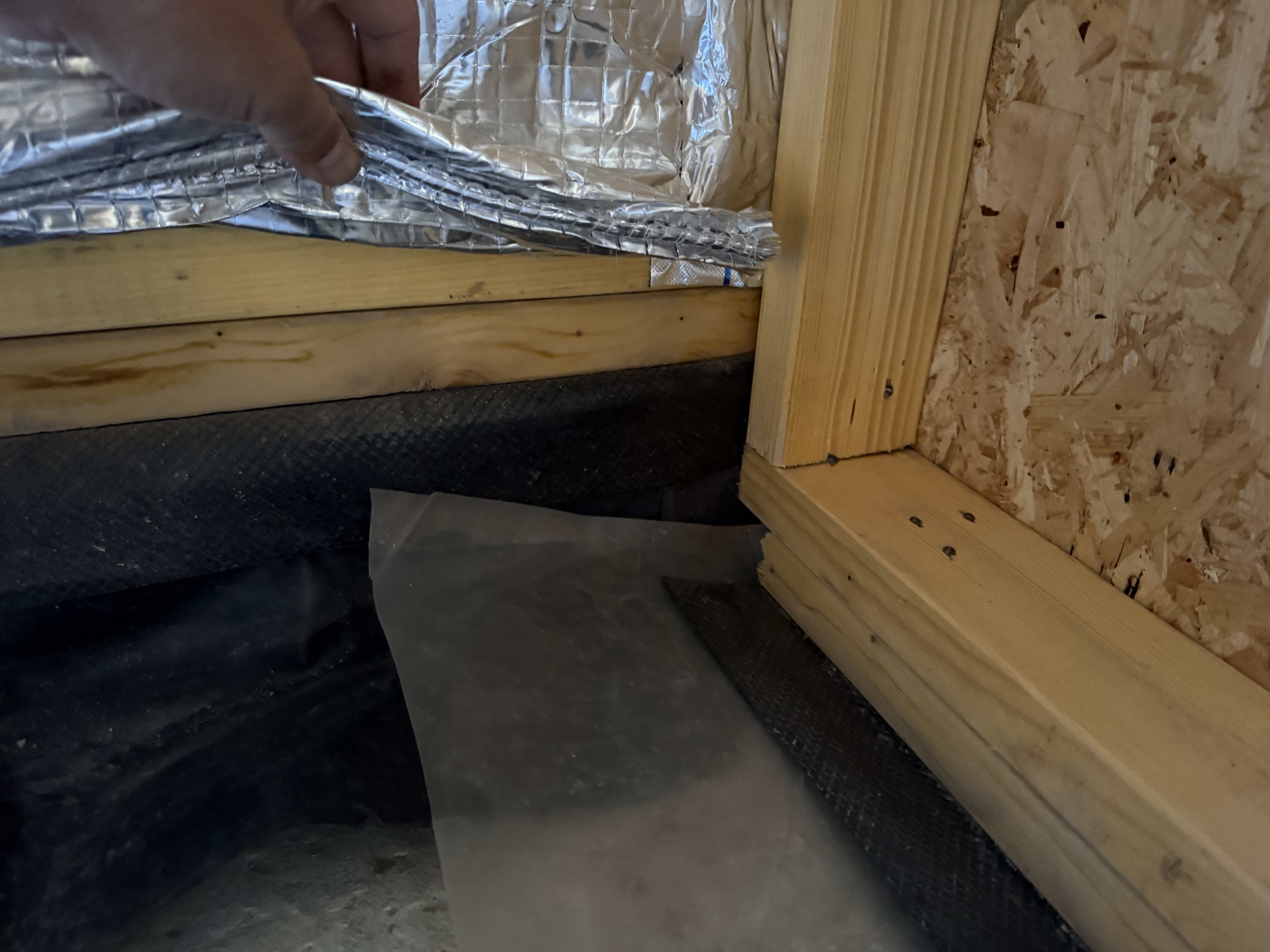

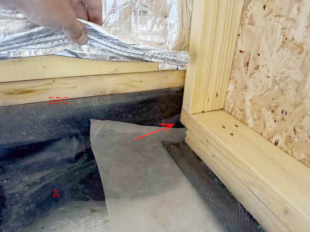

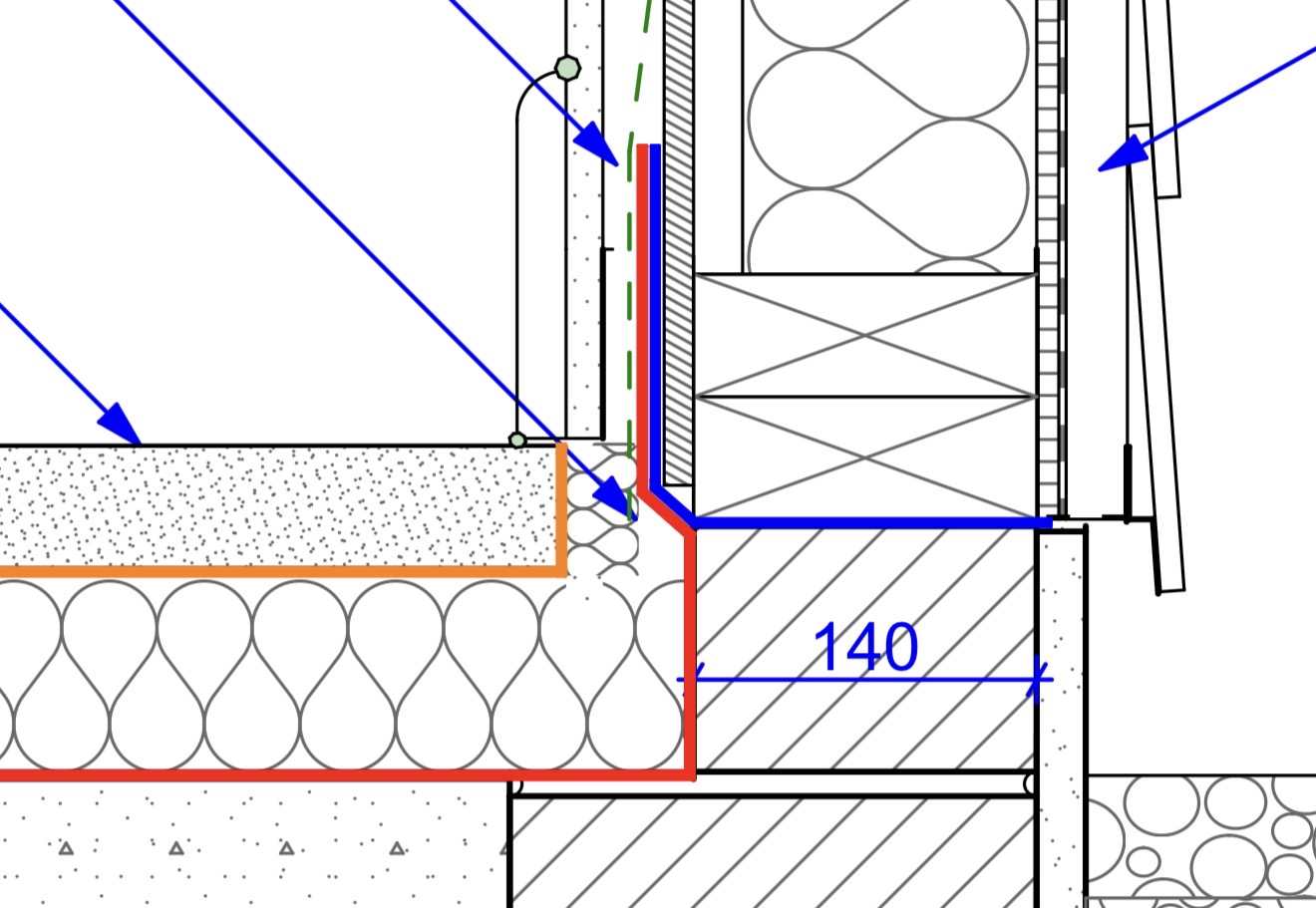

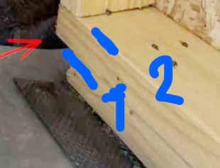

junglejim Posted November 1 Posted November 1 Slowly progressing with my timber frame build and getting ready to lay dpm, add pir, ufh and screed. I’ve got a couple of questions: 1. My architect drawing shows flow dpm sealed to dpm under sole plate and lapped up external walls. (Red and blue lines in drawing) The internal walls were all installed at the same time as the external walls. So where these intersect I can’t fold up the dpm. The easiest solution would seem to be not to fold up the dpm strips that are under the sole plate and instead fold them down but tape / seal the new floor dpm to all junctions with overlap so that can fold up. It would mean that the there is only one layer of dom above the upstand rather than the 2 in the architect spec. In the corners presumably I’d use ‘hospital bed style’ to neatly tuck in without any break in the dpm. 2. there are sections of the slab that to my untrained eye seem quite uneven. I can chisel off small lumps but wondering if I should be taking additional measures to perfect the dpm? I haven’t got any photos yet and i could well be overthinking it! I don’t think self levelling screed will work because it would interfere with the dom under internal walls. I guess I’m wondering when I should worry about this and what solutions there are? I’m thinking the addition of a rubber layer (say 1-2mm) might be useful? 3. also with insulating the slab. The architect drawing shows the perimeter strip sitting on top of the sheet insulation. I’ve also seen lots of people do the strip first at full height then add the sheets. Wondering what the logic is for each method? Thanks as always does the help given.
JohnMo Posted November 1 Posted November 1 5 minutes ago, junglejim said: 3. also with insulating the slab. The architect drawing shows the perimeter strip sitting on top of the sheet insulation. I’ve also seen lots of people do the strip first at full height then add the sheets. Wondering what the logic is for each method? Each method works, but I did perimeter insulation at full depth of insulation and screed, my thoughts were less chance of a thermal bridge due to gaps. I used 70mm PIR which was the maximum use for my wall build-up instead of the normal blue stripes. 8 minutes ago, junglejim said: there are sections of the slab that to my untrained eye seem quite uneven. I can chisel off small lumps but wondering if I should be taking additional measures to perfect the dpm? You could add a thin layer of sand or use thin eps insulation as a sacrificial layer below the DPM. 1

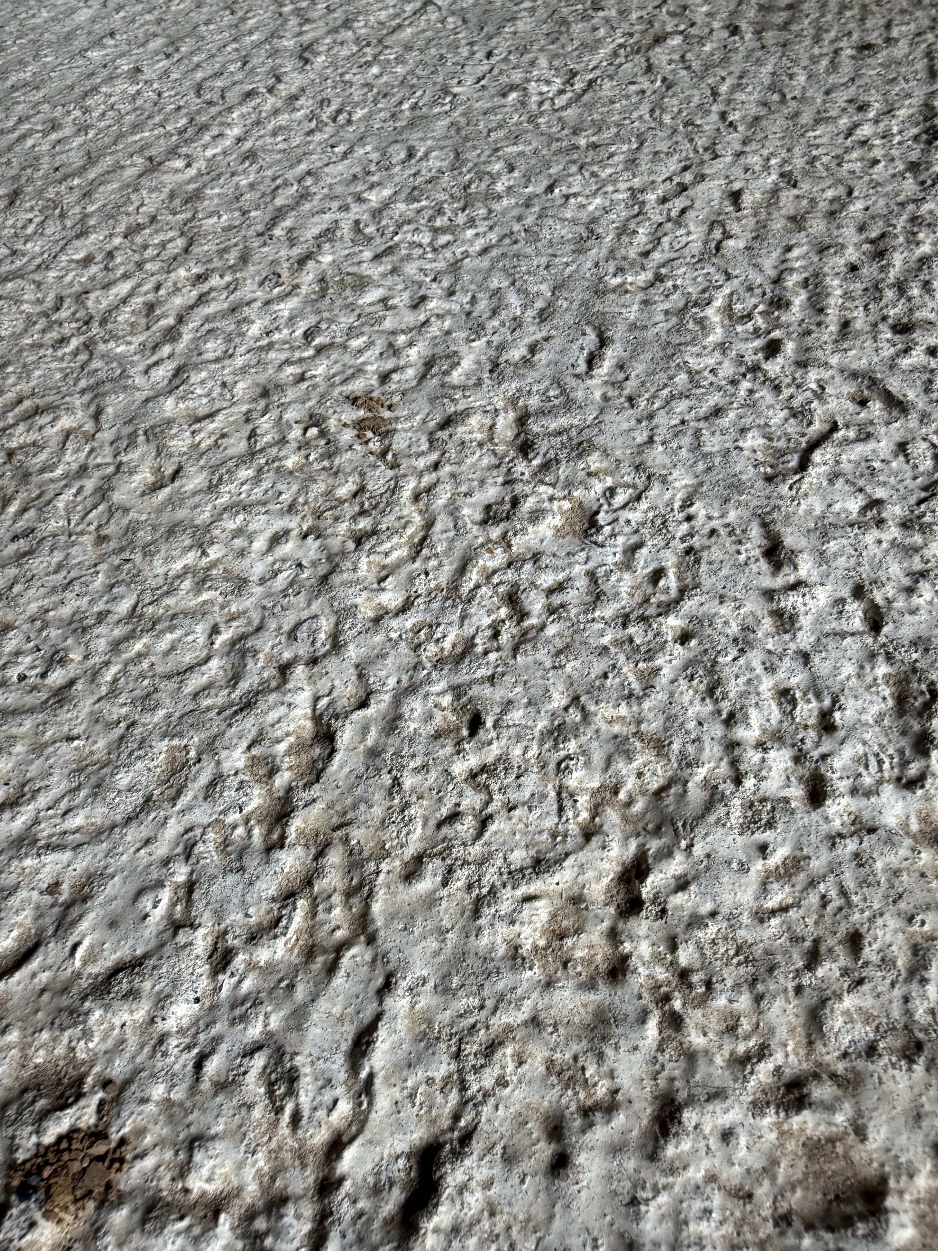

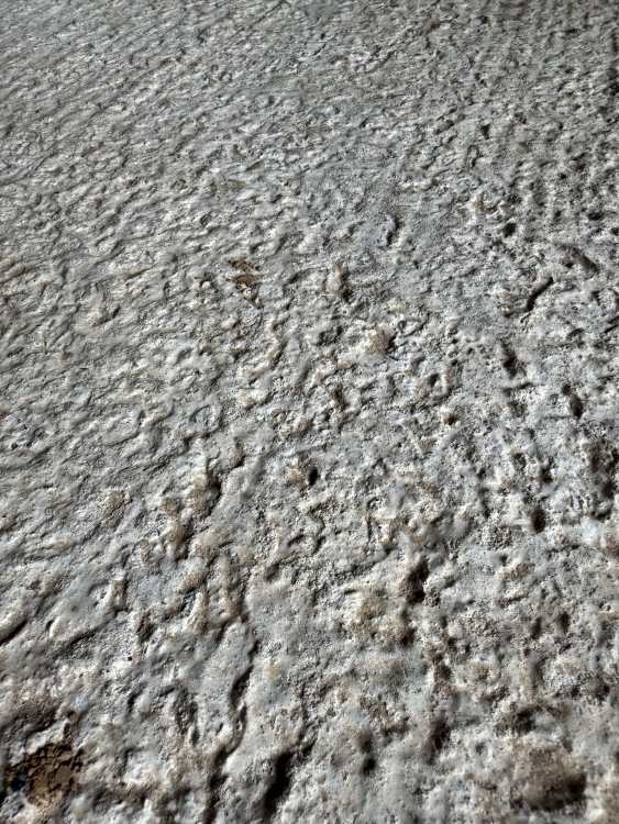

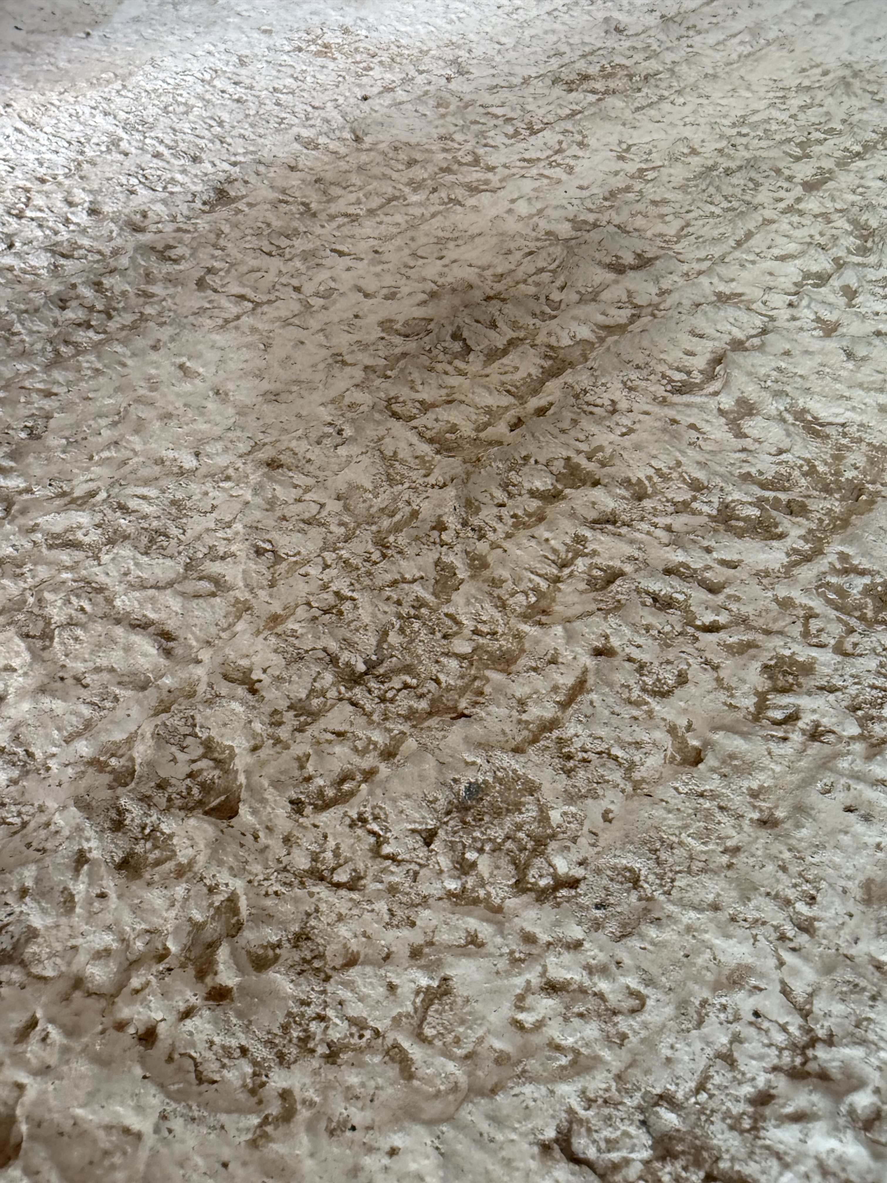

junglejim Posted Sunday at 15:51 Author Posted Sunday at 15:51 Here’s some photos of the slab…any thoughts? I’m thinking of laying a geotextile to protect dpm. What do you think?
Big Jimbo Posted Sunday at 17:14 Posted Sunday at 17:14 That looks rough as IMO. A thin layer of EPS before you put the membrane down would do the job.
