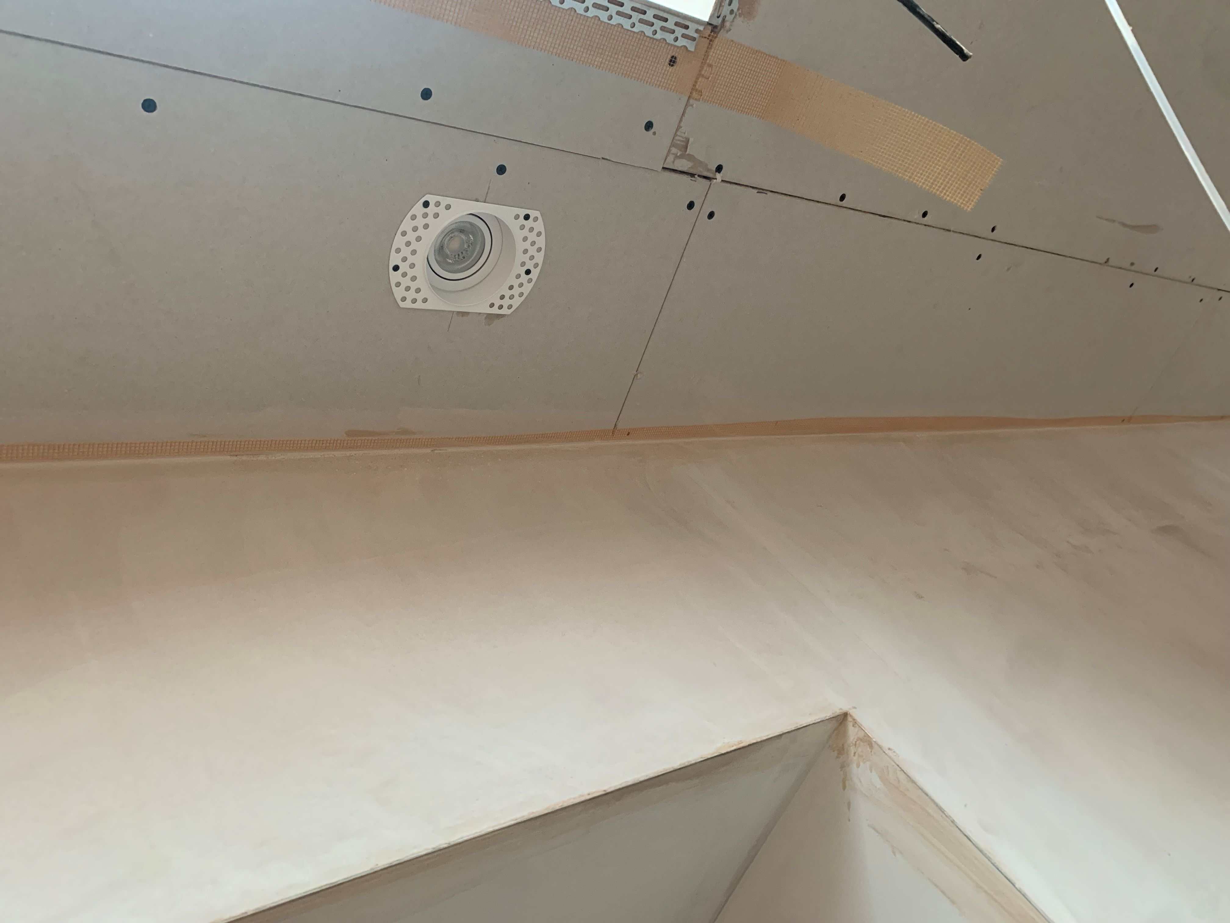

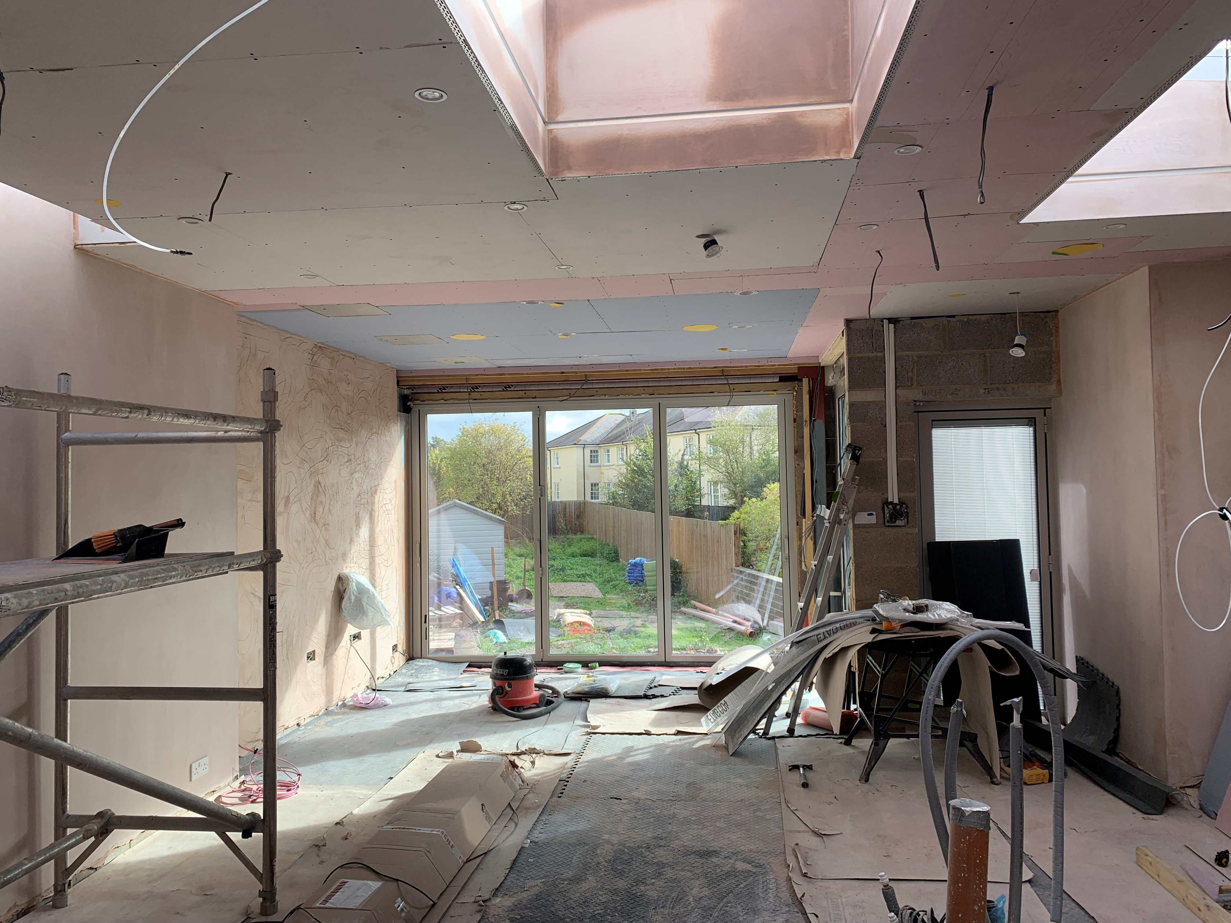

Spinny Posted October 26, 2025 Author Posted October 26, 2025 Well walls are largely plastered already - some hardwall, one wall boarded - see pics. They put mesh in at the junction when they plastered the walls. Too late to change plasterers, I already changed once. They have been plastering for 12 years. All I can say is they are better than the original one the builder had. Not perfect, but not as bad. It actually seems quite difficult to judge plastering as the walls tend to look perfect when freshly plastered, only when dry does the odd flaw show up.

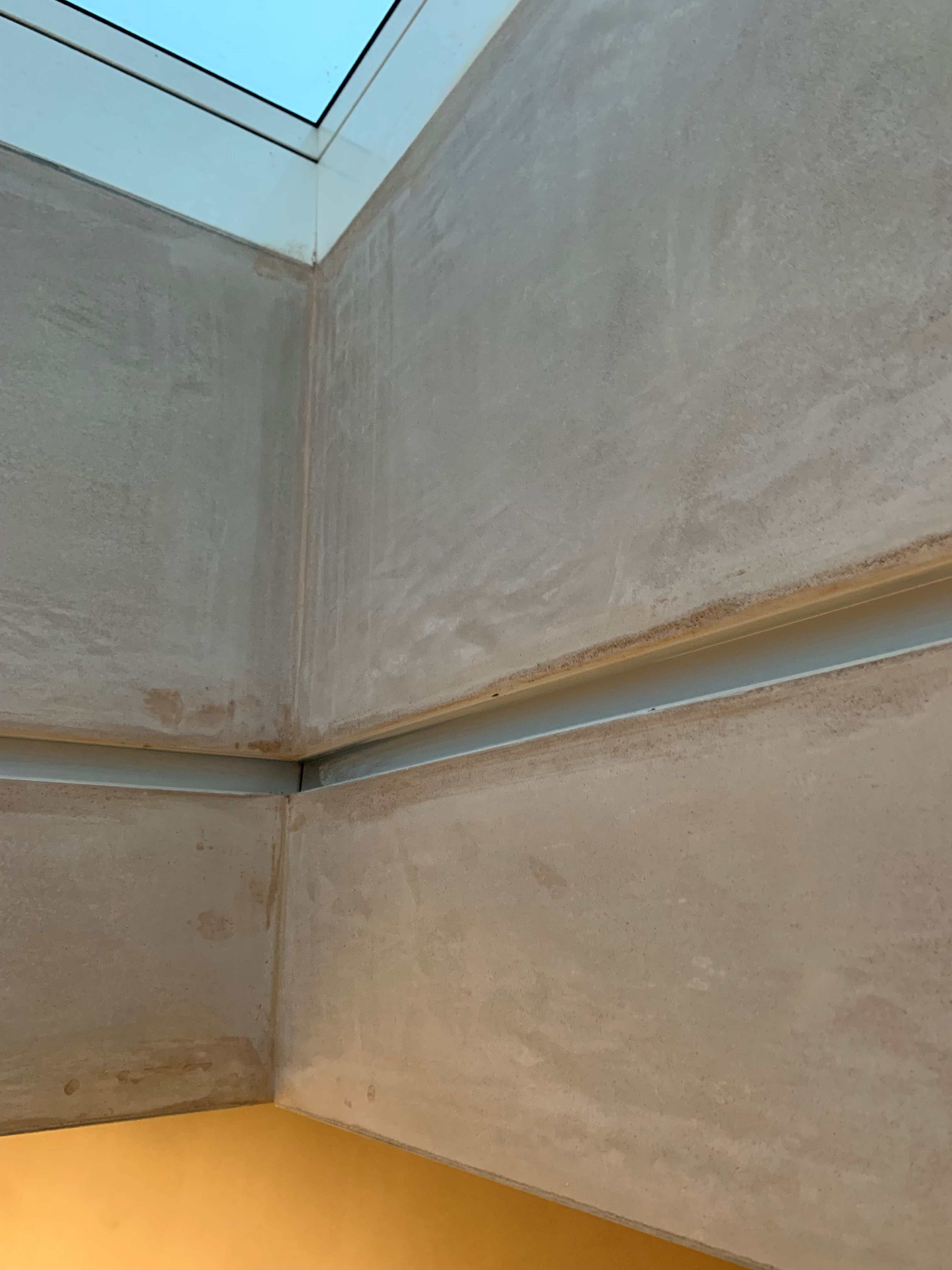

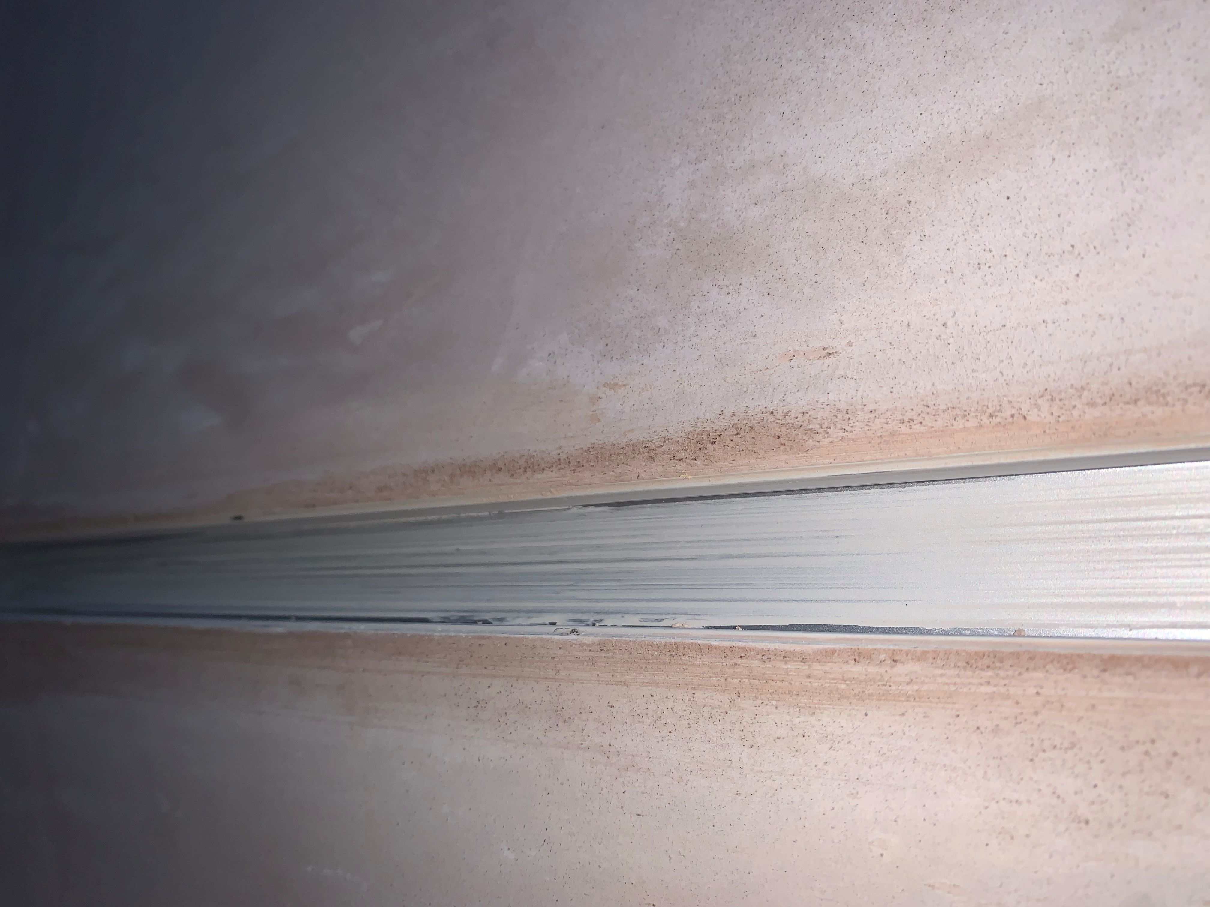

Spinny Posted October 26, 2025 Author Posted October 26, 2025 (edited) Looking at the rooflight makes me concerned regarding the edges adjacent to the LED profile etc... The plaster is grainy/gritty adjacent to the profile and in places near the top bead. The profile was filled with a foam strip to keep it clean during plastering at the plasterers request - but maybe not a good idea ? Edited October 26, 2025 by Spinny
gaz_moose Posted October 26, 2025 Posted October 26, 2025 worst case it will need a bit of easi-fill to sort out any rough bits. as others have said it is achieved by not being crap at plastering. As a crap plasterer, I would say you can see where they have wet brushed it to clean it after plastering.
