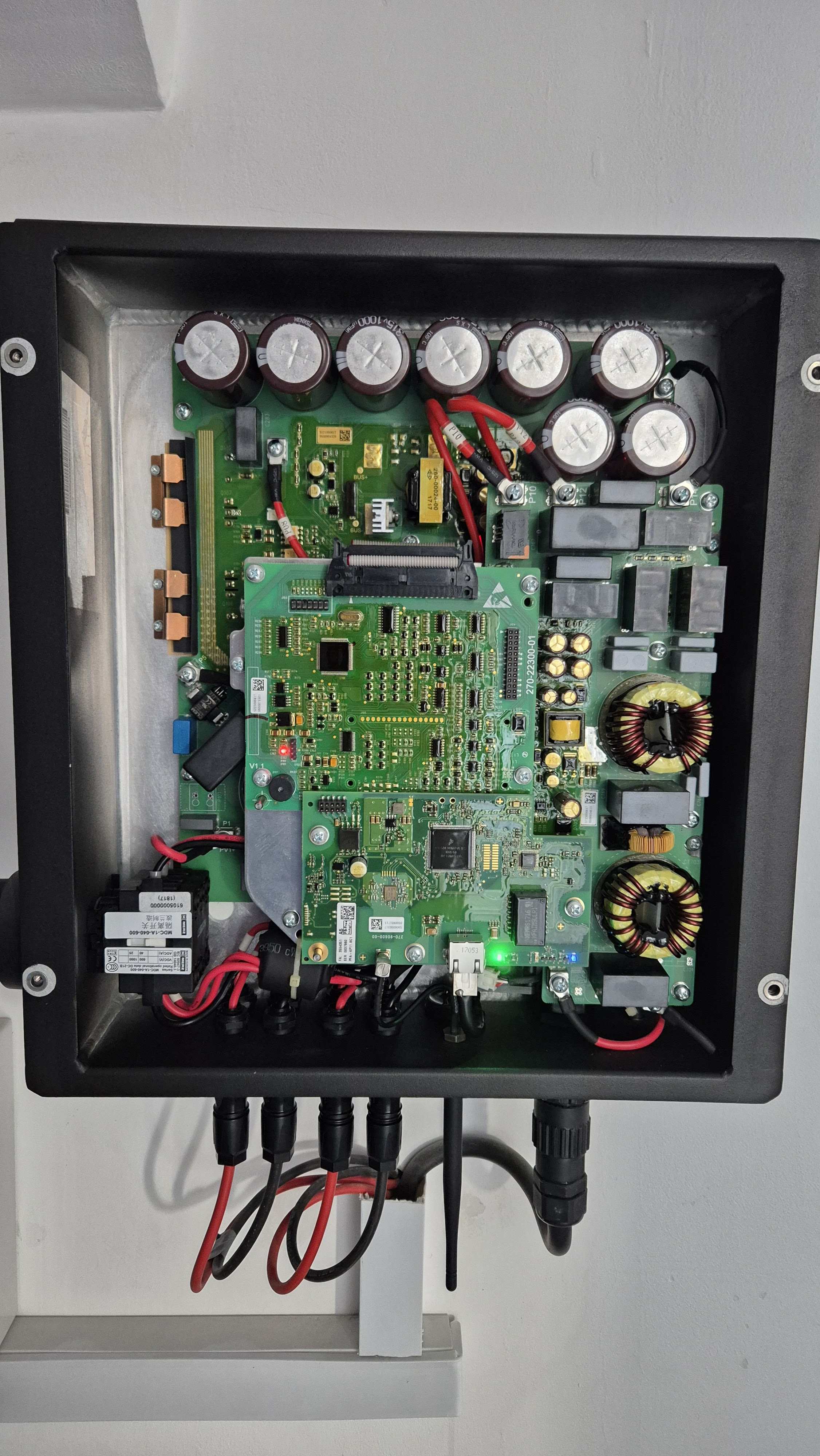

Ultima357 Posted October 22, 2025 Posted October 22, 2025 Hi everyone. I have a Sunny Boy SB3.0-1AV-40 inverter, about 7 years old now, having churned out just over 35Mw in its life. It has 2 strings of 10 x 150w panels each, all due south and no shading. (Location in sunny Cyprus, hence the power generation). I'm now trying to fault find an issue where it is constantly restarting, relay clicking in and out, sometimes a few times a minute. It's not consistent which is also a head scratcher but always occurs from around 9am to 11:30 ish but can also happen at other times too. So far I've found the strings are iffy, panels now some 12yr+ old as previously powered a battery support system. One string is 265v and the other 365v. Plan to sort that out this weekend having sourced some equivalent replacements from a similar system that has been dismantled. £0 so a good find. But, not withstanding the above, further experimentation of running on just one string, it still exhibits the same problem. I've only got basic voltmeter and current clamp and the inside of the inverter is one of layered circuit boards, so very unfriendly. Nothing obvious fried or smelly though. Curiously, the 8 large capacitors at the top of the unit are 4 at 178v and 4 at 0v. That seems odd. Measured simply from capacitor top to ground. Unable to find a circuit diagram, so at a loss as to what else to measure, but beginning to think the inverter is the issue. Oh, no great problems reported on the monitor either. Used to get grid over voltage shutdown but not now, it being typically 240 to 245v. Any ideas?

Ultima357 Posted November 6, 2025 Author Posted November 6, 2025 End solution. Well I managed to borrow a 2nd hand SMA inverter and plumb it in which proved that the issue was in the arrays. They appear to be leaking to earth. After metering each individual panel, 7 were clearly end of life and even getting an array of 10 that seemed OK, you could measure neutral to earth and see the voltage climb to more than 20v just before the inverter tripped out. So plan now is to renew the array and put in another earth rod. A job for the spring time.

Ultima357 Posted November 10, 2025 Author Posted November 10, 2025 A bit of further info for the discussion. The PV system is mounted on steel frames on top of the flat roof which also has the steel framed solar hot water system, duly earthed as it also contains an immersion system. So the steel frames are also earthed and panels directly screwed to them. The panels are 14 years old, probably had 3 to 4 times the sun that UK panels have over this period. Rated at 30v, the 'good' ones showed around 26v on the day they were measured but the 'bad' ones were indicating 37v. So all a bit odd. Ground earth is flaky out there due to the rocky subsoil and immensely dry conditions. Eg, hasn't rained since April in any amount that did more than lay the dust for 30 minutes. The power grid is also flakey, giving frequent power cuts and brown outs, overvoltage spikes etc. I protect sensitive kit with regulators. As for risks earthing stuff on the roof re lightning, well the normal steel reinforced concrete frame means that the whole building will be effectively at earth potential and although thunderstorms are quite frequent, it is very rare to hear of any damage or fires being caused by strikes.
SteamyTea Posted November 10, 2025 Posted November 10, 2025 47 minutes ago, Ultima357 said: Rated at 30v, the 'good' ones showed around 26v on the day they were measured but the 'bad' ones were indicating 37v. So all a bit odd That is odd as PV modules are fixed voltage devises (they are diodes). More investigation would be needed there.
Ultima357 Posted November 10, 2025 Author Posted November 10, 2025 1 hour ago, SteamyTea said: That is odd as PV modules are fixed voltage devises (they are diodes). More investigation would be needed there. That's why I decided to replace them. You could easily spend a few hundred quid chasing your tail with tests etc, so simple to change out as 450w panels ard only about 84€.
